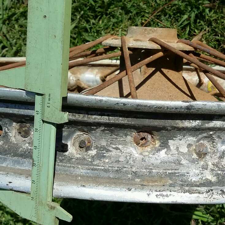

Anyway I am still keen to work out what this :bultaco: rear wheel is off? We thought that because there was a wheel still bolted to swing arm in the shed and there was a M99 Alpina frame under the house missing a swingarm and rear wheel that they must go together. But the rim is only 60 mm wide and it had an Ag bike directional knobby fitted, maybe that is not true?
The hub has much bigger cooling fins and is all aluminum:

So we know that the all-alloy hub type was on at least two 1966-67 :bultaco: models and very likely earlier but by 1968 the small spoke flange on similar hubs were being made of pressed steel and riveted on then later bolted on. This reeks of the all-aluminium small flange design being either too weak, too tricky to cast, or too expensive to make.
Another clue is that I think the square-edged cooling fins on my all-aluminium hubs predate the thin-edged cooling fins on your all-aluminium hub.
Lots of clues but needs more thought.

I think that’s a mk4 or even maybe mk5/6 Lobito rear wheel they had the solid aluminium hub
A m99 has a bolt on spoke carrier or should do

I'd have said Lobito too. Or Campera which I believe was marketed as an Ag bike in some markets.
