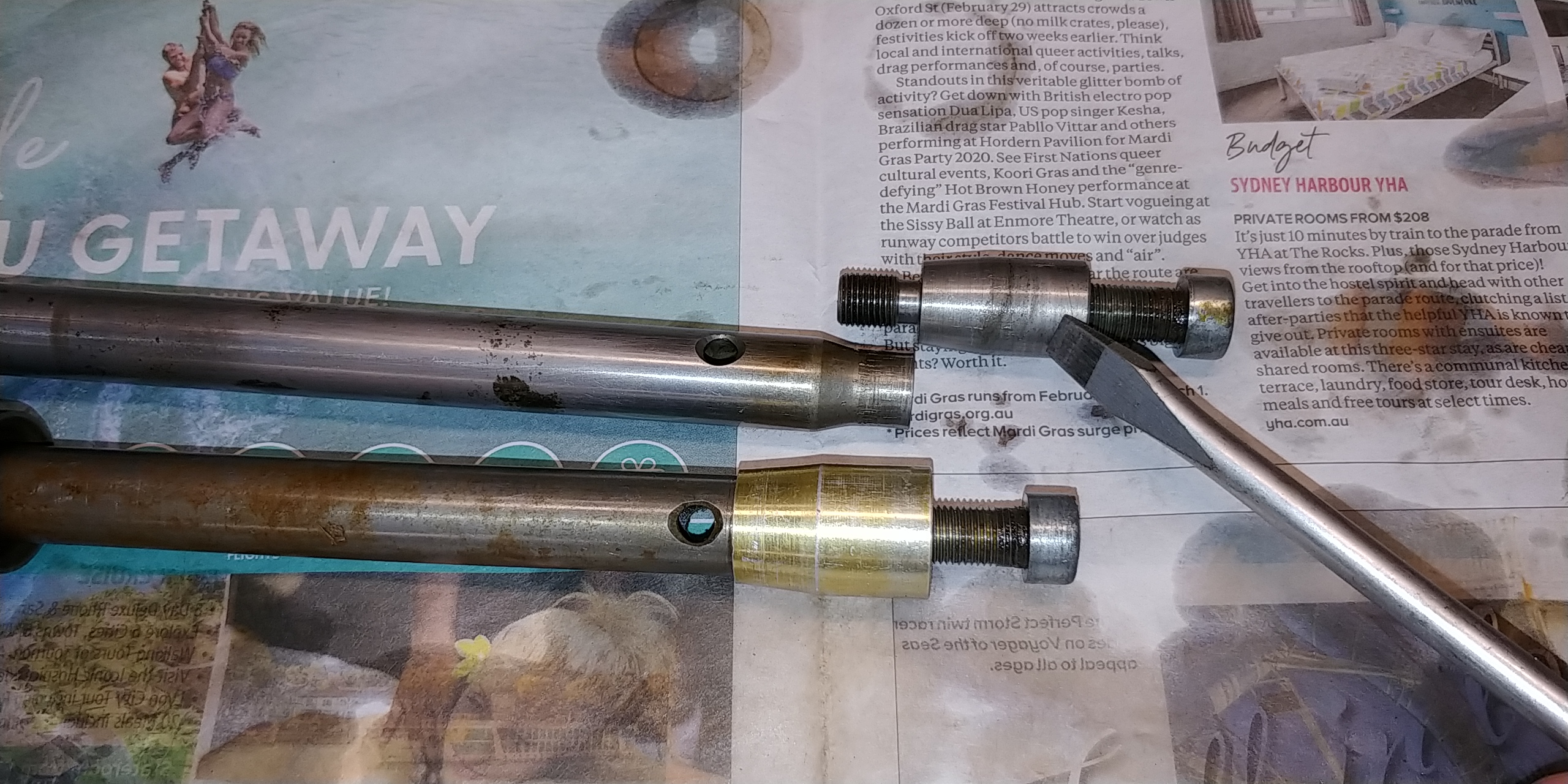

I've been rebuilding an old trials bike for a friend and found something interesting with the TY250 forks that's probably worth sharing. It can take the form of a quiz if anyone is interested so we'll start that way.
The photo shows the bottom ends of two TY250 damper rods. The bottom damper rod is a standard setup from another TY250. The upper damper rod shows a thing that was screwed into the bottom end of the damper rod when I got it. I've taken it out for the photo. Both forks were set up like that on my friend's bike.
What is that thing?
What does it do?
Why was it there?

Looks like someone was trying to increase travel.
It will make for flexi forks due to less overlap

That was an old trick for making more travel in the forks. So I agree with BrentJ. I`ve done it on a set of TM 250 forks when I had to put them on my RM125S as the TM forks had less travel. Wow that was a long time ago!
They sure did Brent. I remember seeing those kits advertised in USDB magazine when I was young. This one was designed in such a way that the fork tubes smacked into the bottom of the sliders exactly when the springs reached coil bind. Also the spacer/cone is too small diameter to work as a hydraulic cushion when they bottom.
The other problems with it on this bike are that it made the stand too short and the front brake cable too short.
It added about 25mm to the fork travel.
Whoever fitted it did a good job making sure it couldn't unscrew in service and let the fork sliders and wheel fall off which would have been a distinct possibility. I had to warm up the Loctite to be able to unscrew them.

The mods to those TY250 damper rods were done when the bike was owned by Stephen Gall and it was being used for cross training
