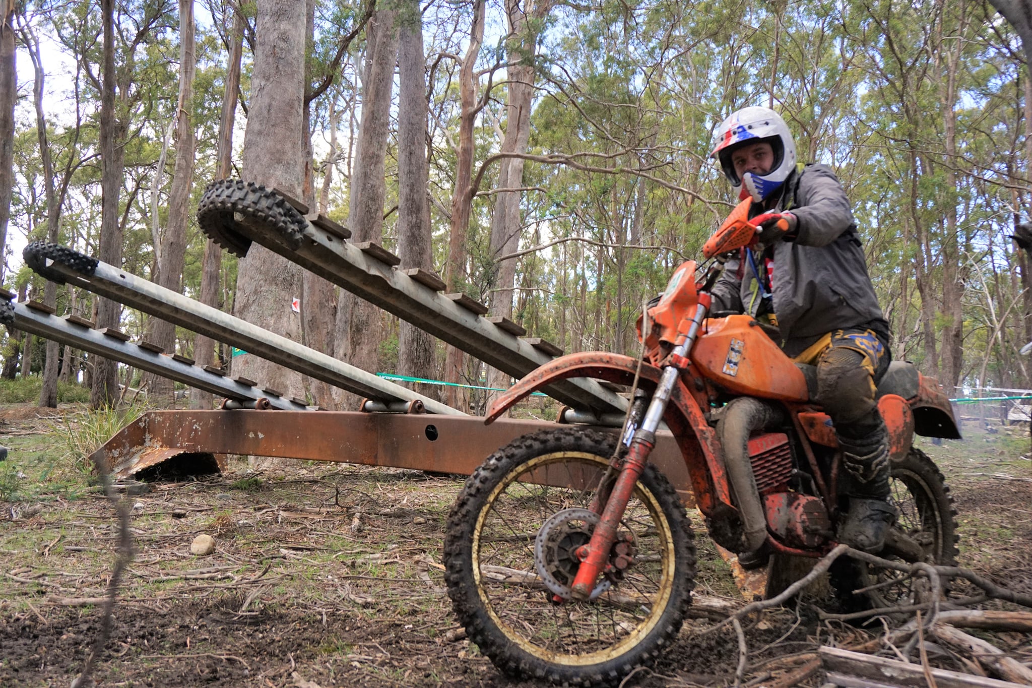

In SWM news, the raging 347 TF3 has completed its first Enduro a couple of months ago after a full rebuild.
The course was described as quite flowing at the riders briefing with a lap of around 20Kms in the foothills of the tiers to the central plateau in northern :TAS: .
After about 3.5 Hrs to complete one lap I decided that the flow must have been referring to the mud in the large bog holes.
In one particularly deep hole I could walk away from the bike and it would stay upright glued in position.
The fortnight leading up to the event it had rained almost constantly causing very deep creek crossings and the track to be mud, mud and more mud.
After the first deep creek crossing I passed a couple of KTM's riders engaging the bilge pumps.
An unexpected problem I encountered further out on the course was the swingarm. The riders before me cut extremely deep ruts with the knobbly rear tyres. Their bikes being newer monoshock designs could fit inside the width of the groove.
I would get there and feel the back end of the motorcycle rise up and we would be firmly beached with the swingarm sitting on either side of the rut.

Hey Kurt, nice enduro SWM'er. Your Trials experience would have put a lot to shame in those conditions but what's going on with those side panels on your SWM, they look like they're encroaching on the seating area, looks irritating when seated.
Posted: Fri Dec 11, 2020 3:56 pm
by Kurt
Mark - I had played with the idea of a squirrel grip of vices but that would be even further over the line.
I didn't notice the side panels Rod but i'm not 100% sure they are correct for the model as they had been replaced before I got it.
All the other plastics are the original Acerbis pieces - extremely brittle and spider cracked all over. it almost looks like broken tempered glass.
I had a good battle the next Enduro after this one with a bloke on a YZ250 four stoke, He would pull away in the flowy areas and I would reel him back in through the technical areas with tight turns and logs and I could also close in down the straightaways with the 350cc of 2 Stroke power.

So good to see you with your foot down in both photos Kurt, love the SWM!
