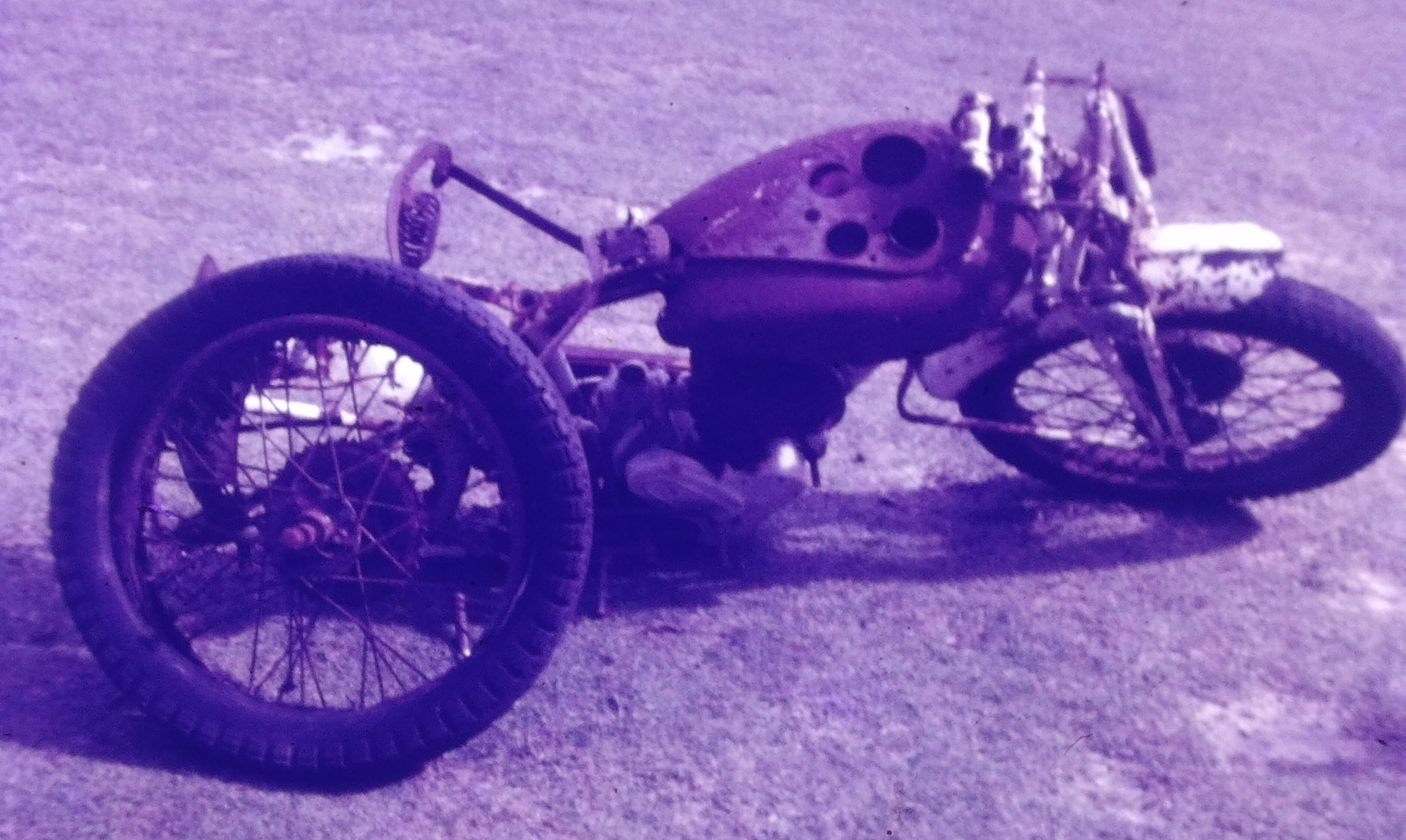

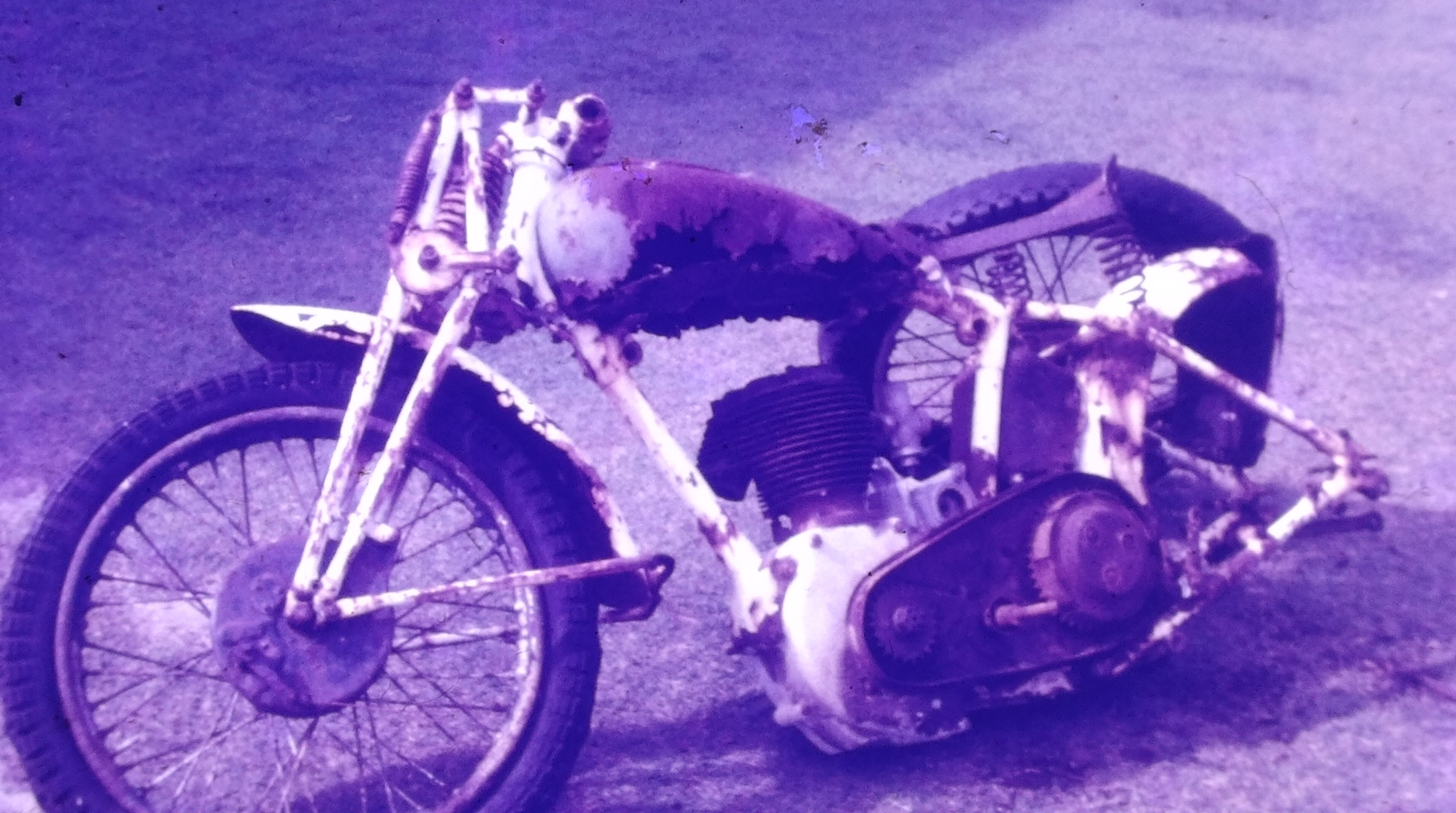

Is this a basket case?
In the early 1970s, my Dad spied a very weathered 1937 Norton 16H in the bush near the road to Adder Rock beach near Point Lookout. Being a Norton person, next trip to Stradbroke Island he took a trailer and brought it home. This is what it looked like in a back yard at Point Lookout.
Yes it was returned to a running condition by my Dad. Amazing

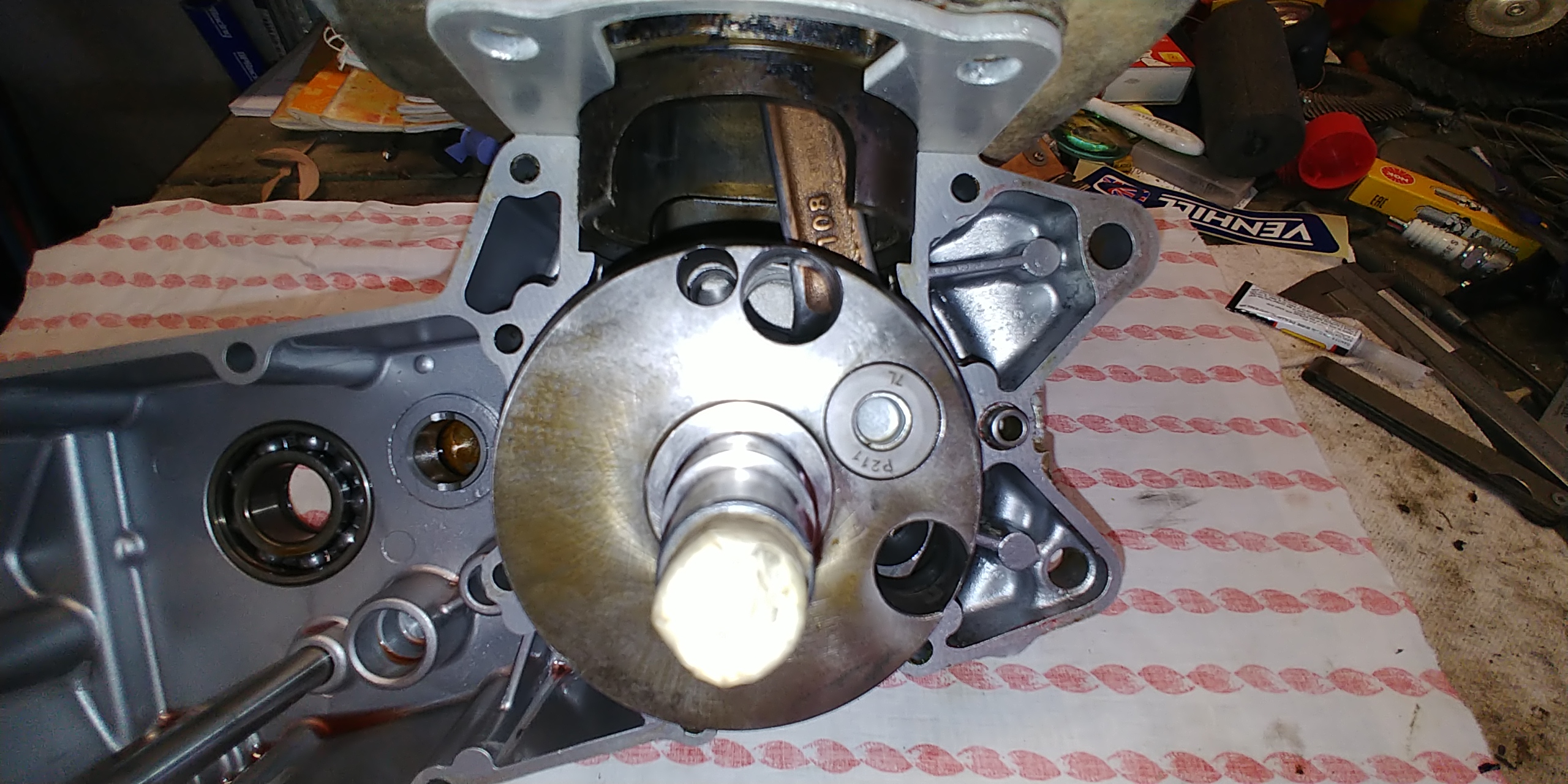

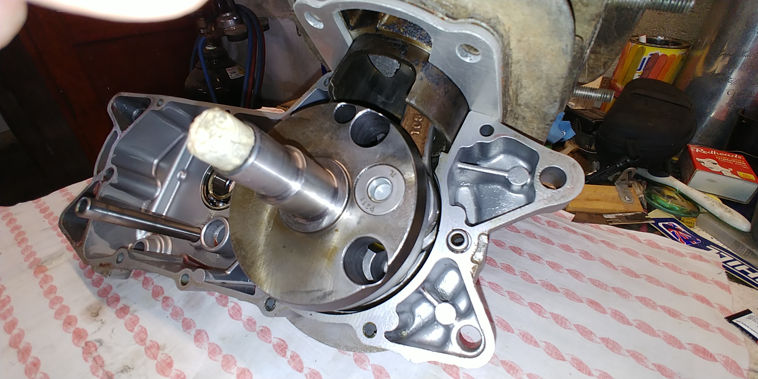

I'm awaiting a part for the 360cc :yamaha TY250 I'm rebuilding before I can progress it so today I made a start on the reassembly of my :kawasaki KT250 motor.
I pulled it apart about a year ago to get a rebore done and decided to replace the conrod at the same time. It still had the original 45 years old conrod and I didn't want to have to pull the motor apart again any time soon hence the new conrod kit.
George McKenzie sourced and fitted the conrod kit to the crankshaft. It's a high quality aftermarket conrod kit made for a :kawasaki KX and as such is a few mm longer than the original :kawasaki KT rod so a cylinder spacer is needed to get the piston at the right height. I bought a spacer kit from Robert Cochrane in NZ for this.
The cylinder studs end up a bit short with the spacer there and I'm in the process of deciding how to deal with that.
Anyway today I test-fitted the crank in one side of the crankcase to check that the new conrod will clear the crankcase mouth. There are important differences to the geometry of the clearance for the rod: The new rod has a bigger cross-section near the bottom, the spacer and the longer rod changes the angle of the rod at that point of closest approach to the crankcase.
George lightened the new rod to get it close to the mass of the old rod, to help with crank balance. Where he removed metal is where you can see shiny areas on the rod.
The Wiseco piston going in is one made for the :Honda: CR/MT 250 Elsinore and they do sterling service in the :kawasaki KT250 motor. The piston that came out was also a Wiseco CR/MT250 piston that I fitted about 20 years ago when the bike had its first rebore.
To make it easy to do the test-fitting today, I loosened the fits for the old LH main bearing that I had taken out for the rebuild. For the OD of the outer race, I ground it down slightly using a bench grinder, holding it by the inner race. For the ID of the inner race, I gripped the outer race in a soft jaws vice, ground it with a small mounted stone in a high speed hand drill and applied some drag to the inner race.
