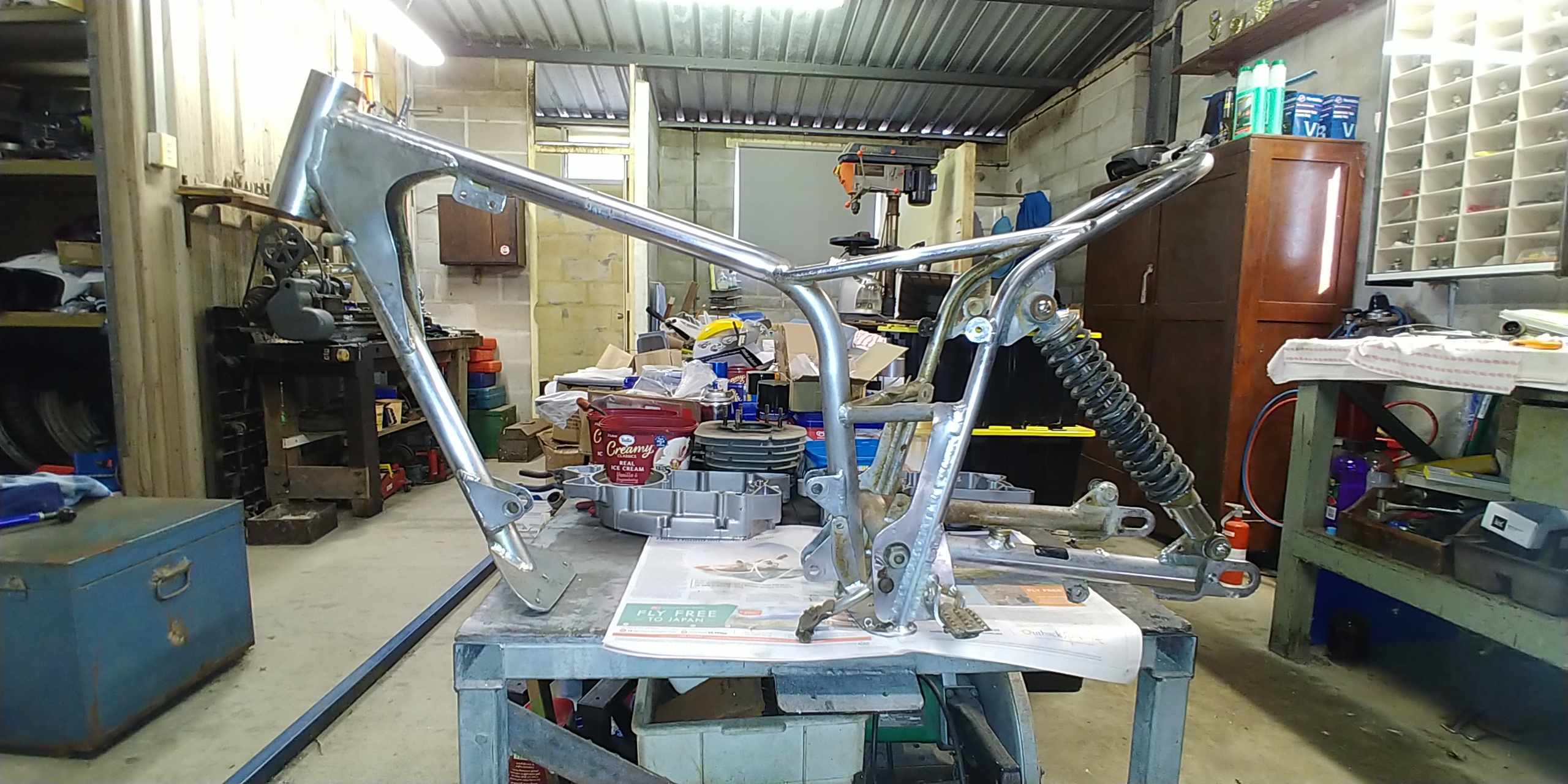

Q1 yes, aftermarket and made in about 1972/74 I'd say. Go on have a guess
My guess would be SM hi-boy frame; if not then Whitlock or Wasp.
Not sure the latter 2 made many for Sherpas tho.
JC1 wrote:My guess would be SM hi-boy frame; if not then Whitlock or Wasp.
Yes John an early type Highboy - as in suits a slimline tank and has a central frame tube in front of the swingarm pivot
With the laid down rear shocks or the earlier version?
JC1 wrote:With the laid down rear shocks or the earlier version?
Hmmm I haven't looked at that yet - the swingarm is still tied up.

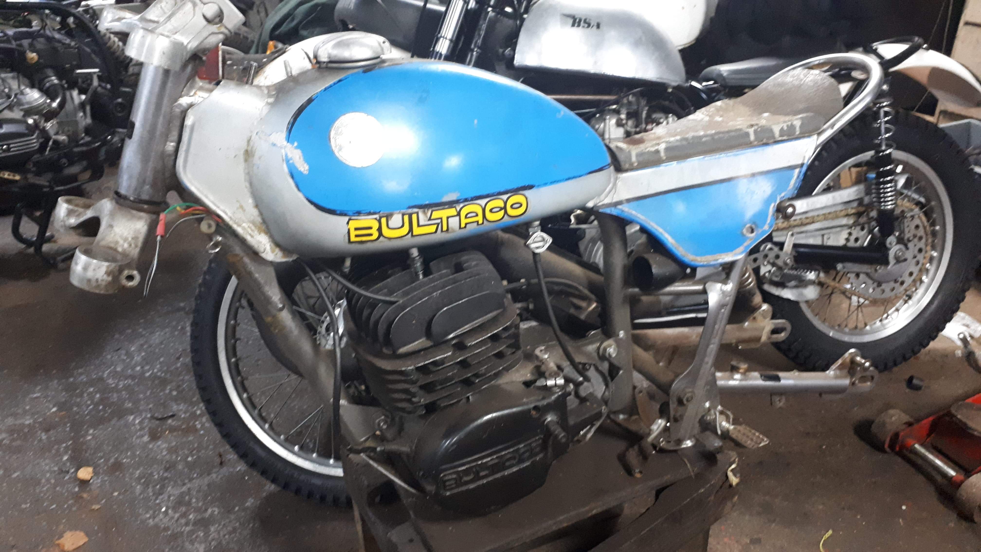

Here's a photo of it in the UK before it was pulled apart.
Yep, that's the model with the laid-down shocks

Shock ratio is 1.42 which means 5.7" axle travel with Falcons.
The model 80 slimline tank comes nowhere near fitting this frame so I didn't show it. The slimline tank/seat is about 50mm too long. Also I'm now thinking that this frame is more like 1975/76 because of it having the Homerlite tank and laid down shocks.
Yes, I'd have thought circa '75 too Dave
Notice in the pic with the Homerlite unit that it has been cut to make it fit around the top shock mount.
Nice frame. From what I've read, that's the one to have.
One of the early SM frames was said to have the footpegs in the wrong place.

I noticed the pegs were further back than the model 80 and model 49. I'm sure there will be lots more revelations along the way.
