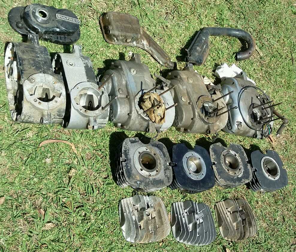

The Sherpa T motors I have available to use are model 49, model 80 and model 198. There is also a model 158 cylinder which could probably be fitted to one of the model 49/80 motors to make it look right.
The motor that came out of the frame (model 159 I think) is available but would cost a lot to bring out from the UK (freight cost alone is $620).

Greg Harding wrote:Likewise, if you have a rolling frame or frame 125, 158, 159 or 198 then I may have your motor or cases and we need to talk. Sorry Graham, there is no 199B motor.
Hi David, do you remember that I have motors that don't have a matching frame? It would be a shame to break a pair if that was what you were thinking?

Greg the frame is a Sammy Miller made in 1975. The motor that came out of it is still in the UK and the original :Bultaco: frame probably is too.
I'm after a big-crankwheel 325 or any 250 :Bultaco: Sherpa T motor with boot-heel casings and square finning to match the era of that frame. Model 125 is a small-crankwheel 325.
I don't want to break a motor/frame pair.

Motor-wise, I'd go with Greg's suggestion.
