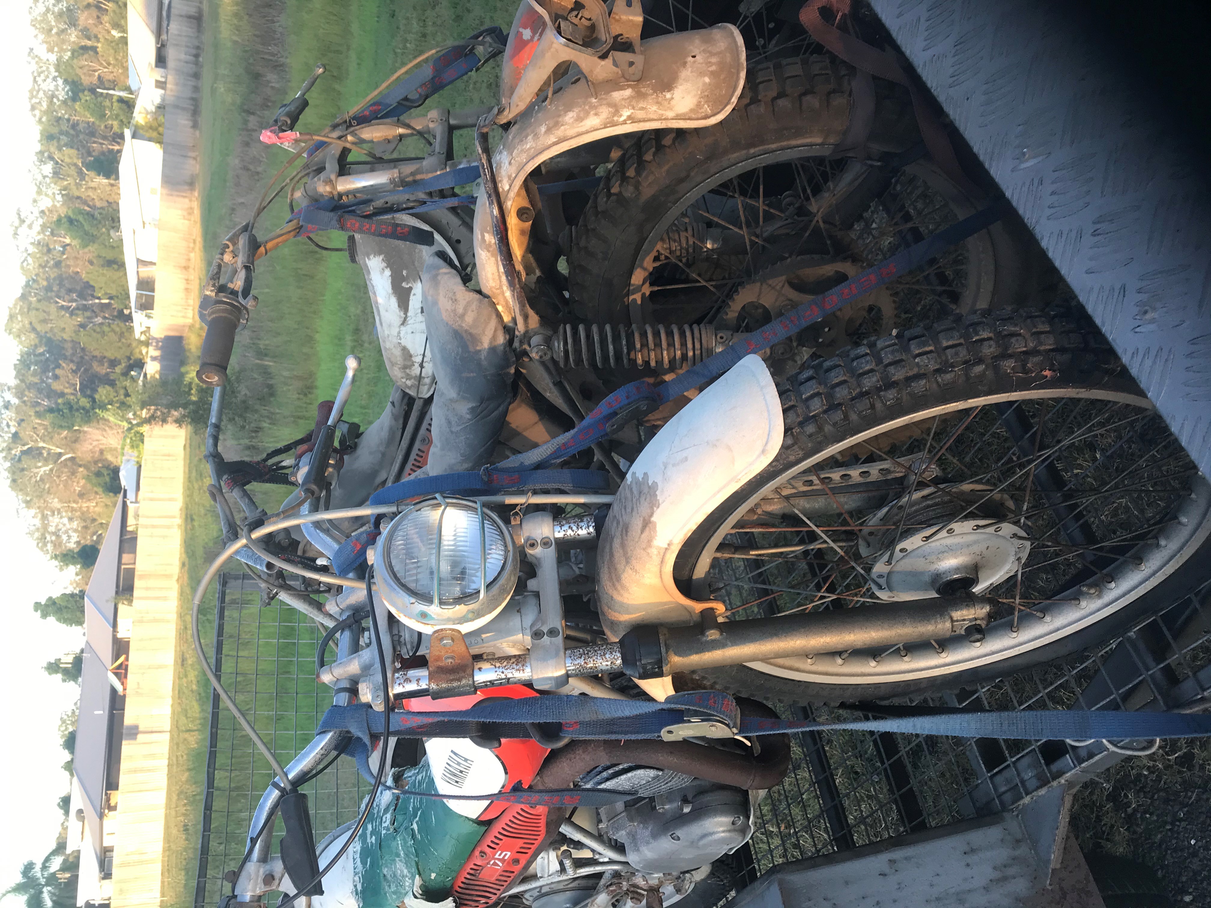

One of my latest finds!! I think it spent most of its life near the ocean and outside. Surprisingly, cleaned the carby and tank out of crud, found an exhaust for it and runs pretty sweet.
Chippy
Really nice work on the Peter Paice
TY250 there David. One of my latest finds!! I think it spent most of its life near the ocean and outside. Surprisingly, cleaned the carby and tank out of crud, found an exhaust for it and runs pretty sweet.
Chippy
chippy wrote:Hi Everyone,
Really nice work on the Peter PaiceTY250 there David.
Chippy
Nice
Chippy. Excellent patina and it's so rare to see a fuel tank that hasn't been caved in.I'm thinking that exhaust looks very familiar

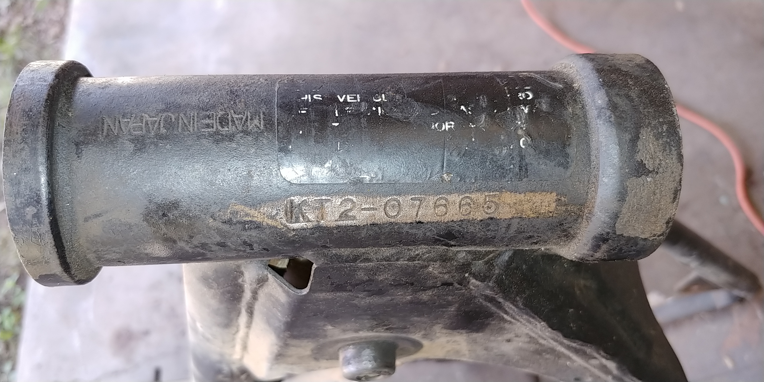

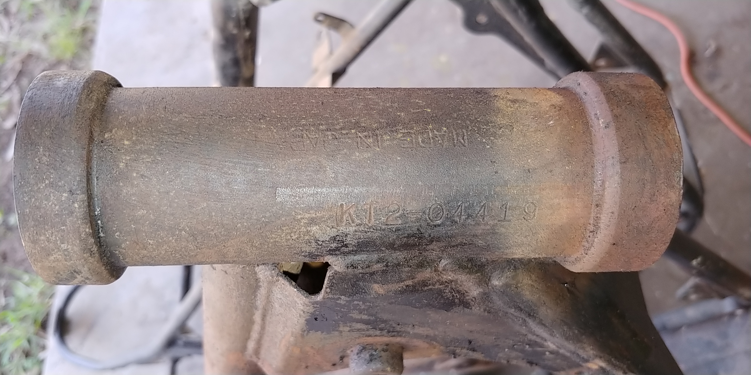

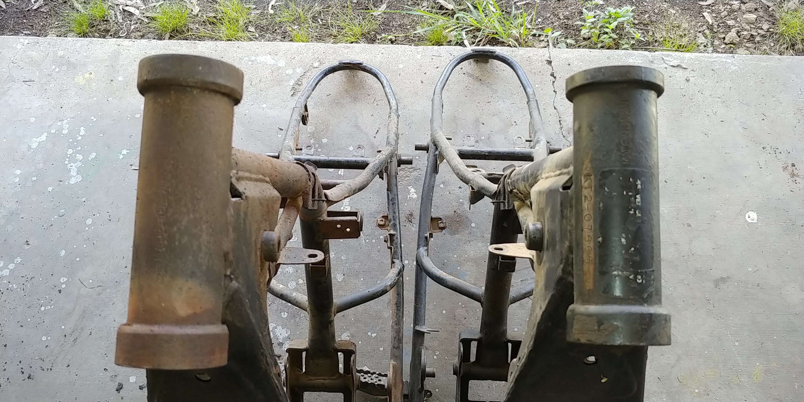

KT250 frame mystery
For the first time, I had two
KT250 frames close together today and noticed that the upper steering head bearing seat is longer on one of them than the other.
I've had the same complete front end in both frames so there isn't a problem with interchangability.
Another interesting thing I discovered today is that the lower steering bearing is the same as a Mazda 323 wheel bearing
KT250 frames close together today and noticed that the upper steering head bearing seat is longer on one of them than the other.I've had the same complete front end in both frames so there isn't a problem with interchangability.
- 20210221_121330.jpg (1.31 MiB) Viewed 1936 times
- 20210221_121320.jpg (1.41 MiB) Viewed 1936 times

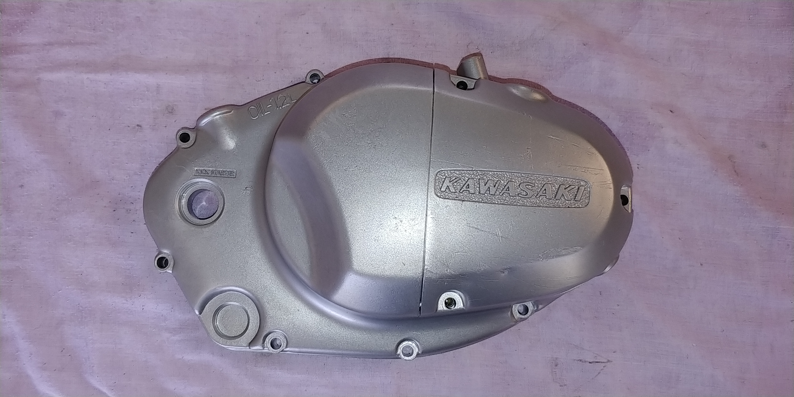

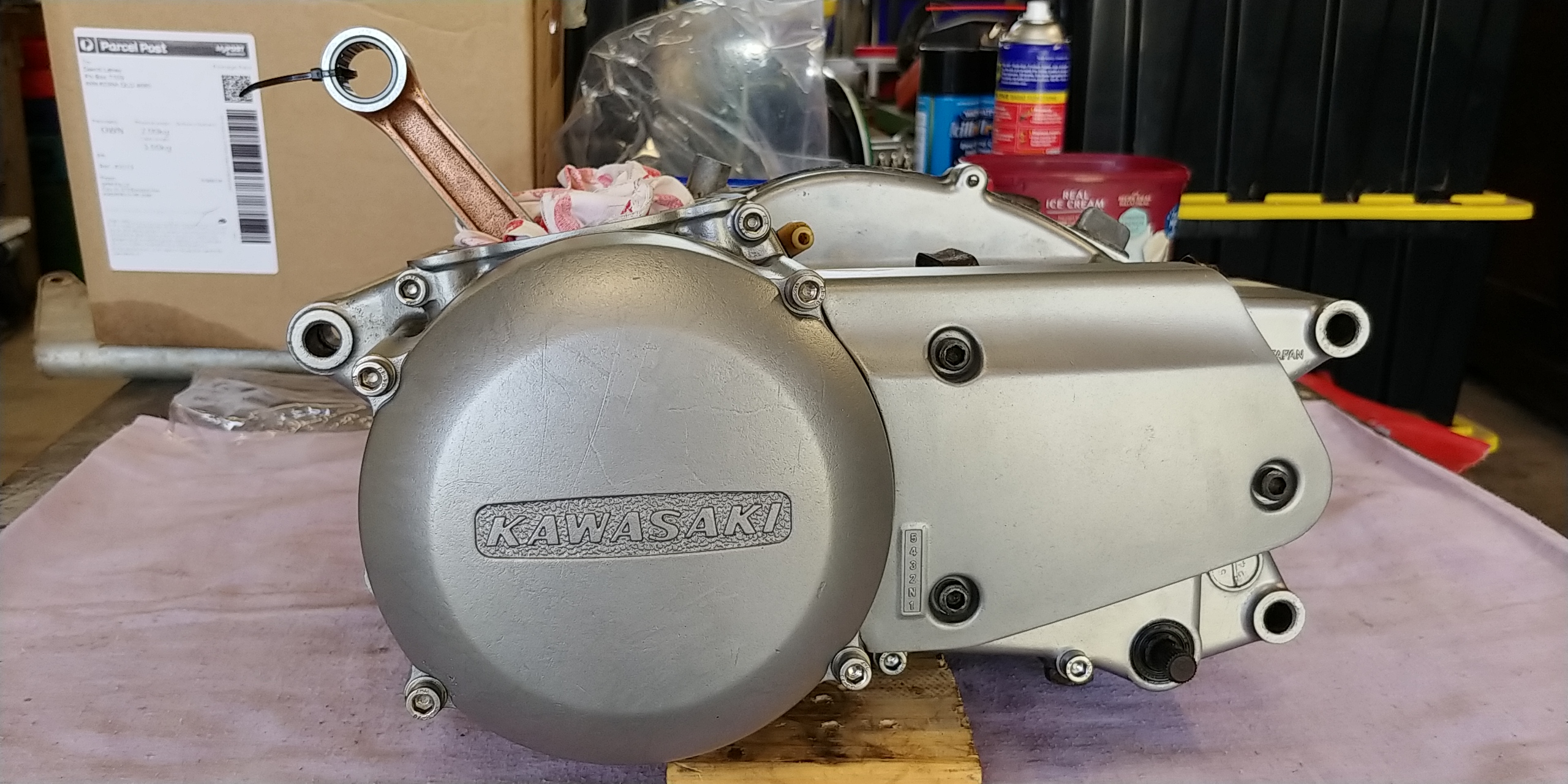

KT250 motor going back together
I just collected some
KT engine covers from the local vapour blaster. He does a great job.
I'm still deciding whether to do the black bits on the
insignia or not.
Yet to get stainless screws for the sprocket cover.
KT engine covers from the local vapour blaster. He does a great job.I'm still deciding whether to do the black bits on the
insignia or not.Yet to get stainless screws for the sprocket cover.
- 20210221_142500.jpg (1.22 MiB) Viewed 1927 times
- 20210221_142841.jpg (1.3 MiB) Viewed 1927 times

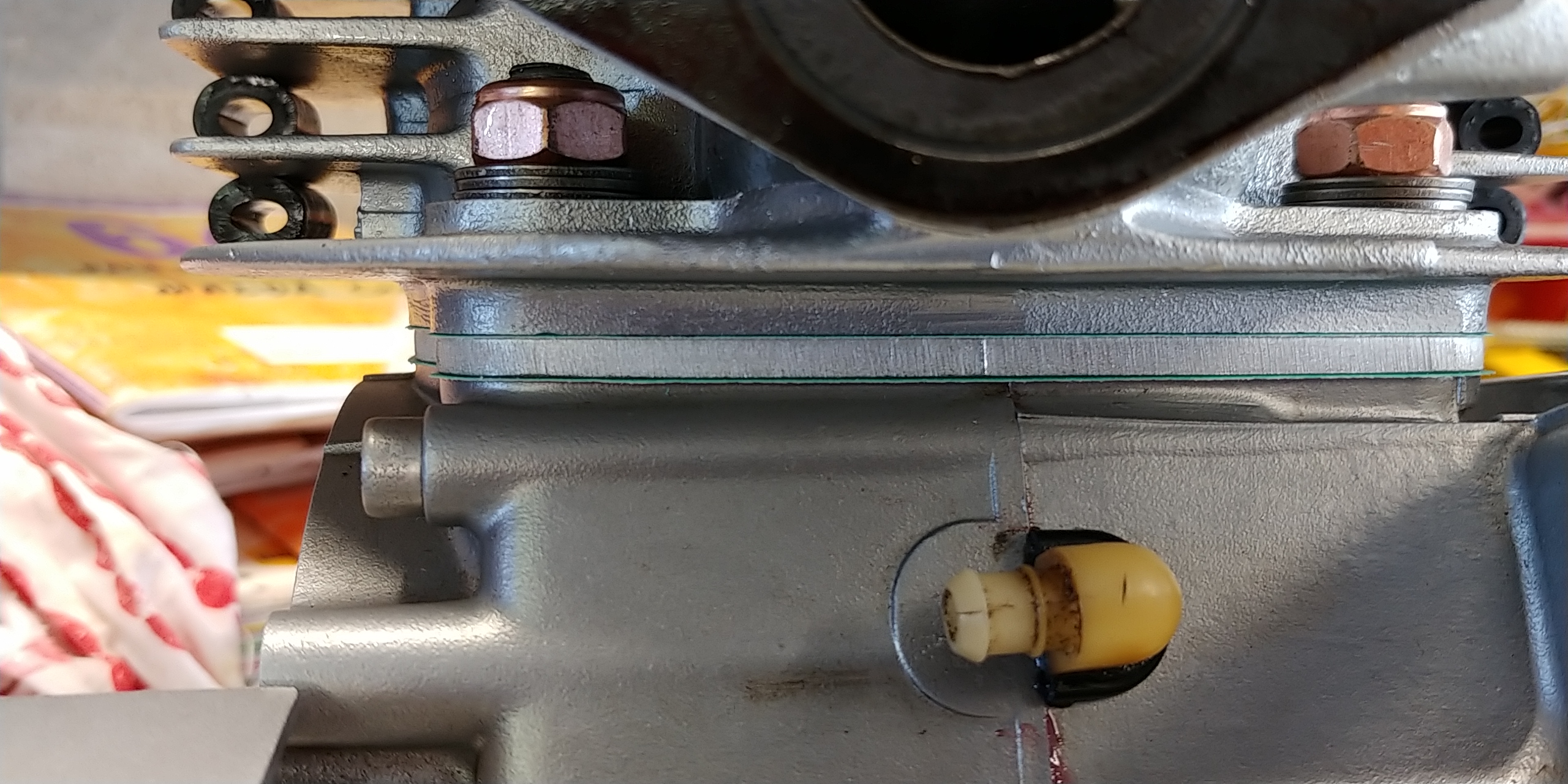

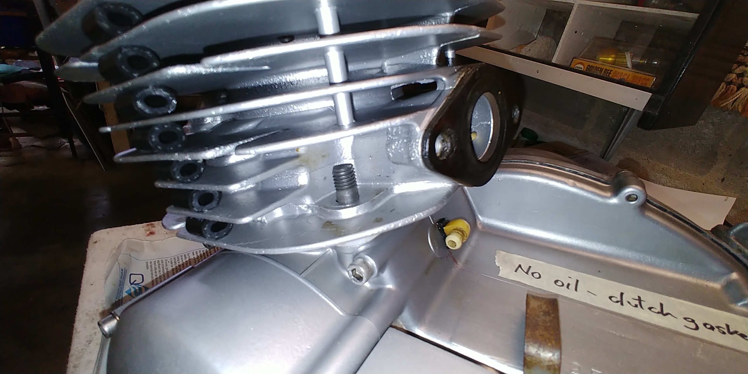

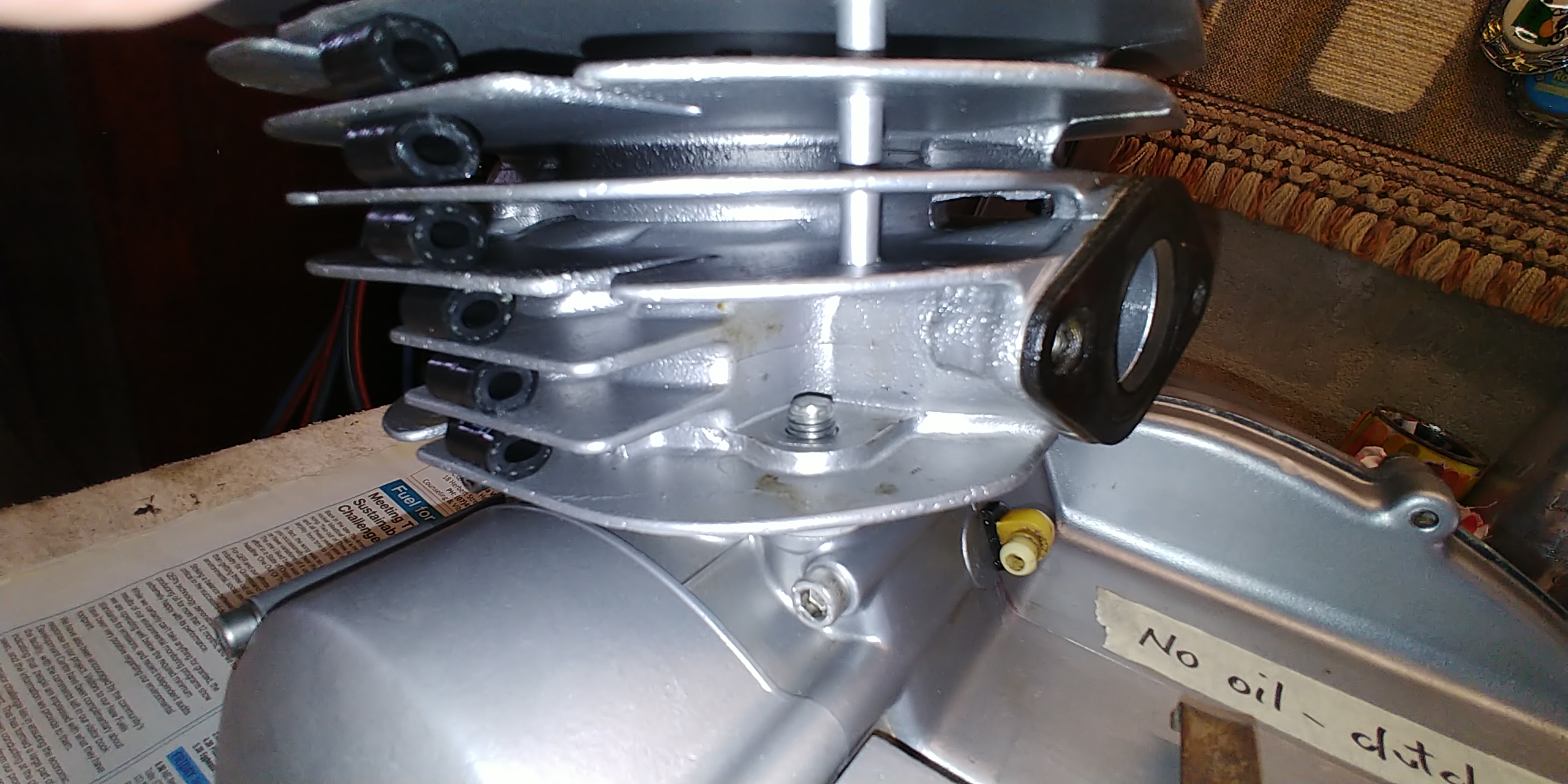

More Kawasaki KT engine stuff
I got to do some more assembly on the
KT250 motor today because the new cylinder studs arrived.
The background story is that I've replaced the conrod in a KT motor and the conrod that was the best fit is a few mm longer than standard. This means that a spacer plate is needed under the cylinder.
I've had the spacer plate for ages but only recently started to put the engine back together and decided to get longer cylinder studs, so that the cylinder holding-down nuts had full thread engagement.
The process of getting longer studs took longer than I expected because the first set of studs I ordered was shorter than original and I wanted studs 5mm longer.
The next set of studs turned up during the week and today I noticed that they were 10mm longer than I wanted (15mm longer than standard). It's easy to shorten them though so today became the day to fit the cylinder back on.
This shows the standard stud length.
This is the cylinder test-fitted with the longer studs.
And here is the cylinder fitted showing the spacer plate. I've ordered some nuts that are more colour co-ordinated to replace those copper-coloured nuts.
KT250 motor today because the new cylinder studs arrived. The background story is that I've replaced the conrod in a KT motor and the conrod that was the best fit is a few mm longer than standard. This means that a spacer plate is needed under the cylinder.

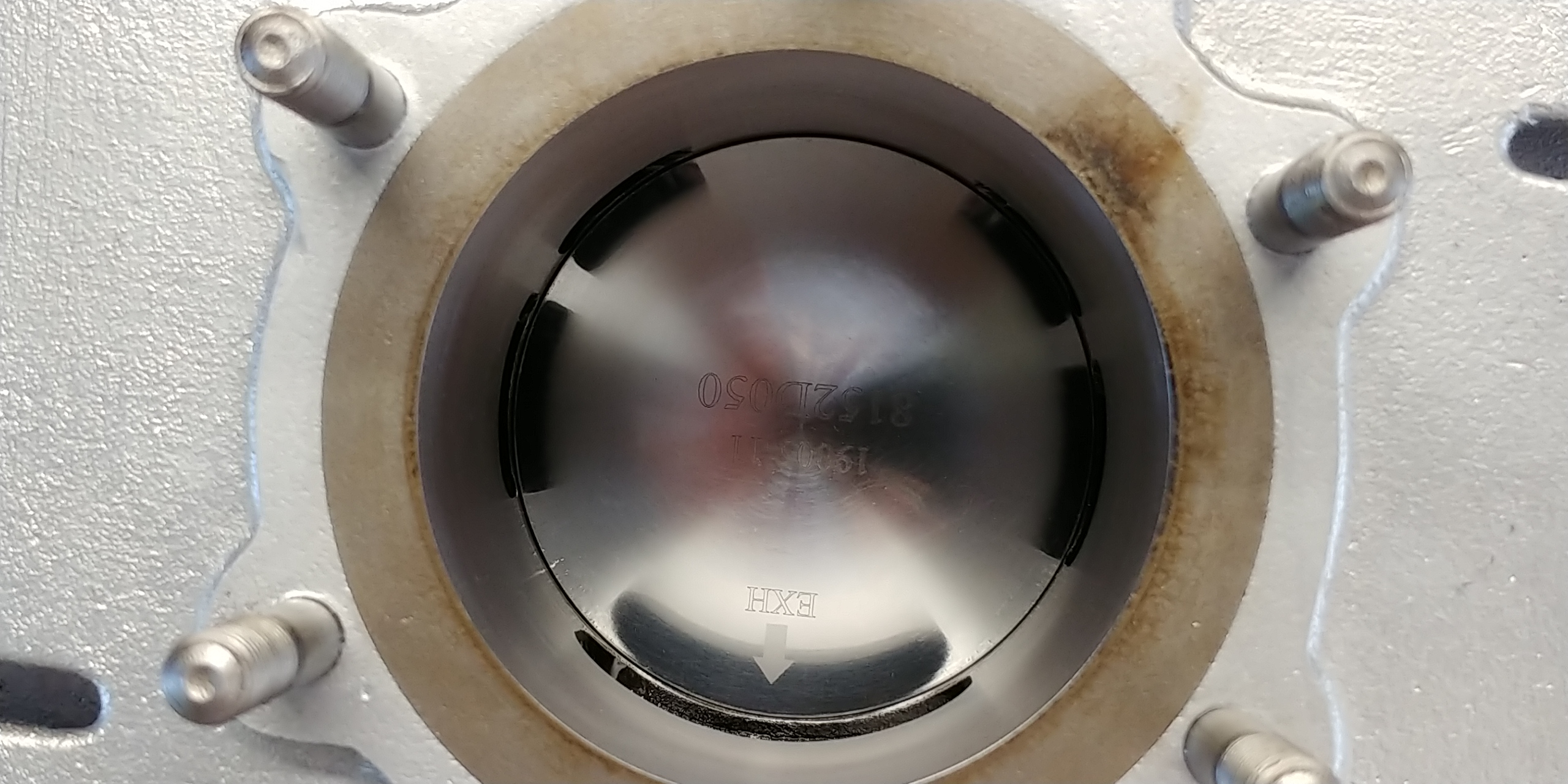

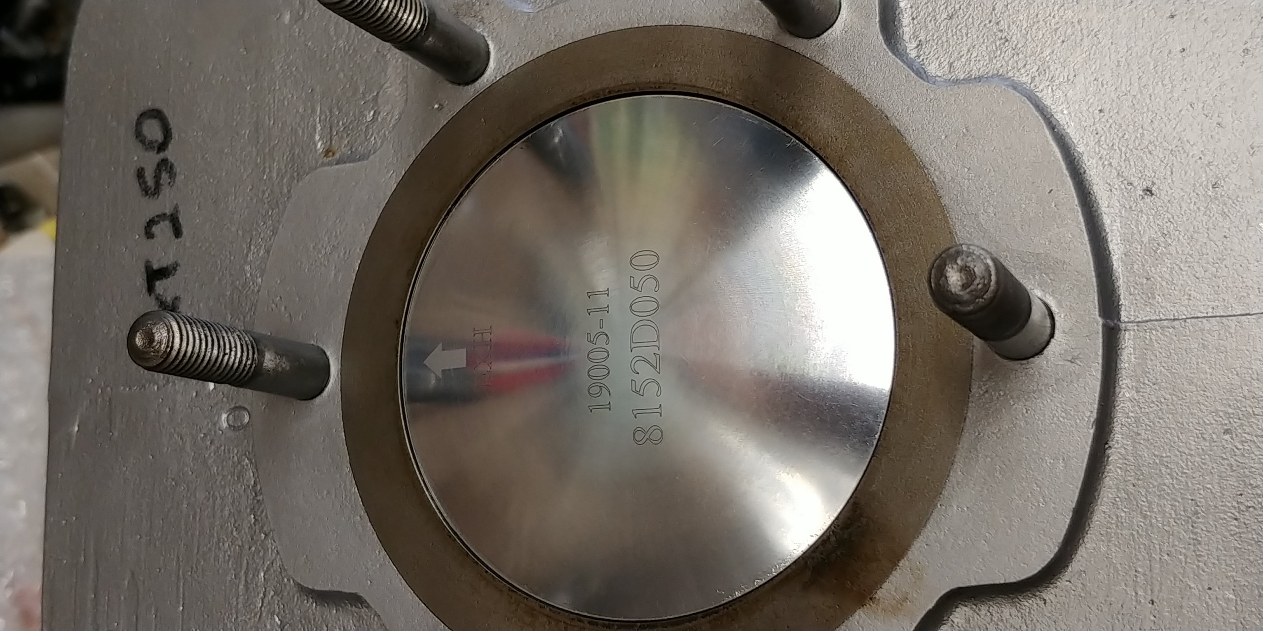

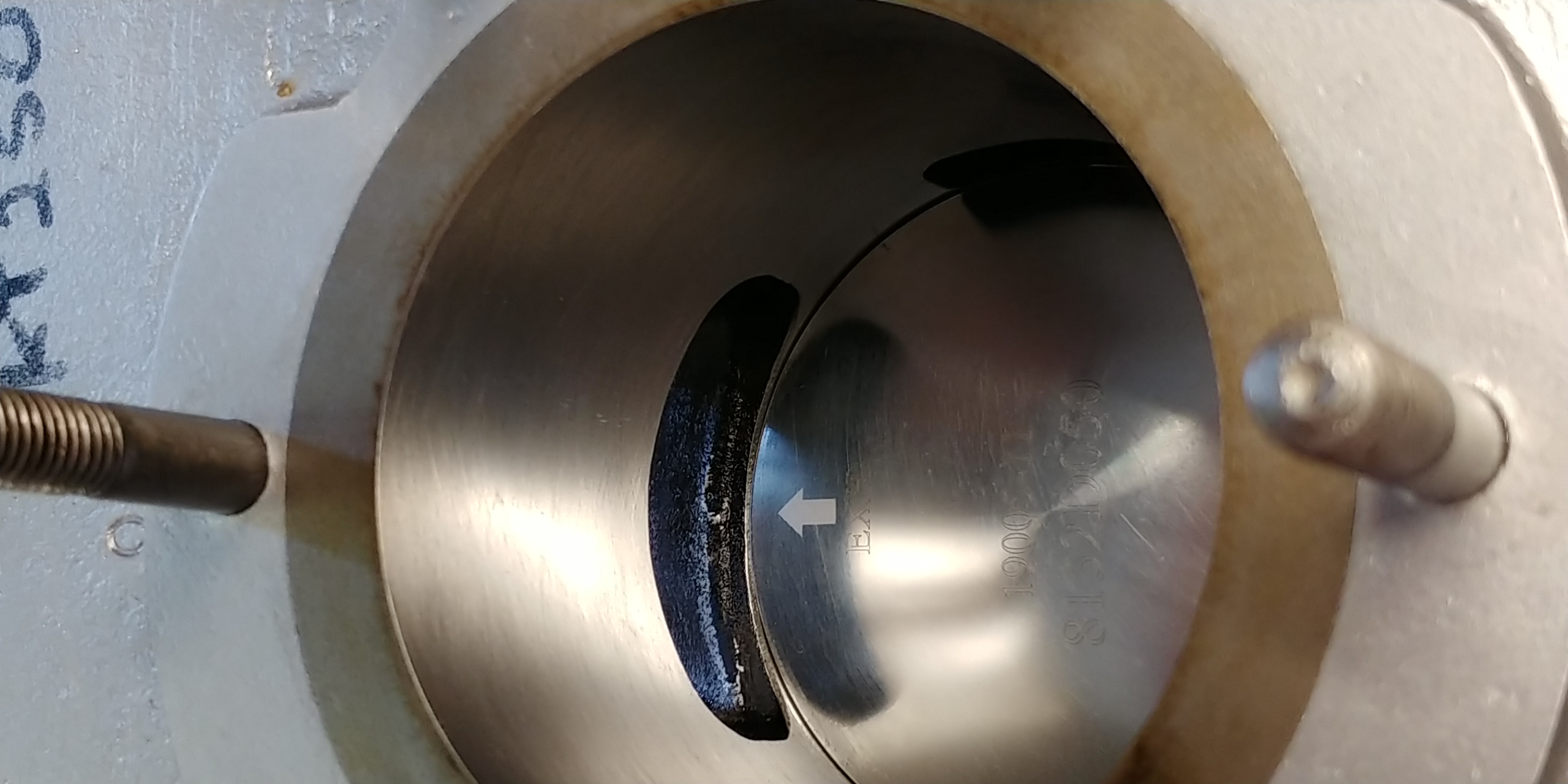

More KT engine internals
These photos are really just because I thought the new piston and the rebored
cylinder looked photogenic
cylinder looked photogenic- Attachments
- 20210227_143535.jpg (1.16 MiB) Viewed 1740 times
- 20210227_144247.jpg (1003.97 KiB) Viewed 1740 times
- 20210227_144326_HDR.jpg (786.5 KiB) Viewed 1740 times

Its interesting that the pretty new piston has an arrow to show you which way it will make the bike go.
