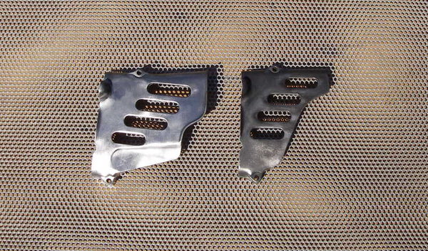

Peter, we had a great weekend riding the SQTA 2 day at Benoble and both of us were impressed with your TL125. Donna learnt to ride on her TL125 which still comes out occasionally. Thankyou for helping her walk some sections and your advice. As discussed, I may be able to help you with a sprocket cover, below is a photo of both types. Do you or anyone know someone who does sandcasting? Either or both could be used as a plug, if anyone else wants one, maybe get a batch made?

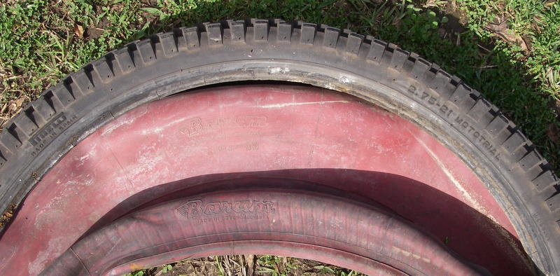

Had some time to work on the Bultaco, the tyres were so hard I had to cut them off. Does anyone know if red tubes and Pirelli MT08 were standard fitment?

Thanks Greg I will look into sand casting options. It was a pleasure to help Donna while you were misplaced and riding at SQTA events is always great day out.
Sand cast TL125 sprocket covers are being made here in the UK. Unfortunately though the person making them seems to have used an OE cover as a core for the casting, which means the finished covers are too small due to no allowance being made for shrinkage (1.5%).

Peter and FM350, if we find someone to sandcast some chainguards, we will need to build up original and fill the mounting holes. That way we will allow for shrinkage and finishing the surface and drill the holes later.

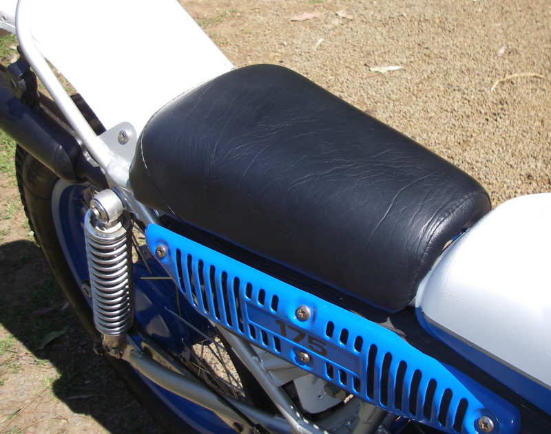

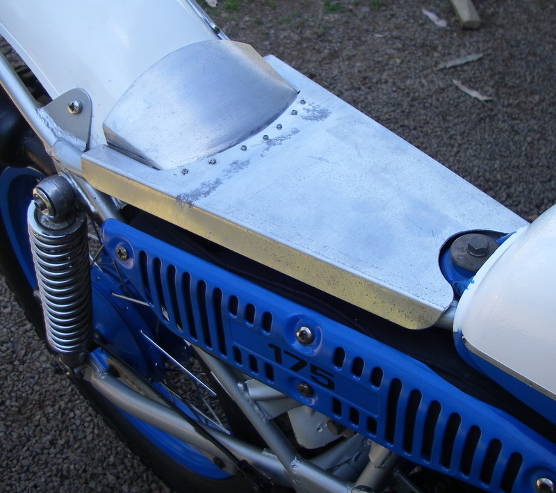

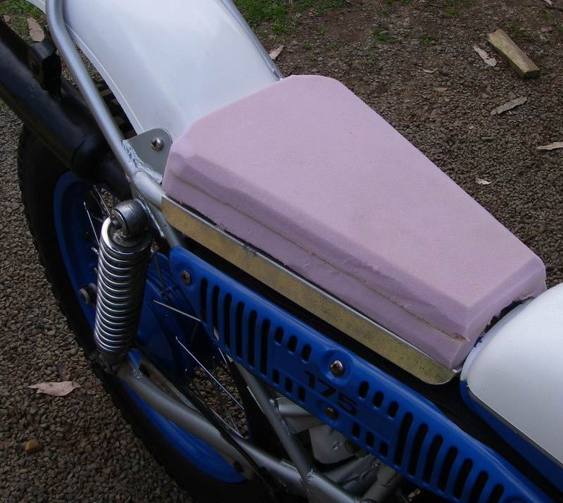

One of the things that I was unhappy with on my TY Challenge bike due to last minute preparation was the seat. Decided to make my own and save some weight at the same time, this is my first attempt and shaping foam is easier than I first thought. Fabricated the base in one piece of aluminium incorporating the mounting legs, shaped and riveted the curved piece in place which stiffened it a lot. Then shaped the high density foam with a grinder, the rest was finished by an upholsterer.

Top notch seat mate - lighter than standard and very comfortable. I expect that you would have no trouble selling them should you want to make some more. I also like the neat brackets to suit Gonelli rear guards.
