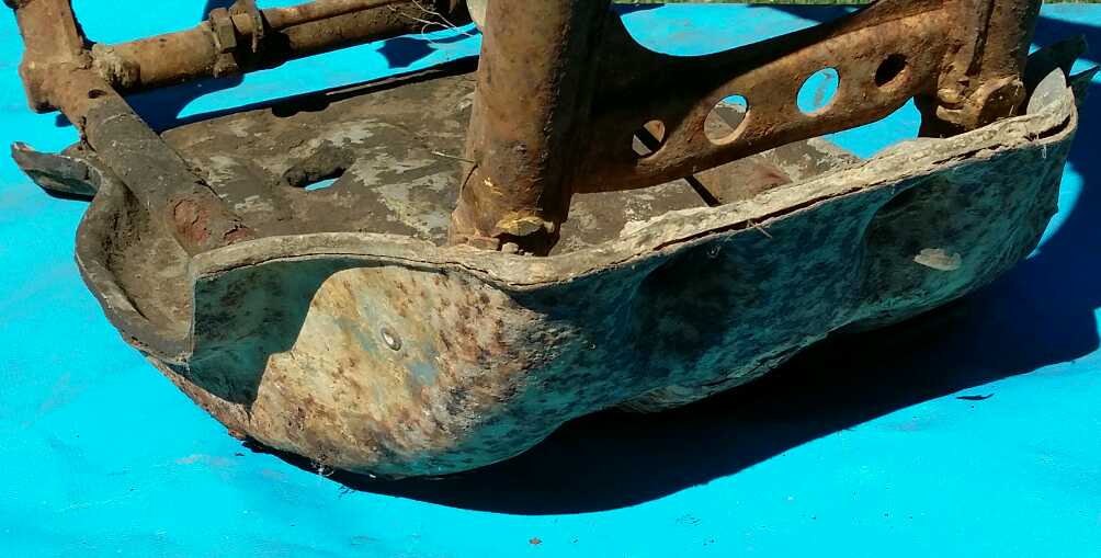

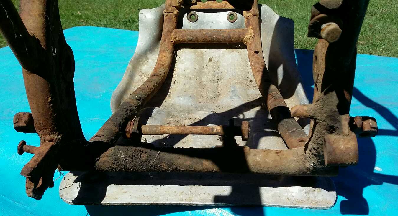

Here are some more photos of that :yamaha "A" model, I am not sure why either as it seems to be :
"What the hell were they thinking?"
On closer inspection, there are holes through the tubes presumably to mount a new bashplate and there is the age old argument that there should be frame tubes under the motor, what poppycock! Maybe the plastic/sheet metal bashplate failed and they wanted to start fresh?
You are right Mark, it has added weight and reduced the ground clearance by at least 20 mm......

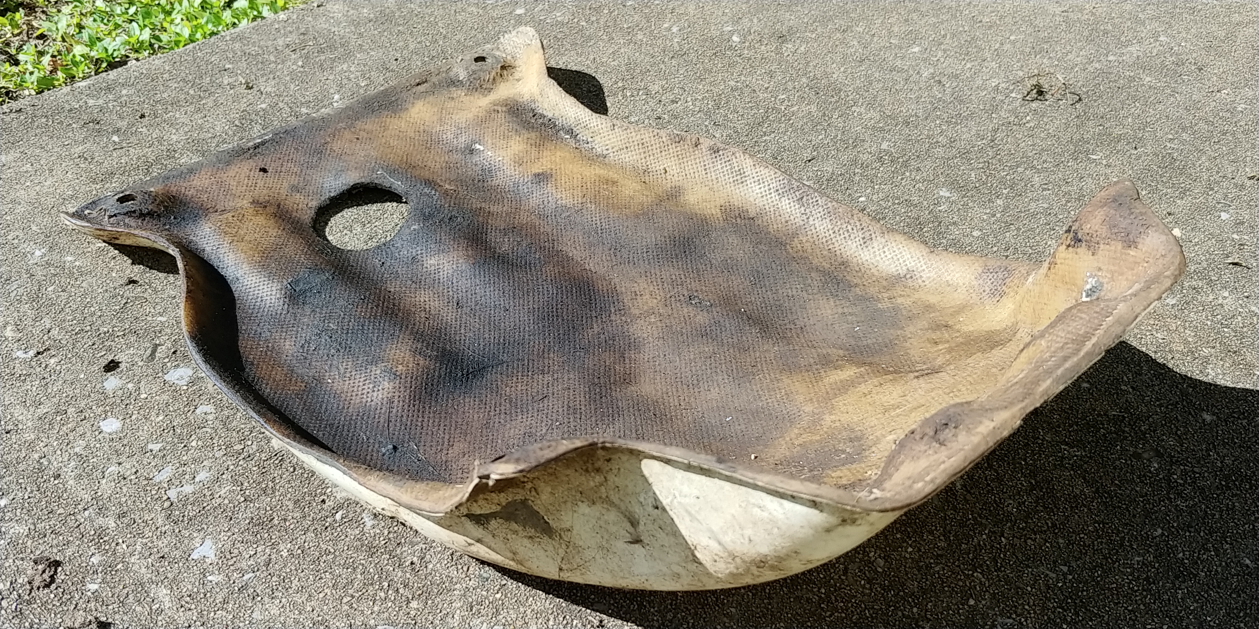

Greg I agree with your logic about why they fitted tubes under the engine after the original bashplate falls apart.

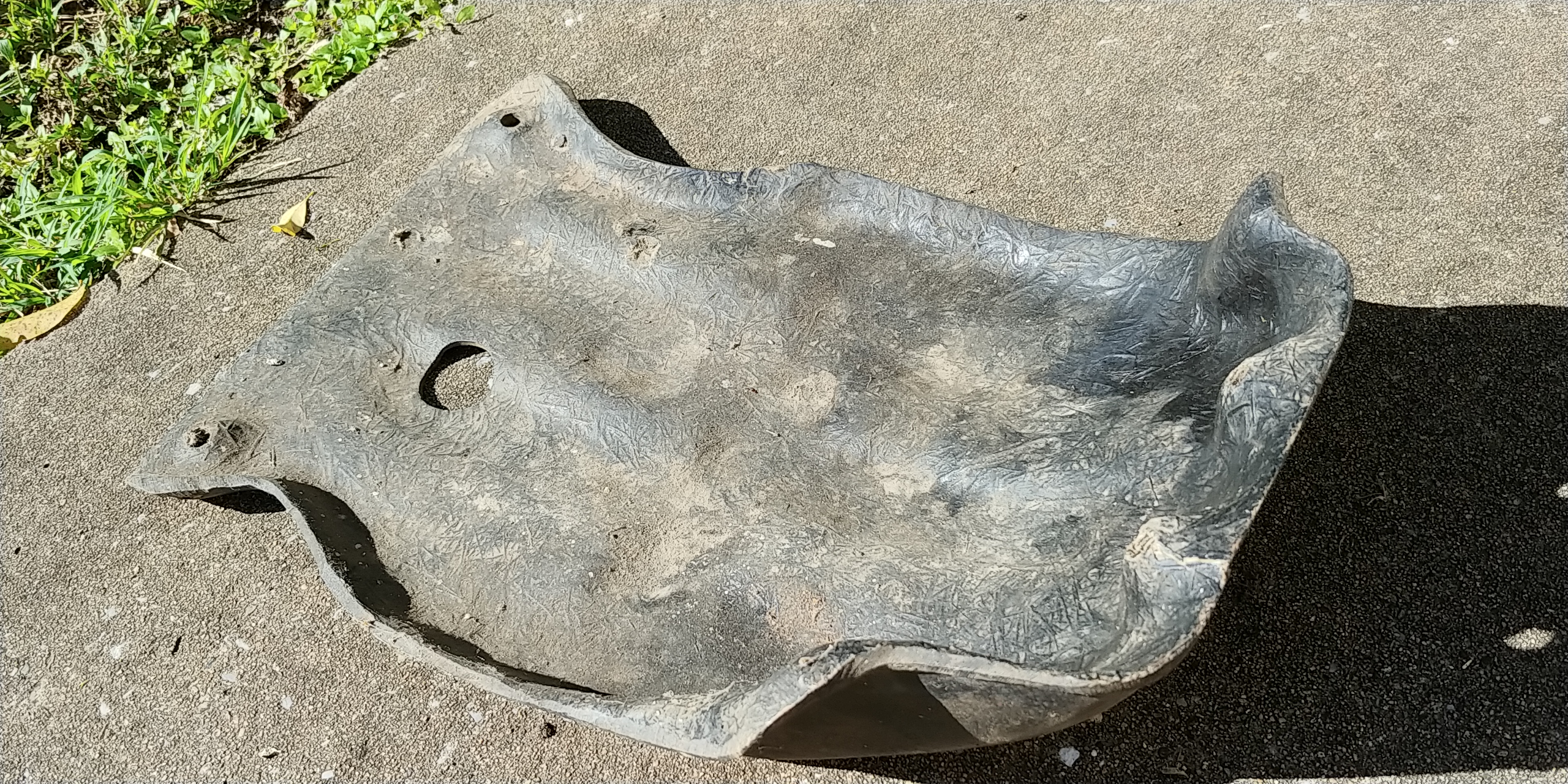

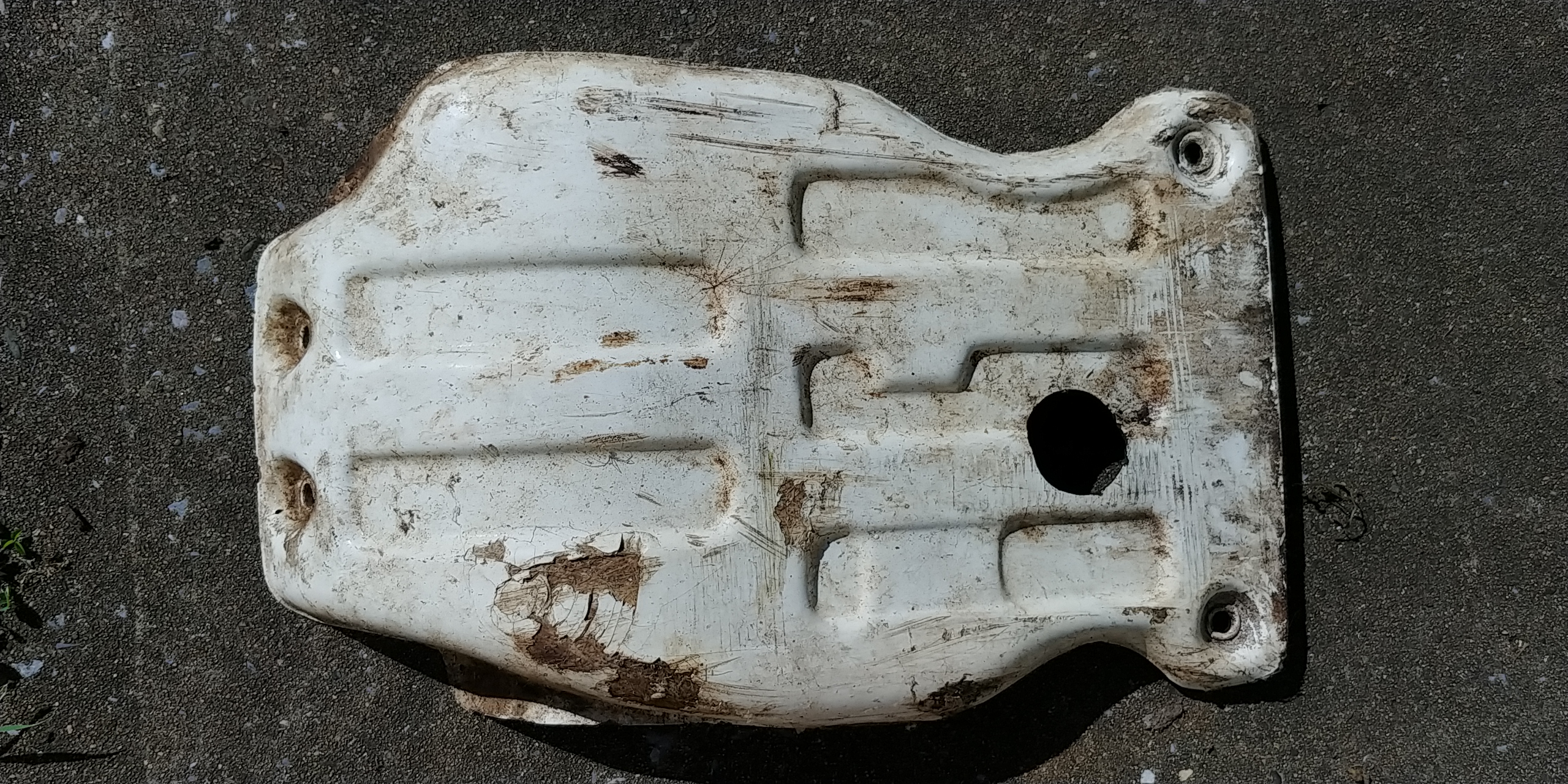

You mention the metal-clad fibreglass bashplate being fragile. What about the first version that was just fibreglass which would have had an even shorter service life?

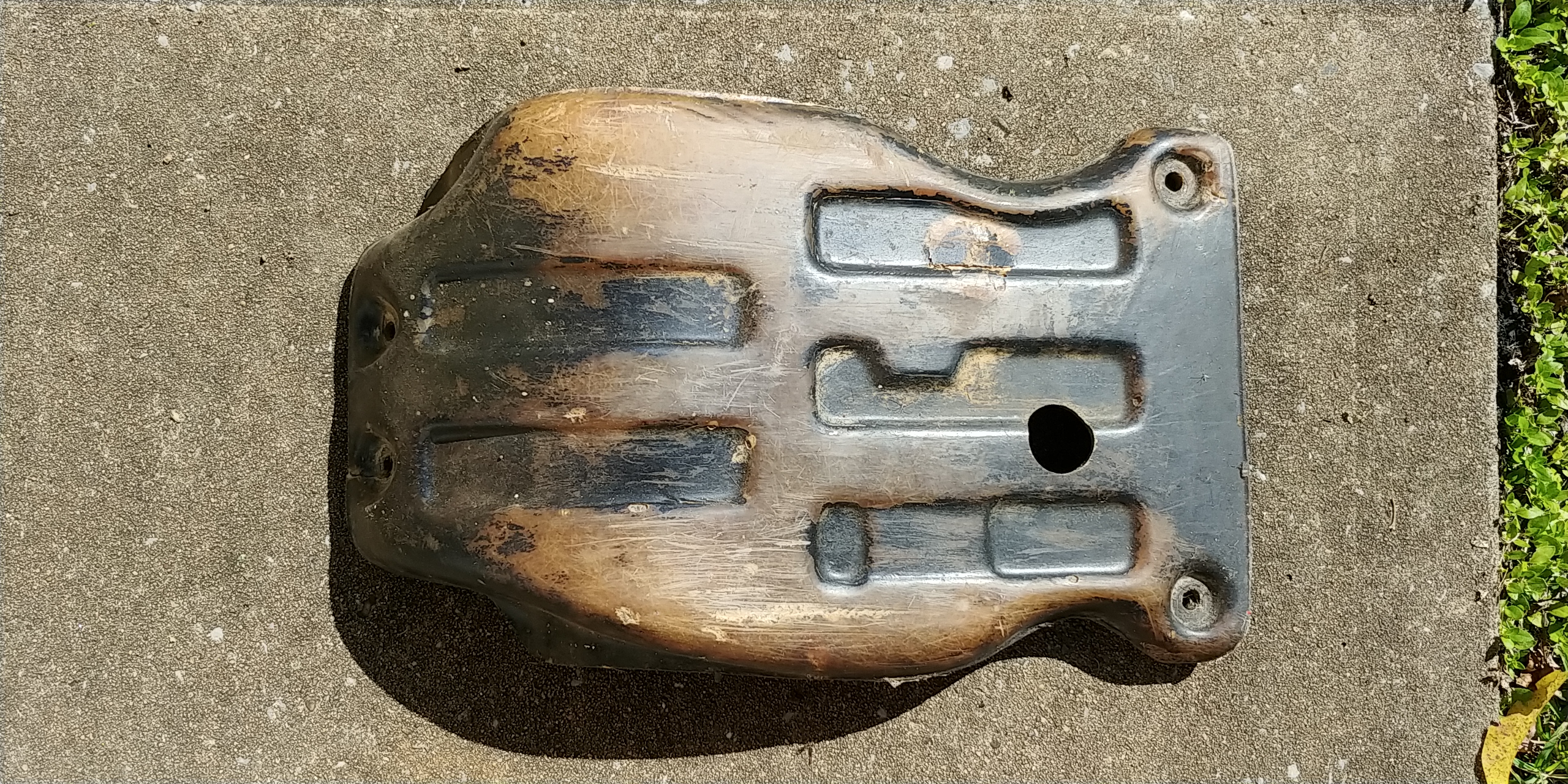

This :yamaha TY250 bashplate is a home-made copy of the original made of super thick fibreglass and has survived pretty well.
It came fitted to a :yamaha TY250B I bought in the late 1990s that also had a lot of other home-made things so I'm thinking the owner was fairly creative.

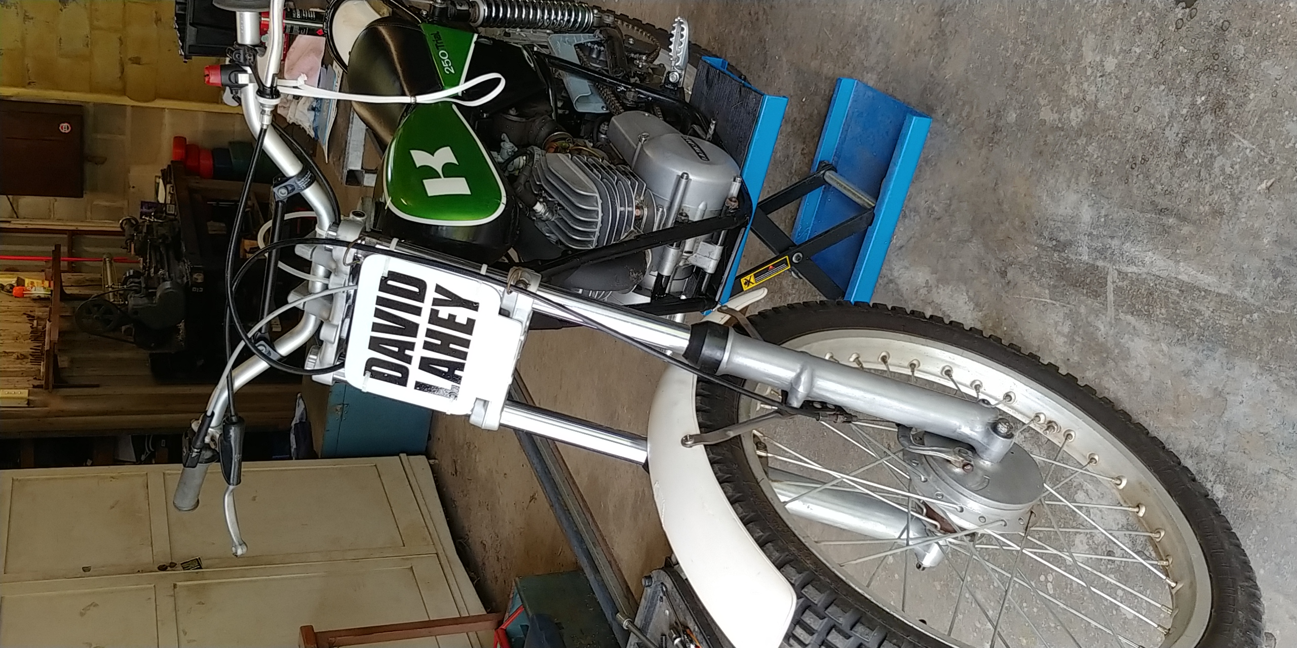

Kawasaki KT250 recommissioning
This :kawasaki was a basket case about 20 years ago. Well not exactly a basket case, more of a scattered around two chook sheds, a cane farm workshop and the previous owners place of employment where he had accidentally left the carby in the ultrasonic cleaner.
A few months later it was rideable and this marked the beginning of 20 years of experimentation and restoration. Still not fancy all over but nice enough to look at and very nice to ride.
I've just put it together after rebuilding the motor, modifying the frame, modifying the forks, relocating the footpegs, painting the frame, making the rear wheel look fabulous and fitting new tyres. It sat completely disassembled (including the motor) for about 1.5 years so it was a bit of a challenge to reassemble it.
I took the photo to show the name board to the friend who made the lettering for me but might as well put it up here to add some :kawasaki flavour to the forum

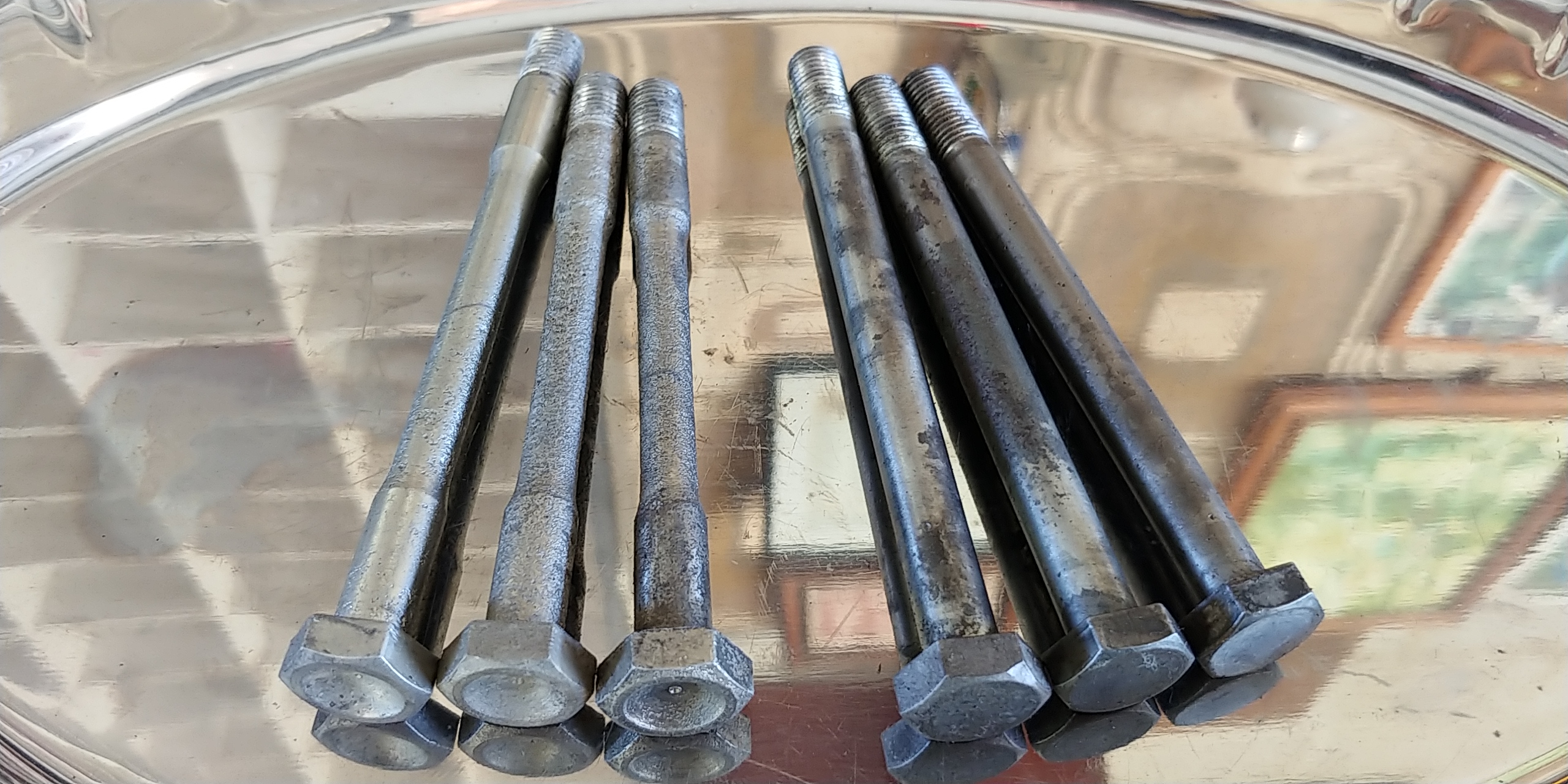

another Yamaha trivia post
Here are two sets of :yamaha TY250 twinshock engine mounting bolts.
Today I am doing an engine swap between two twinshock TY250s and noticed the difference in the bolts. One set has hollowed heads and waisted middles. Both of these things are standard weight reduction methods found on many bikes.
My question is (and I don't know the answer) which model TY250 had the lightened engine mount bolts as standard?
I've done way too much swapping around of TY250 frames and motors to remember which bolts originally came with which bike but I seem to remember that my TY250A which came to me in a very original state had hollowed head bolts here and there (on the handlebar clamps and the upper fork tube clamp bolts) so I'm leaning towards the lightened bolts being from an A model TY250.
Can anyone confirm this theory or provide an alternative answer?

I can check for you, though not until this weekend David. I have a few A models that have never had the engine out.

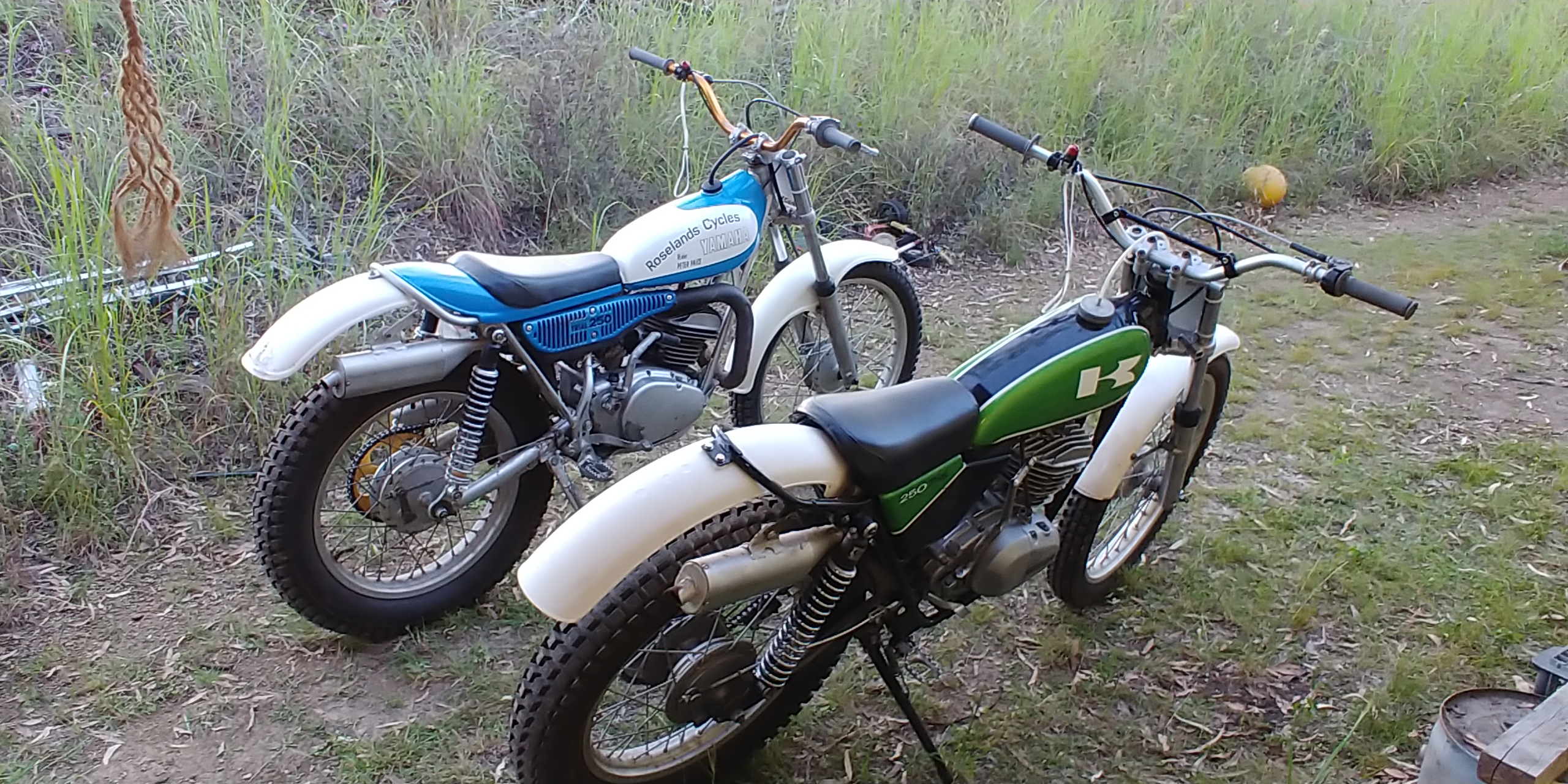

Thanks Alastair
I had today off work and did a motor swap in that :yamaha . The A model motor that was in it started making a funny noise so I pulled the cylinder off and had a good look at things. It needs a rebore and a new conrod kit and I'll probably post up some photos later of the interesting things that I found inside.
I also fitted the blue Peter Paice Replica tank, seat and side covers, which better match the look of the B model engine.
The :kawasaki is now run-in and ready to ride trials on.
This coming weekend is a local trial and I'm still deciding which bike to ride.
