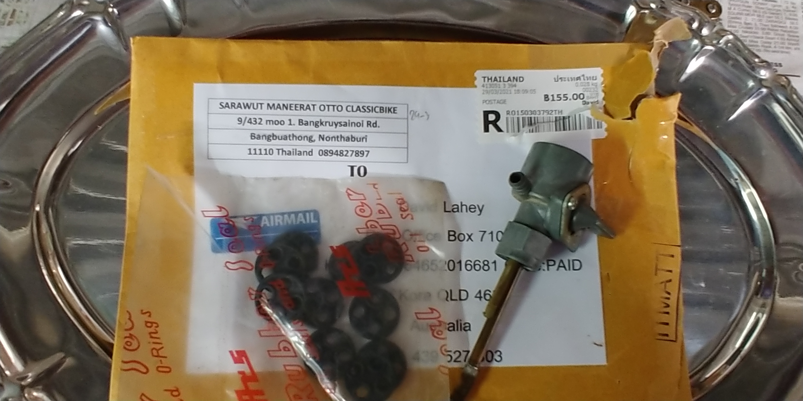

I reckon the standard fuel taps on :yamaha TY twinshocks would have to be the least reliable part of the bike, well the rubber sealing washer inside anyway, the rest of the tap is OK.
After paying good money buying genuine :yamaha sealing washers that were probably made in 1975 and having them last about a week because the rubber has deteriorated in storage over the years, I bought a few genuine :kawasaki KT250 fuel taps which do a great job and last a long time. Since then, replica :kawasaki KT250 taps have become available for not many $$$ and I've bought and used some of them too.
Trouble is, they look very different to the :yamaha TY twinshock taps.
Recently I decided to try some aftermarket TY tap sealing washers from Thailand and give them a go. I reckon they have been made a lot more recently than 1975 so it will be interesting to see how they go.

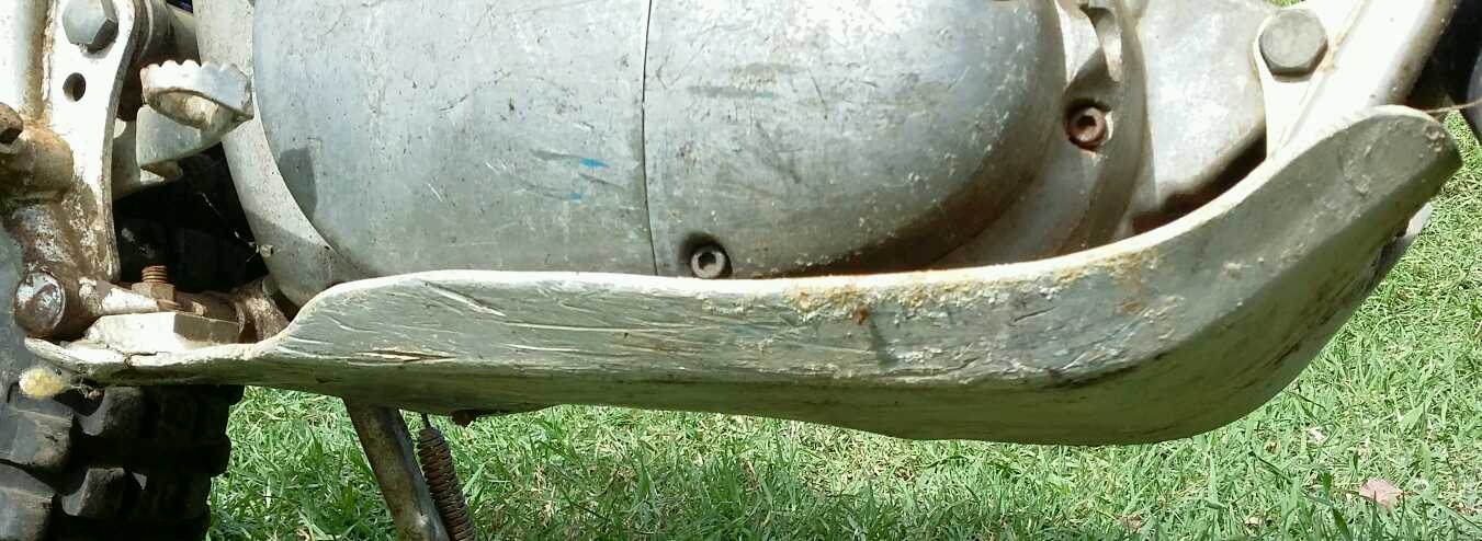

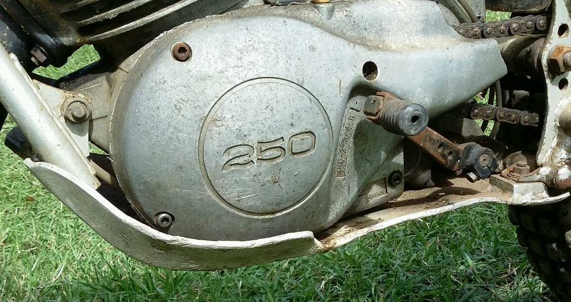

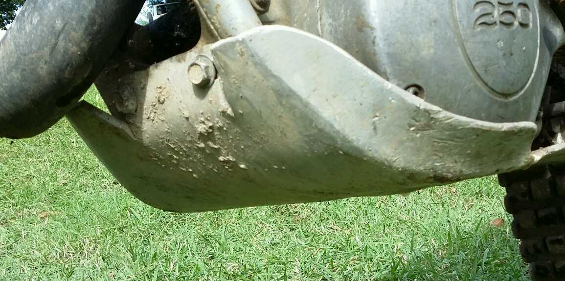

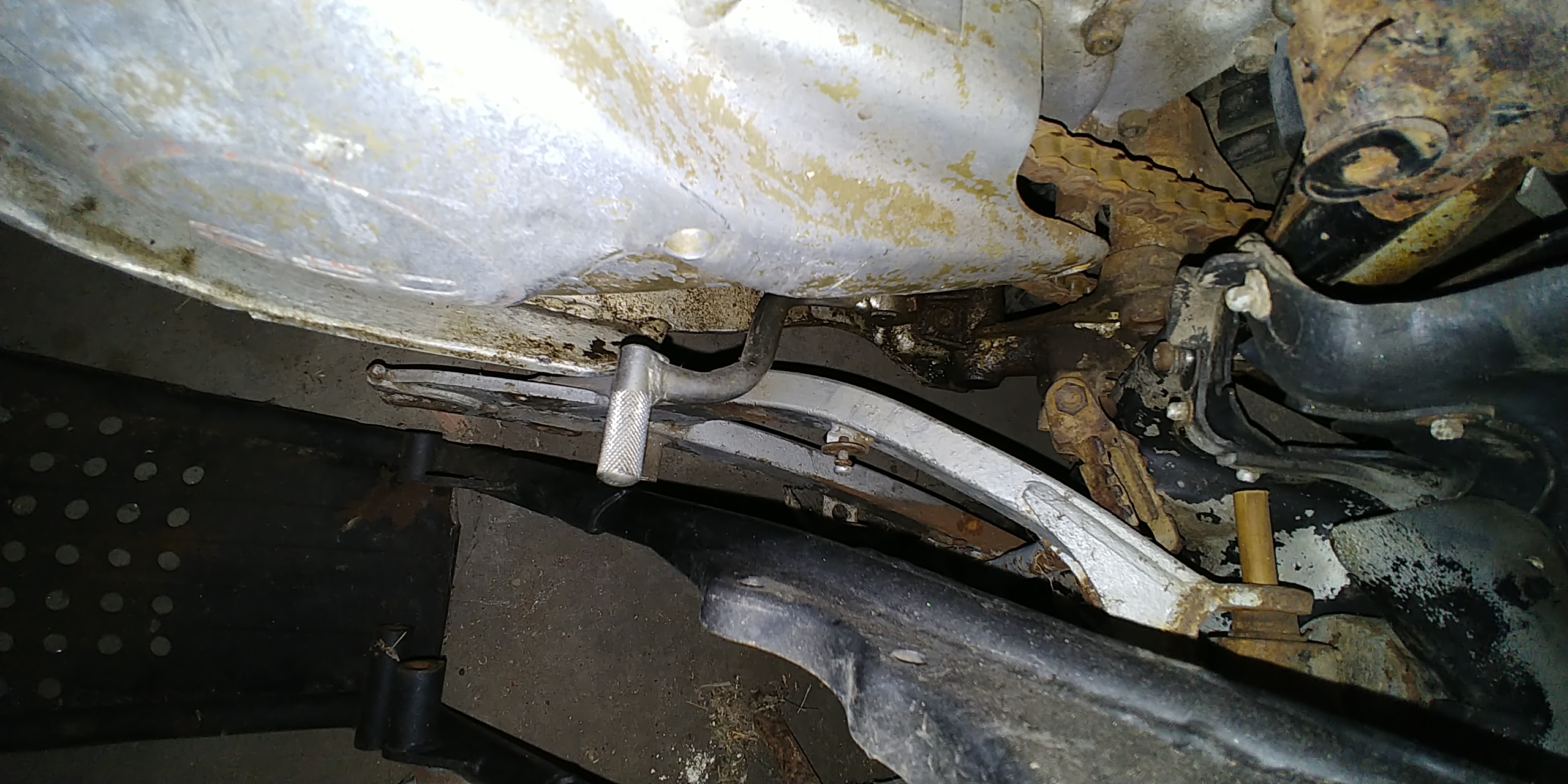

Here are some photos of the custom bash plate on one of my "A" models, Alastair might recognize it?
It certainly does the job well when you consider the gouging and the deformation under the gear lever, then look at the casings. Not sure what grade of alooooominium was used but I think it must be 5005 which is fairly pure and soft. It always makes me laugh when components like this are offered for sale new and a grade is NOT stated as it pretty much means melted down Pots and Pans!
Recycling alooooominium is important as it take five times the amount of energy to make alooooominium out of raw materials than it takes to reuse. However if you are melting down Pots and Pans, you are only going to end up with Pots and Pans strength.
Here is a blast from the past as this is the "A" model with that bash plate that Donna rode at SHATTER. What a top weekend, we all need weekends like that one, thank you Alastair.

The stunning Allooooominum bashplate on my bike was actually made by fellow Shatterer Greg Henry ... from material supplied by Gary Boniface. I reckon David can find photos of it. Should there be just a little warning of an impending nuclear holocaust ...my plan is to remove it from the bike ... put it upon my head ... shut my eyes and hug the bike ... tightly.
Alastair
I reckon this is the same type of bashplate

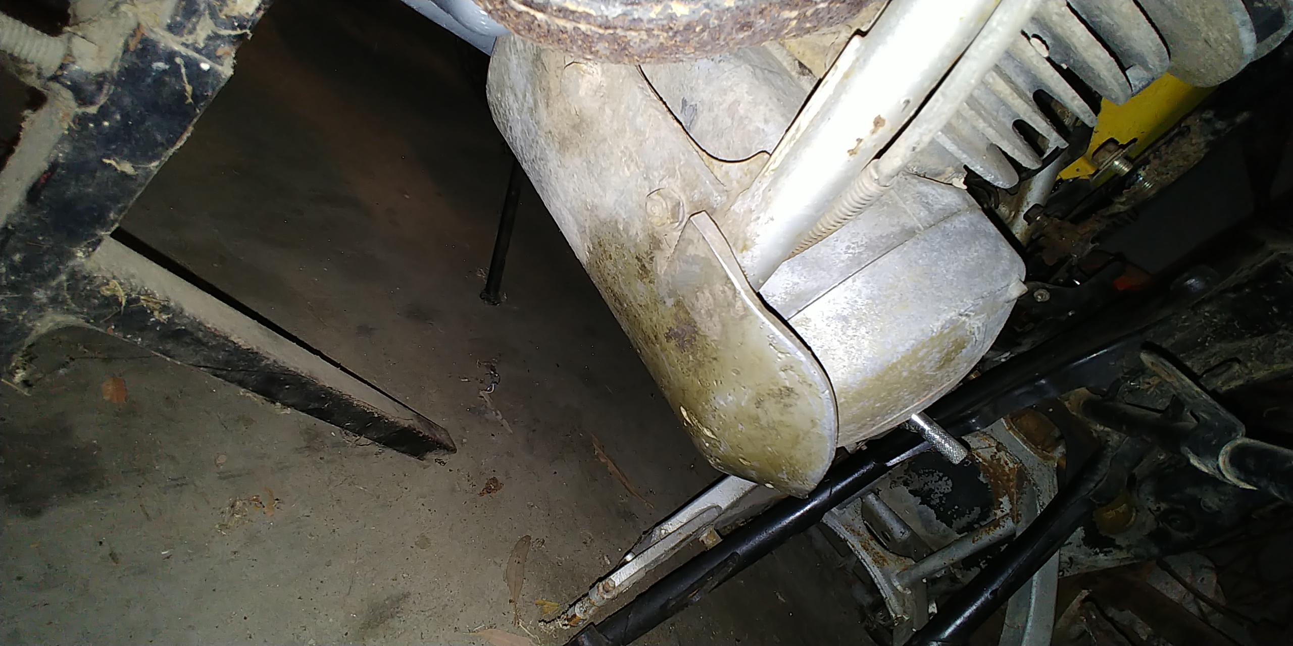

I'm also intrigued with the composite steel/fibreglass :yamaha A model bashplates. I'm assuming that the original ones were the fibreglass ones and the steel/fibreglass ones were a stop-gap measure until they finally bit the bullet and made the aluminium bashplates.
I also assume that the aluminium bashplates appeared when the B model engine outer casings appeared, because the aluminium bashplate is not a perfect fit against A model engine outer casings.

3 of mine have the fibreglass bashplate and the one with the magnificent Greg Henry bashplate originally had the fibreglass/steel bashplate. I've a feeling that the FSBP bike was late in the A model production run.
