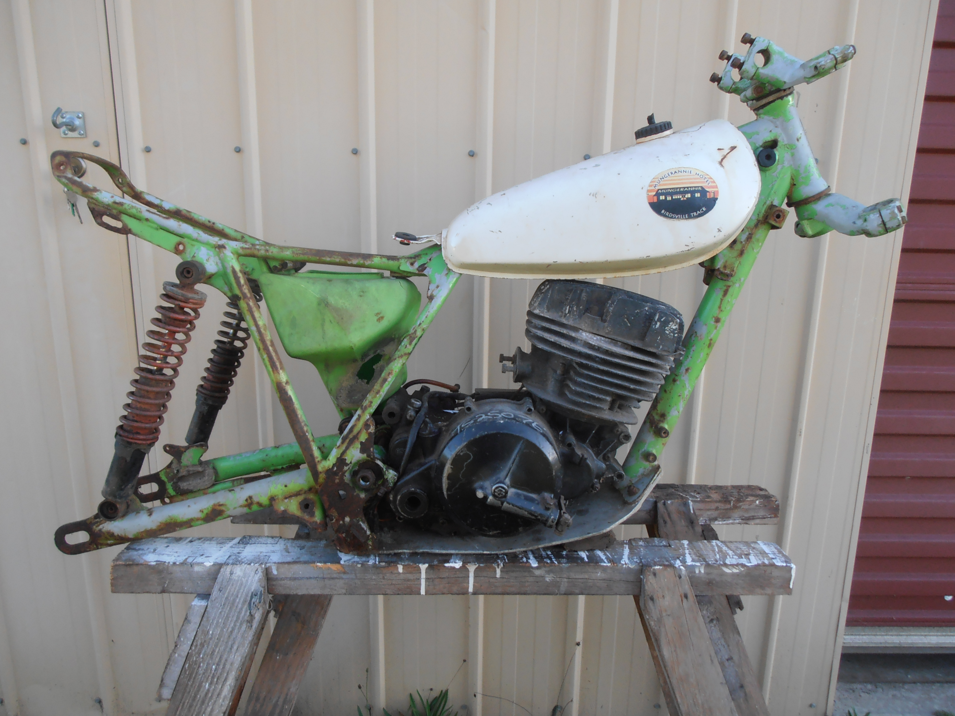

On another subject, I have had this project (below) in mind for some time. Found an Italjet frame in a small-town wreckers some time age. In my shed it was sitting next to RL and TS engines. Well the engine made its way into the frame and it's a good fit. (Though it's a TS engine in the pic, the RL engine is all-but the same.) The sprocket even lines up well with the swingarm pivot. Italzuki 250TRL??

JC1 your Italzuki reminds me of a similar project in my shed. I'm amazed that :suzuki motor fits in the space lengthwise, because a :suzuki motor is also a fairly tight fit in a Bultaco frame and I would have thought that the Ducati/Italjet motor would have been shorter than a Bultaco motor.

Very interesting, the :suzuki motor definitely fits in the :italjet: frame but the exhaust port looks a little close to the downtube and there is not much room for the exhaust below the tank ? That must be as labeled a TS 250 A motor with the exhaust port on the other side.....
Here is a comparison photo.....
