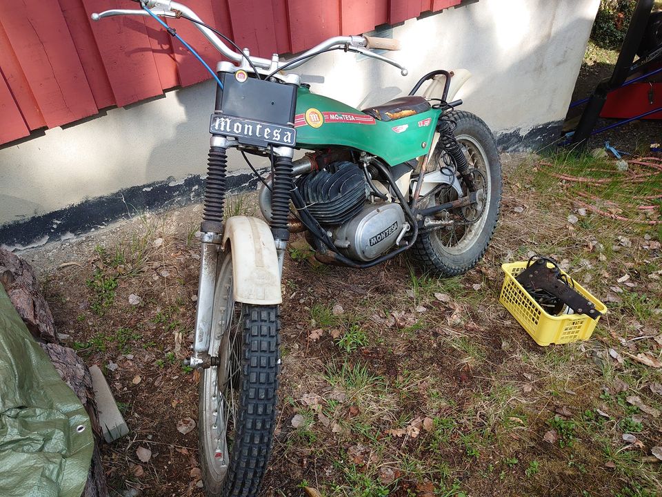

Green Cotas
Here's another green
Cota 172 Greg Harding. This one is in Sweden
Cota 172 Greg Harding. This one is in Sweden- Attachments
- 183549577_10225817746979876_5744577275690266768_n.jpg (210.9 KiB) Viewed 959 times
- 183537700_10225817748499914_3820934178976277423_n.jpg (469.03 KiB) Viewed 959 times

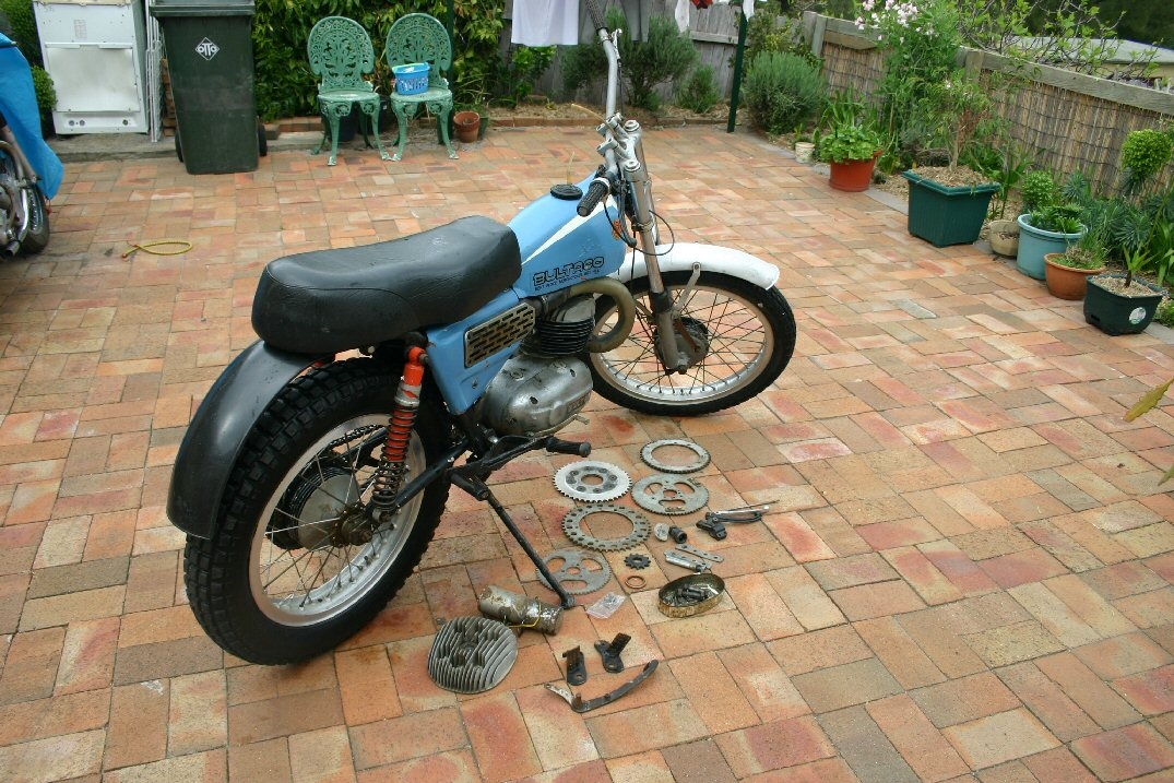

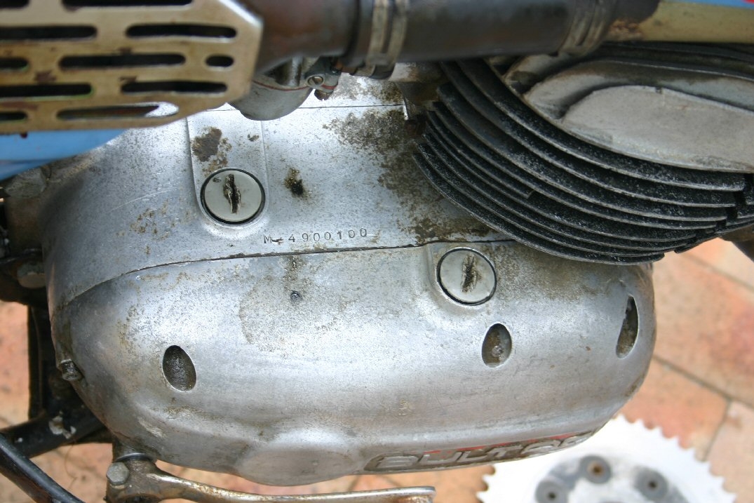

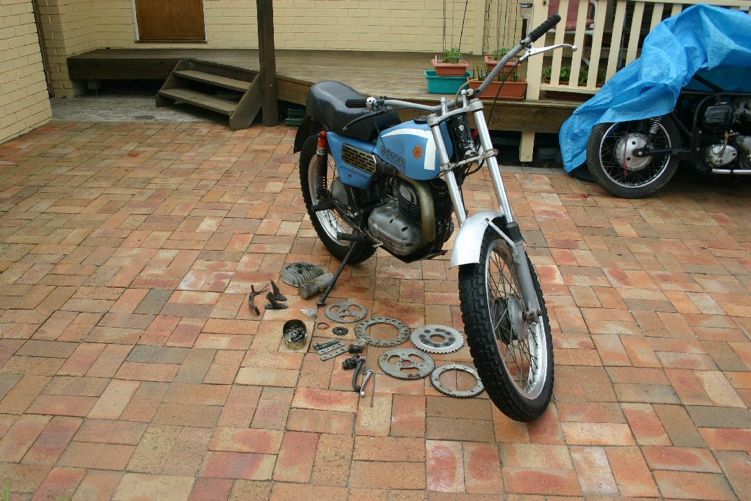

Model 49 with identity crisis photos for Robert Haigh
I promised to show Robert some "before" photos of my model 49 Sherpa T
Home-made dual seat with 3mm steel plate base.
Bent flat rear frame loop.
Huge support bar for rider and passenger footpegs.
Extended brake pedal to reach front footpeg.
Mk10
Pursang paint scheme. Can't see the 3mm thickness of spray putty under it.
Speedway handlebars.
Gas KONIs.
.Home-made dual seat with 3mm steel plate base.
Mk10
Pursang paint scheme. Can't see the 3mm thickness of spray putty under it.Speedway handlebars.
Gas KONIs.
- IMG_0789a.JPG (529.92 KiB) Viewed 924 times
- IMG_0788a.JPG (412.67 KiB) Viewed 924 times
- IMG_0787a.JPG (574.06 KiB) Viewed 924 times

Interesting engine # on the M49 Dave
