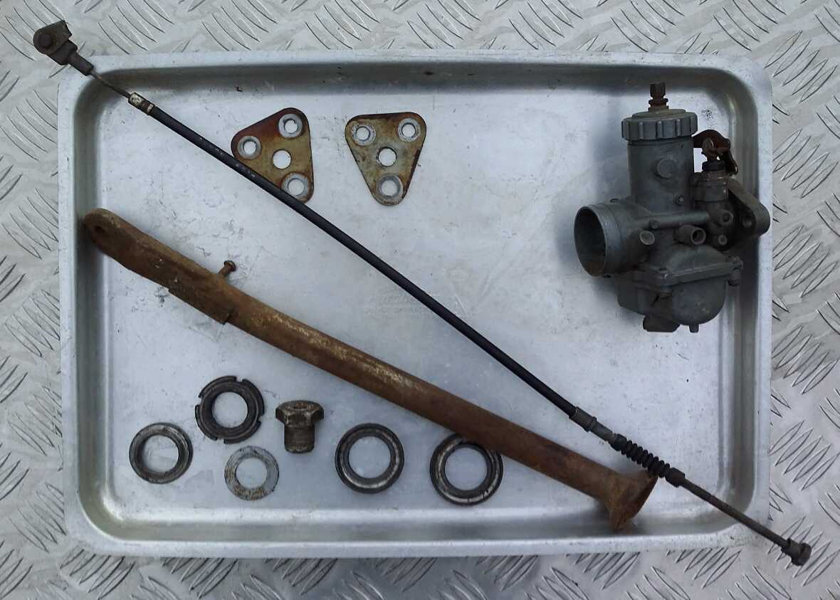

John, here are photos of the parts you have requested:
Since those photos were taken, I have had a bit of a rethink and here is a photo of some other parts I think you will need to build a complete :suzuki RL 250:
If you are happy to swap your eclectic collection for my :suzuki parts then so am I. It will be really good to see another :suzuki RL 250 up and running!
