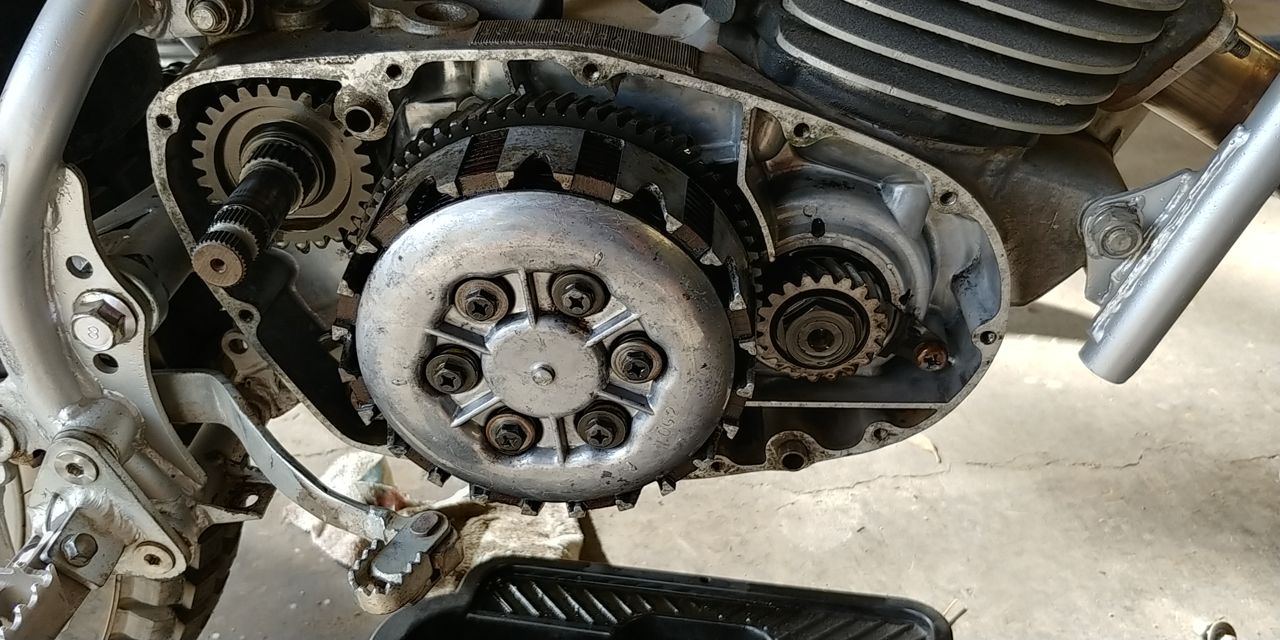

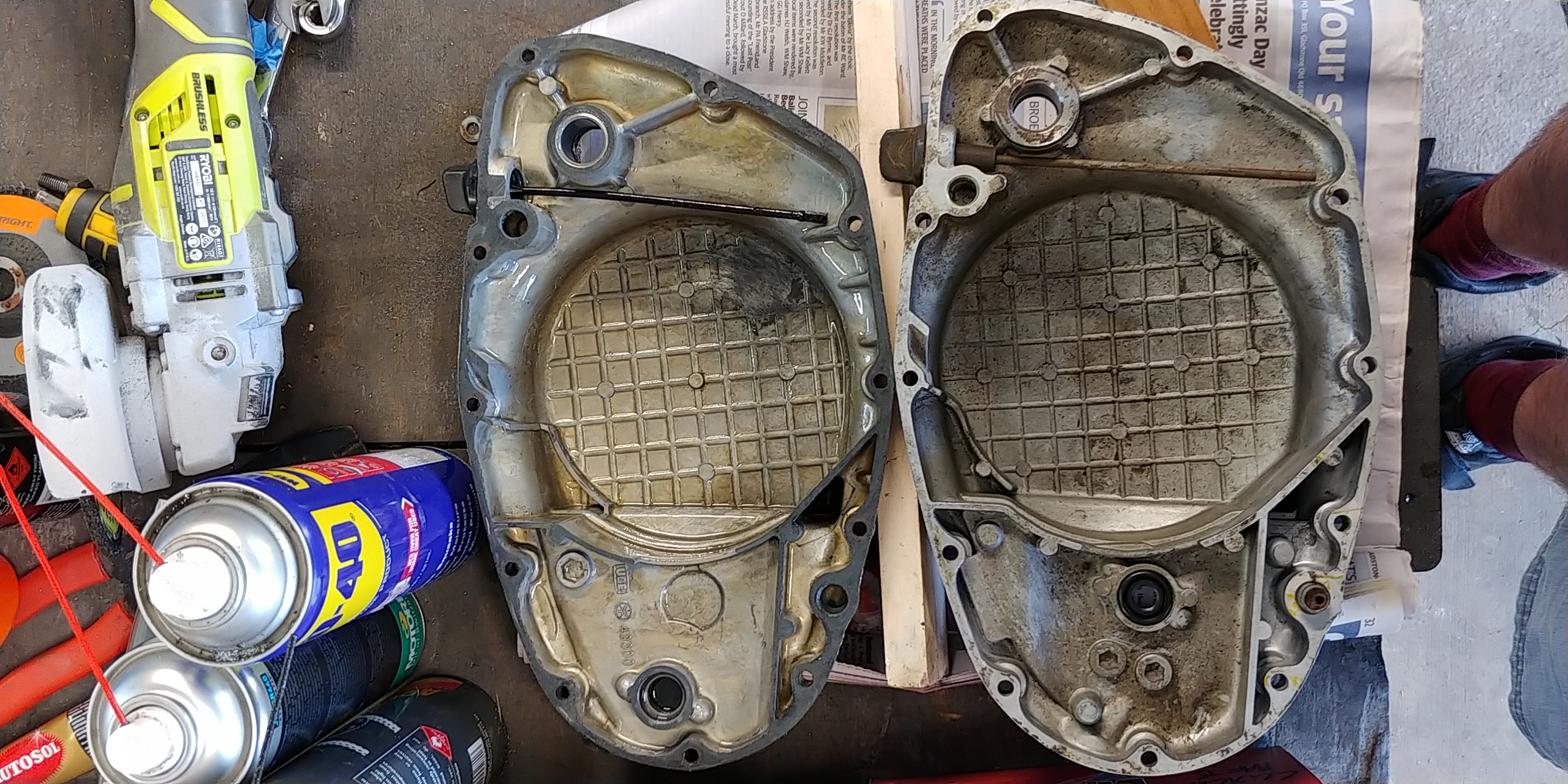

It never rains it pours. A couple of weeks ago I had to fit different clutch springs to my KT250 motor because when the motor was rebuilt it was then a bit more powerful and I had previously fiddled the clutch pressure plate force so the clutch had just enough drive for the old worn out motor.

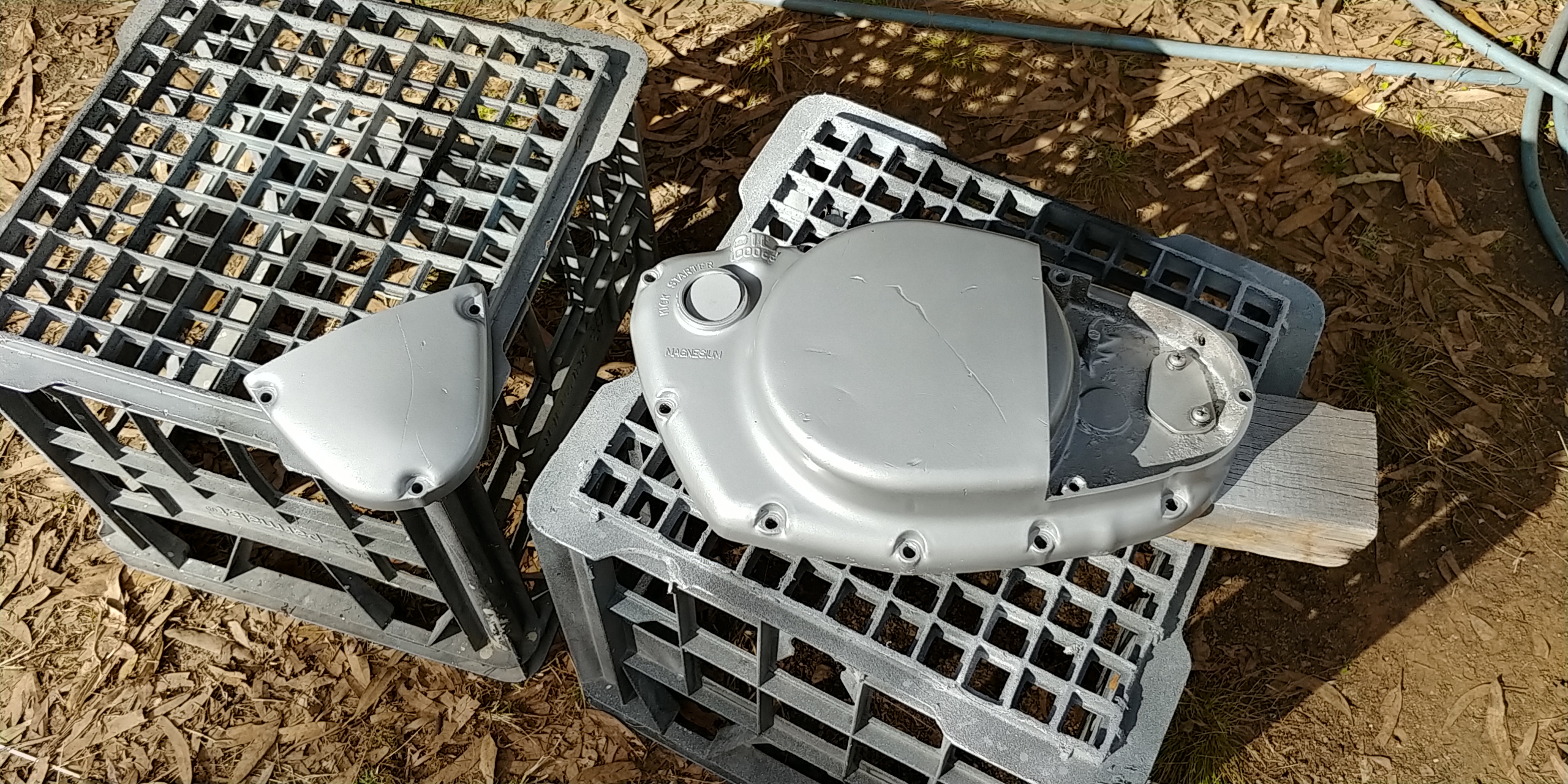

This time is a TY250B motor that I was running three clutch springs instead of the usual six springs. I fitted a WES exhaust and although it felt pretty similar in power to before, the clutch started slipping in 4th and 5th gear with very little prompting which was a bit annoying at a trial on the weekend where there was a nice little trail ride to and from the sections. So today (my RDO) it's back to six springs and repaint the clutch cover while it's off.

My original plan for the slipping clutch on my TY250 with the three clutch springs was to fit all six springs. However the paint on the clutch cover took so long to dry that it gave me enough thinking time to decide to do it differently.
I've now fitted brand new Yamaha friction plates and four clutch springs.
I've got to the desperation stage with the paint and if this doesn't make the paint on the clutch cover go hard, I'm going to strip it off and paint it again with different paint.
