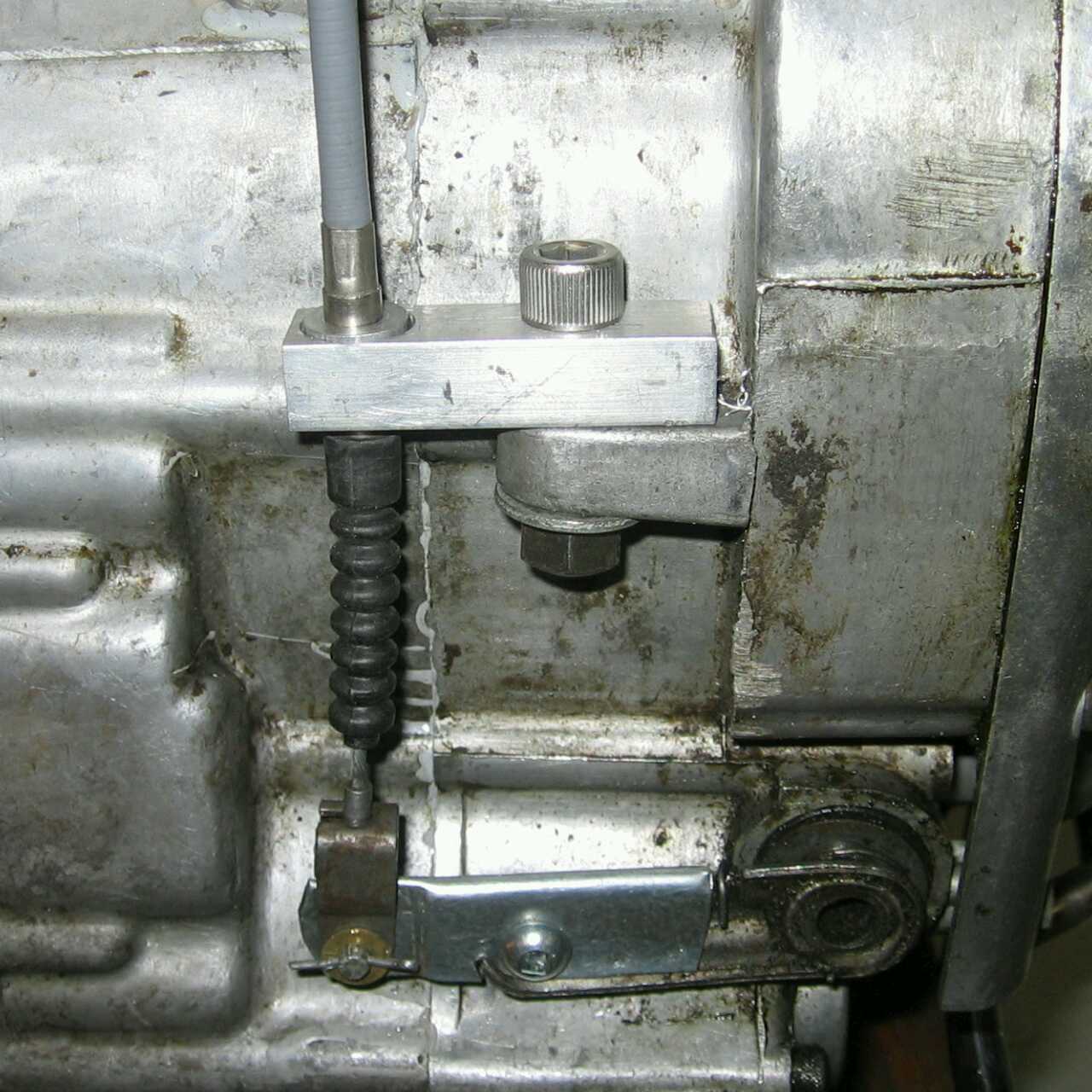

David, is the actuator under the motor standard or longer ?
Guy

I use a standard actuator arm and a high ratio hand lever.

The actuator modification is simple, I don't know how to post picture, it's really worth a thousand words.
Guy

Yes it's better to increase the leverage at the arm as you described, than to increase the leverage at the hand lever, because the tension on the cable inner is less with the increased leverage at the arm, which reduces the friction of the cable.

The actuator modification is simple, I don't know how to post, it's really worth a thousand words.
Guy
Happy to help out.

Wow, that’s lateral thinking :D
Super simple, well done =D>

Hey Greg.
Thank you so much for posting that photograph.

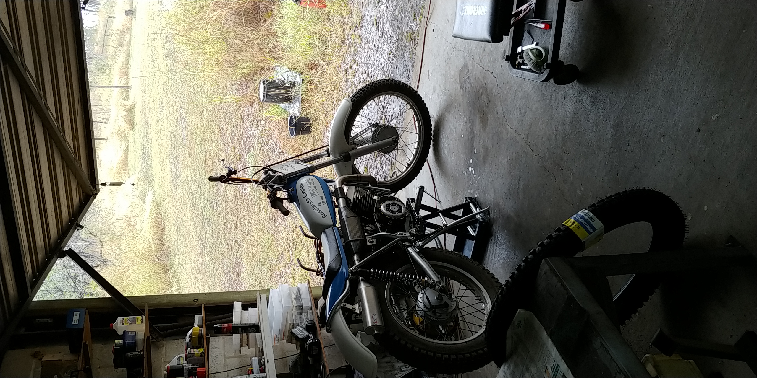

Bike prep for this years Qld Twinshock Titles
Posted: Sat Jun 26, 2021 2:01 pm
in 2019 I was crippled by Ross River virus and could barely hang onto the bars but did have a ball riding at a low level at the Twinshock Titles at Tony Bax's place at Lowmead.
At the same trial in 2020, I had a broken finger and again couldn't grip the bars but had a great time there as an Observer.
This year, so far, my body is going well so I'm fairly motivated to do my best at that same trial which is on in a few weeks time.
Today it's raining, there's no trial on and I'm batching so the bike I'm planning to ride at Baxy's place is getting some serious workshop attention.
