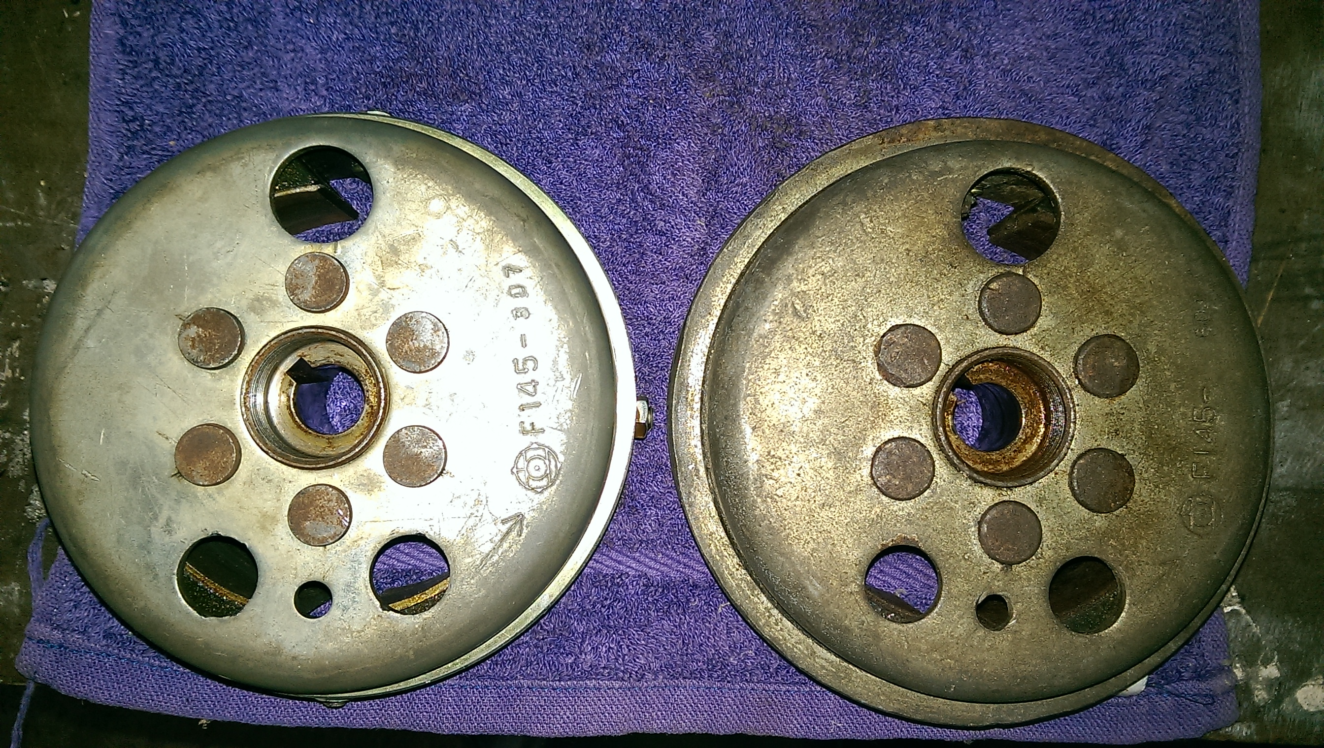

The left flywheel is TY250A and the right flywheel is TY250 BCDE
more for Ray Vinton
Posted: Mon Jul 19, 2021 10:16 am
Ray this is to show how much/little I've trimmed the width of the steel band on a TY250B motor flywheel
Keihin versus Mikuni THAhhhhh
Posted: Mon Jul 19, 2021 10:18 pm
David, would it be a fair estimate that is about halfway between the "A" and "B" model flywheel effect? It is something that I have considered as both original options seem to be either side of what I would like.

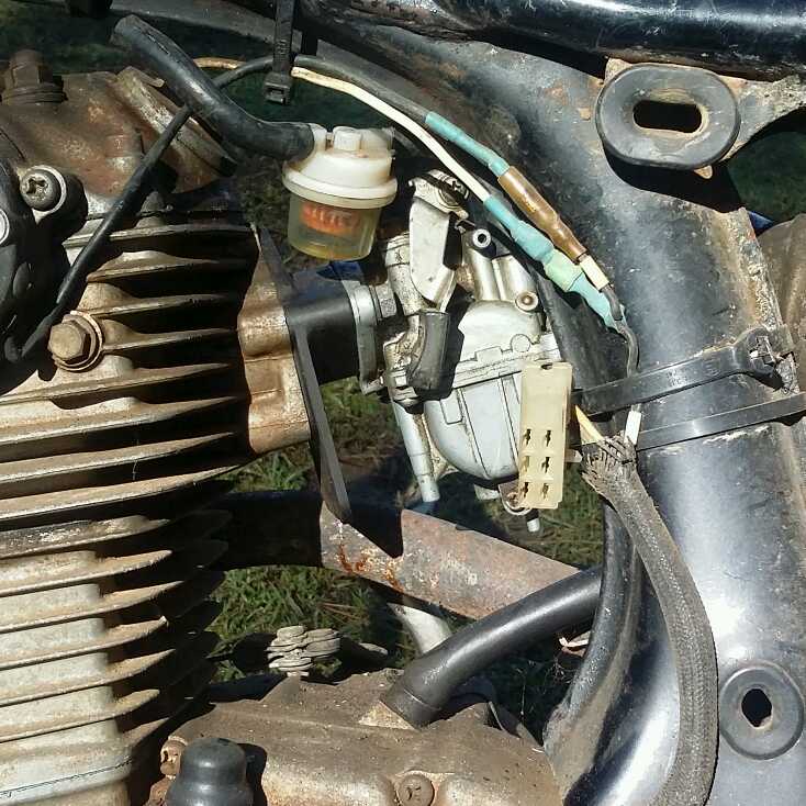

It came to me with the TLAhhhhh, there was no inet manifold, no original Carby and an incomplete air cleaner. Just this 22 MM Mikuni and neither I or the previous owner know what it is originally off:
It interests me as it seems to not be common, two whole aisles at the wreckers dedicated to carbies separated into different makes, 2 and 4 stroke and even large and small but not a single one of these. The industrial supplies had a huge assortment of springs but none suitable! The 3rd bike shop I asked had a spring that fits so now I can try it.
Up until now I have been using to carby on the left off the BLOODY :honda:, as it is identical. The only difference is the 200 has a 98 main and 250 has a 100 main jet. My problem is I can't have both bikes ready to ride if they share a carby. The other problem which I can't seem to tune out is the variable idle and iregular smoothness off the bottom.
Yes I think so Greg and it is indeed "Mama Bear" for me too

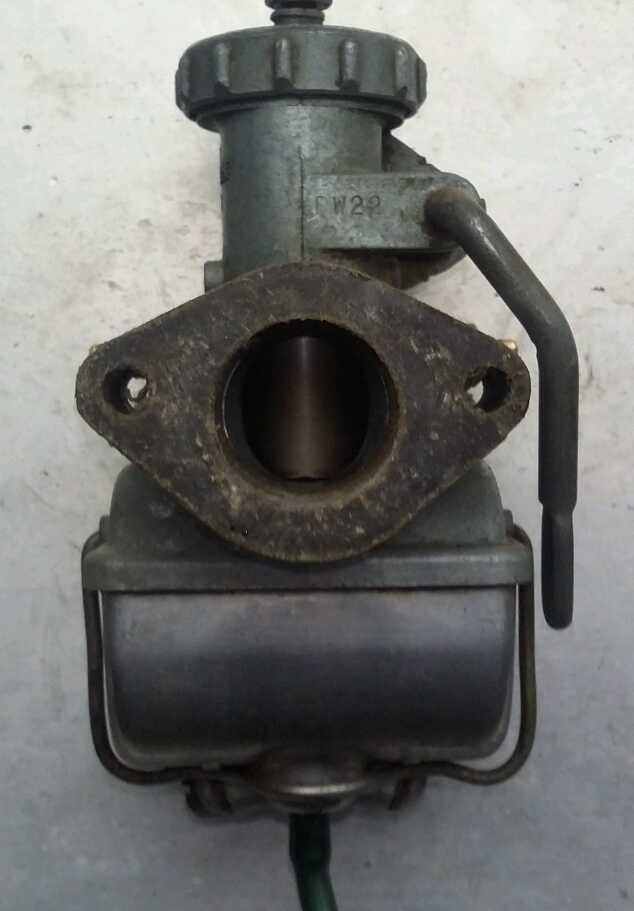

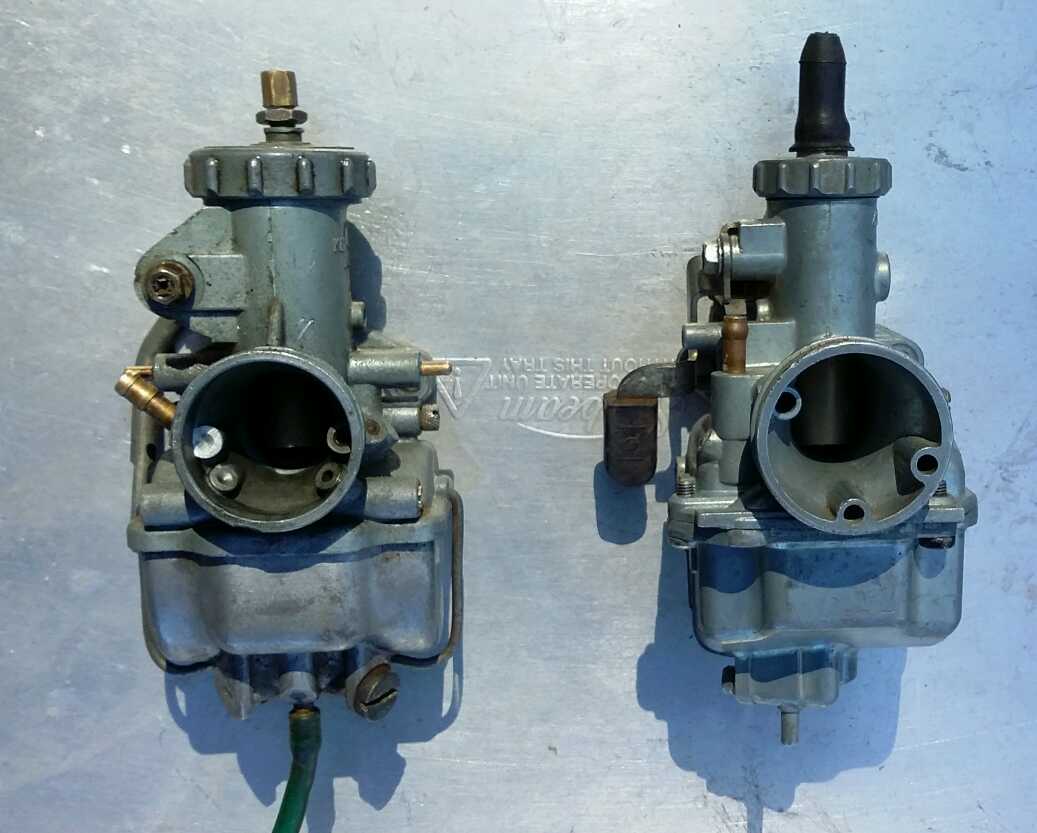

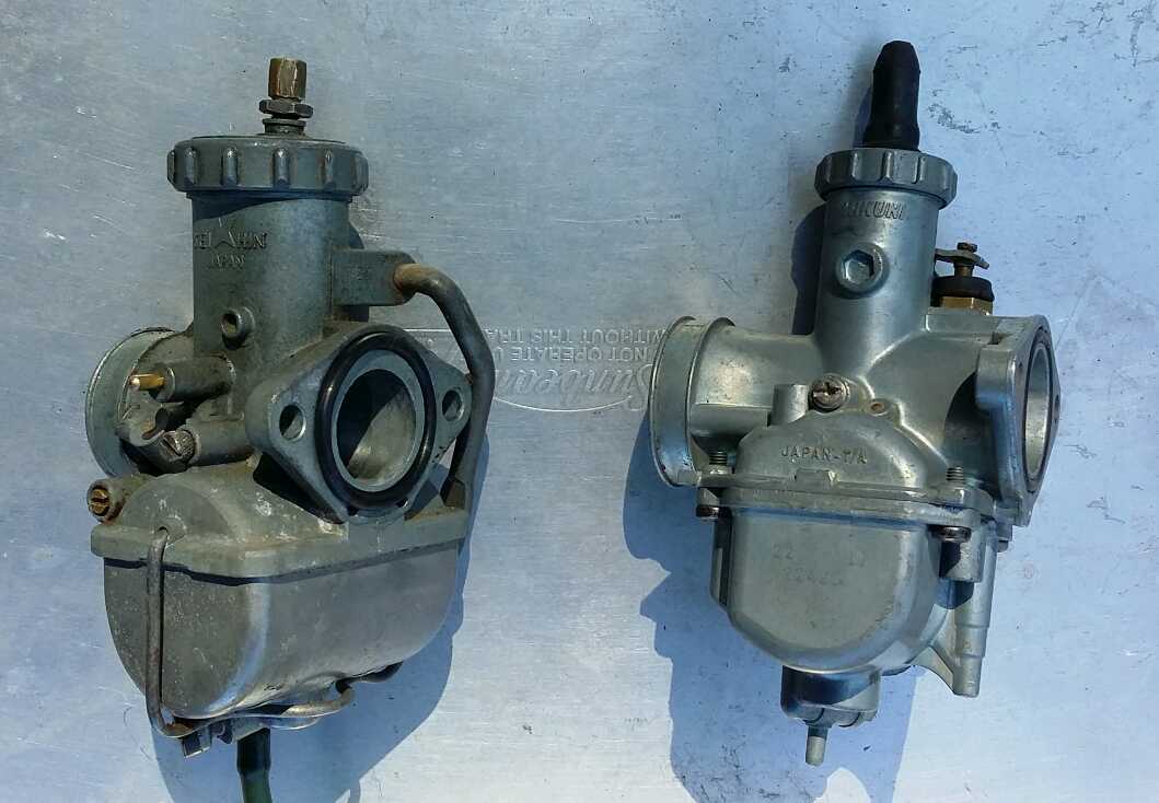

Also Thankyou for the link to Mikuni carby David, apparently there are originals and copies but I don't know how to tell the difference. Mine have the square inside a square Mikuni symbol on the Jets and I have seen jets without the symbol. This carby has haunted my memory until today when I realised I actually have 2 off them both with symbols on the jets:

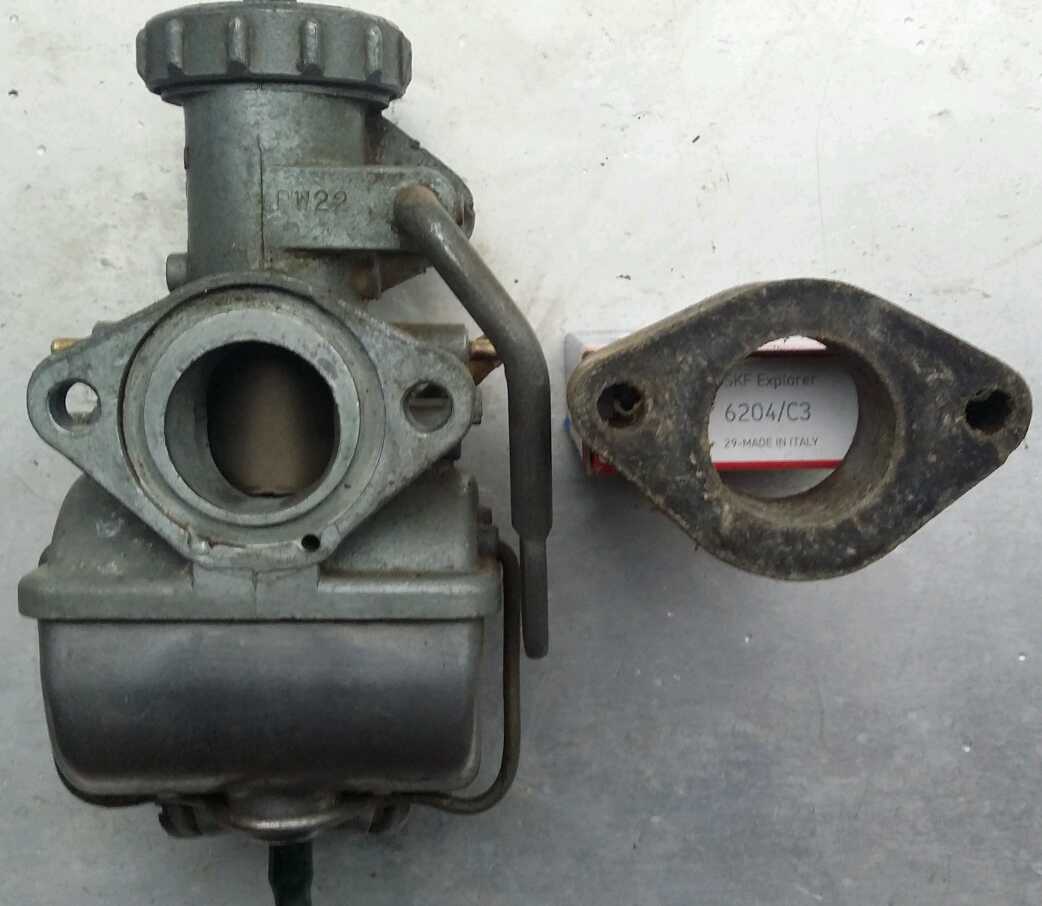

This one was fitted to the :honda: TL 125S loan bike and it made it go much better than the standard carby even if it was a shade too big. Now back to the Mikuni on the TLAhhh, it is actually a better fit than the standard Keihin with 25.4 mm bore matching the manifold:
The standard Keihin is 24 mm inside and offset in relation to the manifold, in fact the TLR Keihin is a better fit ( match ported) on TL 125 manifold:
