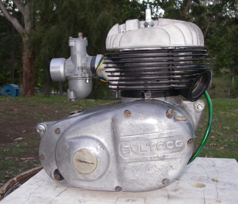

Was unable to get to South Australia for the Aussie Titles this year, but managed to ride both yesterday and today. Had a few Bultaco fans come for a ride today and I am learning to never underestimate Bully fans. Steve is lending me his M49 motor and Graeme has just finished fitting new bearings, seals and rings. Unreal to get this help because without it, riding my M49 with friends at Conondale would simply be a pipedream. So yes, sometimes things fall into place and I am keen to support the Spanish Manufacturers this year, riding a BULTACO M49! Happy days!
David, remember my stupid Conondale rule (can not ride the same bike twice), rode TY175B last year so it is ruled out! There was not enough space in the Dorrigo police cells, so the TY is in the front window of Juan`s cafe as a deterent, I am told.

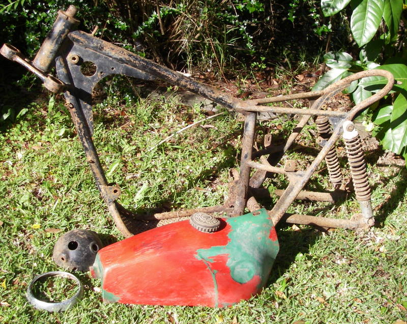

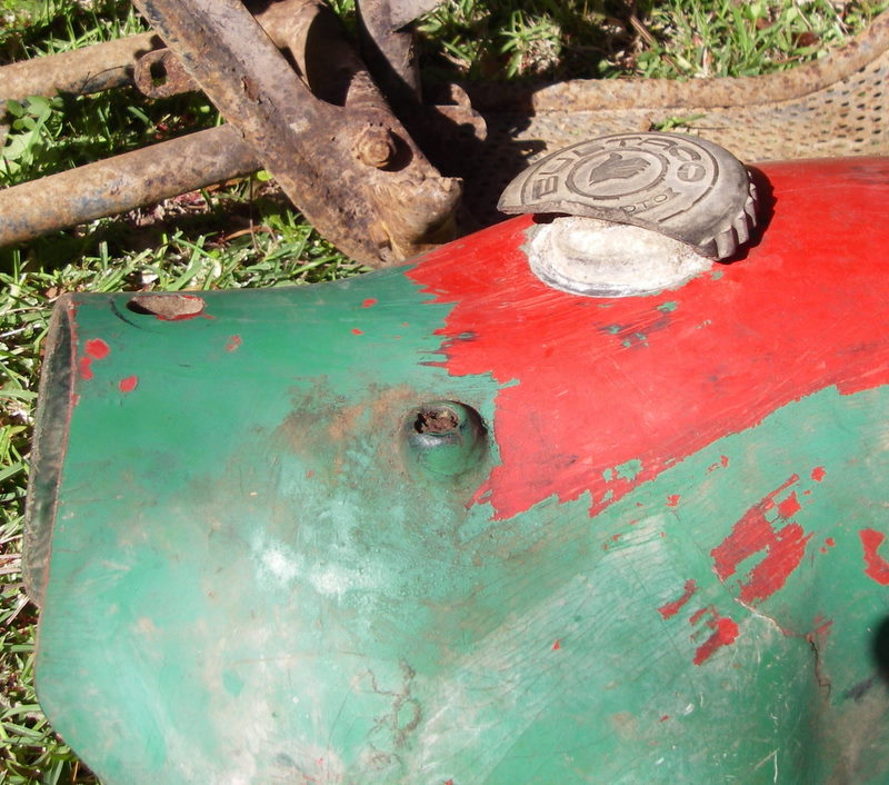

BULTACO fans seem to be everywhere, Phil has just given me some M49 parts, with more to come when he gets further into his shed. Obviously these have been sitting for a long time, out of shot is the original fuel tap. Think I will have to bore cap out of tank in an effort to save female thread unless anyone has a better idea?

Re the cap - you could try Dichloromethane (methylene chloride as chemical paint strippers) - it should soften it sufficiently to dig it out.
Paul Mac
