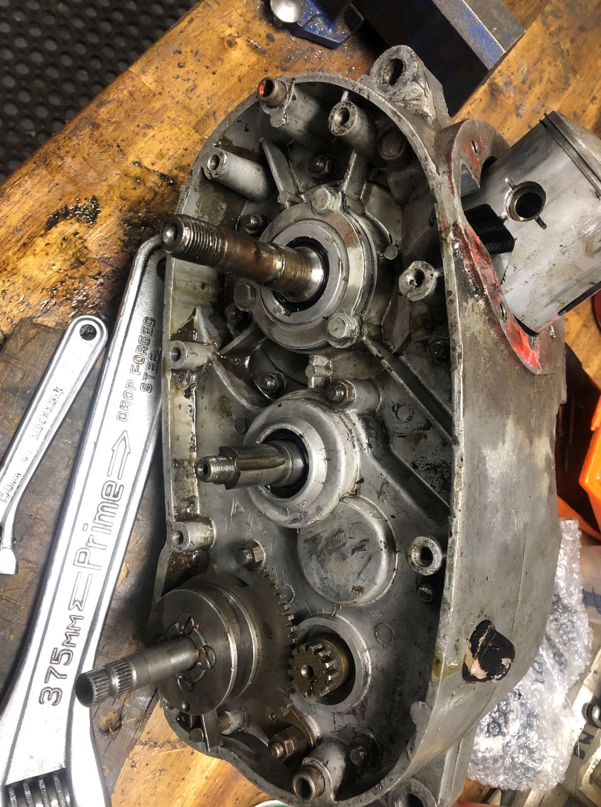

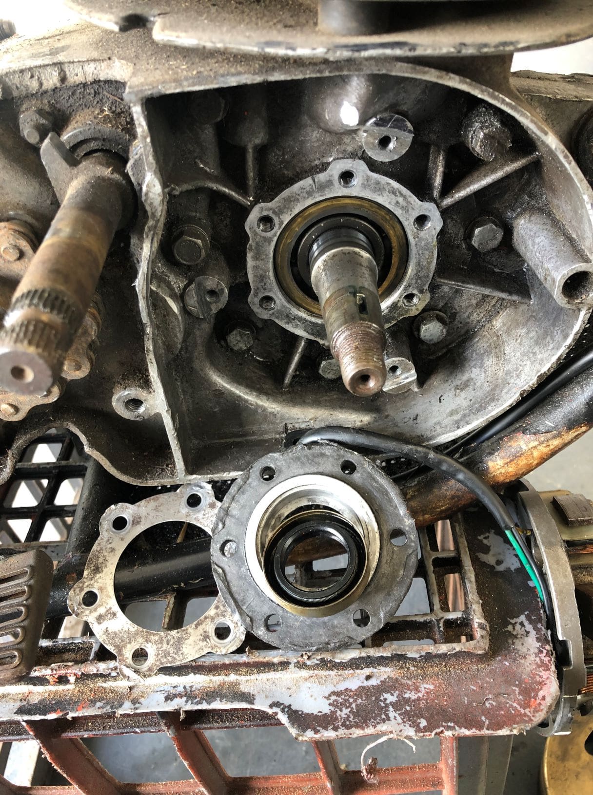

I'm currently in the process of pulling the 247 apart to complete a rebuild.
A major positive on the 247 is the ability to replace the crank seals so easily - very impressive design.
A less impressive part of the design is the tapered fits when you are trying to disassemble them, managed to get the gear off the crank relatively easily with the puller, heat and percussive persuasion but i'm now stuck with the countershaft sprocket.
Like dishes on the sink you don't want to do i'm soaking the gear in WD40 in the hope that might help loosen it.

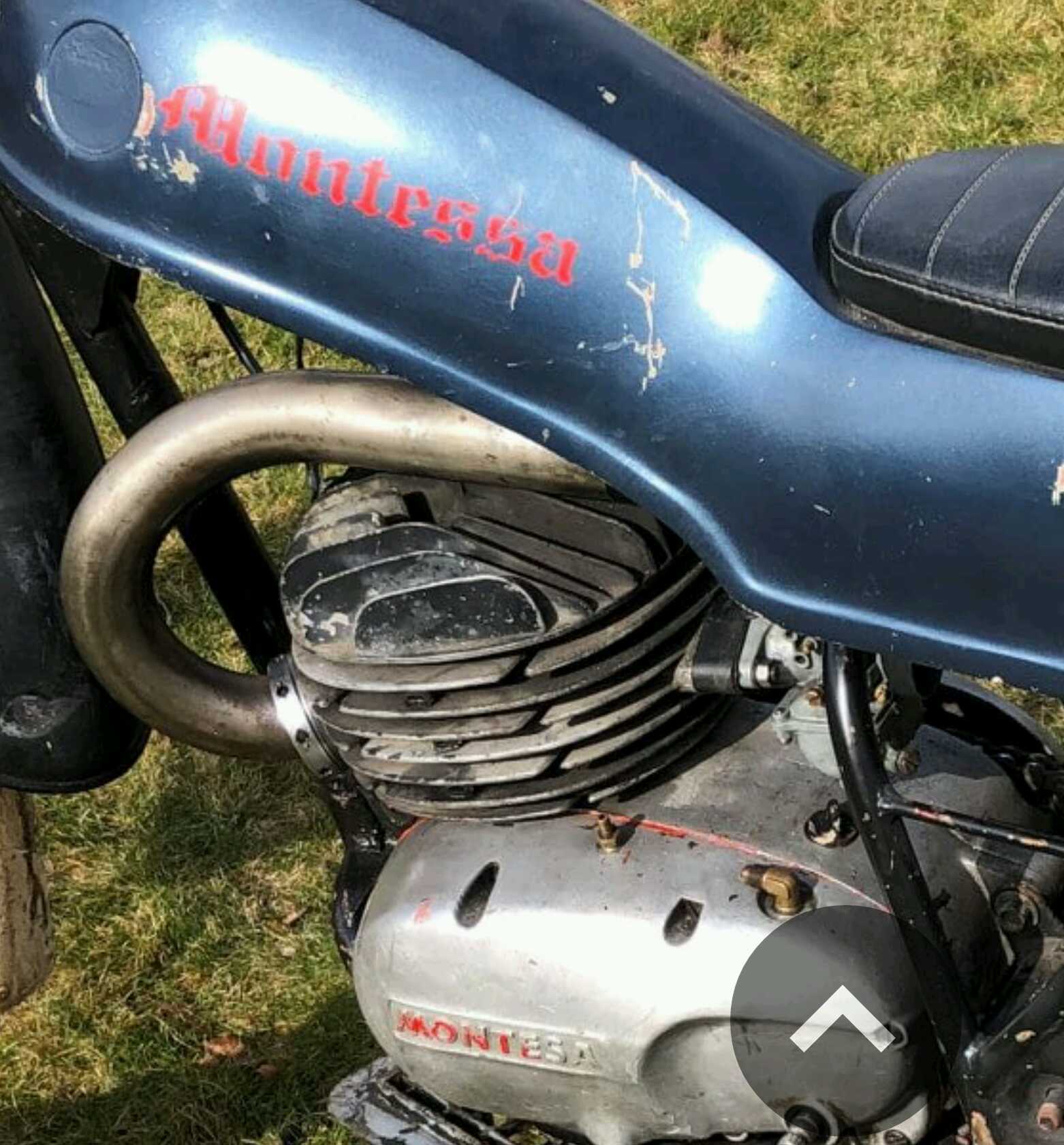

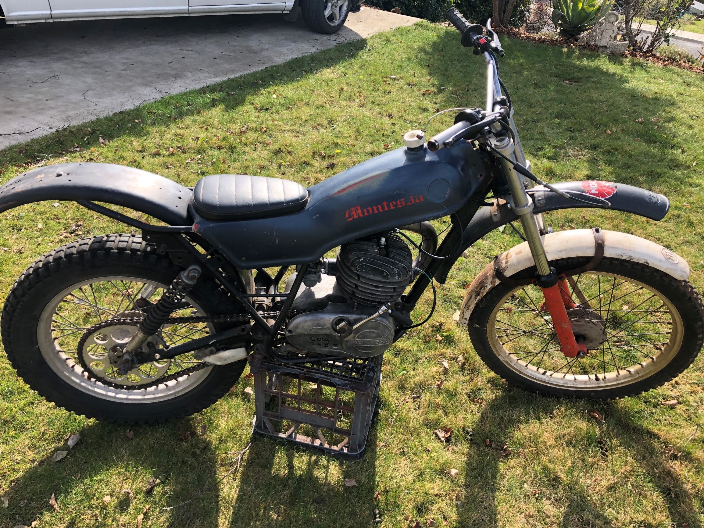

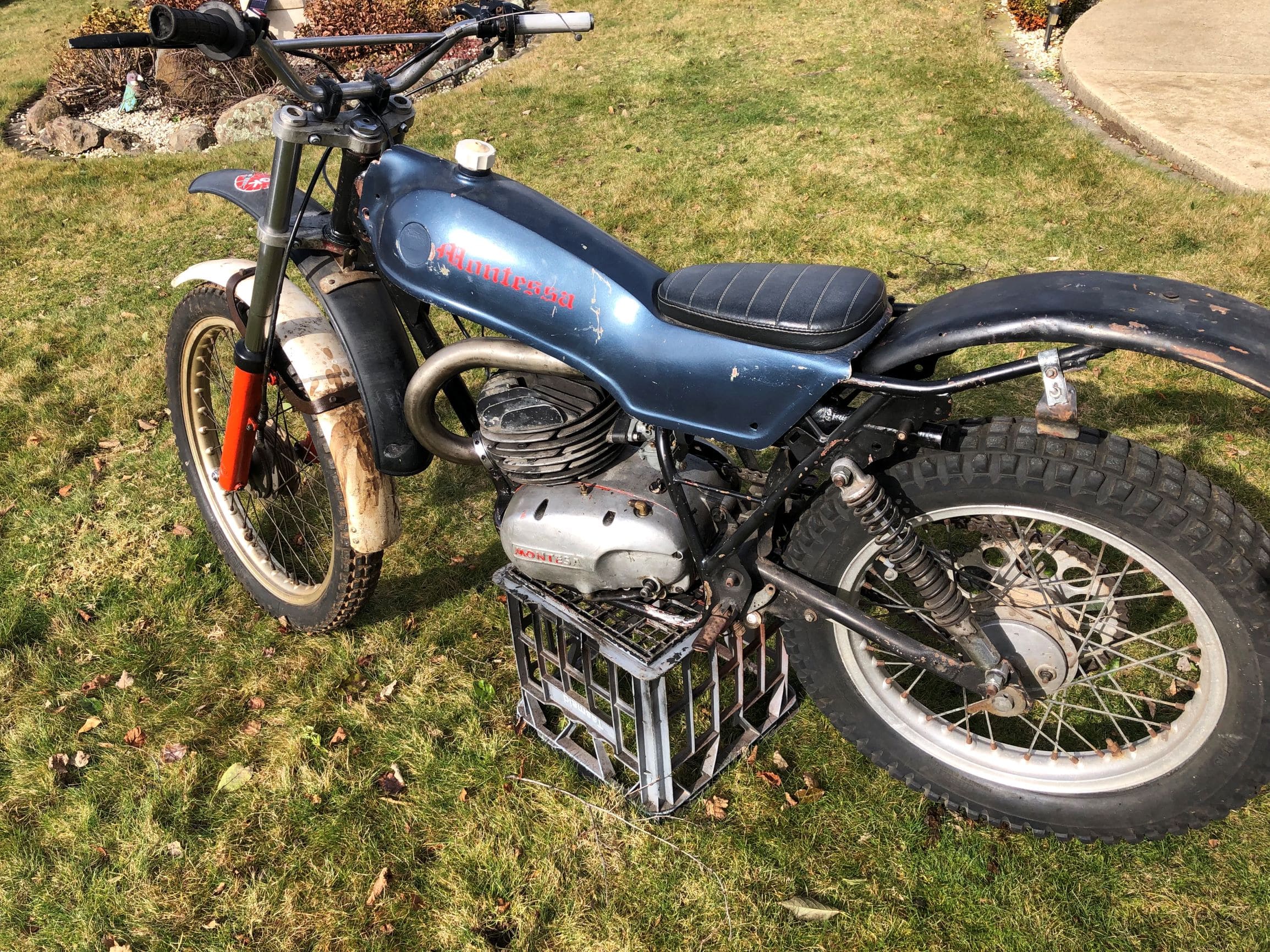

Your 247 must be one of those SS special models that seem to come out right across the whole :montesa model range? The custom paint jobs are the ones I like the best:

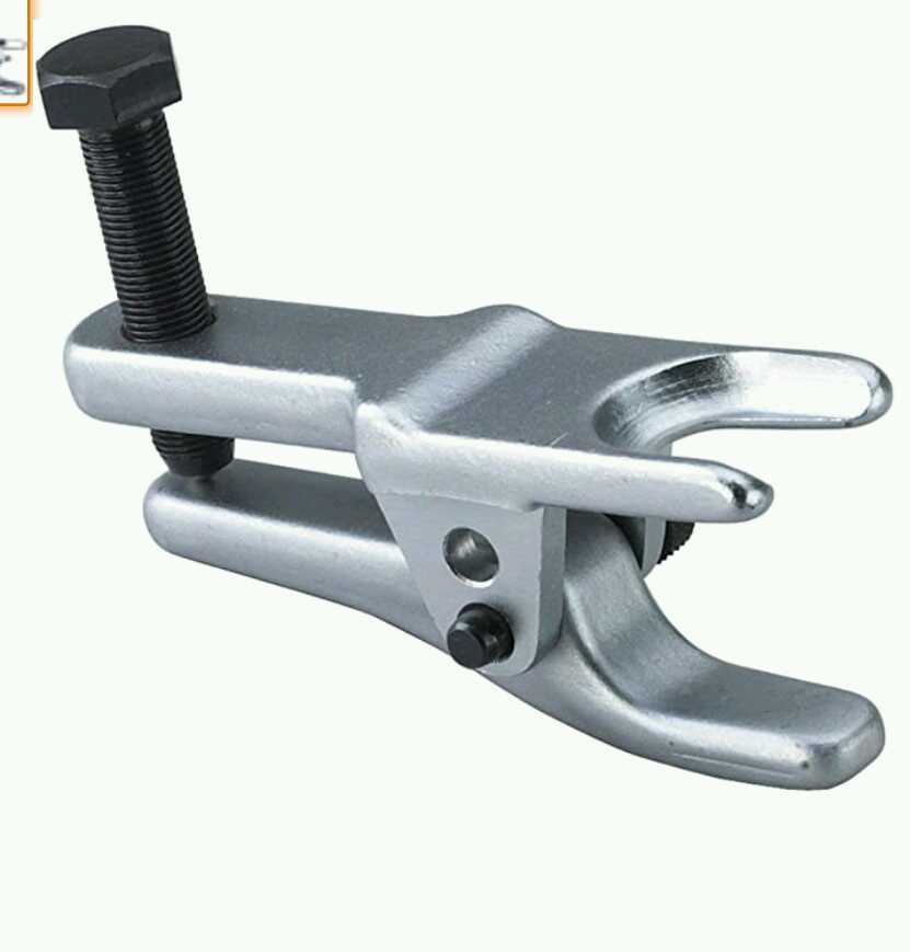

There is not much room around the sprocket for a bearing splitter, what sort of puller are you using? Maybe a balljoint splitter liket like this one:
Have you considered loading it up inside where it is warm and leaving it out in the cold overnight, assuming of course you can find somewhere outside in :TAS: that is cool this time of the year?

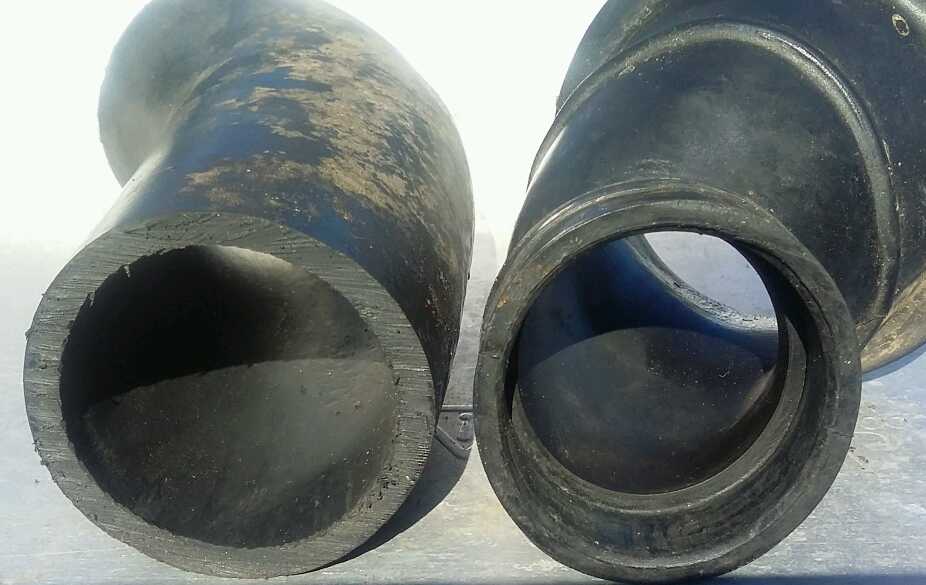

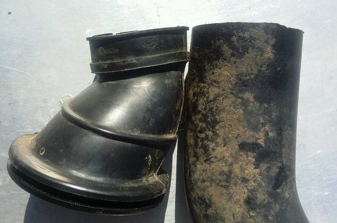

The Mikuni has sharpened it up and 2nd gear is much more usable now, it pulls right off the bottom and revs clean and returns to pretty much the same idle speed, no CVI! Happy Days!
Just looking at the carbys side by side, the Mikuni has a longer velocity scoop area leading into the slide and starts at a bigger diameter. Also the bore lines up exactly with the manifold unlike the Keihin which is smaller, however it is not a fair comparison even though they are both round slide and 22 mm as I could not use the standard rubber boot. Here are some photos of the standard boot next to the rubber tube that I used:

Yes the extra S, hard to figure out given you've got a clutch case with it spelt correctly on there.
You might need blue eyes and blonde hair to ride the SS models.
I'm using a 2 jaw puller unsuccessfully at the moment, nothing as fancy as that ball joint splitter.
I used a bearing splitter on the crank gear.
Hopefully a few heat cycles and WD40 will eventually loosen it.

A 4" angle grinder disc works well for sprocket removal, but I didn't mind doing it that way because the sprocket was worn out anyway
It seems that the :montesa SS models may actually have originated in :SA:

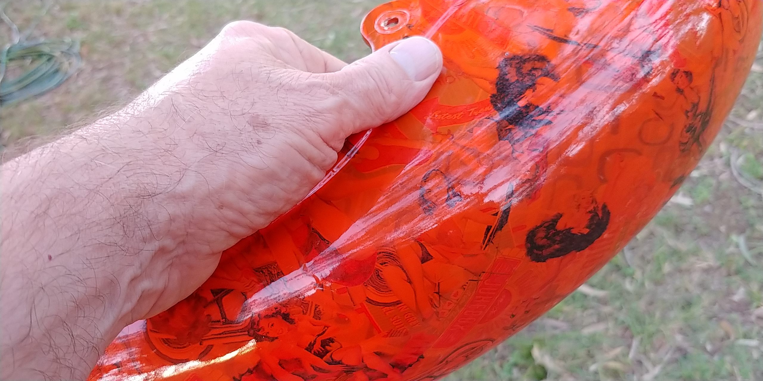

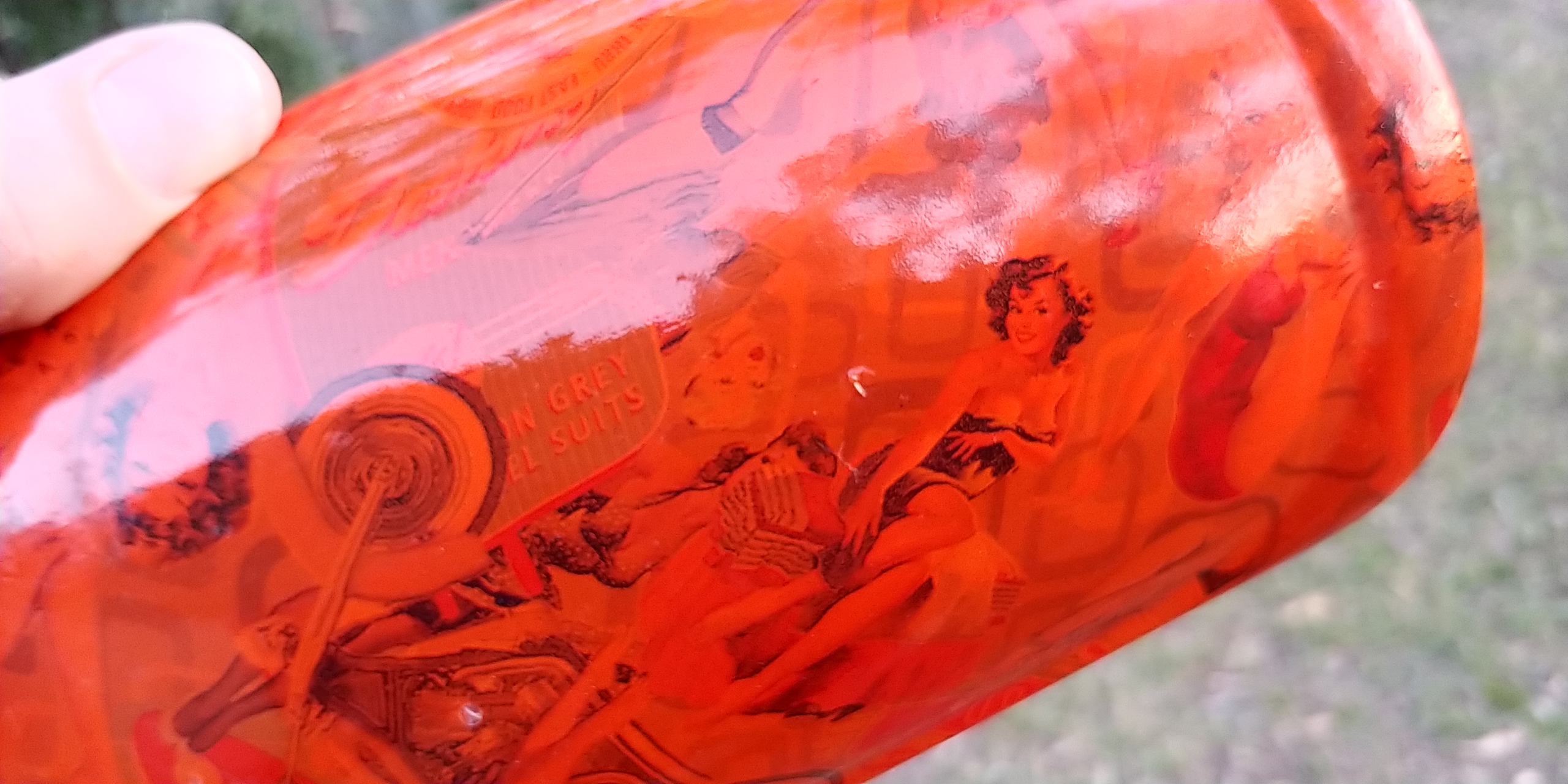

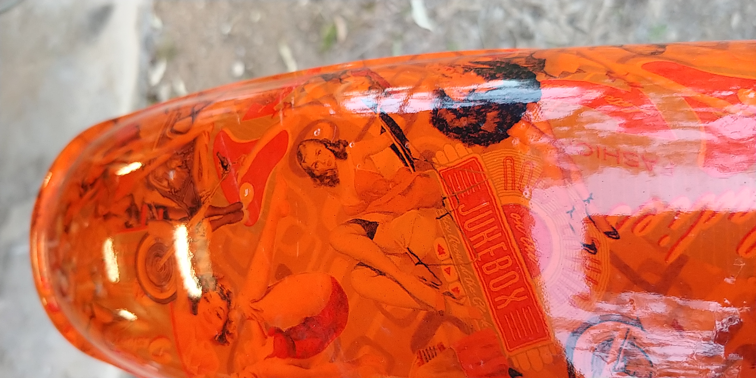

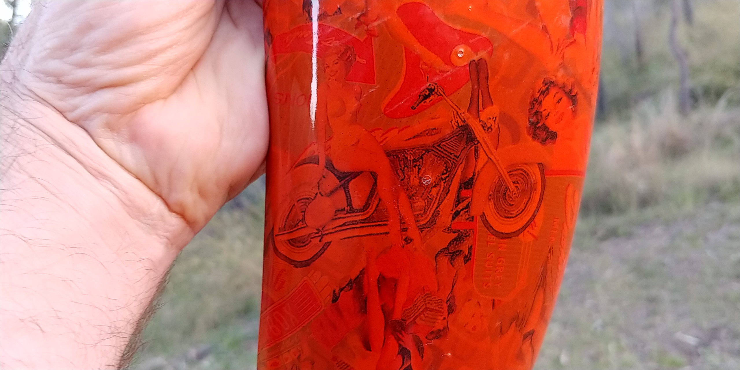

Vinyl wrap dilemma
A friend gave me this :yamaha TY mudguard a few years ago that he removed from a :bultaco: model 199 Sherpa T. It is my first close-up contact with something that has been vinyl wrapped, which is apparently something young people do to cars nowadays.
I've been admiring it for a few years now, but another friend is in need of one of those guards.
He doesn't know yet that I'm going to give him a guard, but he did ask me to try and find one for him.
I'm in a dilemma about whether to remove the wrap before I give it to him or leave it on.
Please help with this fairly minor but fun first-world philosophical dilemma.
Here is some background info:
I have no idea what condition the guard is under the wrap.
I don't want to give my friend a crap-looking guard.
He never looks at the internet so won't see this posting.
I really like the look of this guard with that wrap and there's a fairly good chance he might like it too.
The orange colour on the guard doesn't match the orange of his :yamaha TY175JC.
I would leave the wrap on David. I like it!

I second that.
