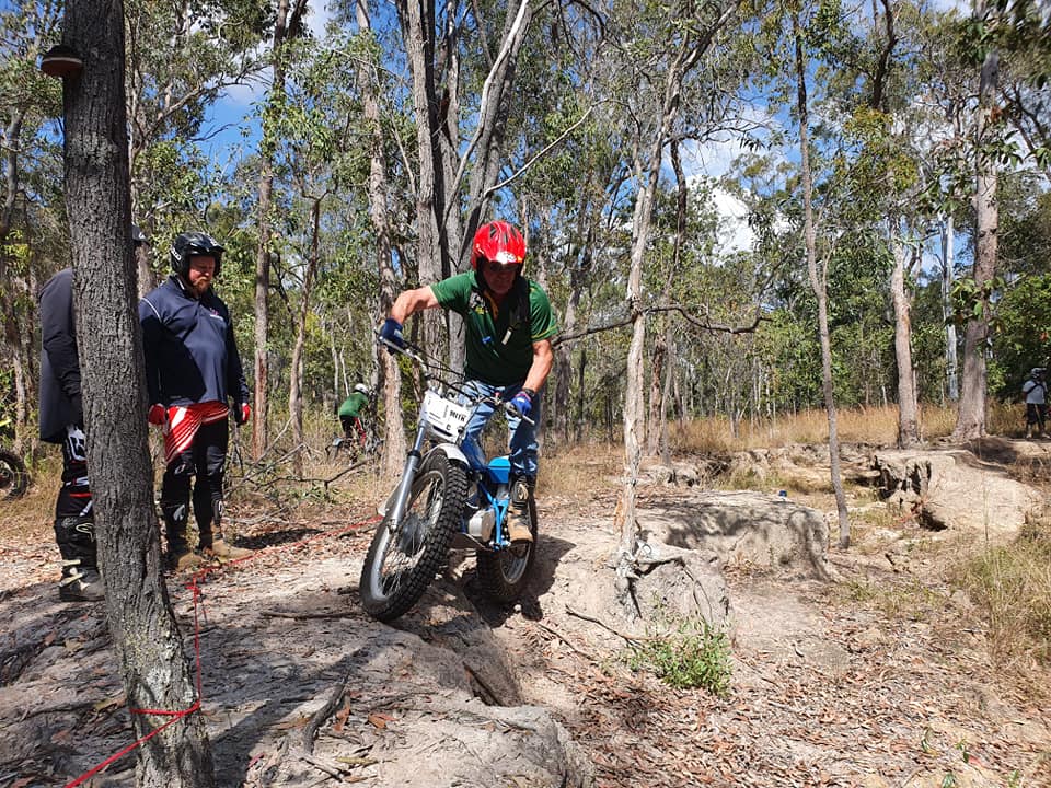

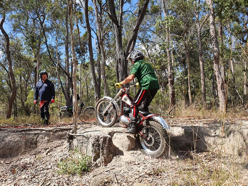

Here are photos of most of the twinshocks in a trial at Benaraby last Sunday. The photographer is Nicole Casey who also rode the event.
Cedric van Heerden is riding one of Tony Bax's P65 bikes in the photo. I couldn't find a photo of him on either of the TY175s he also rode.
The orange and white TY175 rider is Ross Hamilton. The blue TY175 rider is Peter Smith. I'm on my KT250.

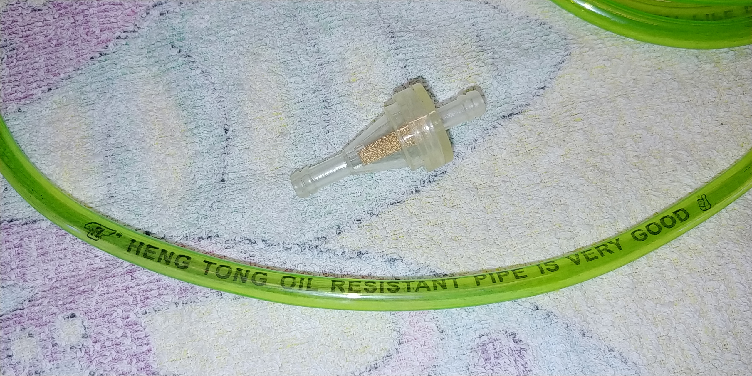

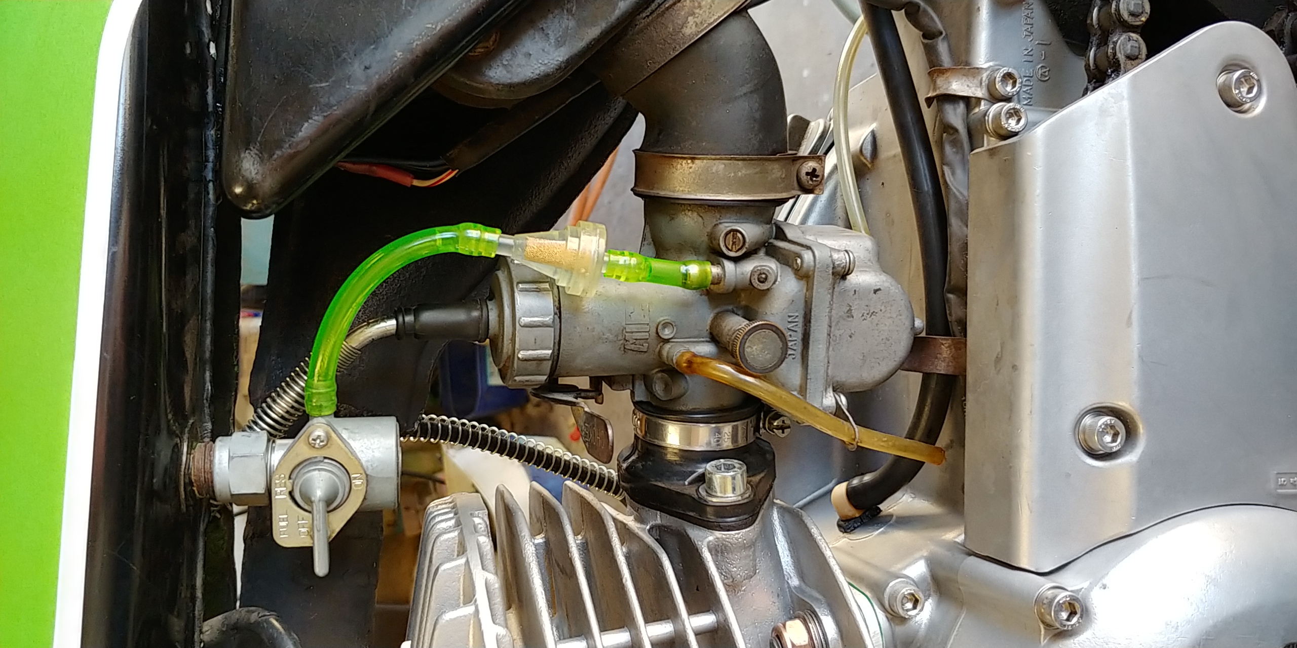

The bike has generally gone great in local trials up here on the last three weekends but each time when it got fully warmed up the idle speed increased. Today I did a couple of things to try and stop that happening. One thing was to improve the fuel flow to the carby. I found it seemed to have less trouble when the tank was 1/2 full than 1/4 full so today I replaced the fuel filter and hose. The filter was very old.
At the same time I fitted a gasket in the carby top where there had been none. I'm thinking that maybe air could have been leaking in there. I've had one 10 minute test ride this morning and the idle was stable but I want to get it really hot later on today for a better test.

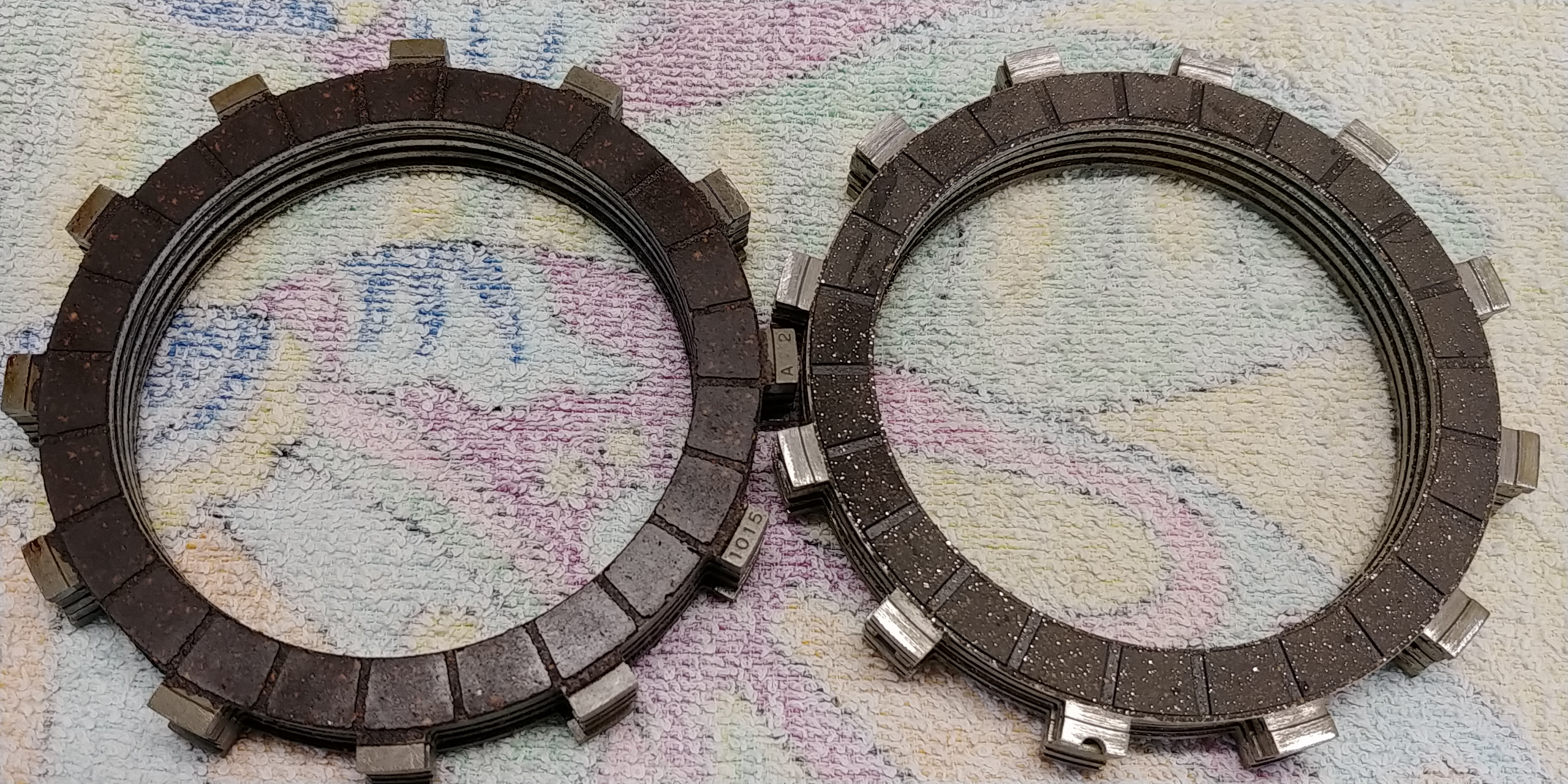

KT250 aftermarket clutch plates
The stack height is only 0.15mm different in total to what came out so I'm going to try the EBC plates without changing the setup of the springs.
The only thing I'm concerned about is the amount of metal in the EBC plates friction material in that it might cause accelerated wear to the aluminium surfaces at each end of the stack. Looks like the standard plates have no metal.
The plates that came out are genuine
plates that I fitted many years ago.
plates that I fitted many years ago.- Attachments
- 20210918_122420.jpg (1.92 MiB) Viewed 1053 times
EBC clutch plates in KT250
Well the EBC plates are fantastic in the
KT250.
The action is terrific - controllable slip, strong engagement, no drag and instant release
KT250.The action is terrific - controllable slip, strong engagement, no drag and instant release

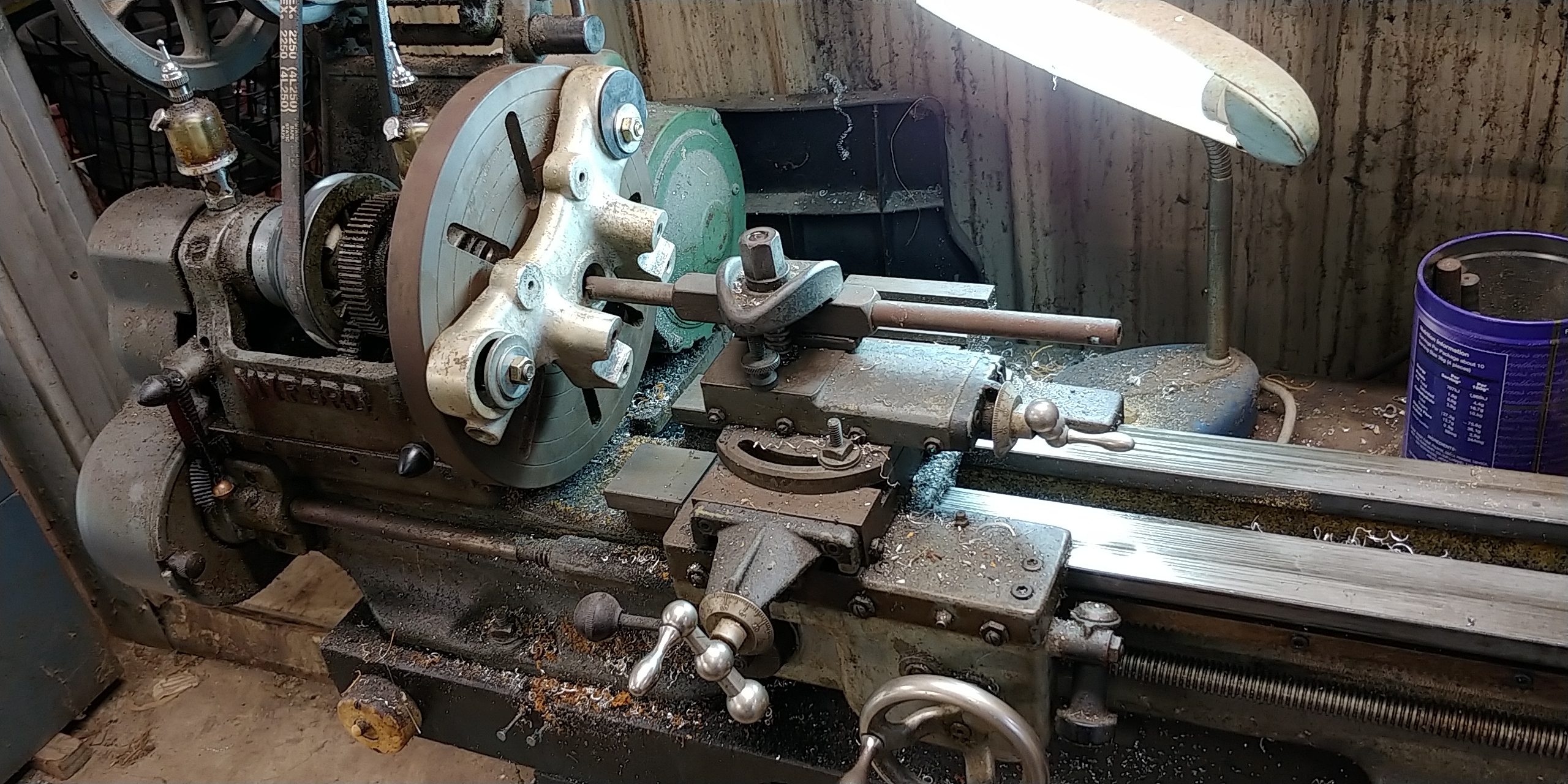

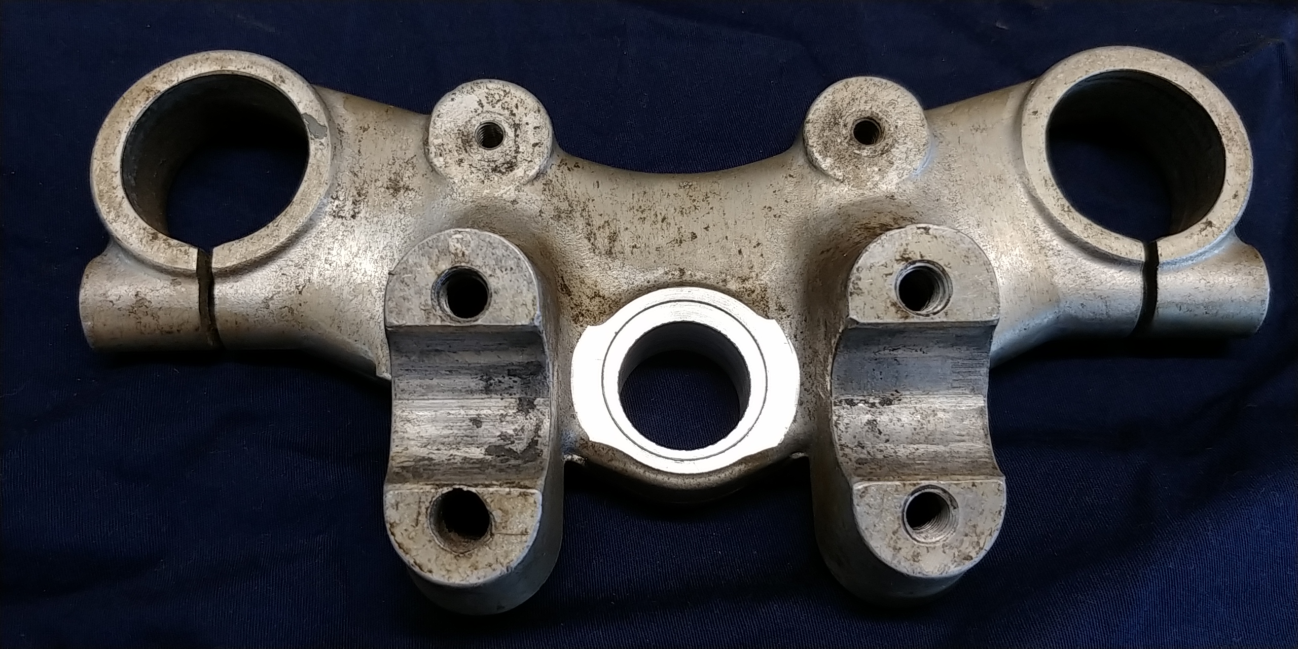

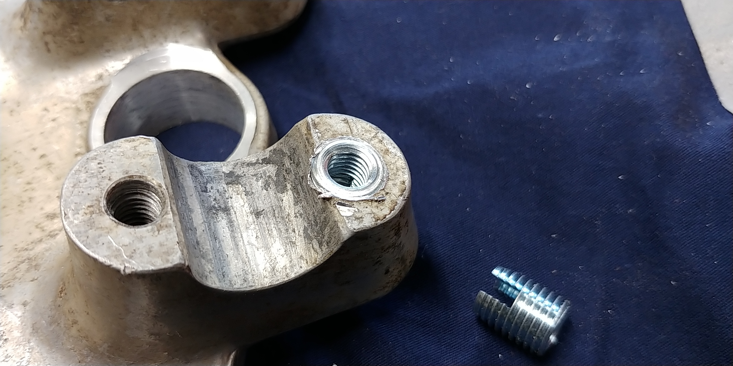

Today a spare KT250 top triple clamp got a lot of attention. The first thing was to bore the axle hole bigger and at a slightly different angle and face the ends at 90 degrees to the hole. I'm posting the photo to prove to a friend that it did fit in my tiny lathe, mounted to a face-plate. What I'm doing here by moving the axle hole rearwards is to move the top ends of the fork tubes forwards slightly to move the front axle back slightly.
The next thing was to make an eccentric bush. For this I finally got to use a vintage four jaw chuck. This job was my excuse for buying the chuck. I almost stuffed this bit up though because I thought that one turn on my dial indicator was one mm when it was actually one tenth of an inch. Sorry I forgot to take a photo of the bush being machined but you can see the eccentric bush sitting in place in this photo.
Next was fixing a stripped-out handlebar clamp thread. This was my first ever go at using one of these thread-serts to fix a stripped female thread. I can see why they are popular, being much more robust than a heli-coil repair. After I did this photo, I ground back the top edge of the threadsert with a Dremel so it doesn't touch the handlebars.
