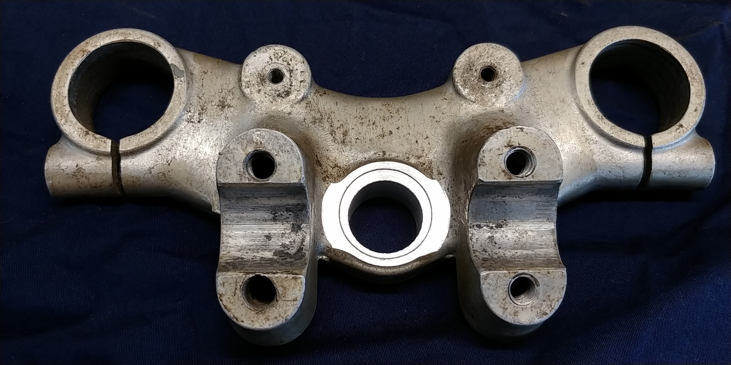

A while ago I posted about how I wanted to try out increasing the trail dimension on my KT250. Well a few things lined up today:

Today a spare KT250 top triple clamp got a lot of attention. The first thing was to bore the axle hole bigger and at a slightly different angle and face the ends at 90 degrees to the hole. I'm posting the photo to prove to a friend that it did fit in my tiny lathe, mounted to a face-plate. What I'm doing here by moving the axle hole rearwards is to move the top ends of the fork tubes forwards slightly to move the front axle back slightly.
The next thing was to make an eccentric bush. For this I finally got to use a vintage four jaw chuck. This job was my excuse for buying the chuck. I almost stuffed this bit up though because I thought that one turn on my dial indicator was one mm when it was actually one tenth of an inch. Sorry I forgot to take a photo of the bush being machined but you can see the eccentric bush sitting in place in this photo.
Next was fixing a stripped-out handlebar clamp thread. This was my first ever go at using one of these thread-serts to fix a stripped female thread. I can see why they are popular, being much more robust than a heli-coil repair. After I did this photo, I ground back the top edge of the threadsert with a Dremel so it doesn't touch the handlebars.

Well I've had shed time again this weekend and the :kawasaki KT250 is back together with the increased trail as shown above.
I went for a test ride between showers of rain and am very happy with the result.

How much did you reduce axle offset

In theory, 2 mm at the top end of the fork tubes should give about 6 mm perpendicular to the line of the fork tubes at the axle.
Measurement using a tape measure parallel with the floor, the axle moved back 5 mm.

What noticeable advantage in handling would you expect that 5mm to deliver?
