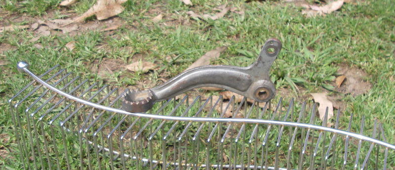

PS Decided to post a photo of this stupid looking thing in an effort to remember where it is!

You know that is the luxury version of the M49 brake pedals in your photo.
Ross, yes I ran the bike with your mikuni and all the other borrowed parts, I am thinking the bike is about 60% mine! Dumb luck that I stumbled into a BP5ES as it was the only plug left in my toolbox.
David, luxury version you say, and all this time I thought it was Built Under Licence To Absolutely Cheapest Options!

David Lahey wrote:You know that is the luxury version of the M49 brake pedals in your photo.
You mean the one that gives about 1/2 an inch of travel before hitting the bottom tube
Greg Harding wrote: David, luxury version you say, and all this time I thought it was Built Under Licence To Absolutely Cheapest Options!
If you thought that brake pedal is crappy, you and Ross will have a good laugh when you see what came before it was "improved" to that one. I have deliberately kept most of the weirdest parts of my M49 original so people can see how things were done back then. Unfortunately (or maybe fortunately for my feet) I had to fit normalish footpegs to be able to ride MA events. The standard footpegs are fixed, rigid torture devices that are like standing on the upturned blade ends of screwdrivers. I expect it would take about an hours riding to drill through the soles of modern trials boots. I have studied photos of Sammy Miller riding at the time of the early M49 and he appears to be wearing leather-soled boots (no wonder!). Maybe thats why he didn't foot much - his boots had holes that located them firmly onto the bladed ends of the footpegs. They are like something from a Roman battle chariot
brownie wrote:David Lahey wrote:You know that is the luxury version of the M49 brake pedals in your photo.
Ross you have brought back memories of my first Alpina. The brake adjustment had to be perfect to avoid what you have pointed out, and when the shoes got wet, the adjustment changed. Another memory of that bike from when I was a kid(M85 I think) was that it had a huge rear sprocket on it so I could ride trials and one day the chain derailed and the sprocket was so big diameter that as the chain came off, it managed to catch the end of the brake rod between two rollers and snapped the brake rod off. I think that was about when I realised it was important to make sure the chain was in alignment before going for a ride.

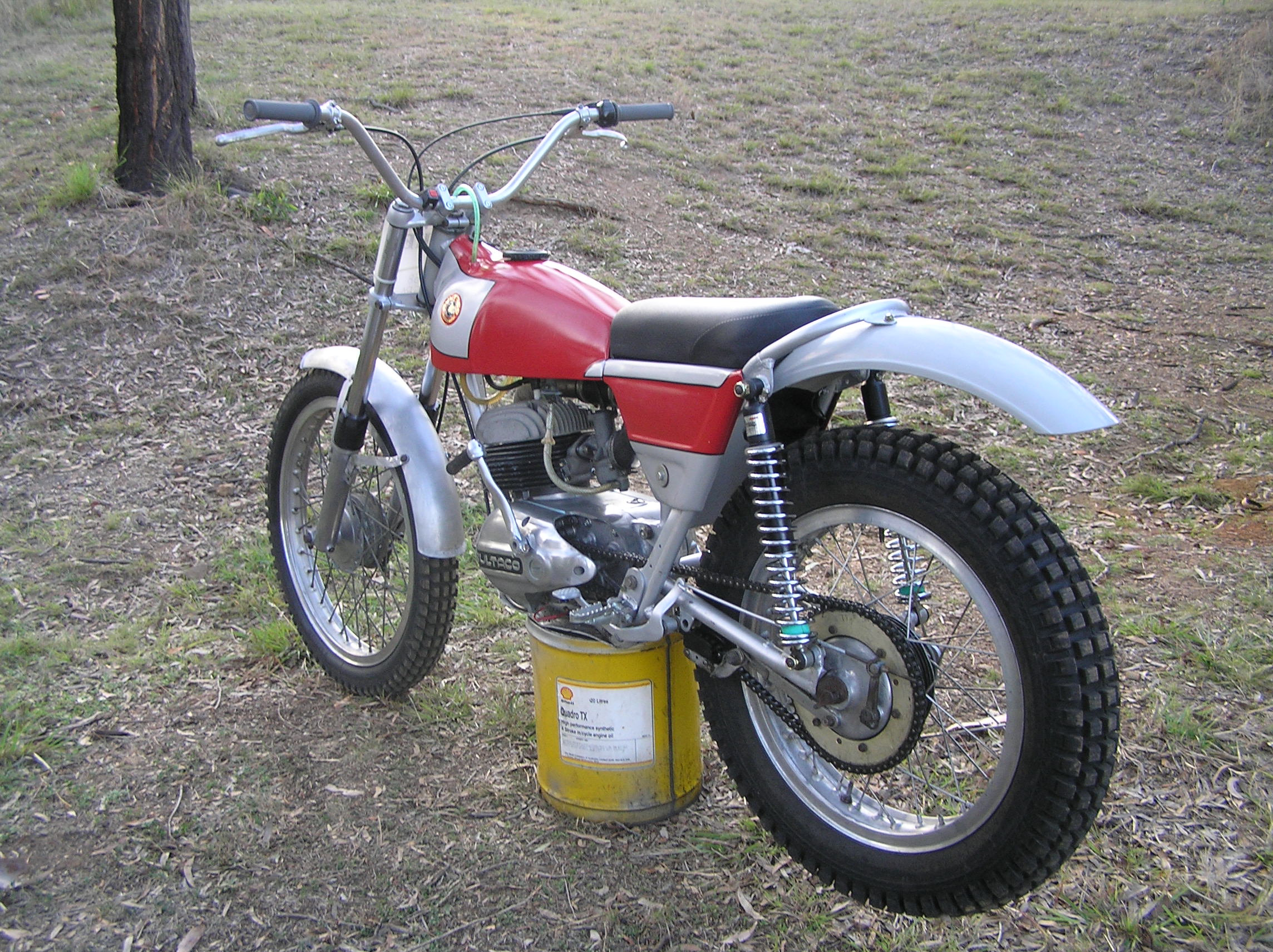

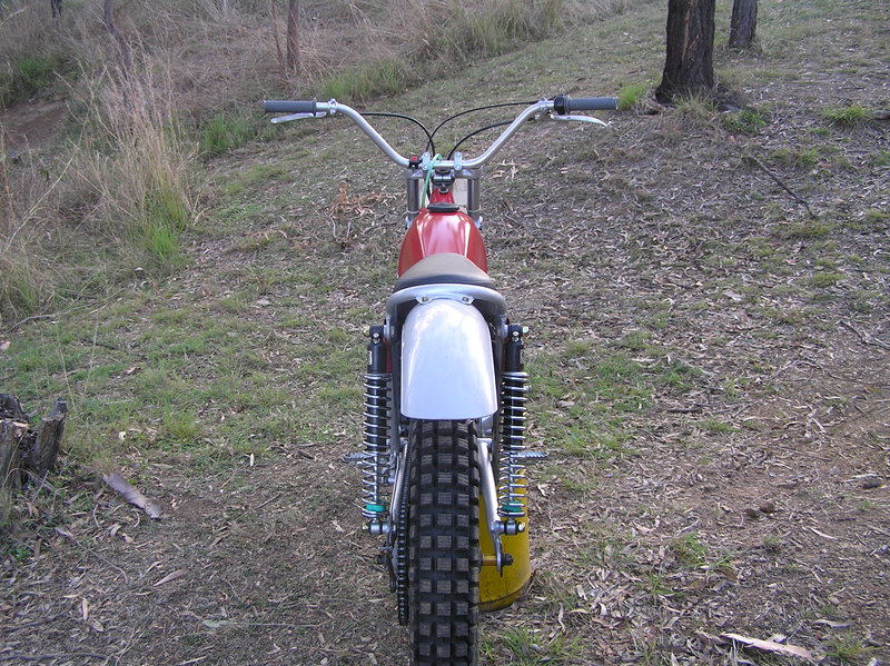

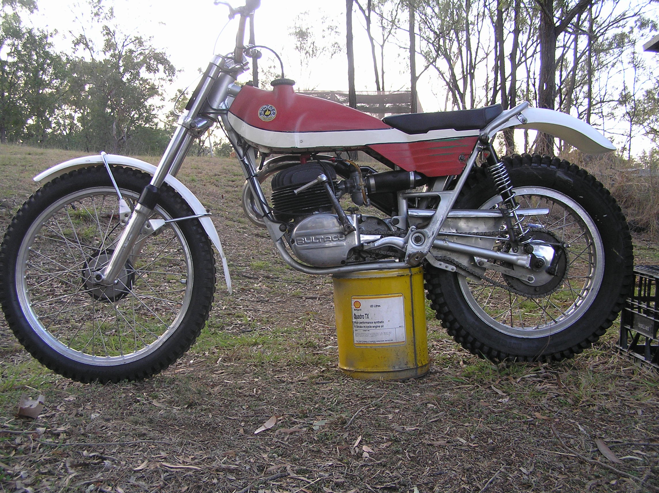

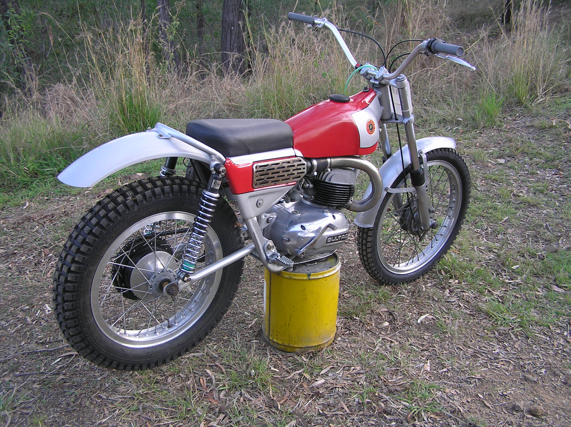

I took some photos of the M49 today. I realised that it is the first time I have cleaned this bike since 2007 and wanted to capture the look before it gets muddy this weekend at Conondale. The handlebars are 7" rise and for me feel perfect on this bike.

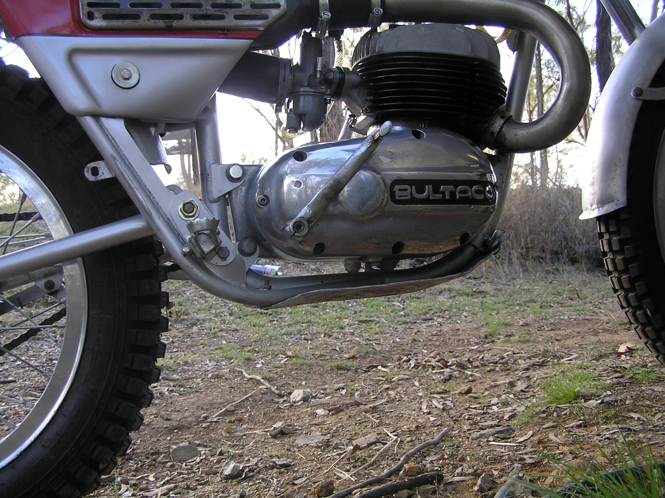

Bultaco developed the Sherpa T continuously, introducing improvements as they were developed. One such development was the arrangement of the frame tubes under the motor. The early M49 in the photos is the last Sherpa T that has the full central frame element under the motor. Part-way through the M49 model run (1968 to 1971) the central tube disappeared. Here are comparison photos showing my 1968 M49 and Cedric Van Heerden's 1973 M91 to illustrate how much ground clearance was gained by the change in design.

David Lahey wrote:........ I realised that it is the first time I have cleaned this bike since 2007 ...........
I suspect you may have done just a little more than just clean your bike.
Alternatively, if cleaning your bike makes that much difference, maybe I should consider cleaning mine.
