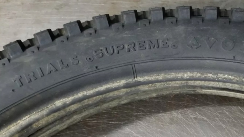

Here are some more variations of old Trials tyres:
One of my school friends had an Avon Mudplugger on the back of his :kawasaki KE175 circa 1978.
These next 3 photos are courtesy of ebay USA, you may be familiar with these Guy? I have never seen these before.
Would any of these comply with these above mentioned antiquated rules?
Knobs that are not square, extra rows of knobs outside "Trials Universal pattern", staggered rows of knobs like an Enduro tyre/ Knobby.
