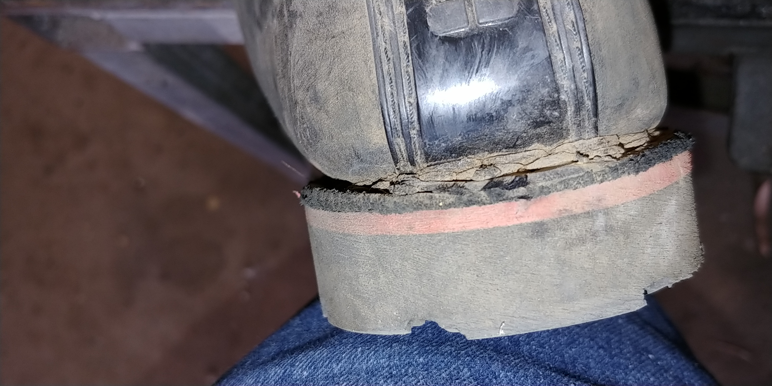

I bought some new boots and on most bikes they were great but on one bike the top edge of the sole would get caught under the edge of the stand mount at critical times when riding.
I thought about modifying the boot sole but decided to try making a boot heel deflector instead. It's made of 3 mm HDPE and worked well on a brief test ride this morning. Much more testing required but it is ridiculously hot and humid here this morning.

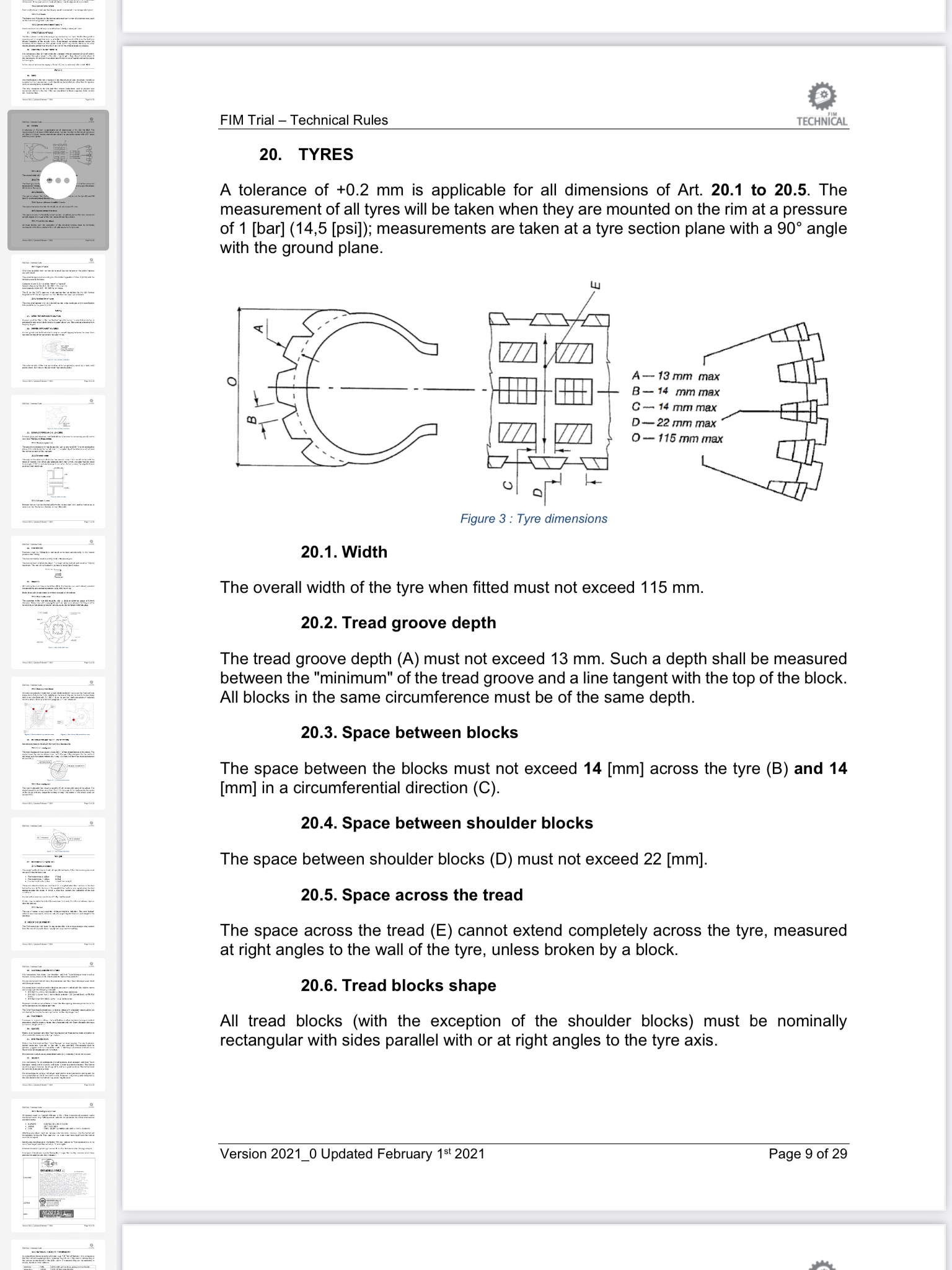

If anyone is unsure of their tyre just read the measurements in the FIM link David put up and get your tape out to measure your tyre or the one your going to buy.

FIM tyre regs
FIM tyre regs
