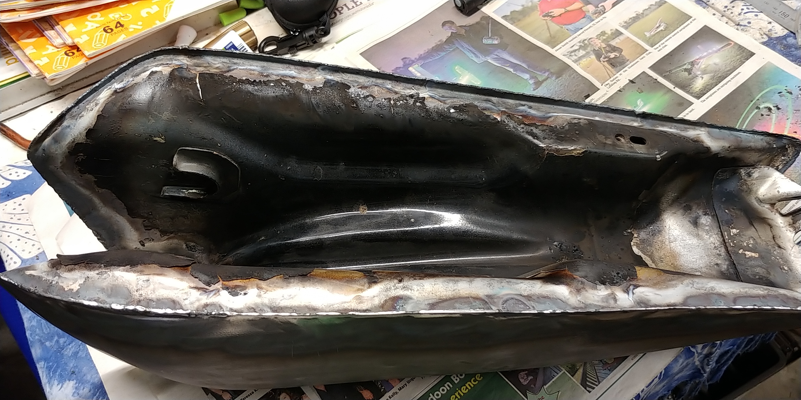

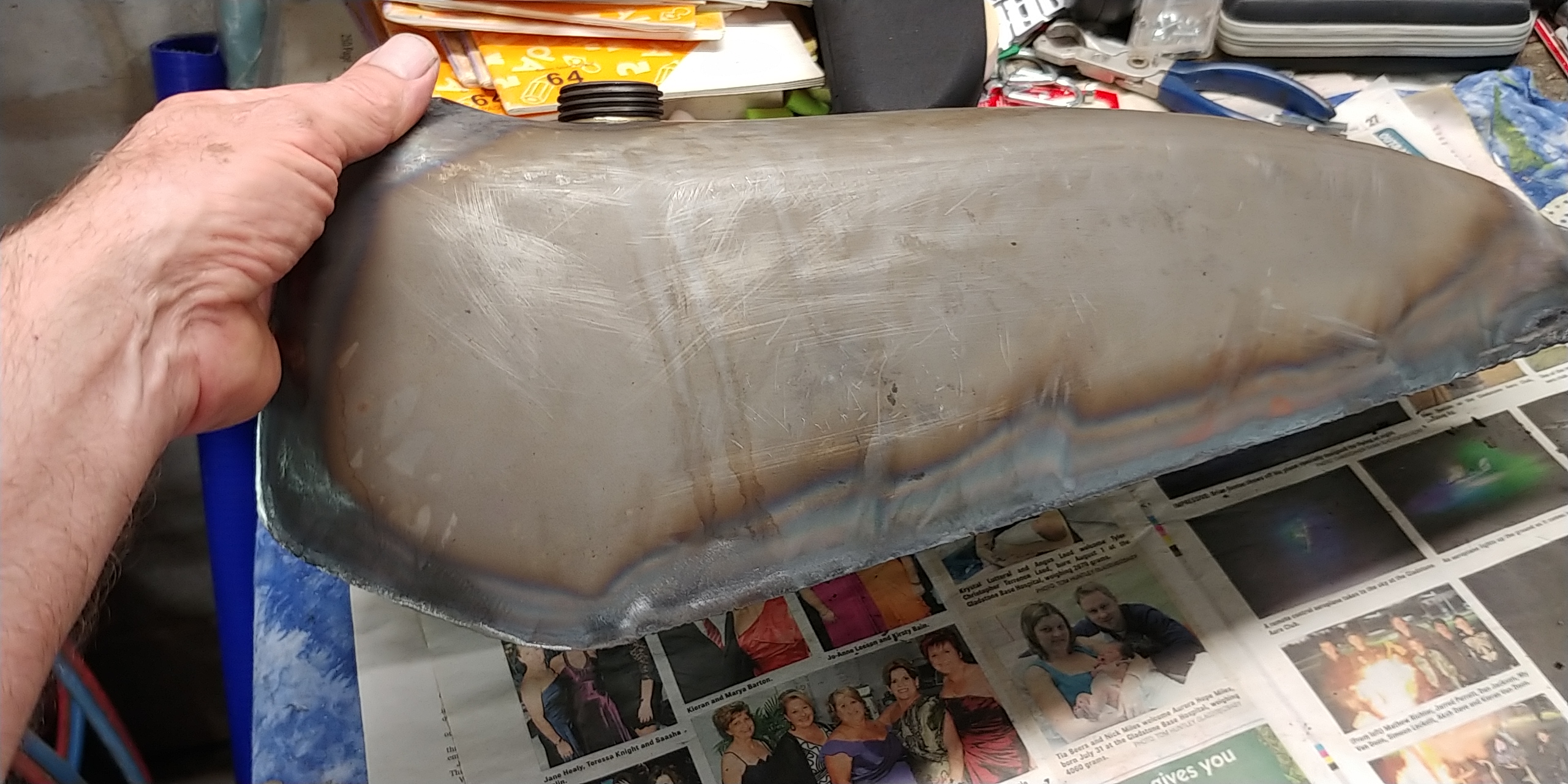

more Honda TL125 tank workshop time
So a few things lined up which allowed me to re-join the top of my friend's
TL125 tank to the bottom.
1. I got new glasses.
2. The local welding shop was able to supply a D cylinder of acetylene.
3. I'm on holidays!!!
I've never used such a tiny welding tip before (number 4).
The metal is about 0.8mm thick.
The modern sensible method to weld it would have been TIG.
I used oxy-acetylene because that's what I have had a fair bit of practice with and enjoy the nostalgia.
Leak testing comes next

Well done David. I still prefer to use oxy/acetylene to weld thinner metal. A 4 tip is really small. I have used a number 6 before.
Jools
- Posts: 293
- Club: VJMC
- Bike: TL125 TY175 GG280
Yes Oxy Rules... (trouble is they kept putting up bottle rental prices so I returned them).
But I've successfully repaired a few tanks using MAPP gas and brazing rod and Silver solder.
I hate my ARC - have so much trouble actually seeing where I'm going. (Yes I do have a good auto helmet). Need more practice, but unlike oxy which I used to positively enjoy, moving that nice molten pool along, I find arc is such a violent process.
