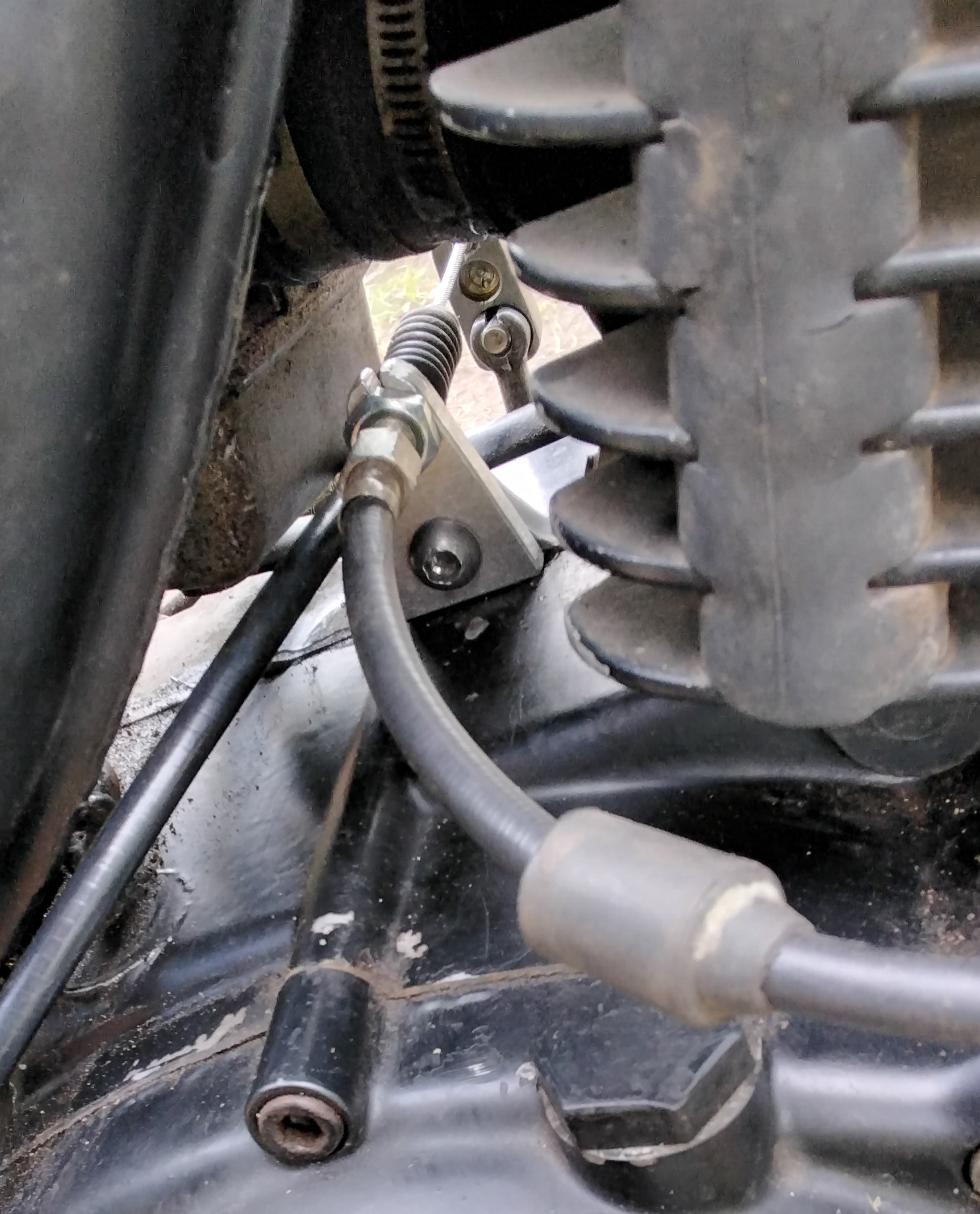

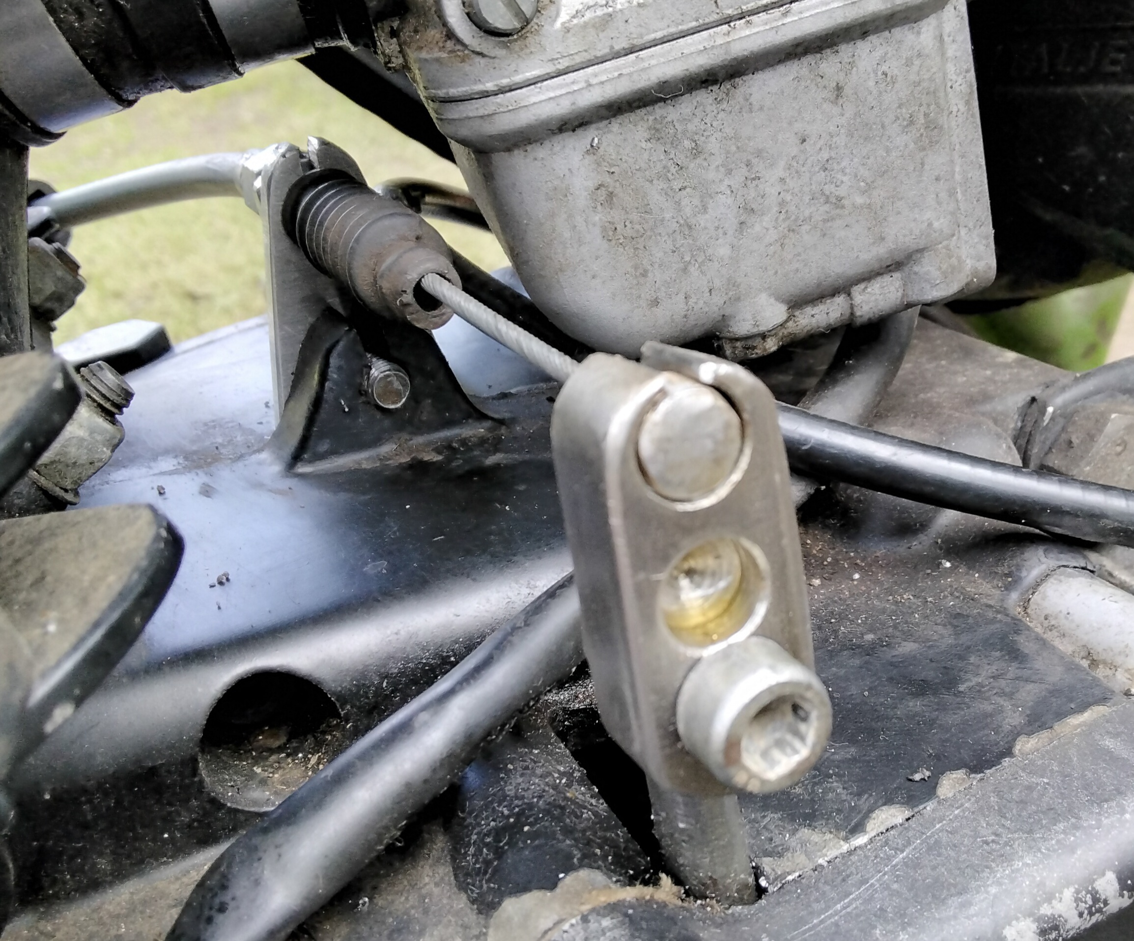

Just sharing where I am up to with the :italjet: hand catapult, after snapping the clutch cable after the first lap at Denman, I have had a bit of a rethink. So now I have gone away from the "acropolis1989" set up:
and hand fabricated an extension to the clutch arm along with a quicker way to adjust the clutch and a new cable:
This works better and Donna can now pull the clutch in but wanting even less effort I decided to back off the pressure plate preload:
Yes Gristy, drilled clutch basket and crank  weights so true Piuma!
In other words, the standard preload was enough to snap 2 cables, (during competition of course) so I backed the preload off 1.4 mm. This was easier again but clutch slipped in higher gears! Then I tried 1.2 mm and this gave me the Goldilocks moment! Happy Days :mrgreen: :mrgreen: :mrgreen:

What are the heat affected marks on the clutch pressure plate?

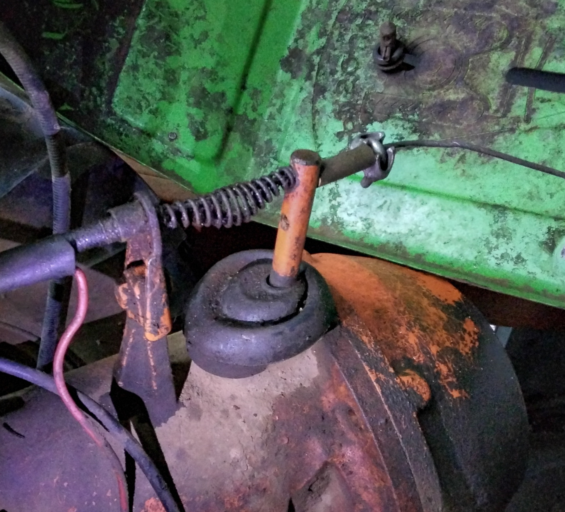

Oh, that is not where I got the idea:
My Italian rotary hoe has a similar set up that someone has reworked at some time before it came to me:

Kurt wrote:Very nice clutch lightening mod Greg, on the :italjet: .
The pressure plate is made up of pressed sheetmetal spot welded together.

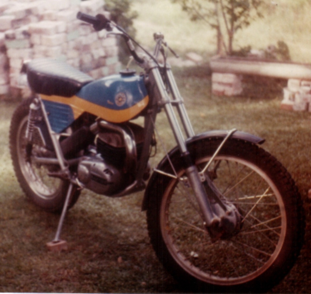

David Lahey wrote:While thinking about :bultaco: model 99s, found this photo of my :bultaco: model 99 taken in about 1976 in the front yard of my parent's place at Balmoral in Brisbane. I was 17 years old and had just repainted it.
What a shame the rear hub isn't visible. I remember the chamfer on the rear brake plate though.
Notice the black, solid aluminium Inter-Am handlebars. They were fabulous.
This bike was road registered but I had the lights off it at the time to ride it in a trial.

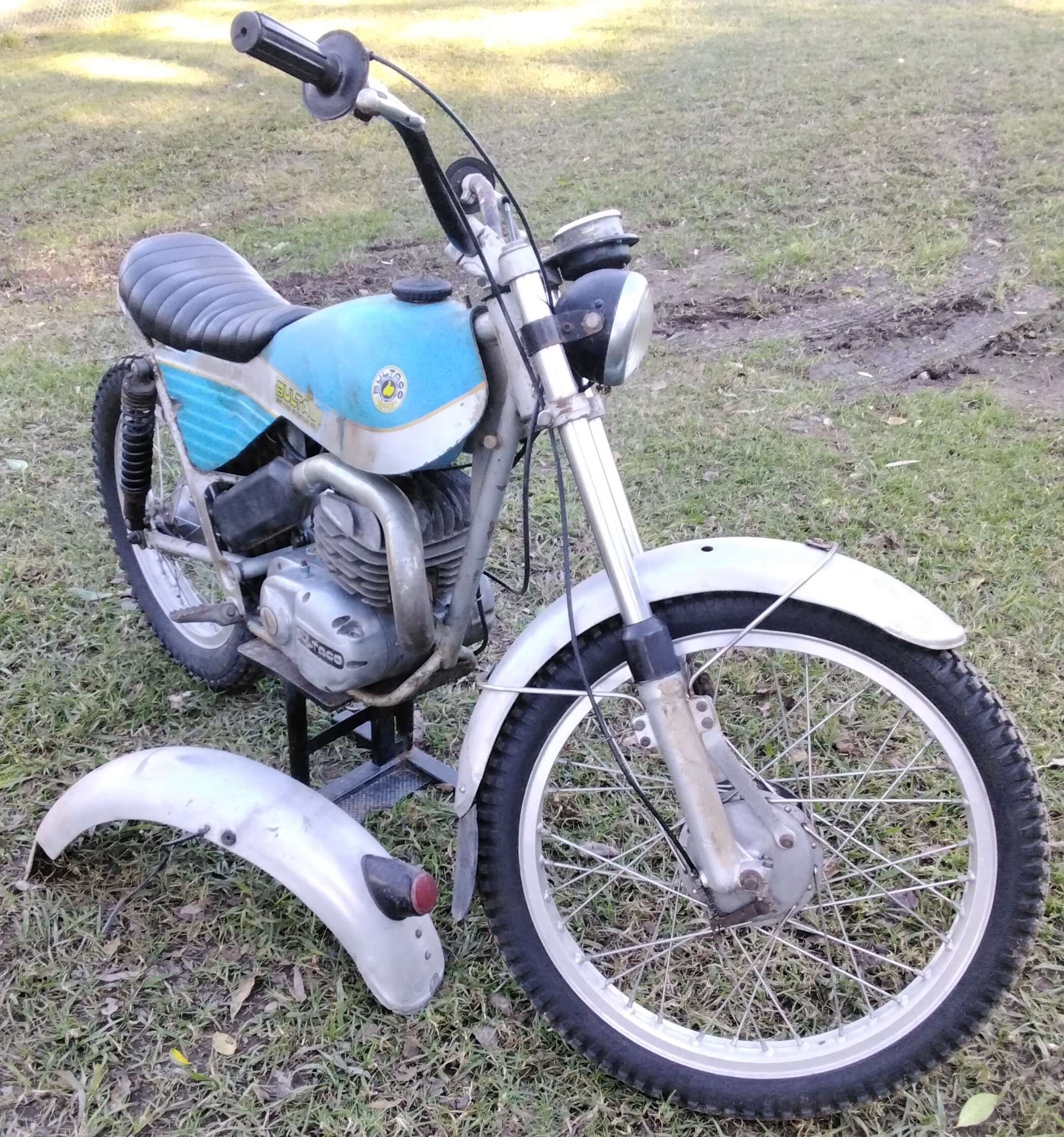

Is this your bike David?
It has the acropolis1989 set up. Looks similar to yours but has aloooominium mudguards and 66W is stamped in the cases.
Seeing that photo is excellent news Greg. Well done.
I especially like the patina on the tank.
It can't be my old one because that one is in very good original condition :D
It does bring back great memories of riding in trials in Trailbike class, riding to QUT along the South East freeway, riding at the powerlines on the way to Capalaba and riding up Honda Hill somewhere out past Ferny Grove.
Finally I got one of your obscure jokes!!!!! 66W indeed :shock: #-o :D
