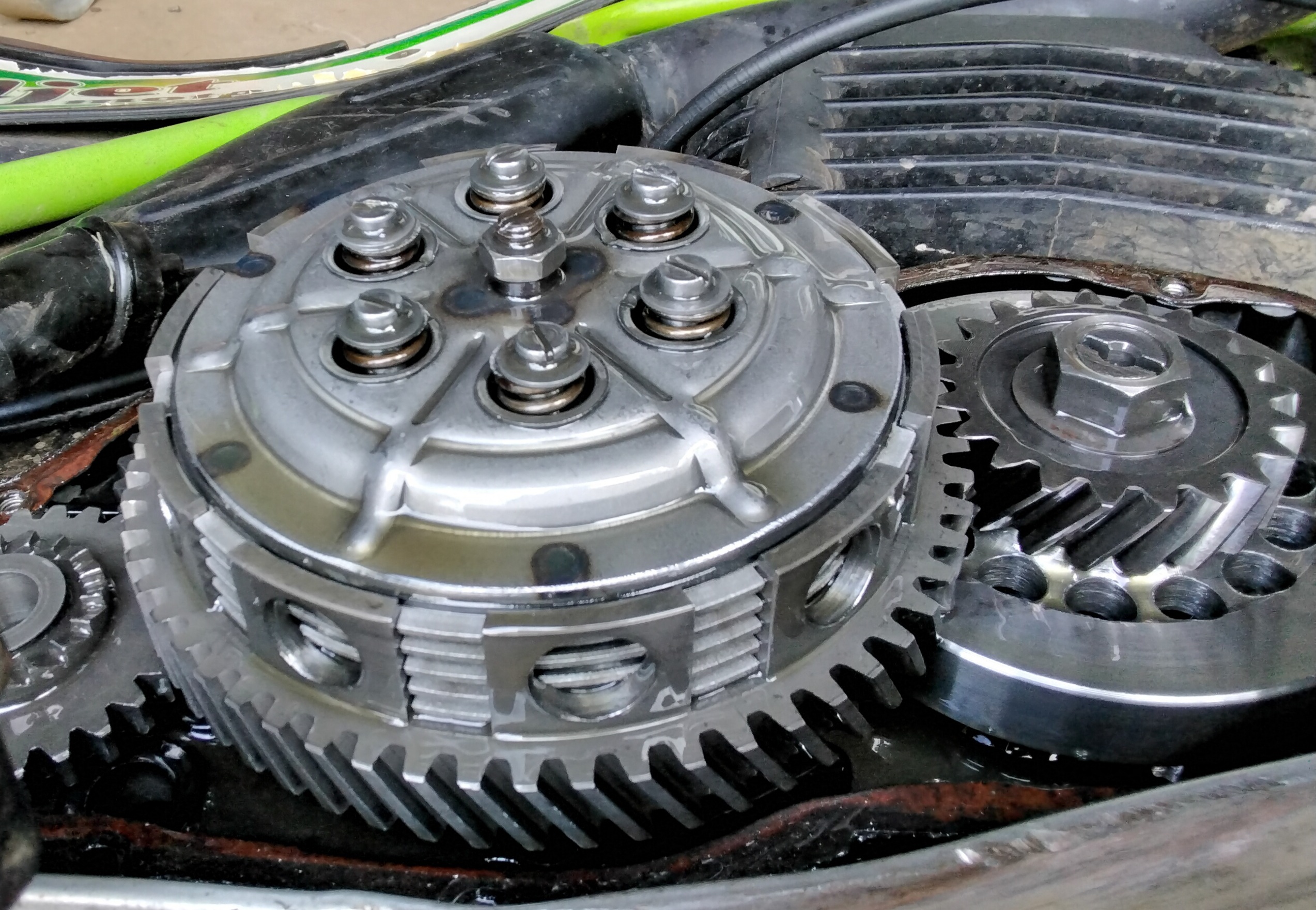

Just sharing where I am up to with the :italjet: hand catapult, after snapping the clutch cable after the first lap at Denman, I have had a bit of a rethink. So now I have gone away from the "acropolis1989" set up:
and hand fabricated an extension to the clutch arm along with a quicker way to adjust the clutch and a new cable:
This works better and Donna can now pull the clutch in but wanting even less effort I decided to back off the pressure plate preload:
Yes Gristy, drilled clutch basket and crank  weights so true Piuma!
In other words, the standard preload was enough to snap 2 cables, (during competition of course) so I backed the preload off 1.4 mm. This was easier again but clutch slipped in higher gears! Then I tried 1.2 mm and this gave me the Goldilocks moment! Happy Days :mrgreen: :mrgreen: :mrgreen:

Very nice clutch lightening mod Greg, on the :italjet: .
What are the heat affected marks on the clutch pressure plate?

Kurt wrote:Very nice clutch lightening mod Greg, on the :italjet: .
The pressure plate is made up of pressed sheetmetal spot welded together.
