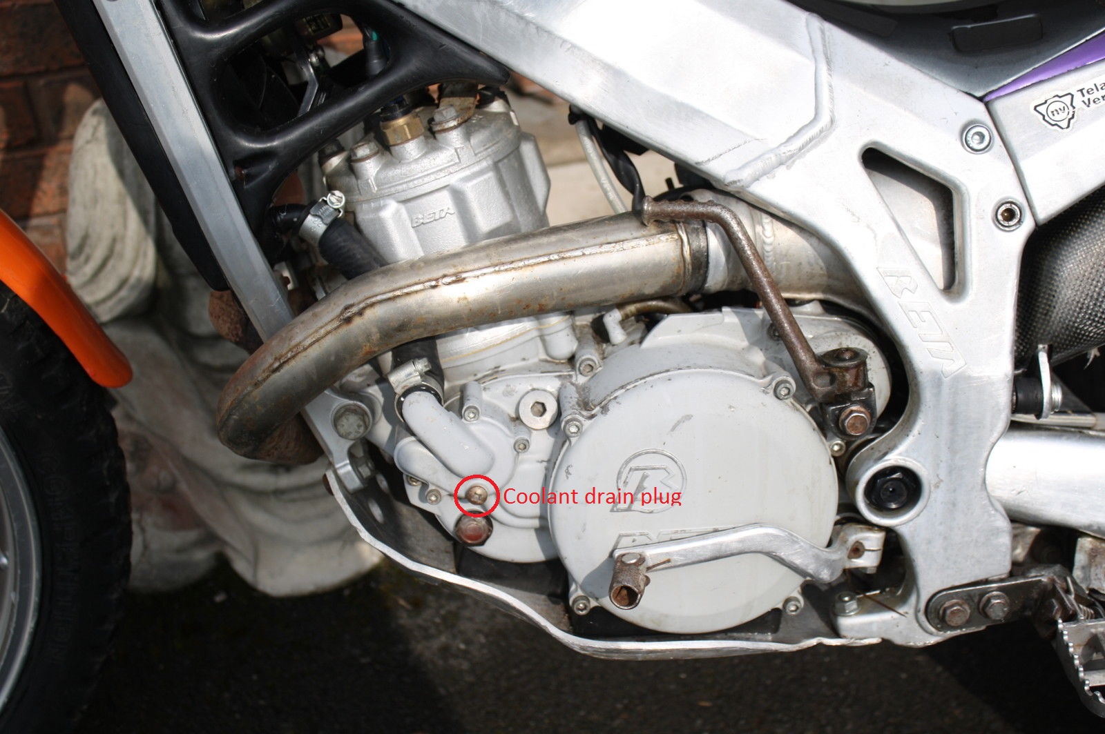

I could not find how to drain coolant fluid on service manual.
So, I removed fluid with injector. Some fluid remained.
I had set up a resin sheet and a bottle as shown attached photo.
I tried to replaced with thermostat not to leak fluid.
I made it. There was not fluid leaking.

This is the coolant drain plug.
coolant drain plug.jpg (354.66 KiB) Viewed 16682 times

Thanks, PA.
I could not find coolant drain plug on parts list.
I will be able to drain as instructed next time.

Just make sure you remove the top filler cap on the radiator as well when you remove drain plug.
Also you can wire up the Thermo switch either way as it is just a tool to complete or disconnect the circuit. It does not have to be polarity dependant. The fan does, but the thermo switch doesn't.
