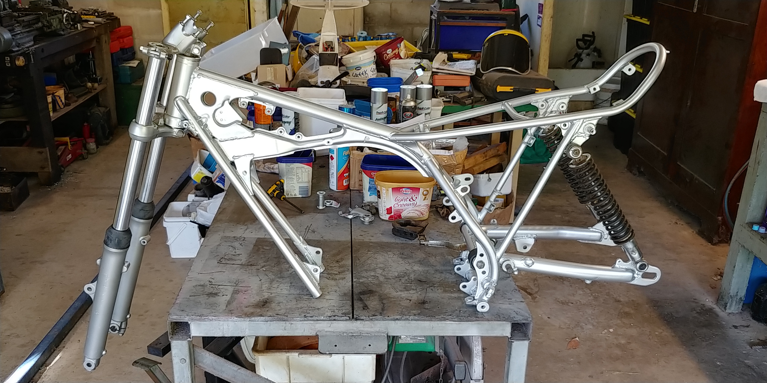

It's a weekend again so I've been having fun there again and done a bit of assembly on the Peter Paice bike

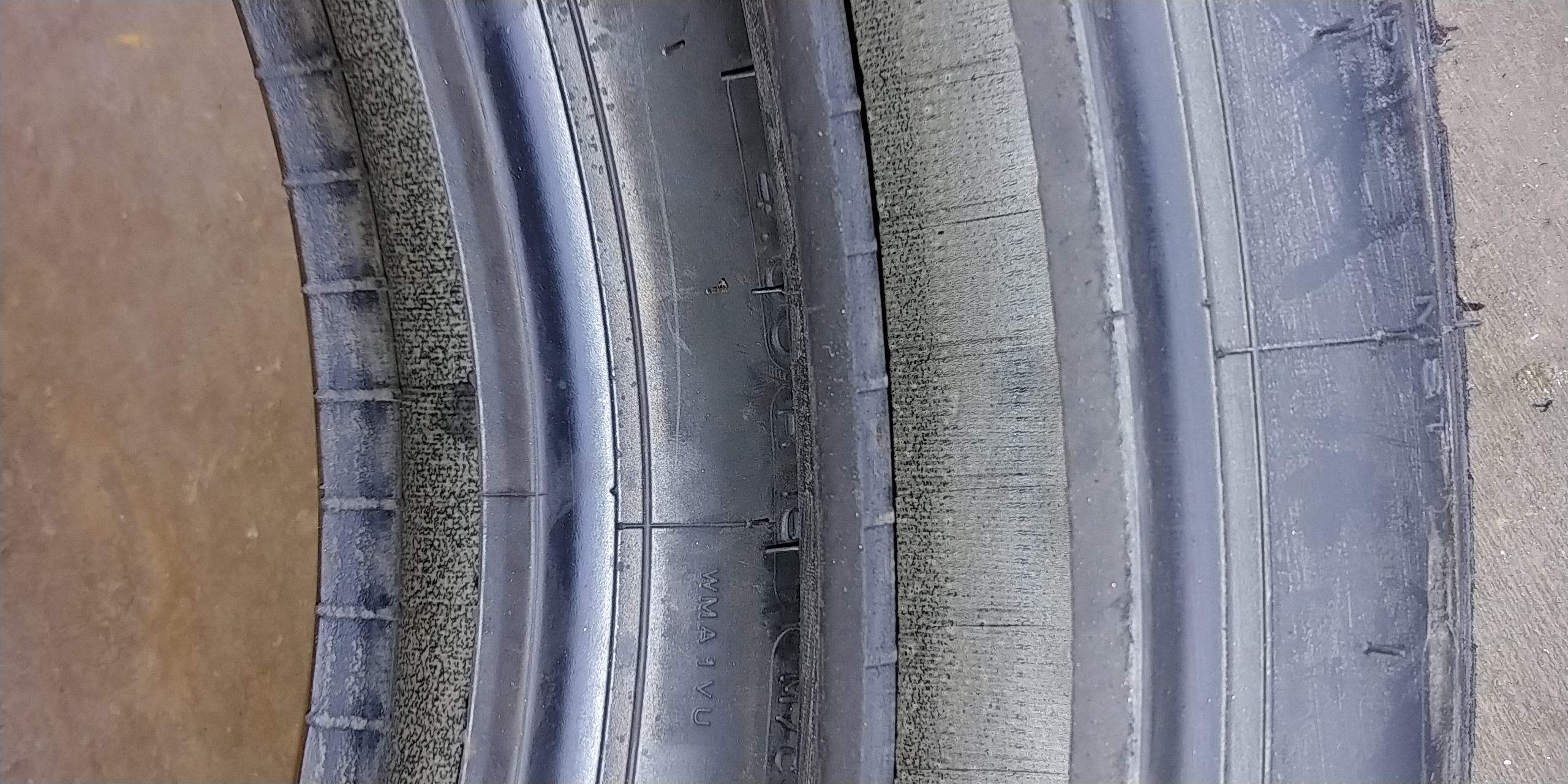

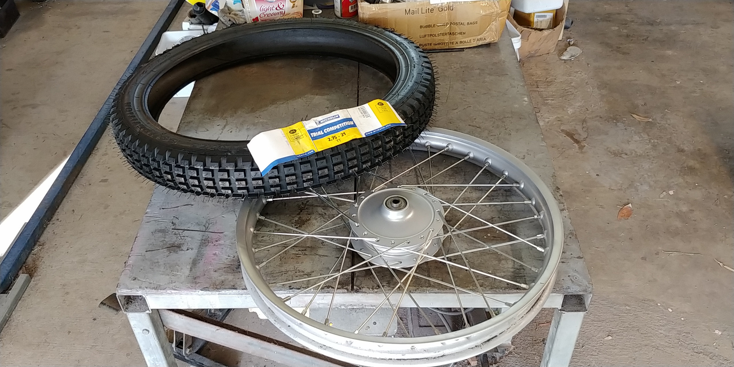

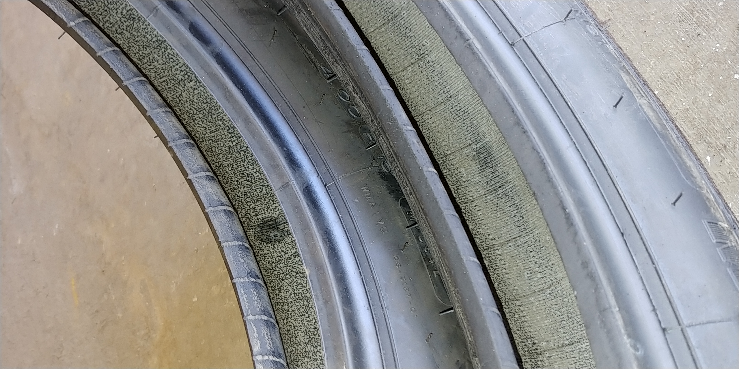

When I got to fitting the rear tyre I did my usual modifcation to the beads.
Some tubeless tyres don't like staying up on the bead seat of some tube-type rims at low pressure.
The combination of Michelin X11 tubeless and TY250B rim is one of those combinations. In the photos I've tried to show how I've taken off the wedge-shaped part of the tyre beads.
The photo shows a new untouched X11 and a new X11 that I've reshaped the beads on.
