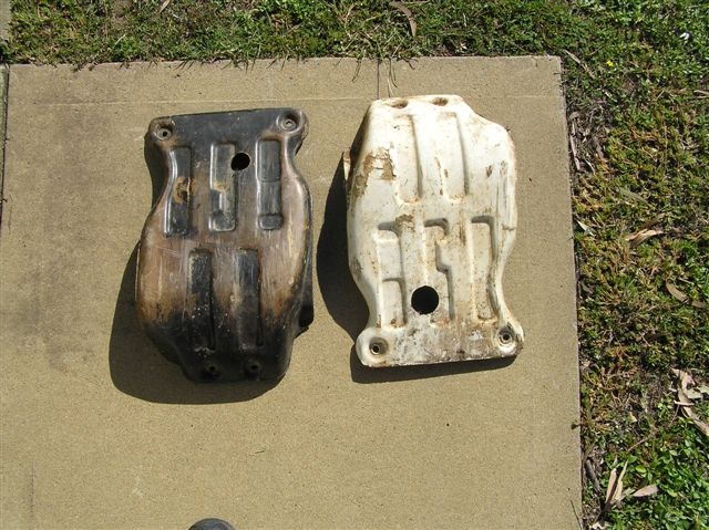

My 250A came without a bash plate so I made my own. Can someone supply a picture of the original type?

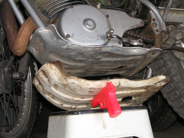

I can send you a photo of an original TY250A bashplate if you want. It is pretty much the same shape as for the TY250B,C,D,E except the A model bashplate is made of fibreglass! I'll take a photo over the weekend and post it on this thread.

Thanks for the bash plate pictures. I would be a bit worried using the same bash plate on an A as a B. As you know the A has much wider casings so my bashplate is wider at the front to protect those precious casings.
