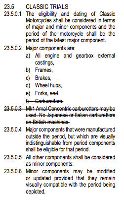

All the rules are available to read online at the Motorcycling NSW website.
The trials specific link can be found here:
http://www.ma.org.au/fileadmin/user_upload/Documents/MOMS/2013_MoMS_Files/2013_MOMS_VERSION_2/CHAPTER_23_29JAN.pdf
The specific Classic trials rules as listed (this year - 2013) are below.
Screen Shot 2013-08-31 at 8.25.25 AM.png (48.77 KiB) Viewed 5302 times

Re: Classic Trials rules in Australia - who is interested?
There's also Rule 23.2.1.1 e) and f) relevant to Classics & Post-classics:
e) Classic - for machines manufactured
before 1965 and excluding machines
manufactured in Spain,
f) Post Classic (Twin Shock) - for
machines manufactured before 1986.
The machines may not be fitted with
disc brakes or mono-shocks,
and 23.5.0.7 d) (iii) that's relevant to Classic specials:
iii) Pre-1965 machines that have
been modified so as to provide
a ground clearance or chassis
performance more in keeping
with this era shall compete as
specials in this Post Classic
category
(The whole of 23.5.0.7 is relevant to classics)
yorkshireracer wrote:Couple of questions about your rules if you could answer please -
1. Do the frames have to be made from original materials or can you use modern materials (ie chrome moly) ?
2. Can you put any engine in any frame or do they have to be same ? I'm building test bike using a Suzuki TS250 simply because that's what I have kicking about so does it have to be a Suzuki frame ?
3. On a tangent, I know there as been some mention of chinese frames, what about chinese engines in EXACT replica 60's / 70's frames if the engines where a similar power output to the original Brit/ Jap motors ? Or is this opening a whole knew can of worms ?
I'm just putting it out there as a cheap alternative to the cost and availability of original engines.
Under the current rules, giving best case & worst case interpretation:
(I numbered yr Q'ns for easy reference)
1. The relevant rule is 23.5.0.4 ie major components "manufactured outside the era" must be "visually indistinguishable" from original to be eligible. Hard to prove diff material, since it would be "visually indistinguishable", but it maybe argued that its not in the spirit of the era, if its known that its cro-mo/531 etc. Tho such materials were available back then, they weren't used in production models to my knowledge. You might leave yourself open to the bike being classed as a special & pushed into Twinshock category under rule 23.5.0.7 d) (iii).
2. A reasonable interpretation of 23.5.0.4 would allow engine swaps I would think, if only the engine mounts are changed, but a strict interpret'n would say the frame is no longer "visually indistinguishable" if they are changed.
If original engine mounts were left in place & adapter plates used you'd be safe I would think.
3. Again the relevant rule is 23.5.0.4 If the engines are "visually indistinguishable" from the originals (eg like Indian built RE Bullets) I'd think you'd be right, but the chinese-copy Jap engines I'm familiar with are visually diff, mostly in the outer engine cases
