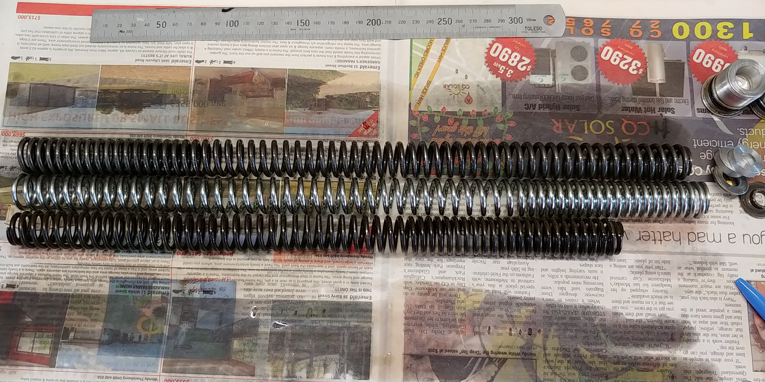

I have been quite happy with the action of the modified forks on the :kawasaki KT so decided to try the same setup on the Majesty forks. The KT has aftermarket TY250 aluminium damper rods and TY250 Magical springs. Compared to standard TY250 damper rods, the aftermarket damper rods have smaller damping holes and are a bit longer.
So for the fork testing on the Majesty, I first fitted a set of the TY250 aluminium damper rods and ran with the shortened B&J racing springs that had been used in the Majesty TY forks with the Gold Valves. In Motion suggest to use 10W oil with those damper rods so I did that. The action was very nice indeed.
Then I tried Magical TY250 springs with the same 10W oil. Also very nice action but not quite as much bottoming resistance as with the B&J springs.
Then I tried the Magical TY250 springs with 15W oil. Still very nice action and slightly more bottoming resistance when dropping down a step big but not as supple on small stuff as with the 10W oil.
That's where I'm at, trying to decide which oil and springs to use with the new damper rods.
While I had the springs out, I measured them up and worked out their rates:
Standard TY250 spring (dual rate spring) initial rate 0.26 final rate 0.42. Spring travel to reach the higher rate 137mm.
Magical TY250 springs (dual rate springs) initial rate 0.36 final rate 0.54. Spring travel to reach the higher rate 134mm.
B&J Racing TY250 springs shortened by about 8mm (single rate springs) 0.39
If anyone wants to do their own calcs on the springs here are the relevant dimensions:
Standard TY250 springs OD 24.95mm - wire 3.4mm - wide spaced coils 35 - total coils 57 coil - gaps in close coil 2.4mm
Magical TY250 springs OD 24.6mm - wire 3.6mm - wide spaced coils 37 - total coils 56 - gaps in close coil 2.4mm
B&J Racing springs OD 24.8mm - wire 3.75mm - coils 60

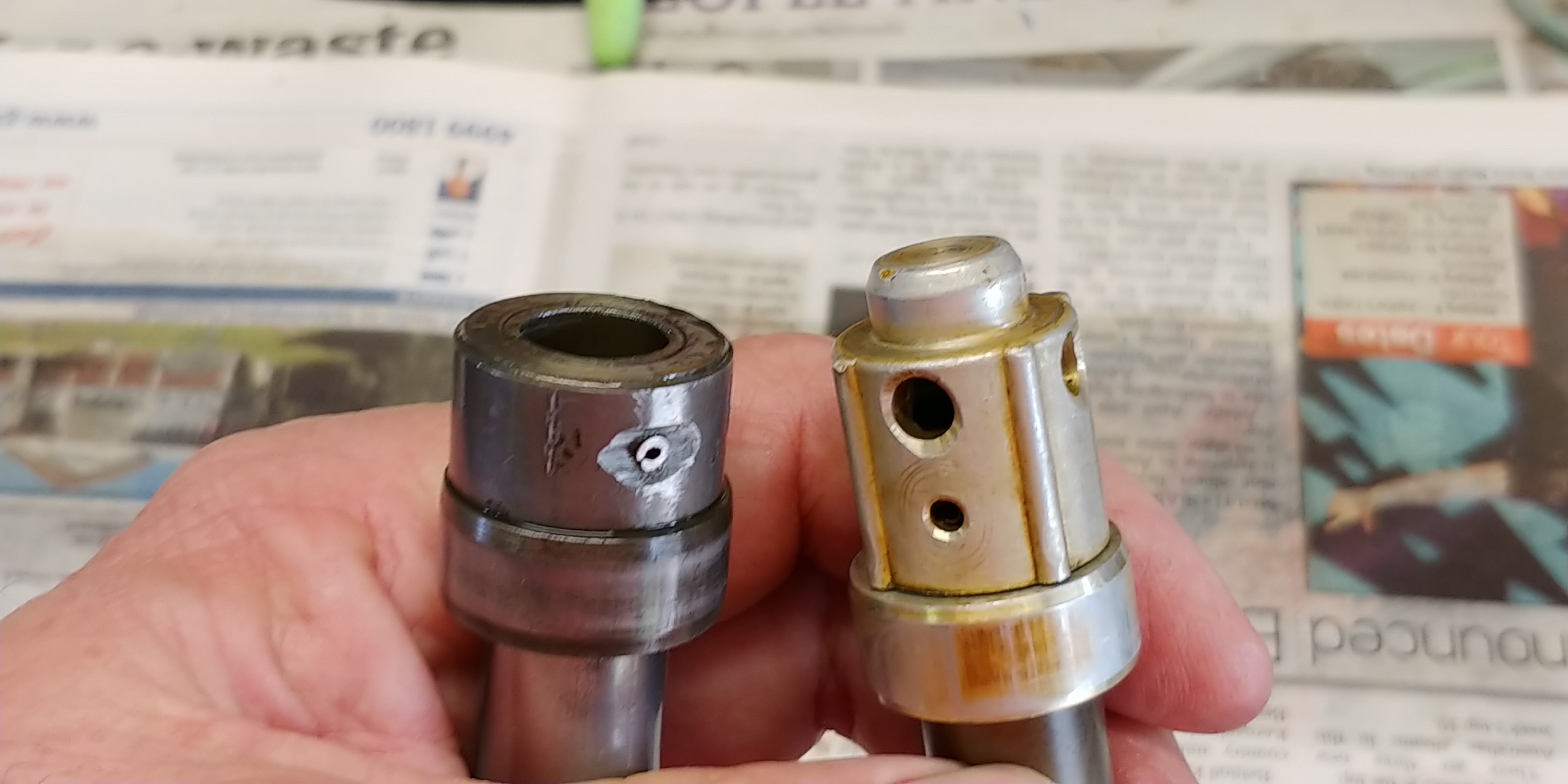

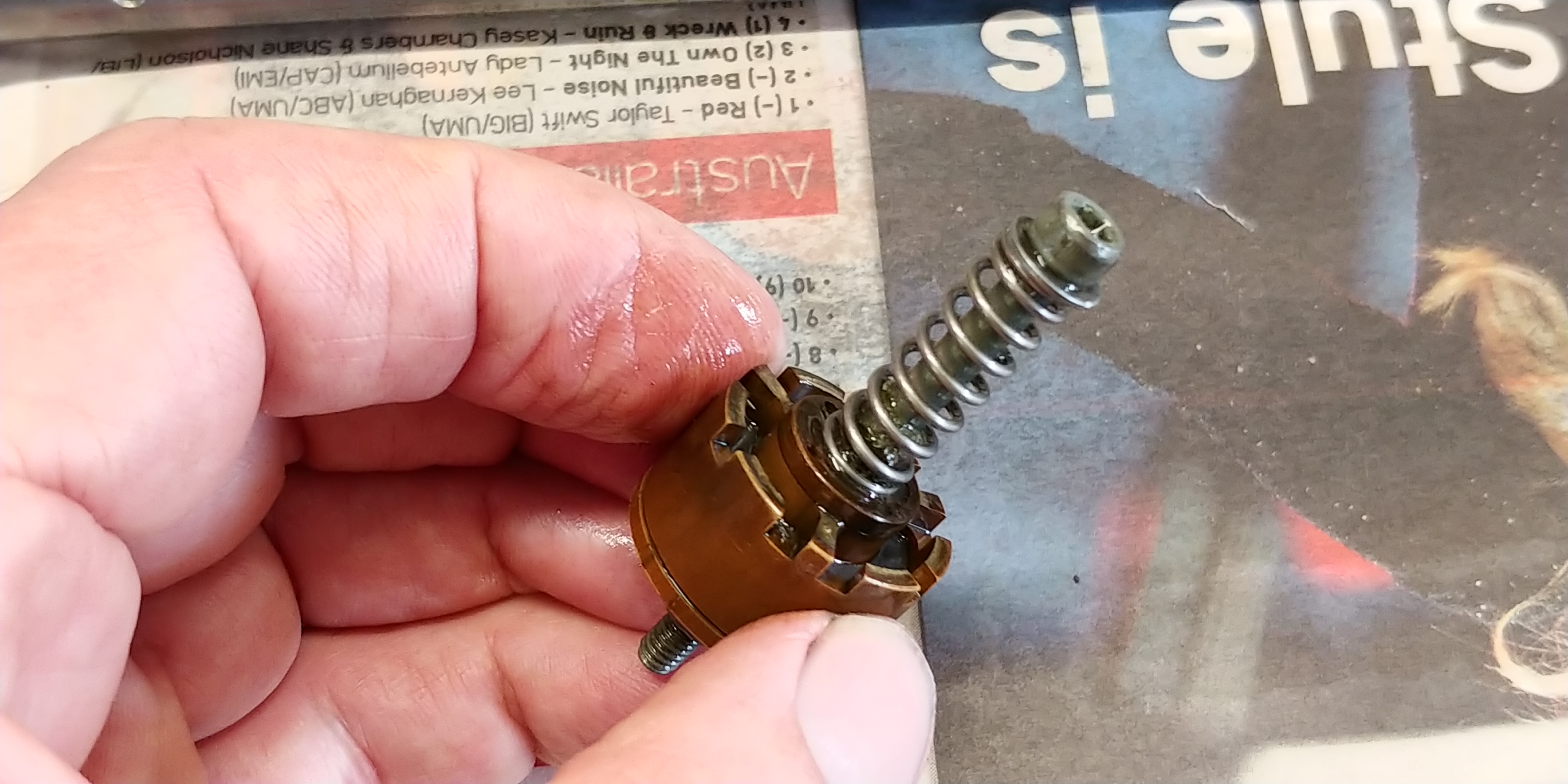

Racetech Gold Valves for mid 1970s 34mm KAYABA forks
This posting is to show what Gold Valves look like compared with what's inside standard mid-1970s KAYABA 34mm forks.
The insides of :yamaha TY250 and :kawasaki KT250 forks are very similar and both are made by Japanese suspension company KAYABA. The inside diameter of these forks (where the damping pistons run and the springs go) is 25mm.
Other Japanese dirt bike forks from the 1970s are very similar inside.

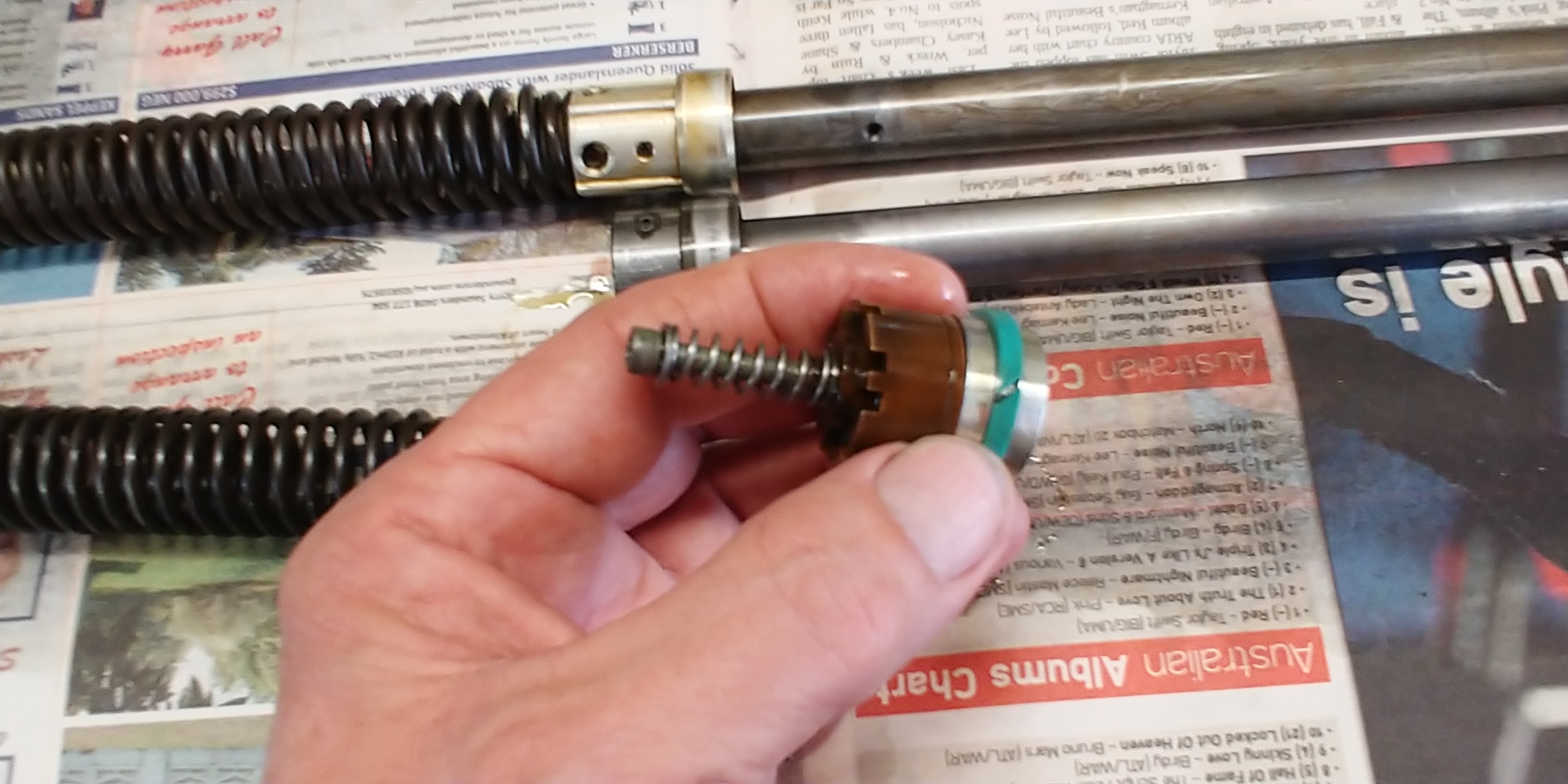

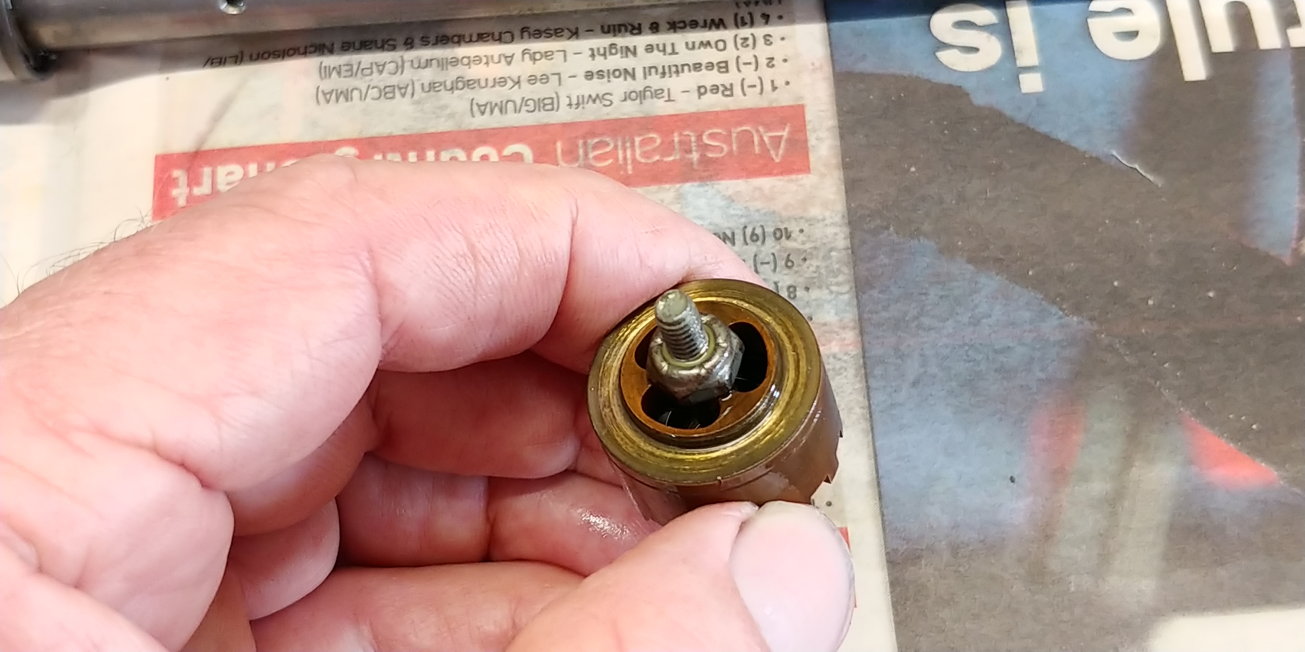

Race Tech make these Gold Valves primarily for MX and Trail bikes that use the fork damping technology of the time, developed by Ceriani in the 1960s and copied by other manufacturers. The Ceriani design has one fixed rate for compression damping and one fixed rate for extension damping. The Gold Valve concept is to provide the ability to tune the damping of the forks and to provide compression damping that is rate-sensitive. Rate sensitive means that if the forks are compressing very fast, there is less compression damping than when the forks are being compressed slowly. Landing from a jump causes slow compression. Stutter bumps cause fast compression. The rebound damping rate is fixed which is a standard thing on suspension because fork extension damping does not have to deal with things like landings from jumps.
The little spring on top of the gold valve pushes on a plate valve that restricts the flow of fork oil as the forks compress. The faster the forks compress, the further open that plate valve moves. There are different rate springs you can use and the spring preload is adjustable too. This spring is the lightest of the springs supplied with the gold valve because it's a trials bike and you don't want much compression damping compared with an MX bike. Even with the lightest spring, I had the spring preload wound back almost to minimum.

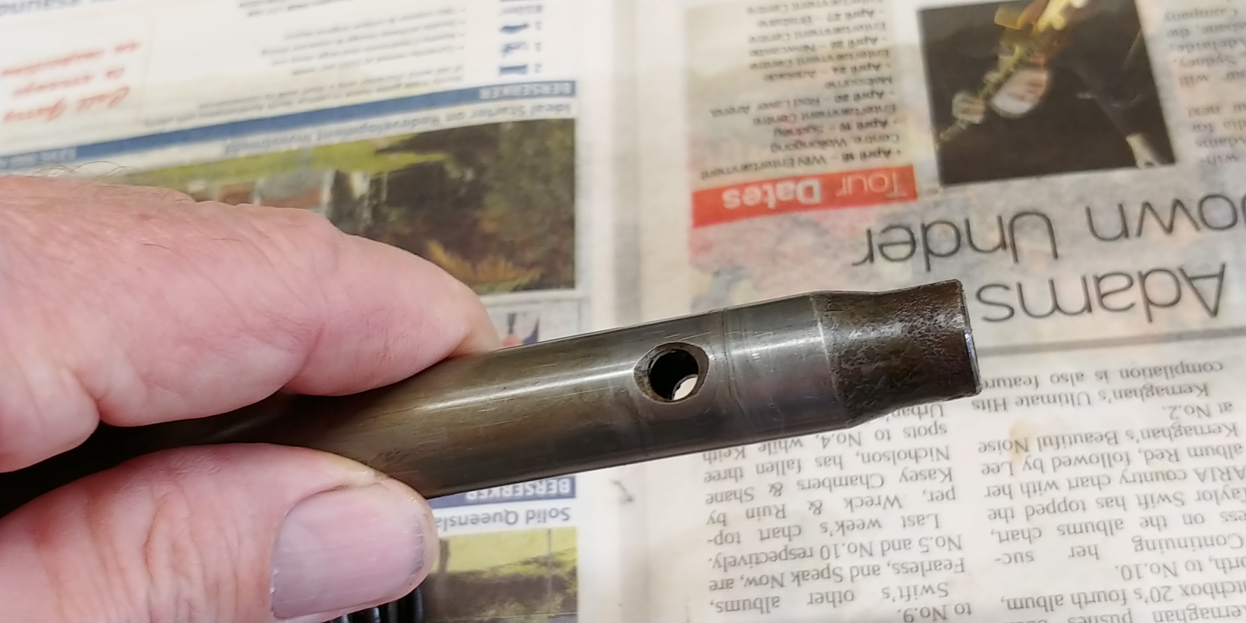

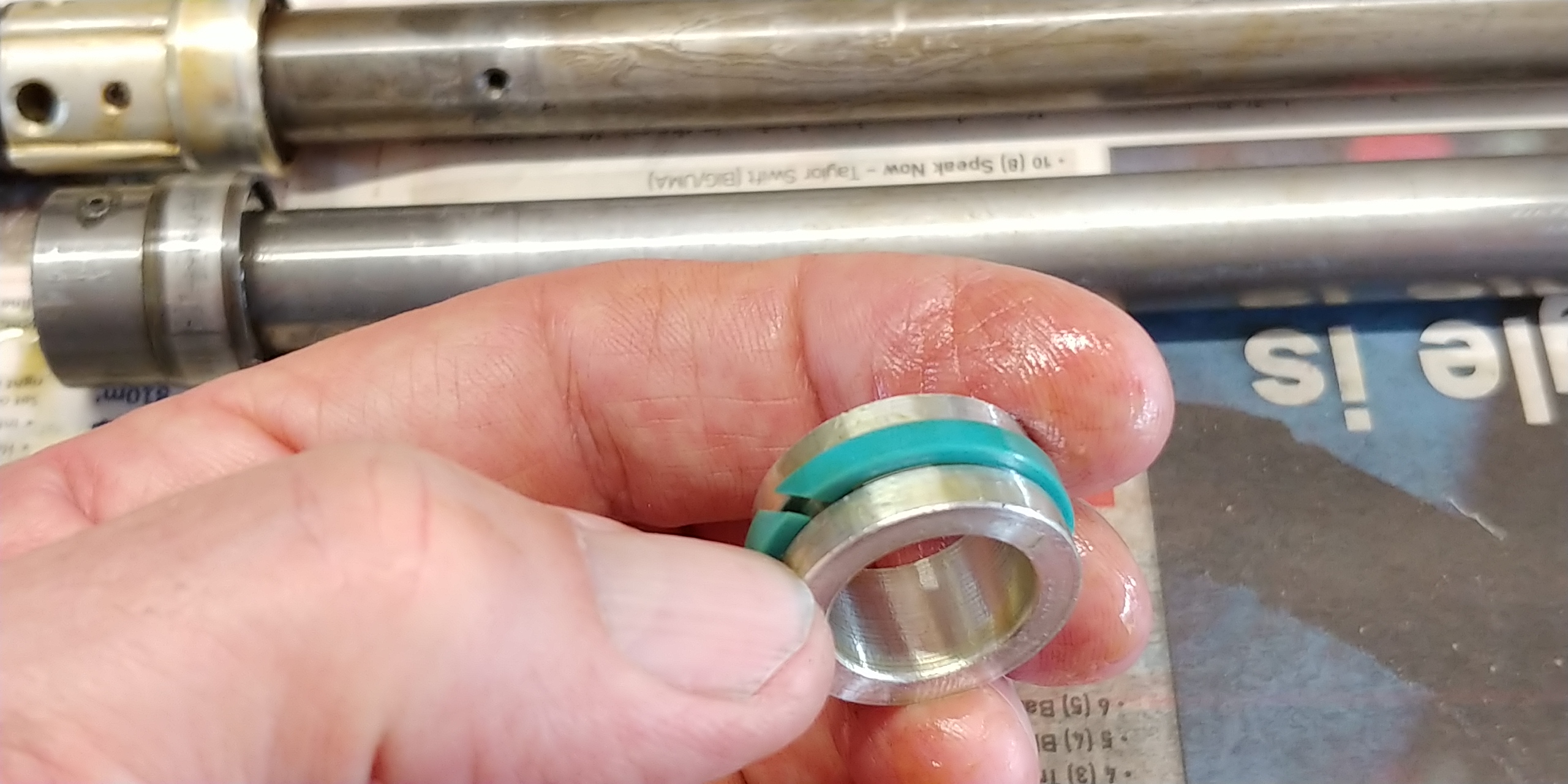

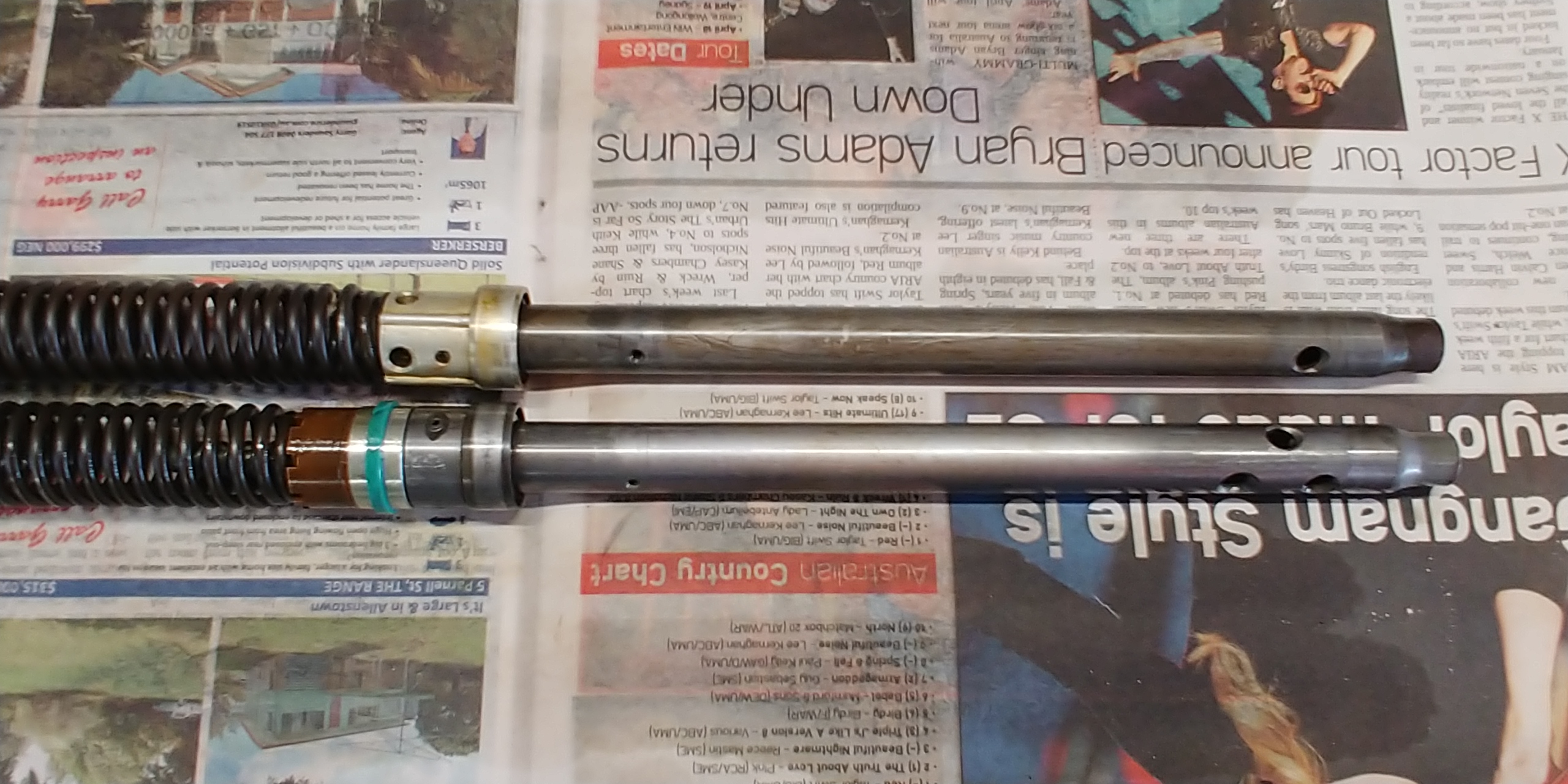

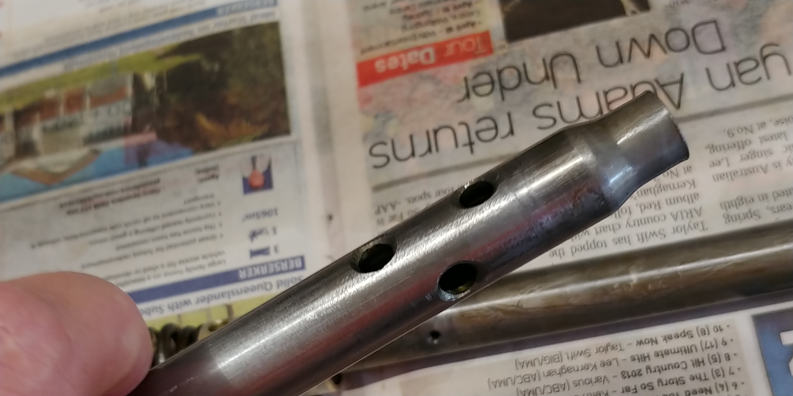

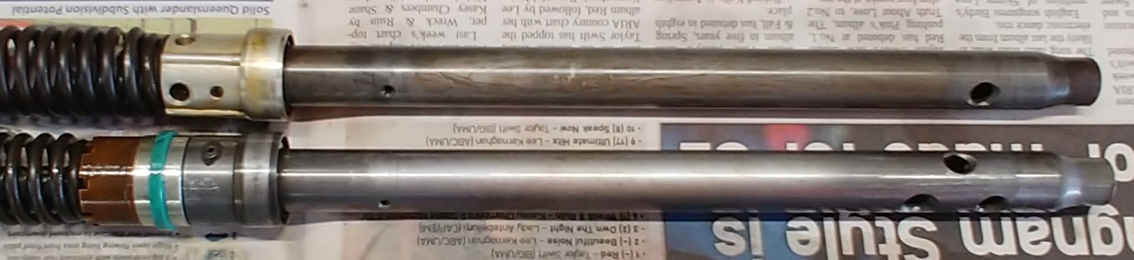

Here's a series of photos to show the various differences between a standard damper rod and a standard damper rod that has been modified to fit the Gold Valve.
The important differences are that the modified damper rod has a lot more holes in the bottom end, has had the top machined off and has a big hole through the middle of the top end.

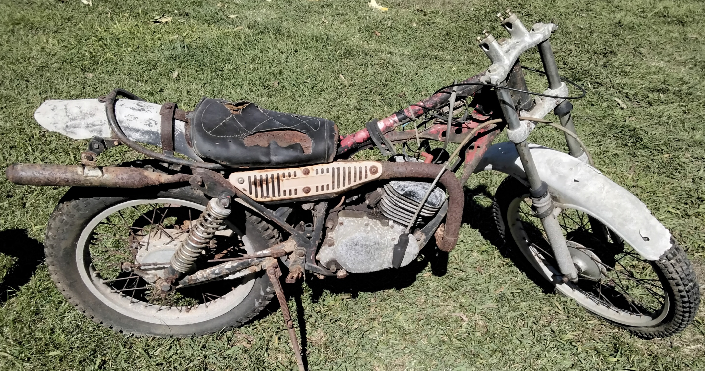

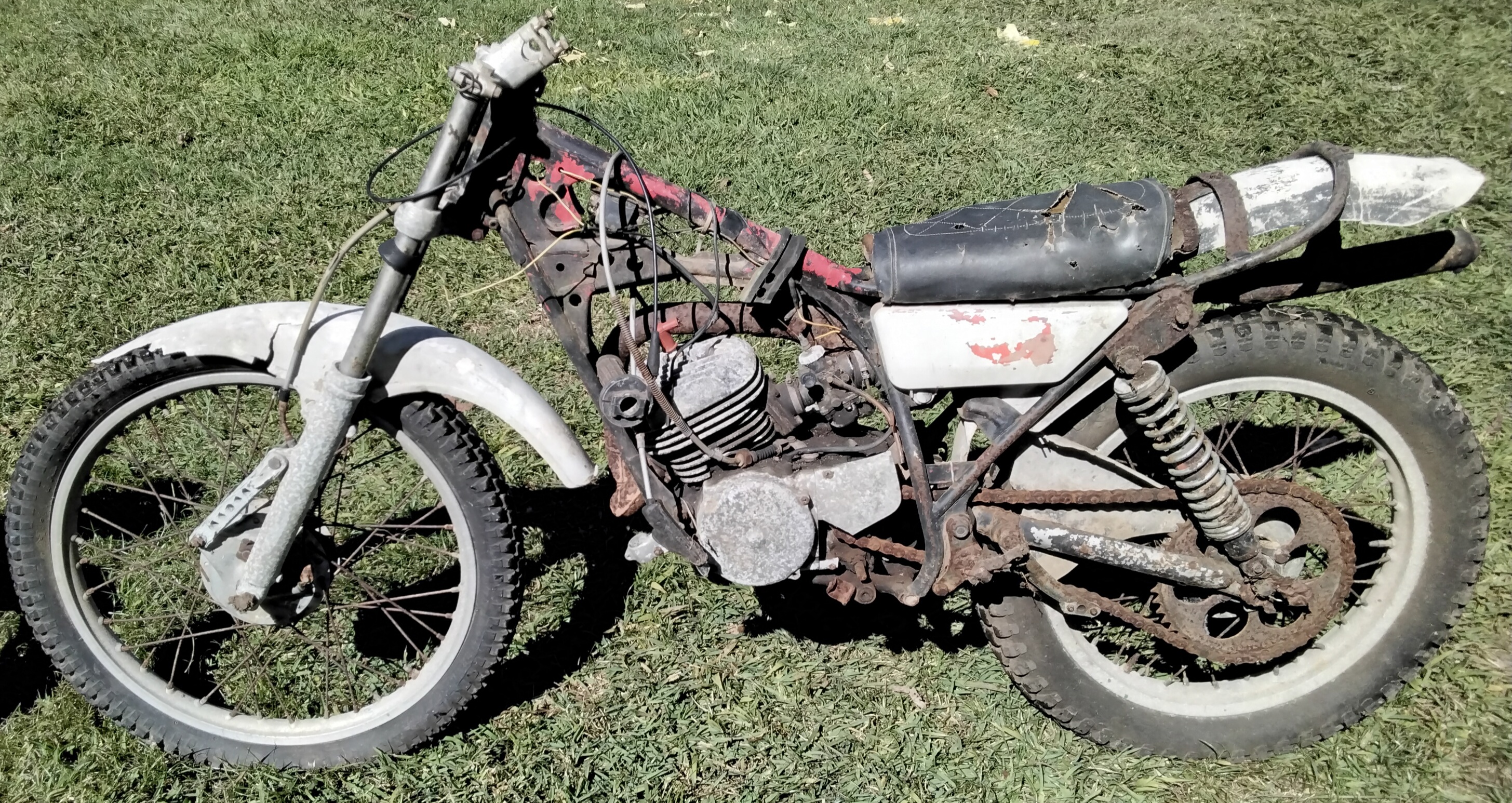

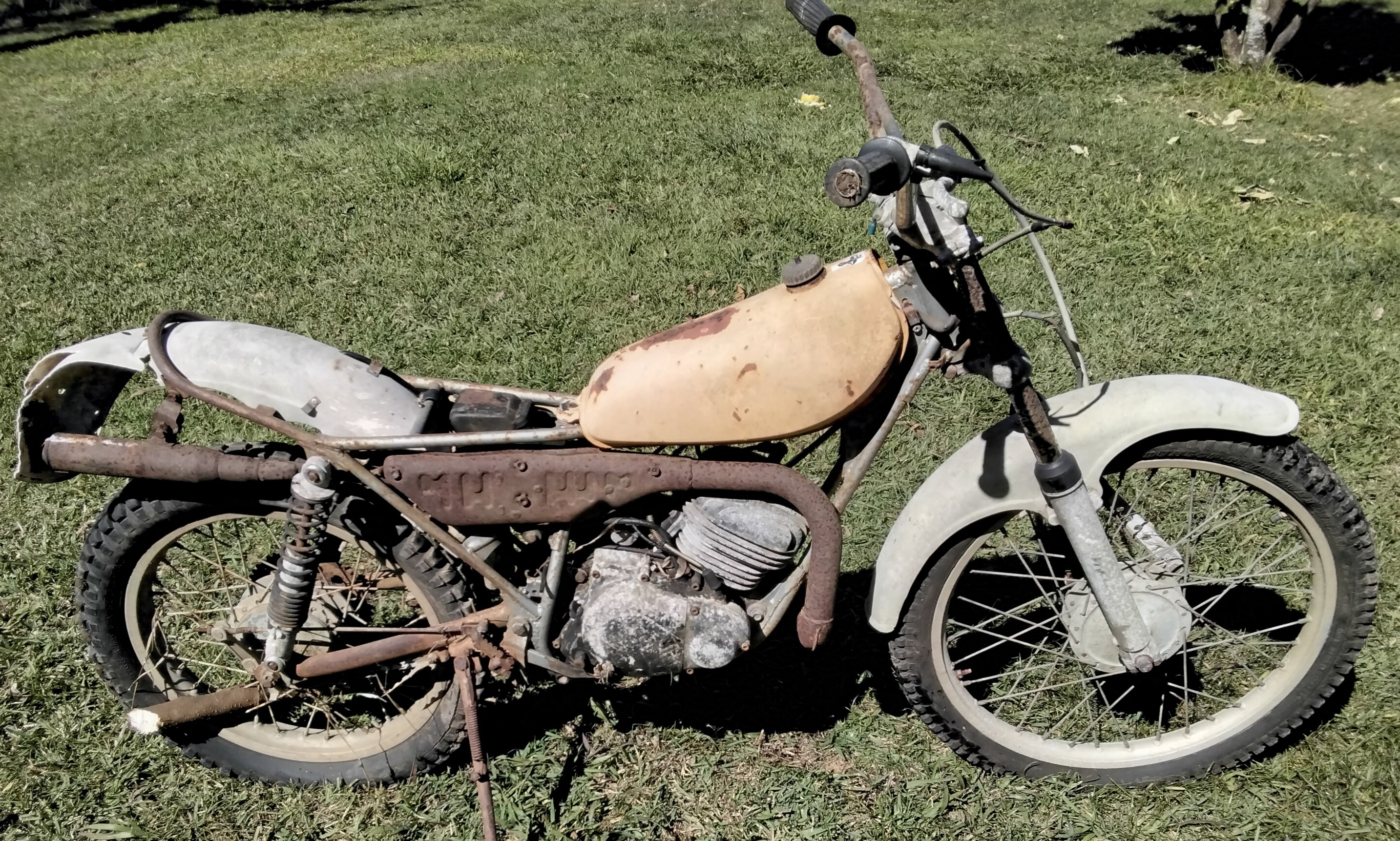

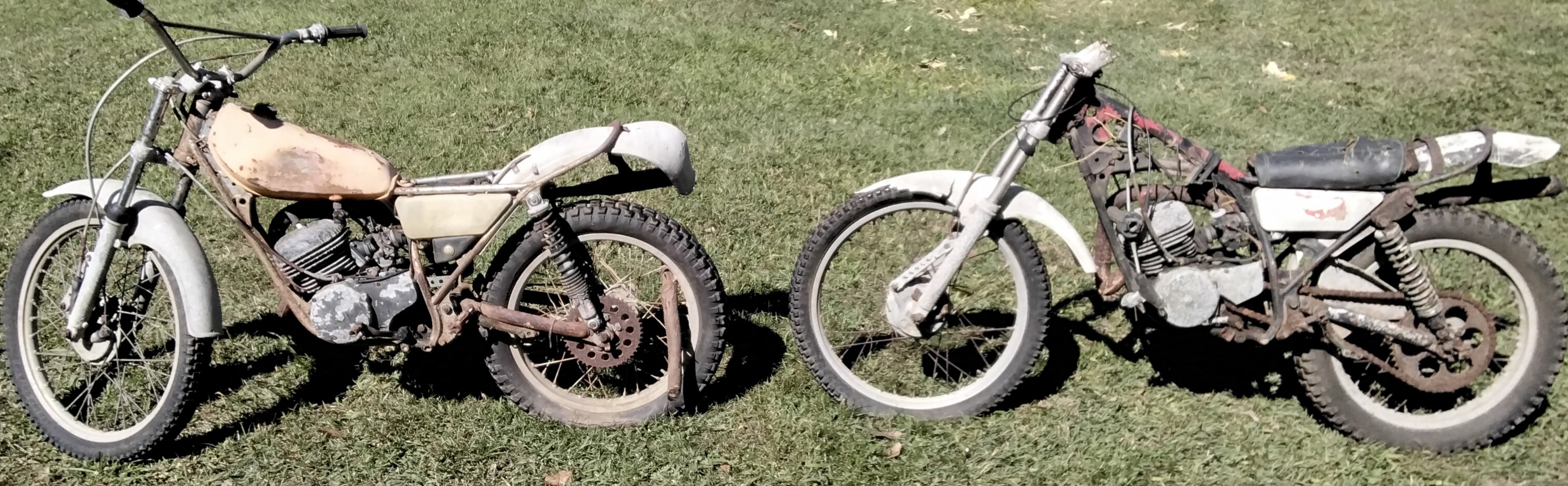

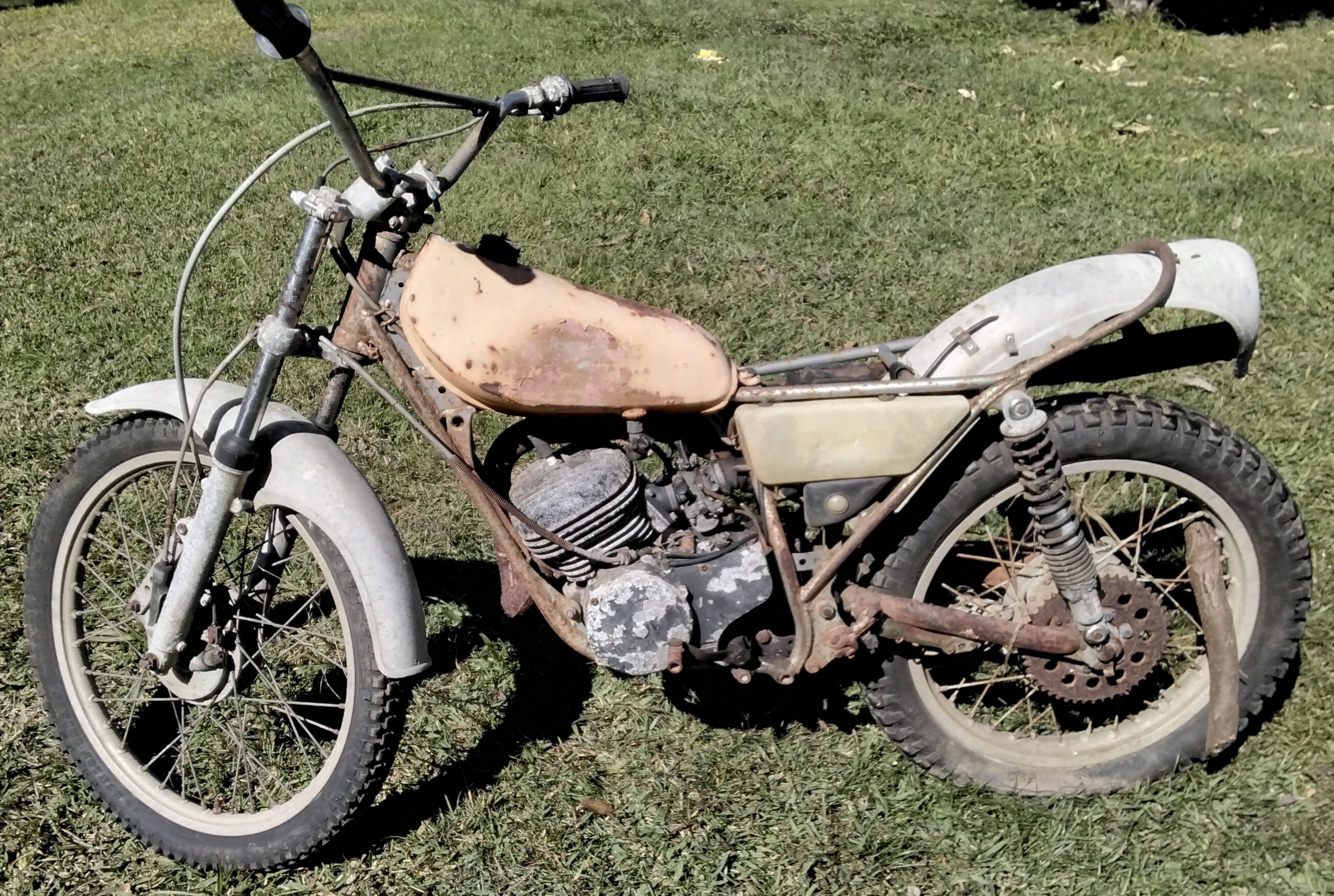

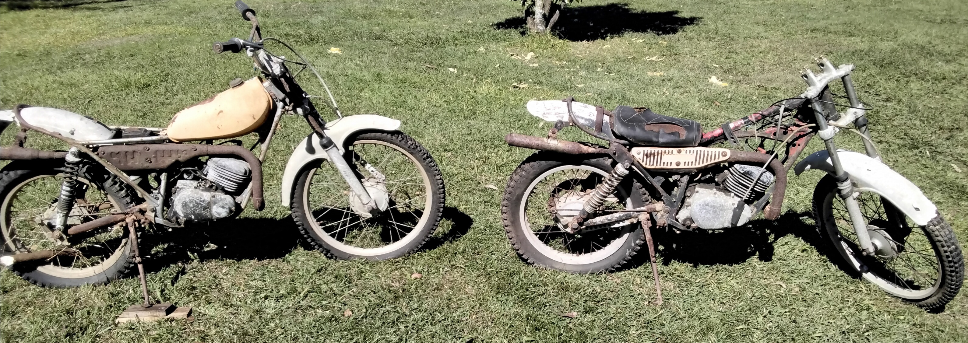

While we are on :yamaha , I just picked these two glamorous TY 175s up:
Anyone got any theories as to why they sometimes come in pairs?
Up for swaps if anyone is chasing parts?

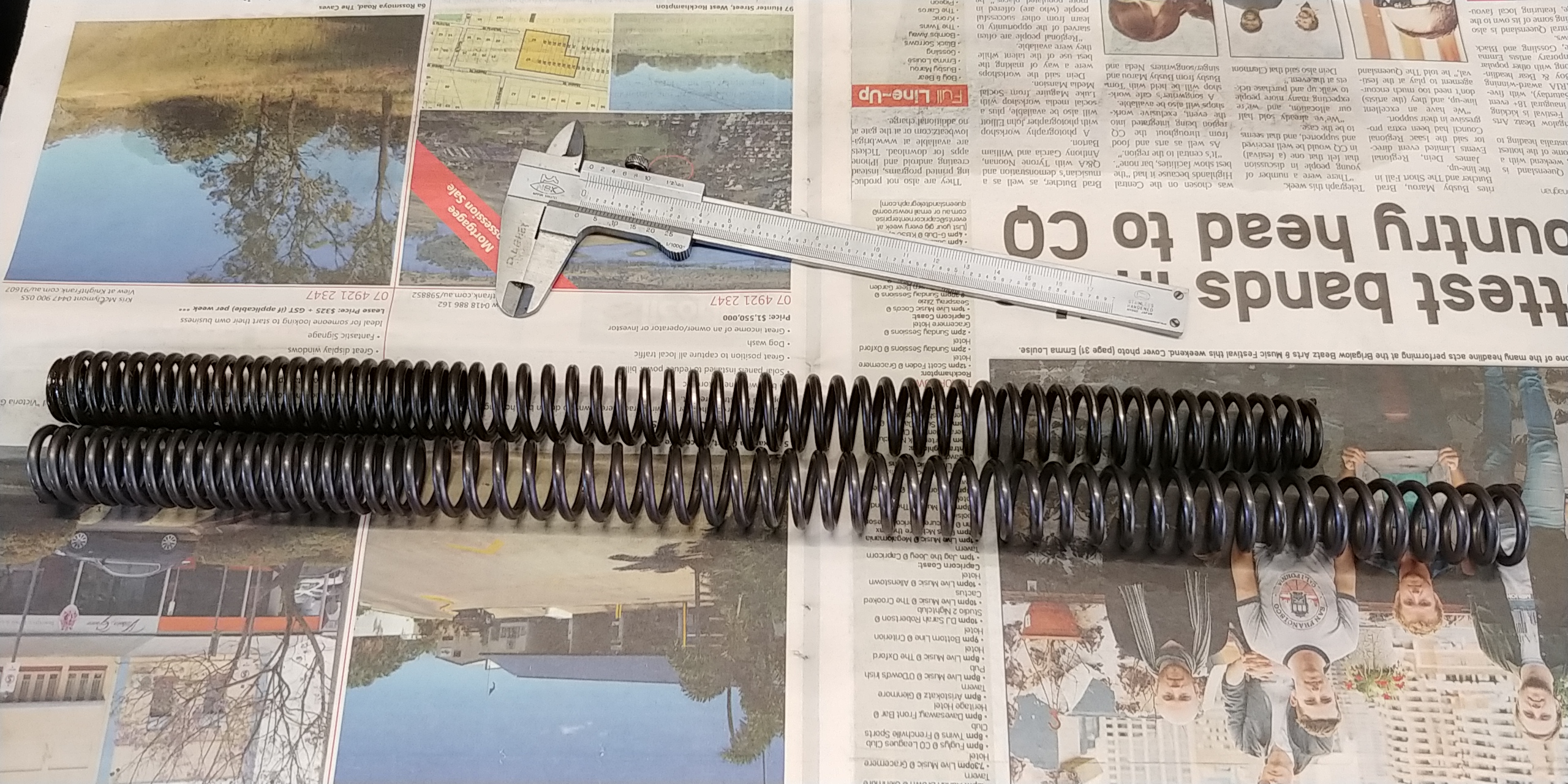

The springs that arrived share all the important dimensions of theTY250 Magicals so they should be exactly what I wanted. They look a bit different because they are not zinc plated. I don't know if they are made by Magical or are exact copies of Magical springs. I'll be giving them a try soon.
Especially for Greg, I weighed one of the aftermarket TY250 springs from France and a standard TY250 spring.
Aftermarket "Magical" spring 295 g
Standard TY250 spring 280 g
