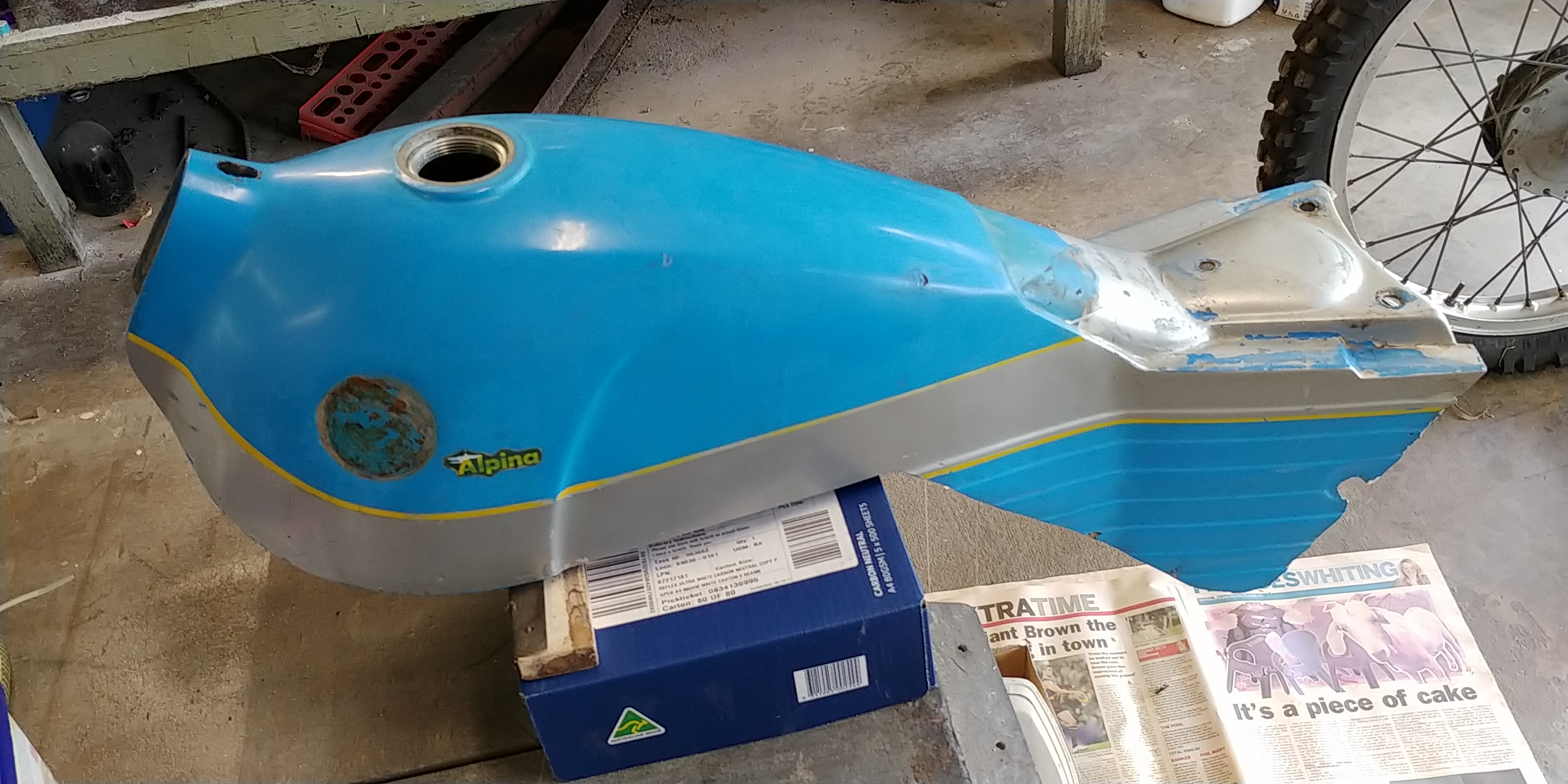

Dave's model 85 tank relining
Posted: Tue Dec 27, 2022 4:58 pm
About a week ago I cleaned out the model 85 Alpina :bultaco: tank to prepare it for being lined with brushing epoxy. I started by washing it out with turps, then dish-washing solution, then a clean water rinse. Previously when doing this, I've then given them a very quick final rinse with acetone but I found this tank very hard to get the last bit of water out and if acetone is left inside it would destroy the tank before it evaporates.
It took about 4 days for the last bit of water to fully dry out.
Today I blocked off the outlets and set up a spot to rest it while the excess epoxy was draining out.
I then mixed up 600 ml of West Systems brushing epoxy and coated all of the inside surfaces by carefully moving the tank around.
The three outlets underneath were then opened and I put the tank in position to drain.
After a couple of hours the epoxy had started setting and I was able to clean the outlets of epoxy. The fuel tap hole thread was cleaned with a thread file. Earlier I had put a thin smear of grease on this thread to stop the epoxy sticking and that worked well. On other tanks being lined I made a plug for the fuel tap hole from plasticene, but I couldn't find any plasticene today. The two 6mm steel fuel balance tubes were then cleared out with a drill.
Of the 600 ml of epoxy that went in, about 300 ml epoxy drained out. It was quite a challenge to coat the inside fully with the 600 ml. More would have made it easier, but I still think I'll use the 600 ml pack again next time I do one.
Before
While draining out the excess
After
