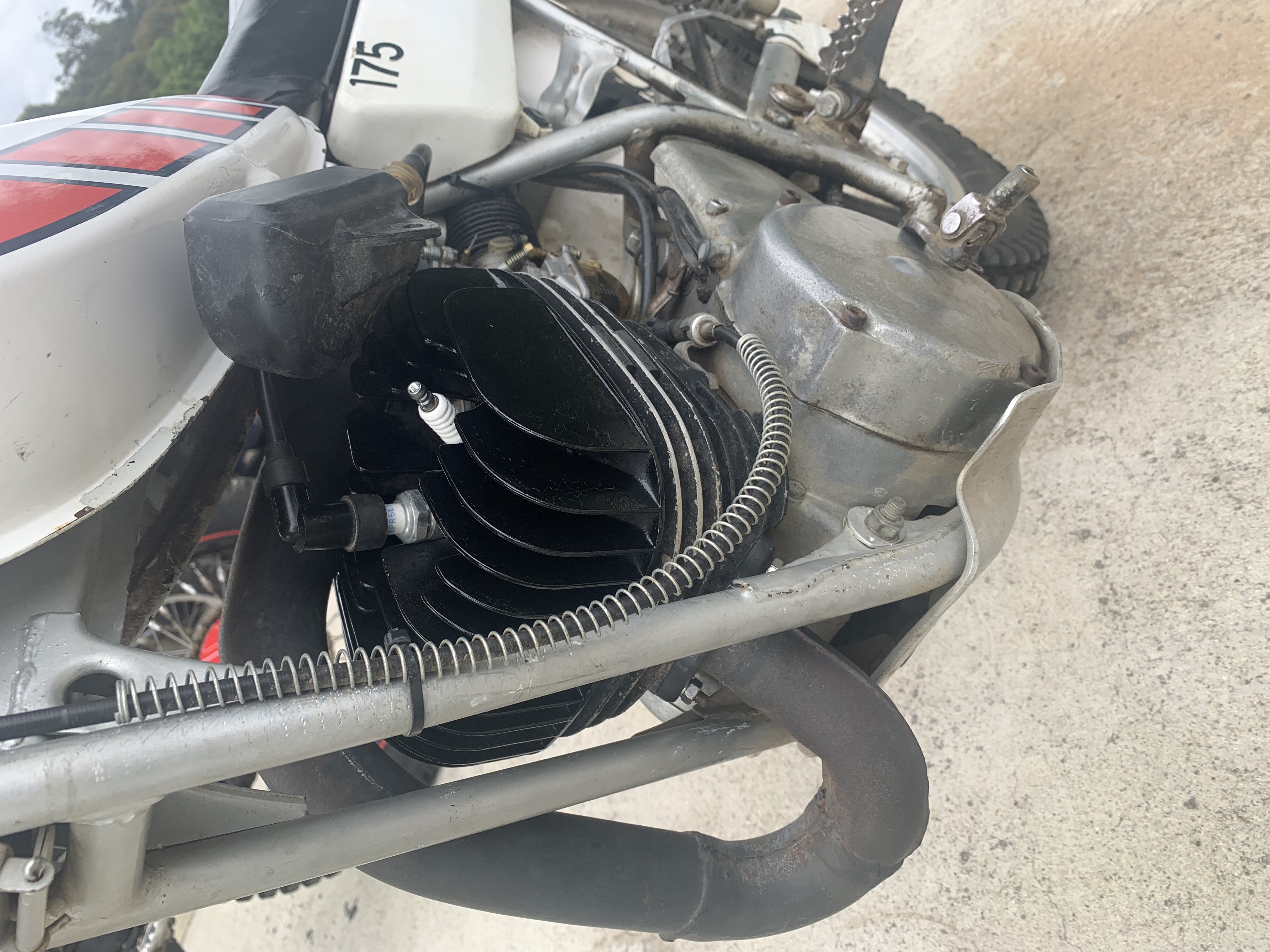

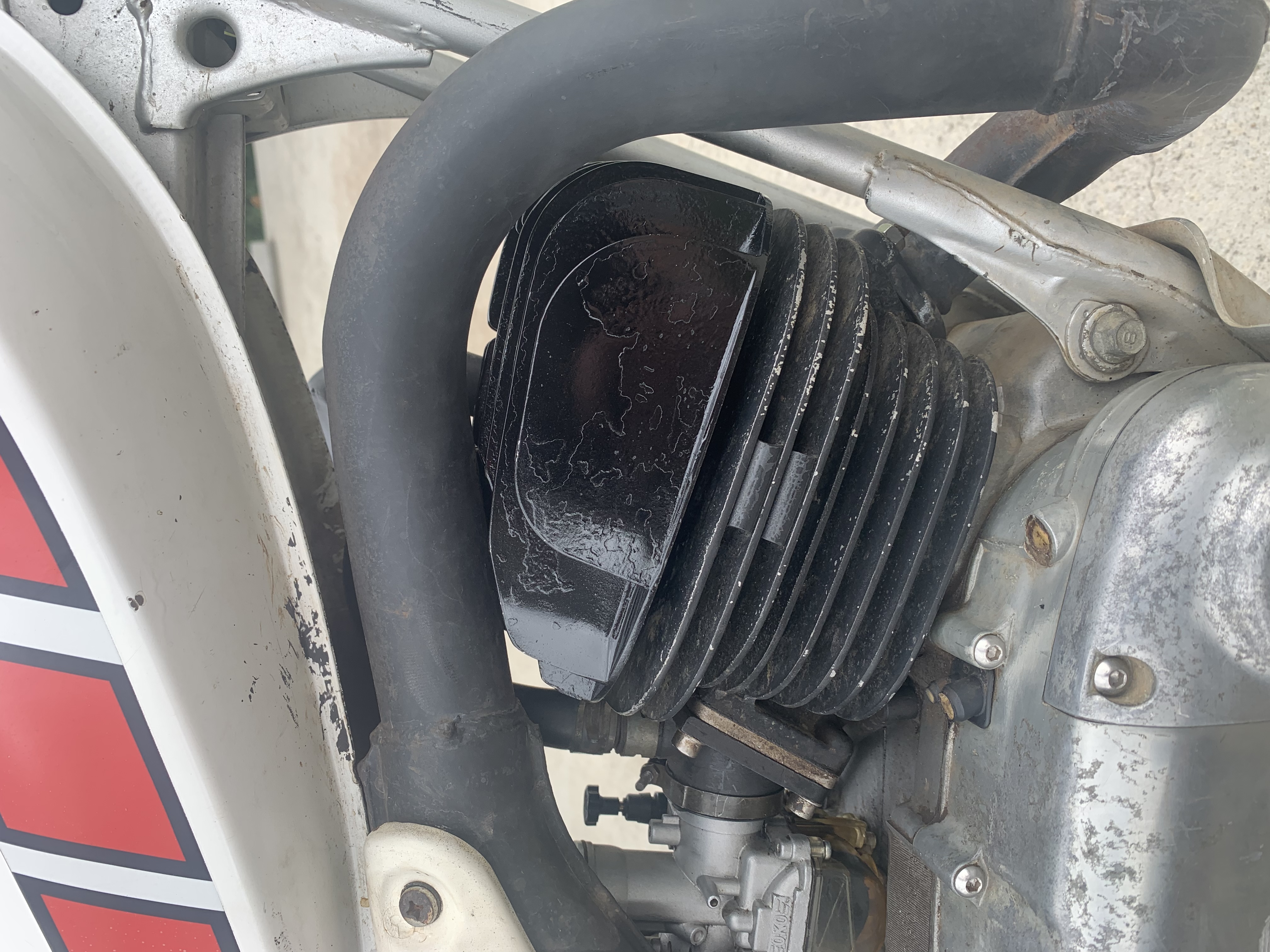

It was discussed in a different topic the possibility of fitting a DT175 head to the TY175.
The DT175 head bolts straight onto the TY175 barrel and although the fins are longer the exhaust header fits with about 4mm clearance.
Based on a quick ride around the front yard it is certainly more powerful off the bottom and that advantage continues through to the top end.
Interestingly the carburation was quite ok with no changes, I will have to take it for a proper ride and see how it goes.
Compression Ratios listed:
TY175 = 5.8:1
DT175 = 6.8:1
Bore and Strokes listed
TY175 = 66 X 55mm
DT175 = 66 X 50mm
Based on my calculations you would end up with a compression ratio of 7.5:1 if you added the DT175 head to the TY175.

Re: TY175 DT175 Head
Posted: Tue Jan 03, 2023 12:06 pm
by Kurt
A typo in the manual I have which I then copied #-o
Which makes the compression ratio the same as the DT175 = 6.8:1.
The power does not come in savagely but the port timing etc hasn't been effected as we have only increased the amount the gasses are compressed.
It is still smooth off the bottom and doesn't seem to want to stall with the extra compression.
Looking forward to taking it for a proper ride.
