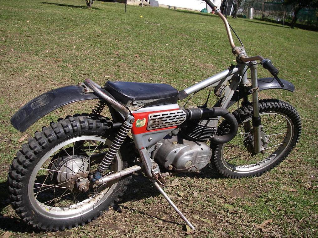

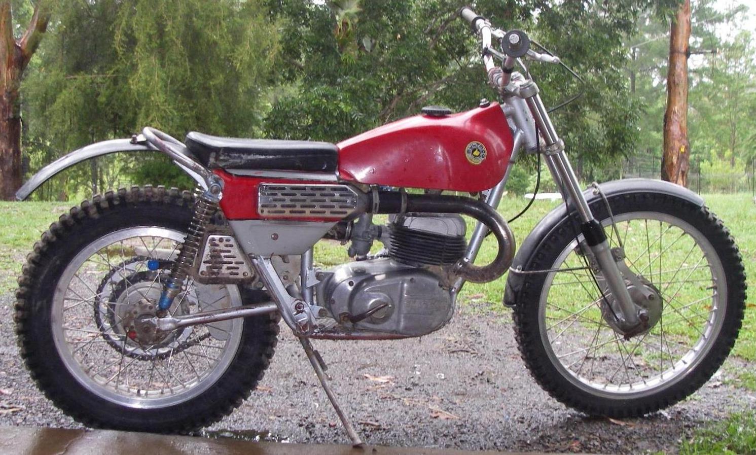

Graham, Pursang you say, they were already on Steve's bike, we were not sure but the tip to tip dimensions were close to what I wanted. And yes the brakes were far from the only thing that is good on your blue beauty!
JC1, you are getting quite a collection of bikes and like me, don't seem fussy about which bikes. Fixing old bikes is character building and you can learn a lot as you go, it seems there is always something to test you!
Thought I would share a before and after shots of Steves M49, he is painting his tank and seat base, so is using mine in the interim. Apparently it belonged to a wild sort of character who raced flat track on it a long time ago.

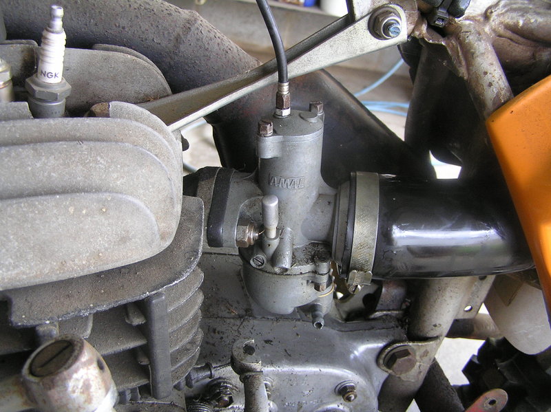

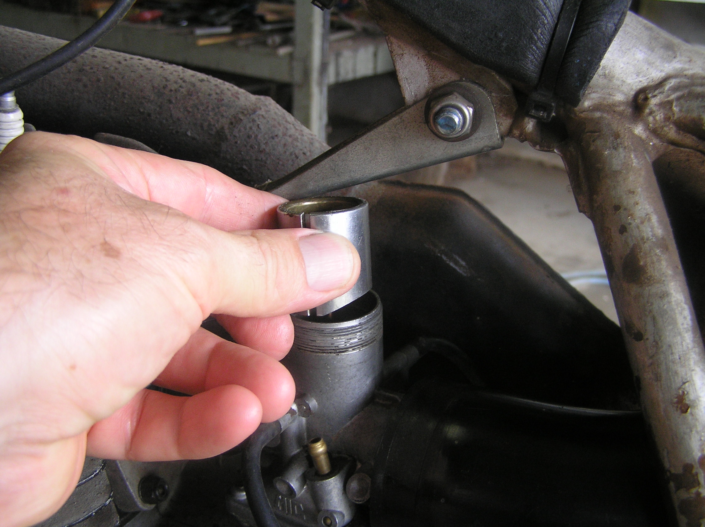

I think this story fits well enough here is Basket Cases. The bike in question was a non-goer with the main problem being it had been ridden to death. The autopsy report concluded that it was the big end bearing failure that was the final straw.
Anyway, this M138 Alpina has been the subject of my attention since about 1996 when it came into my hands as a part-trade for a Suzuki TM125. The motor was soon rebuilt and as part of the work it went from being a 350cc motor to something bigger - 370cc I think - because the only piston I gould get was from an uncommon model Bultaco that has a piston a couple of mm bigger diameter than the 350 Alpina motor. Anyway that went together OK on my third attempt at reassembly. I had not rebuilt a Bultaco motor since I was a kid and was obviously not paying close attention to what I was doing because I didn't notice I had fitted the crankshaft the wrong way around until the motor was bolted into the frame and I was preparing to fit the primary drive parts. Oh well, start again (I didn't have kids back then so I had all the time in the world to do things like this)
Next time I got everything right - or so I thought until I found it would only select first and secong gears!!! This time the motor was in the frame, primary drive in place, barrell and head in place. Oh well, start again.
Upon splitting the cases again, I found that I had fitted one of the shift forks upside down - yes it is quite possible and I'm sure I'm not the first person to do just that. Anyway third time lucky and still not hassled in the slightest (no kids remember)
I did a lot of boring things to it too like rebuilding wheels and forks etc so I could actually ride it, converting it to RH braking at the same time (Greg Harding will be impressed with that) by using a Pursang type two-piece wheel that has the brake on the opposite side to the sprocket, and making the loop on the brake pedal go inside out so it worked on the other side. All well and good. I had heard that AMAL concentrics could be a bit of a worry, so I bought all the usual bits to make it as good as it could be (slide, needle, float needle and needle jet) and a new fuel tap just to be safe. Slight issue emerged when I was doing some needle position adjustments to the AMAL, was that to get the slide out of the carby, you have to either remove the carby from its mounting flange or take the tank and head steady off!! I just figured this was something that missed the design checking at the Bultaco factory and went on to do test riding. Anyway with the advent of Vinduros (vintage Enduros) starting up in earnest this year, I thought that there might finally be a suitable use to put the Alpina to. This prompted me to think about what needed doing to get it ready, and the one thing that has bothered me each time I have "test ridden" the bike over the past 15 years is that it runs like a pig. Starts well, plenty of go but no finesse. I figure it will be a handful in serious riding terrain unless I can get it going a bit more smoothly, and the thought of all that drama just to fiddle with (or get water out of) the carby so today I tried a couple of different Mikuni carbies on it. The first was a (26mm) TM125 carby I recently bought (sight unseen). That is the one in the photo. First thing I checked was that the slide could be removed without any ergonomic issues - yahoo - yes. Unfortunately that carby didn't work out as it had so much wear that the bike ran even worse than with the worn-out AMAL concentric. It has slide/body wear, the float needle leaked terribly, the needle was worn down, and the float pivot pin was worn to half the usual diameter where it goes through the mounting posts. I swapped the float needle and seat for one I knew worked well, but it still ran poorly.
OK next step, try a decent (26mm) KT250 carby. Happy days when I found it also could be worked on in position without any issues, despite being quite a bit taller than the TM125 carby. Even more glee when the bike ran so well. I'm now happy to do the rest of the stuff on the bike to make it Vinduro-ready.

Hello David. Well I told you a KT Mikuni would probably work fine on a Bultaco even if it is an Alpina. I would say you have a 340 piston in it as over here they are rare. They are an 85mm bore compared to an 83.2mm bore. It could also be a 360cc Pursang piston as well which with a 64mm stroke would make it a 370cc. I can`t remember what the Pursang bore was off hand. The Sherpa T that Martin Lampkin was using in that 1976 superstars trial was a Reg May 370. Normally the Alpina`s are a 349cc using a 64mm stroke and a 83.2mm bore. Being that size a 28mm Mikuni would be a better choice but if you have a 26mm sitting around you might as well use it. Hope it goes well for you. Good luck. Graham.
