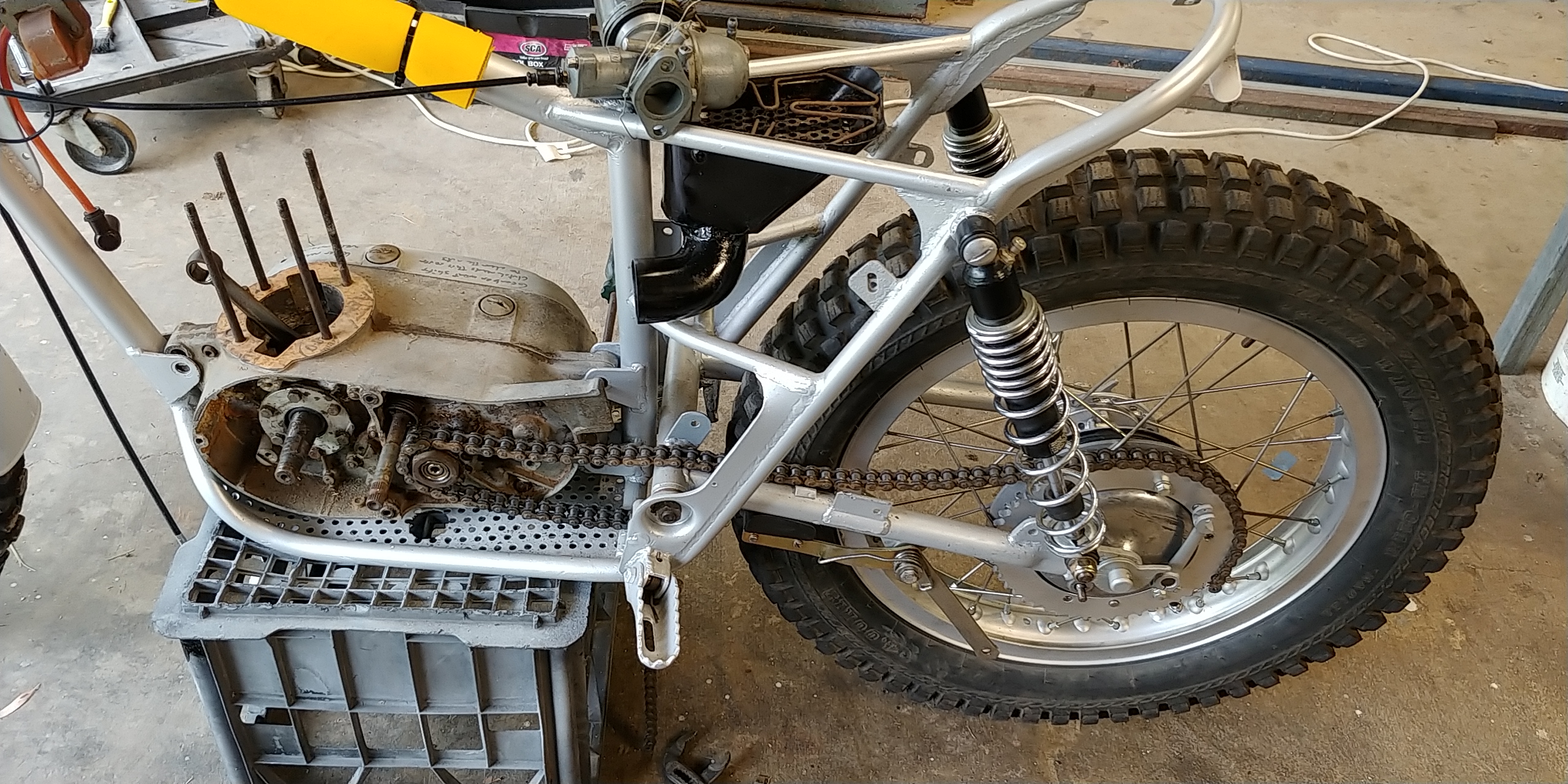

It's a wet weekend up here and I've been able to enjoy a couple of :bultaco: workshop therapy sessions.
These photos show some of the rear wheel/frame/swingarm/alignment I did this weekend.
I made an axle spacer for the right side of the rear wheel that takes the place of the original speedo drive. 30mm long turned out to be the magic number.
The blue thing in the hub where the spacer goes in is a ring of stiff closed cell foam fitted there to hold the spacer in place while the wheel is being put in and taken out
I then put an old :bultaco: 175 Campera bottom end in place for two things:
To check the chain alignment.
To see if a pre-69 magneto cover would fit this frame (no it wont). It seems that Bultaco changed the cover design to clutch-cable-on-top before they changed the frame design from single tube underneath to two tubes underneath.

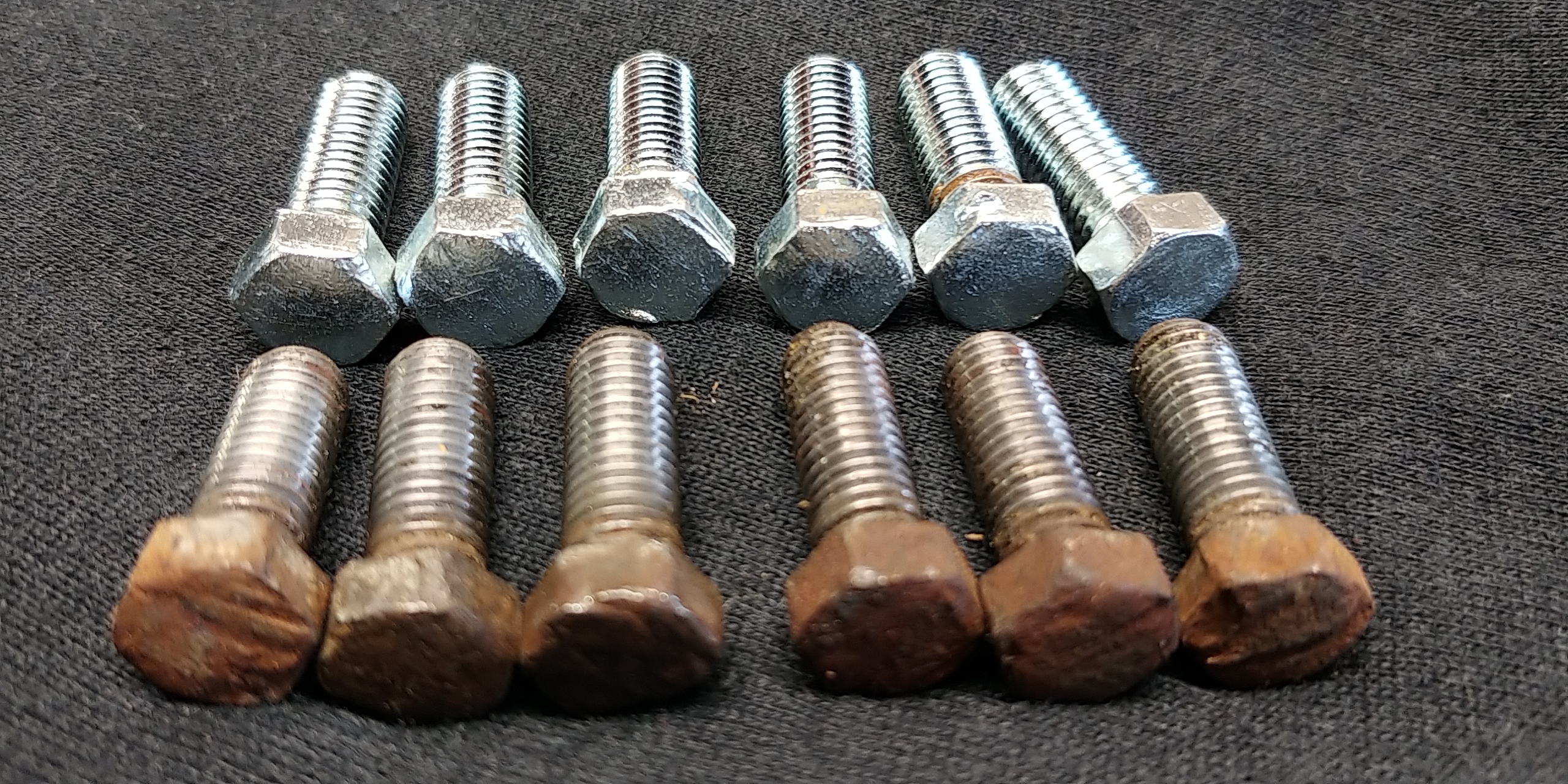

Posted: Sun Jan 15, 2023 6:09 pm
The original sprocket bolts for the :bultaco: model 85 Alpina were fairly knocked around and I know that Bullylover has a thing about dodgy-looking fasteners so I looked in my stash of M8 x 1.25 fasteners but couldn't find anything that had a small enough head to clear the brake backing plate. The originals are 11mm AF hex which is a fairly bizarre size because M8 x 1.25 hex is usually 12 mm or 13 mm or 14 mm AF, and while flanged head M8 x 1.25 bolts can be 10 mm AF hex, the flange is too big in diameter and would look a bit weird if I machined it down in diameter.
I was ordering some other parts from Bultaco Parts Australia and found that they had the correct zinc plated 11 mm AF hex bolts for the job.

by eagle
I can't believe how far the front sprocket is from the swingarm pivot point.
