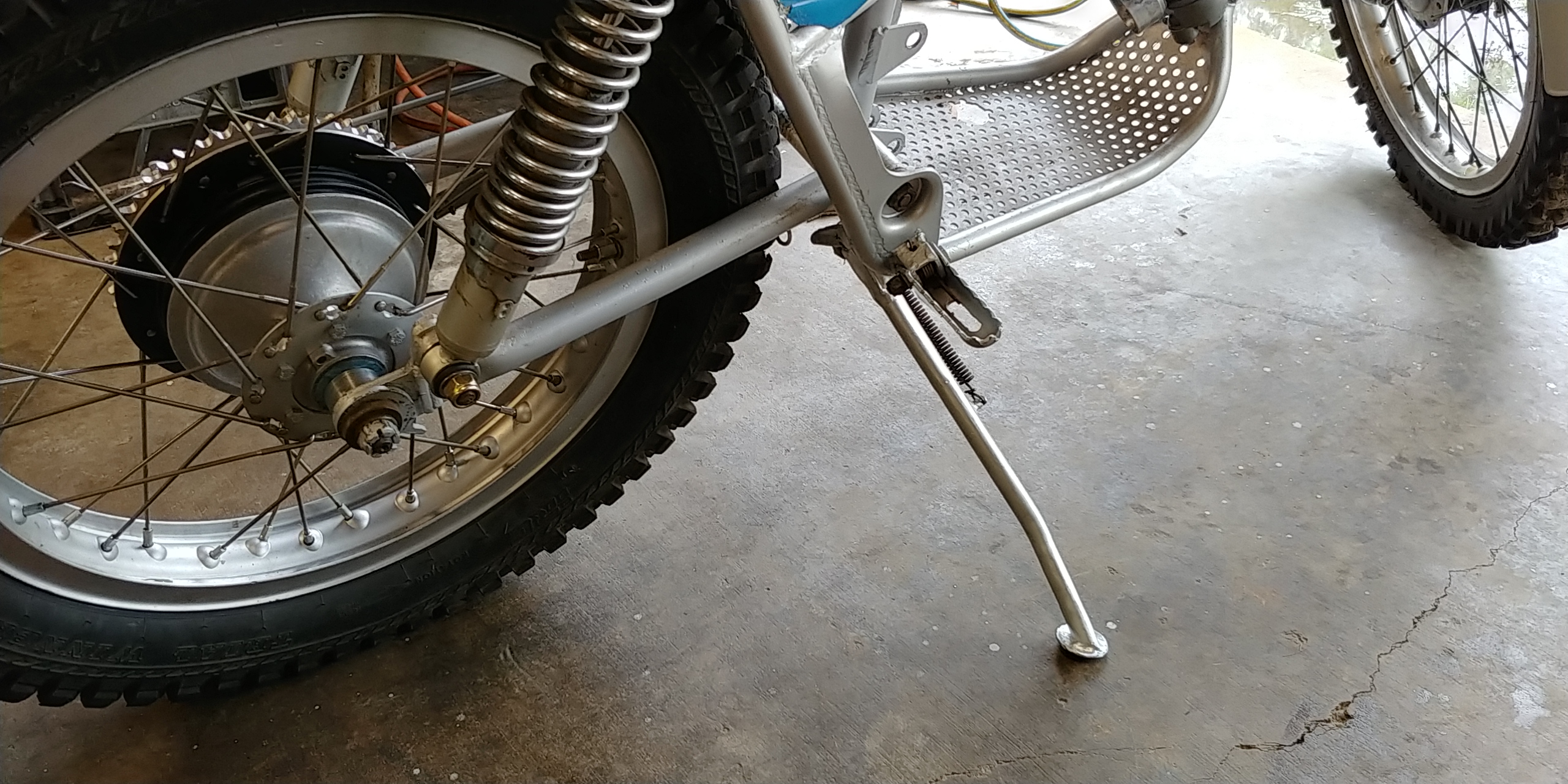

The side stand finally lives! Much more convenient now.

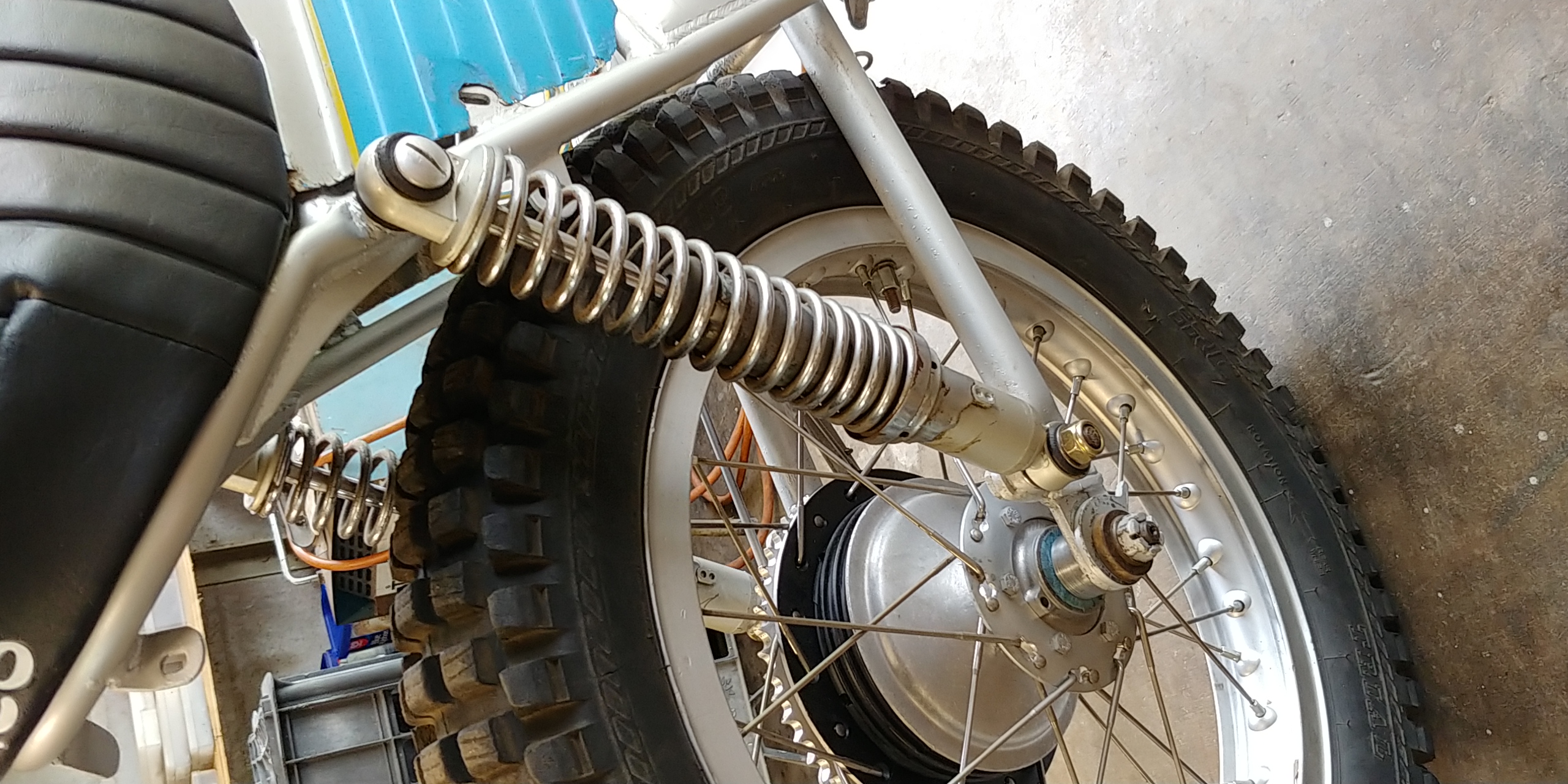

Some original 1970s Betor shocks. They came on an :ossa but I think they are the same as what came on :Bultaco: Alpinas. I rebuilt these ones many years ago.
The brake pedal stop was very worn (it rests against the swingarm pivot tube). It now has an adjustable return stop. I haven't got a pedal return spring for it yet.

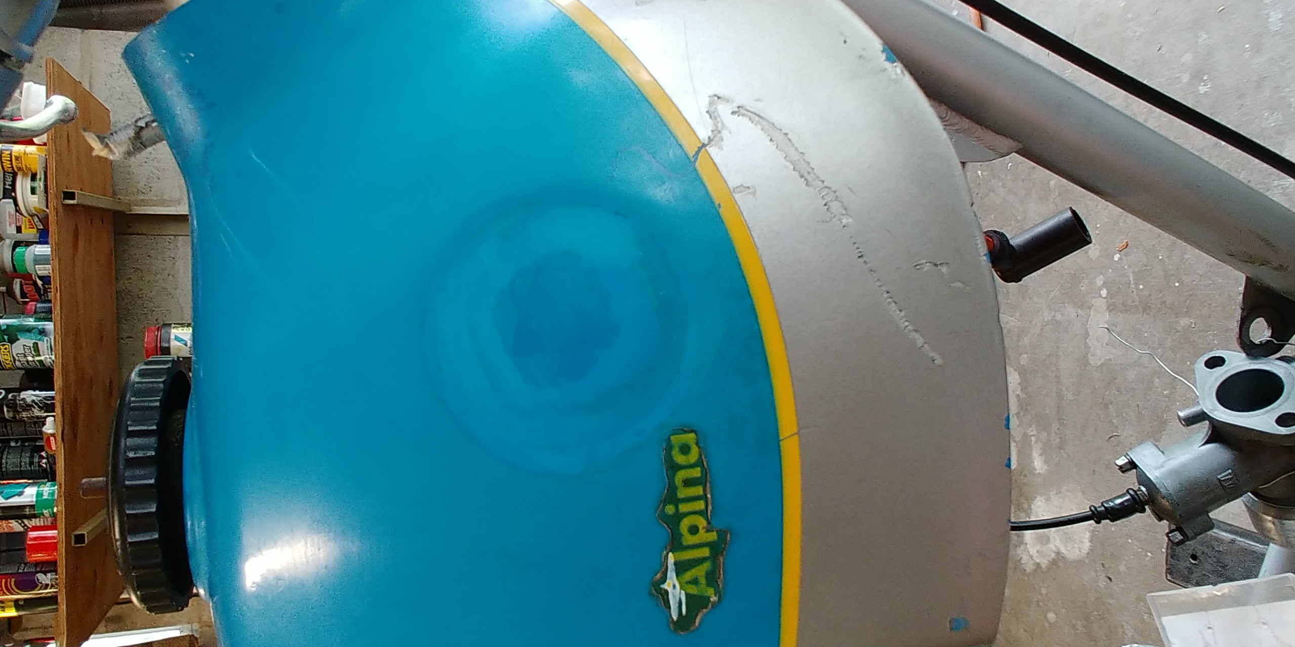

Bultaco tank has paint over gelcoat
With this fibreglass model 85 :Bultaco: tank, I was planning to leave the original finish because it has great patina and is the original graphics done by the manufacturer.
So today when I was cleaning the old glue off where the round badge goes on, I got quite a surprise when blue paint appeared on the cotton bud I was using to clean with. I was using thinners on the cotton bud which I knew would be pretty safe on fibreglass but paint??? So it turns out the fibreglass has a blue gelcoat finish with silver and blue paint over it. The blue paint is a slightly lighter colour than the blue gelcoat.
I got out another very original-looking model 85/97/99 :Bultaco: tank and found it also had blue gelcoat with lighter blue and silver paint over the blue gelcoat.
I wonder why they did the graphics this way?
Anyway here's a photo showing where I have removed the blue paint in the centre of where the badge sits.

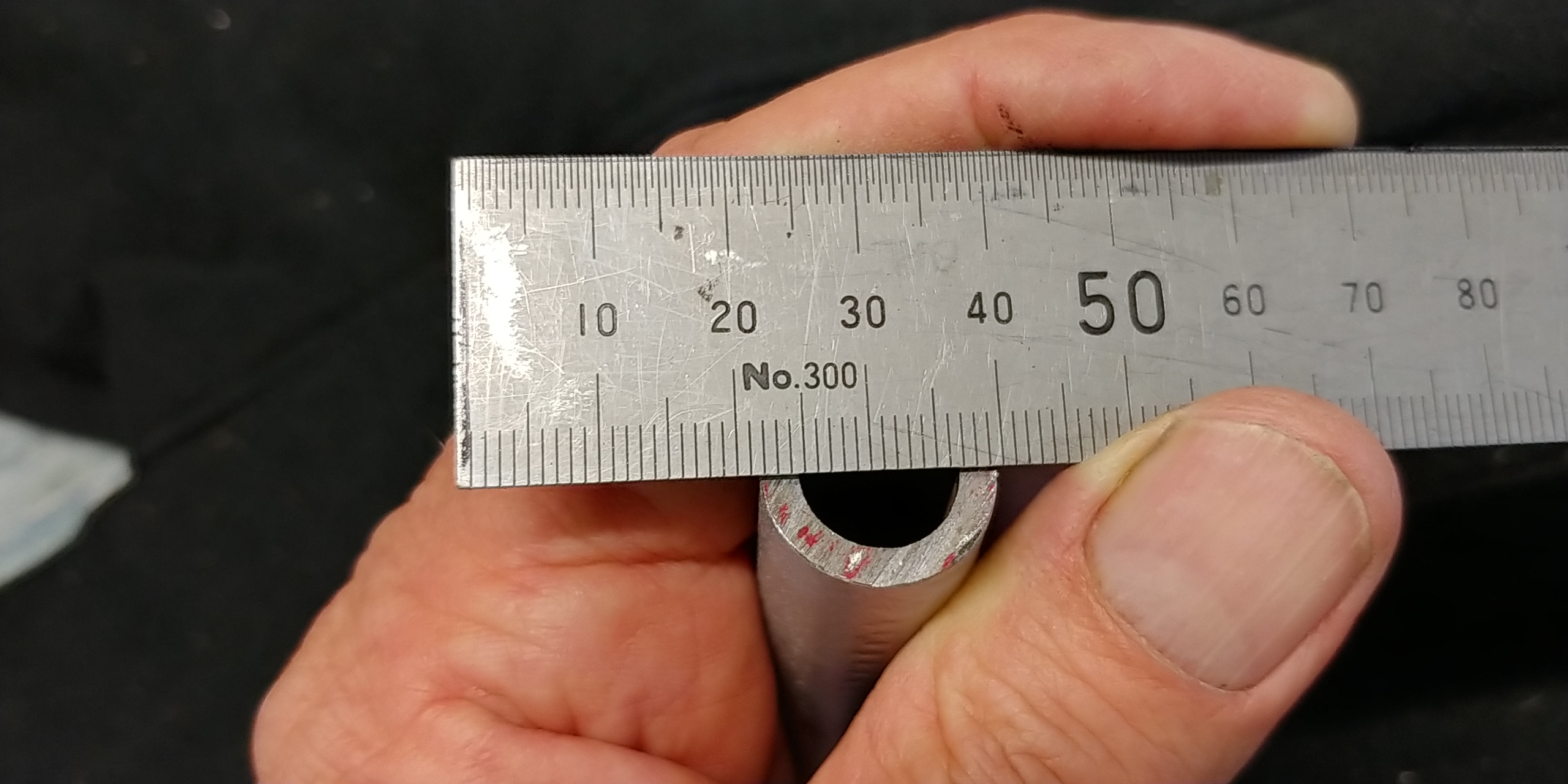

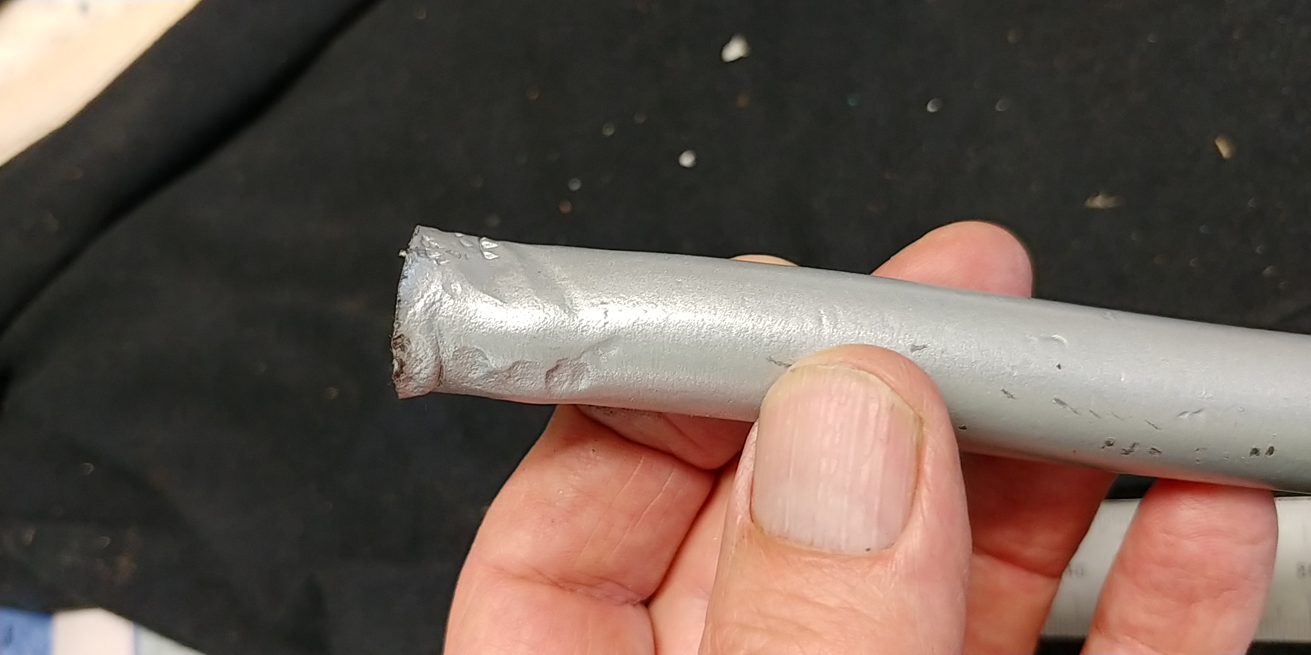

The model 85 side stand is made from heavyweight tubing
I replaced a few inches of the original stand that had been damaged from being pushed hard against the up and down stops. The photo showing the damaged section was taken after I straightened it and painted it, but then decided it looked too horrible to leave like that.
What was such a surprise was finding how thick the tubing wall was when I cut it. It's 3 mm thick! which is quite thick tubing for that OD.
I'm pretty sure the stand on the model 85 :Bultaco: Alpina is the same stand fitted to the early Sherpa T models (the models with the stand mount on the frame) so there would have been quite a weight saving from taking the stand off for competition.

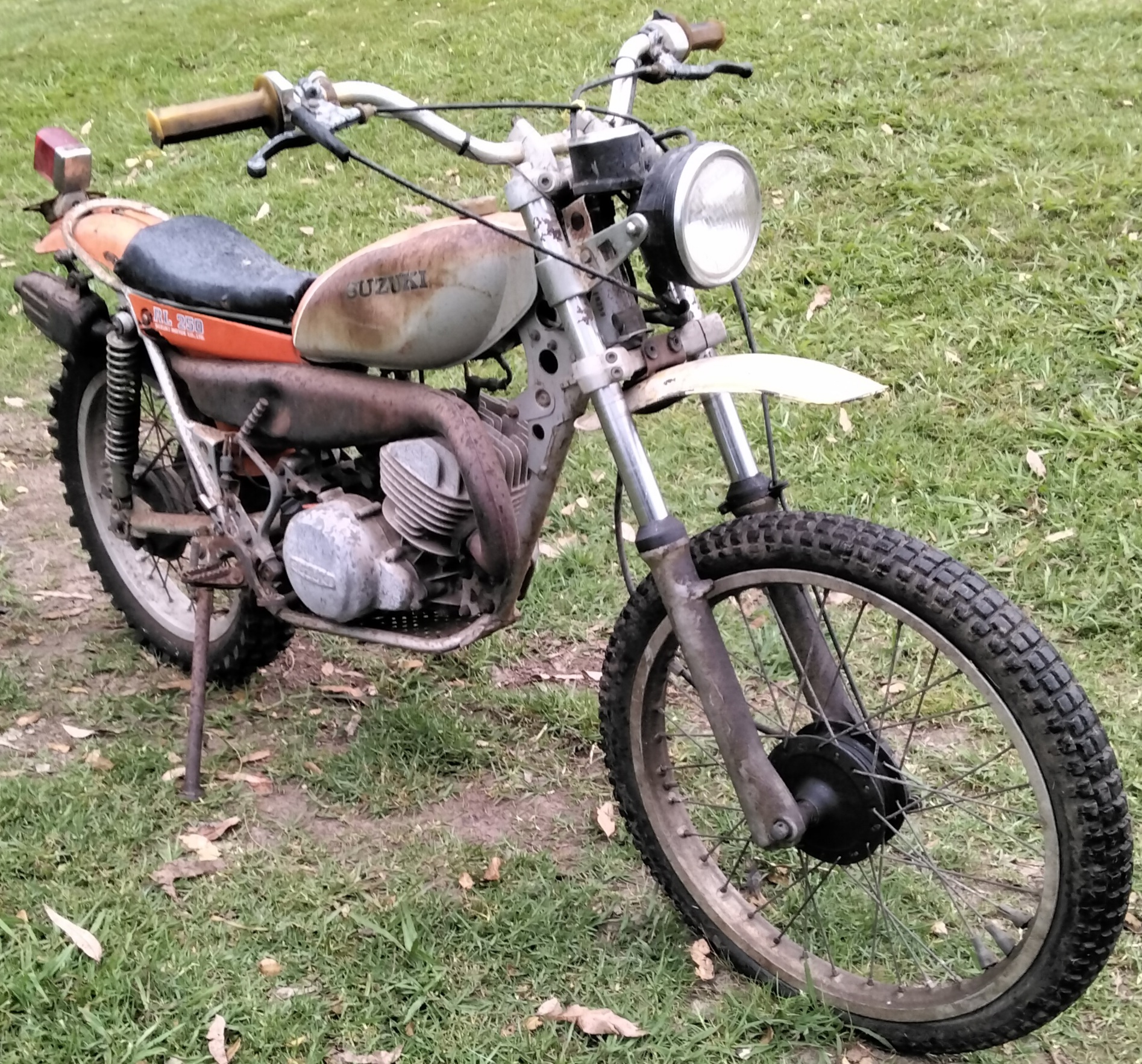

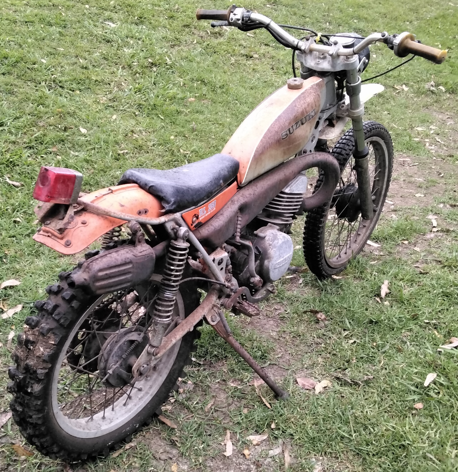

Here are photos of my latest acquisition, a real Trials bike:

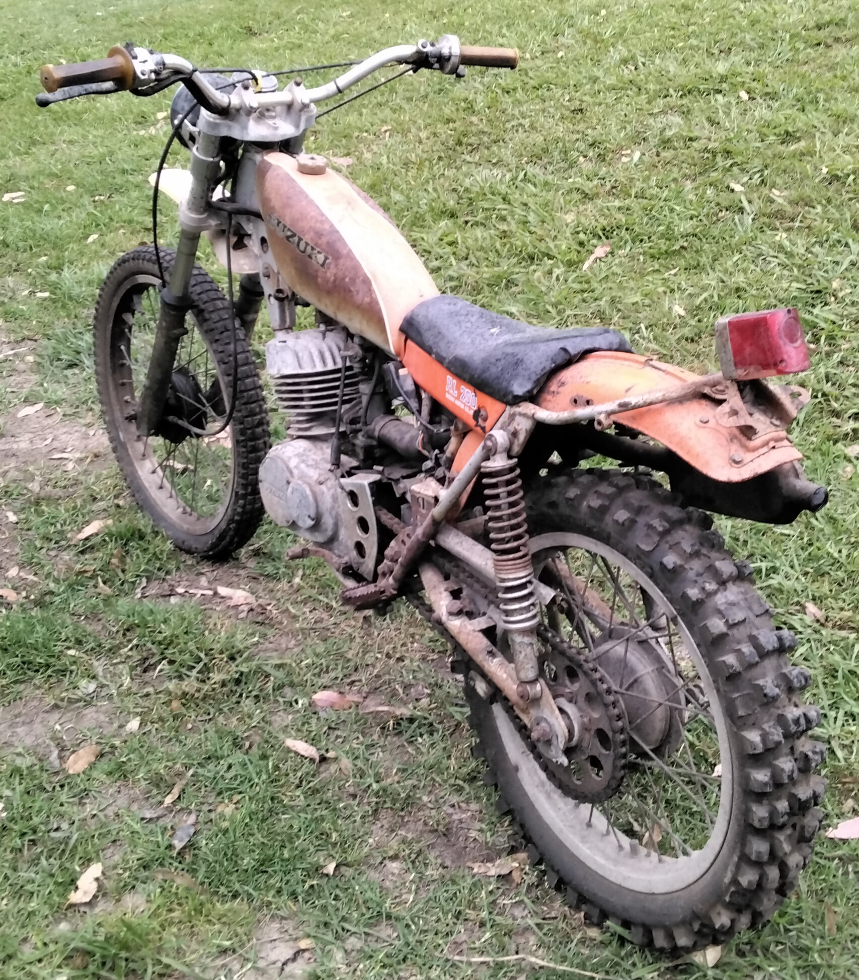

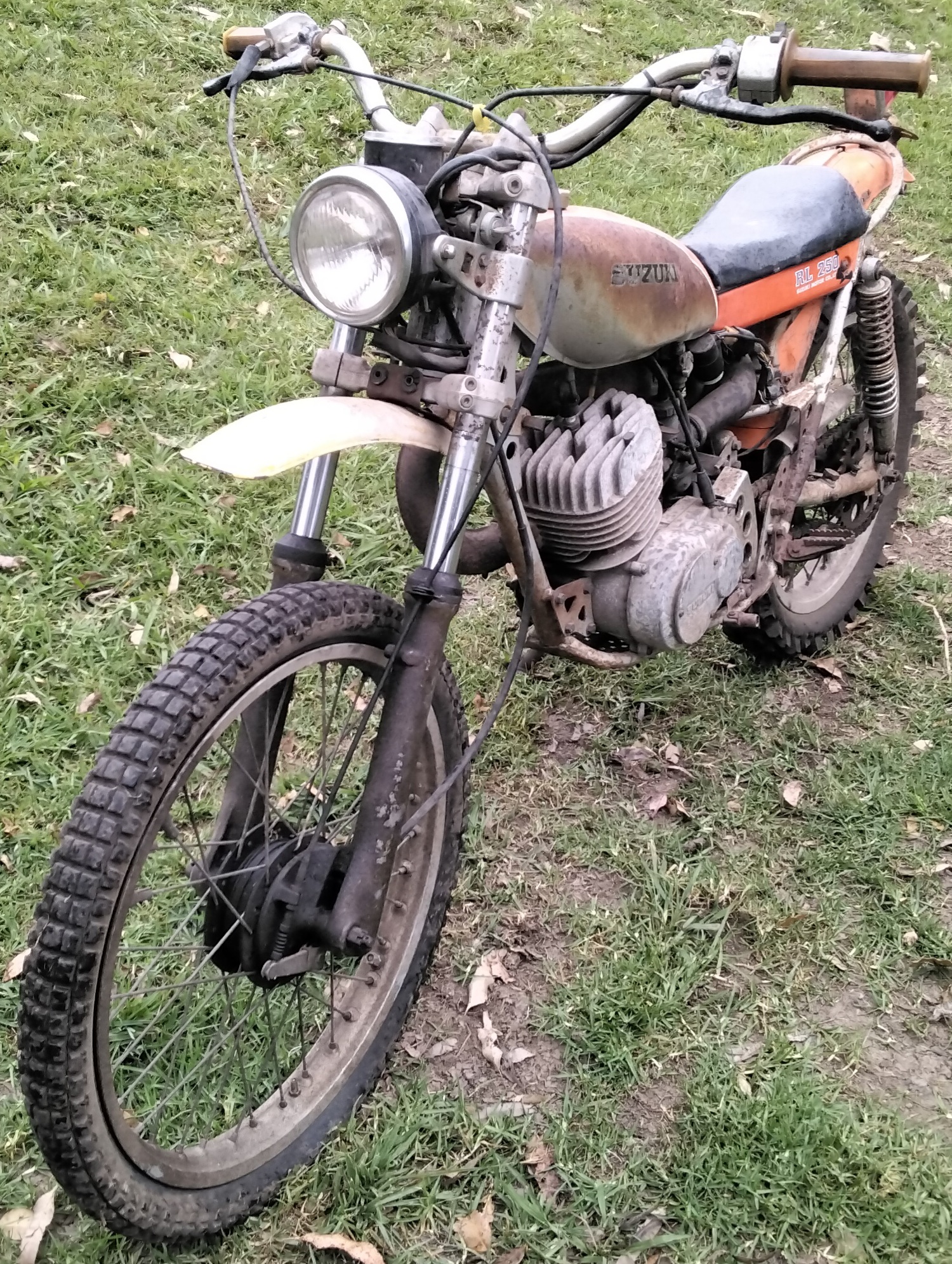

Good to see you replaced those sprocket bolts with originals David. I would of hassled you for years if you didn`t!!!!! Greg that is NOT A REAL TRIALS BIKE. It`s even worse than an imitation one. #-o #-o #-o #-o
Thanks Graham. You are a motivating influence for the better appearance of my :Bultaco: s.
Even if it isn't a :Bultaco: , Greg, that :suzuki is a great find. Amazingly complete!

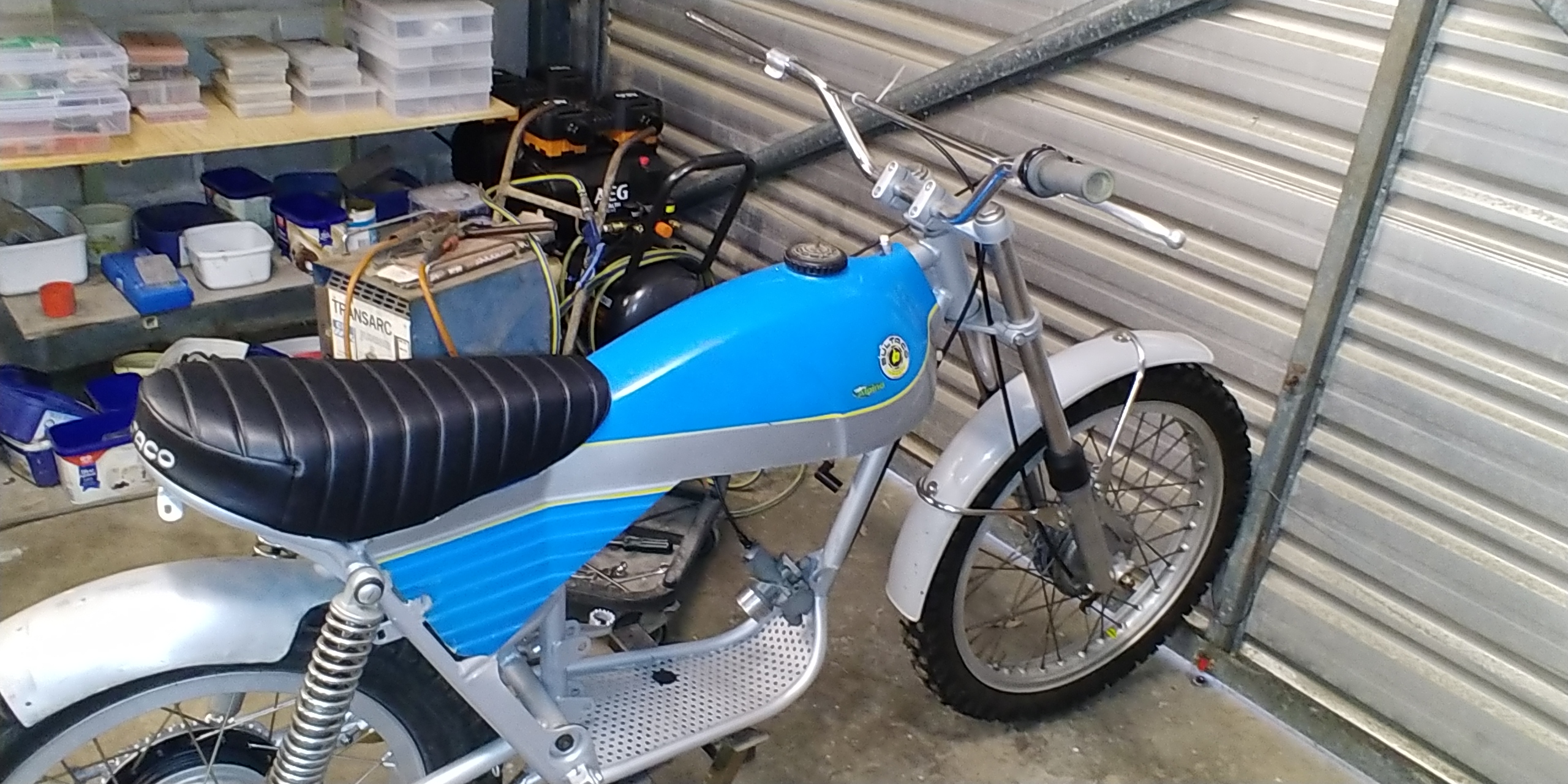

progress photo 17 Jan 2023
One of my kids reckoned it looked pretty sad without the tank badges and she was right.
I reckon it looks slightly less sad now

David, nice front guard, is it a Goneli with that stupid mud flap removed?
I have a pet hate for Goneli front mudguards with that easily removed flap that people don't remove.
Rod wrote:David, nice front guard, is it a Goneli with that stupid mud flap removed?
It's one of these Stilmotor guards Rod, but in grey, square both ends.
https://www.inmotiontrials.com/product/ ... ard-white/
I originally bought that grey front Stilmotor guard for my model 49 :Bultaco: because I wanted to use a rear Stilmotor in grey on it and they came in pairs front/rear.
It has been an excellent front guard on the model 49 and after stealing it for this model 85 :Bultaco: I'm still deciding what front guard to replace it with on the model 49 :Bultaco: . Maybe another one? Not sure yet. There's a new front guard mount going on the model 49 :Bultaco:
I know what you mean about the mudflap on the front Gonelli looking out of place on some bikes. I have a few bikes with the front Gonelli with that flap cut off and fitted with the round end at the front end which I think looks OK.
