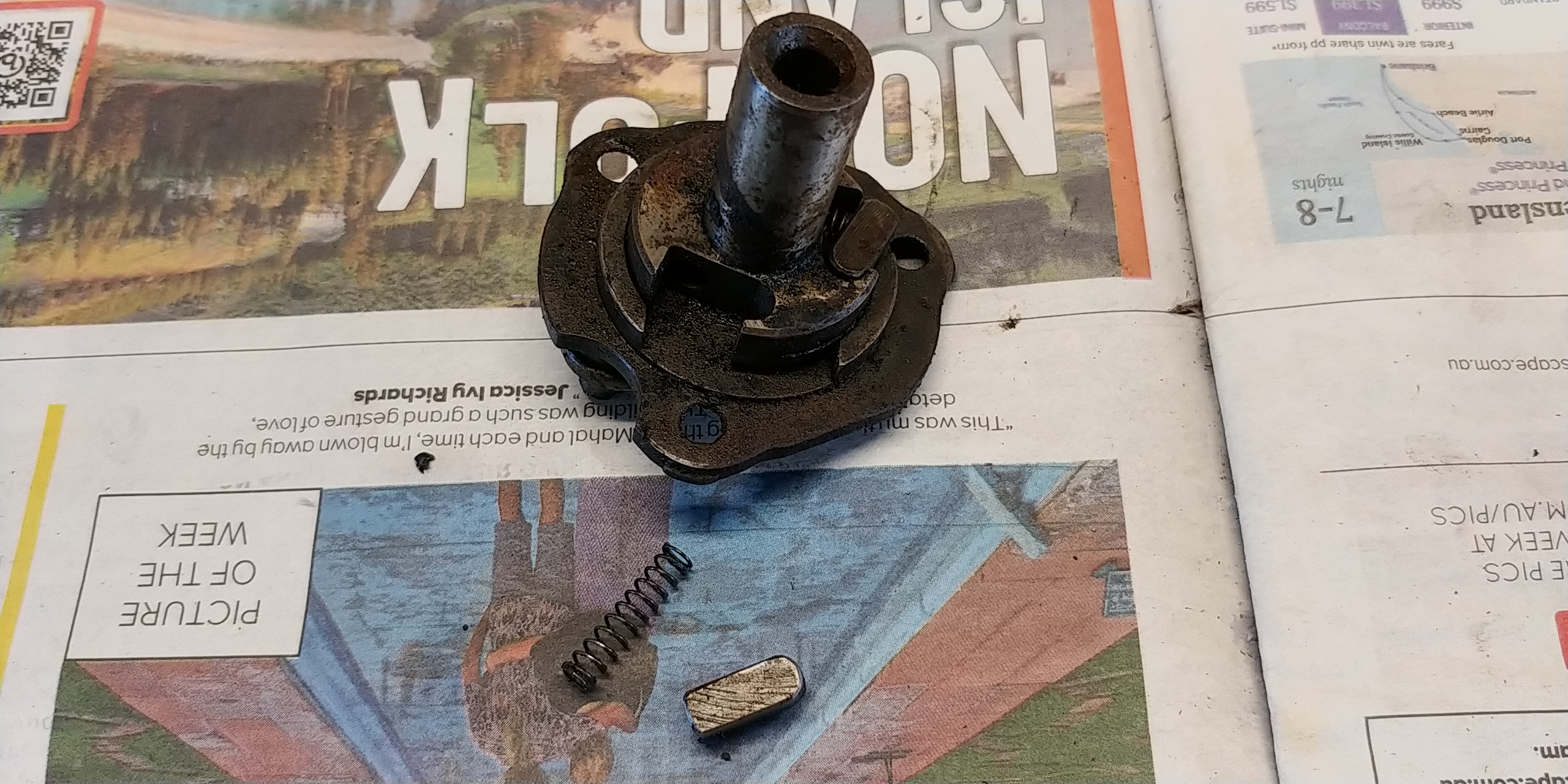

Hi Greg. I can`t see the springs that push the shifting pawls out and the washer on top of the kickstart gear either. A few case screws are not there either. It looks like it is basically all there just some minor bits missing. :Bultaco: :Bultaco: :Bultaco:

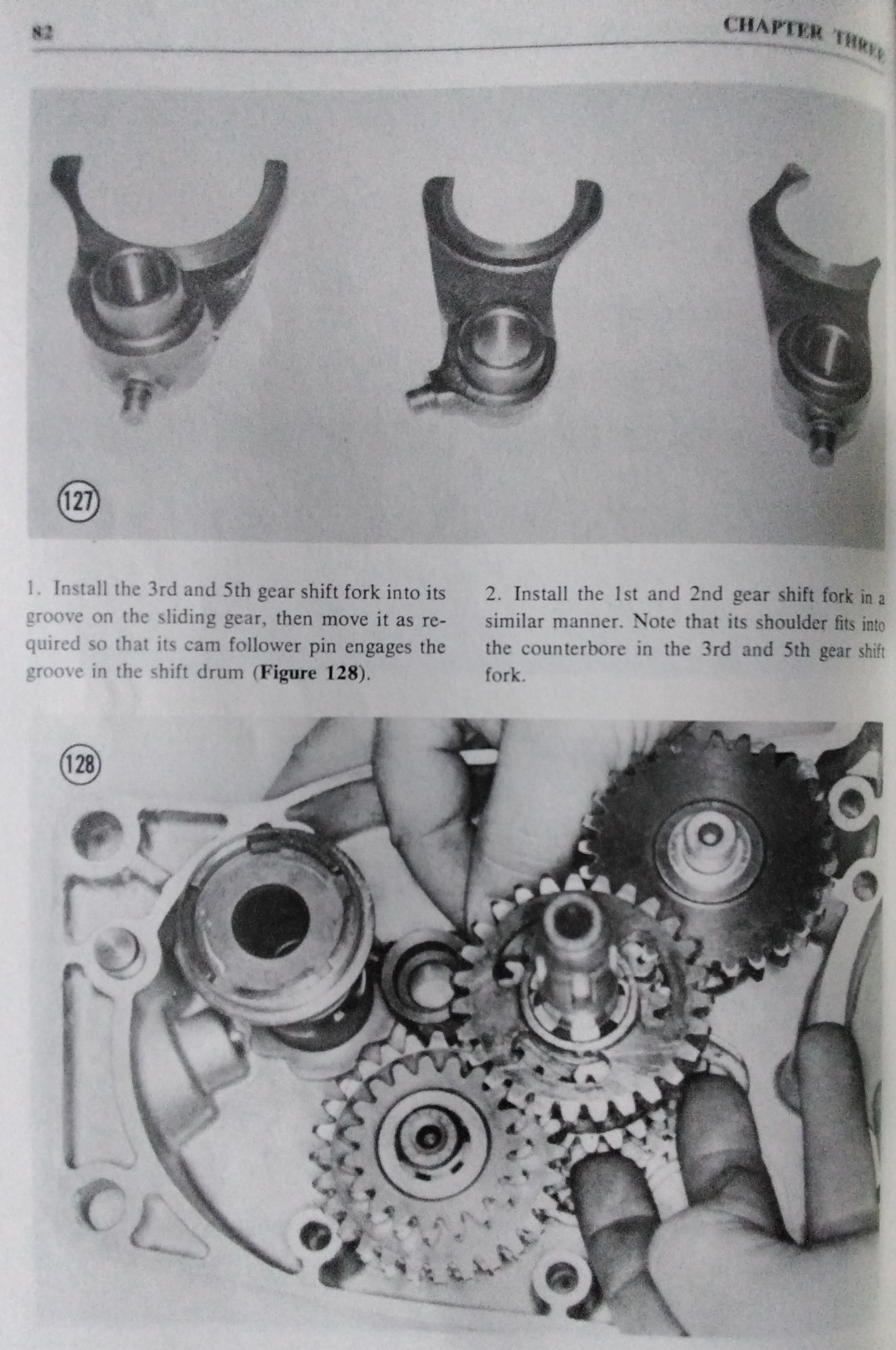

Today I had a brainwave and decided to read some instructions, I am after all a bloke. The case screws are easy and plentiful so I would like to work it out so I can hand over a complete motor. Here are some photos of my manual hopefully of the right pages so you can identify for me?

See in the first and last photo on top of the kickstart gear there is a flat washer on top of the kickstart gear. That on is the only washer in an older Bultaco gearbox. Some later ones have one on the clutch shaft inside the center cases. The shifting pawls have a spring behind them to hold them out in the top of the shift drum. They are a very easy motor to work out.

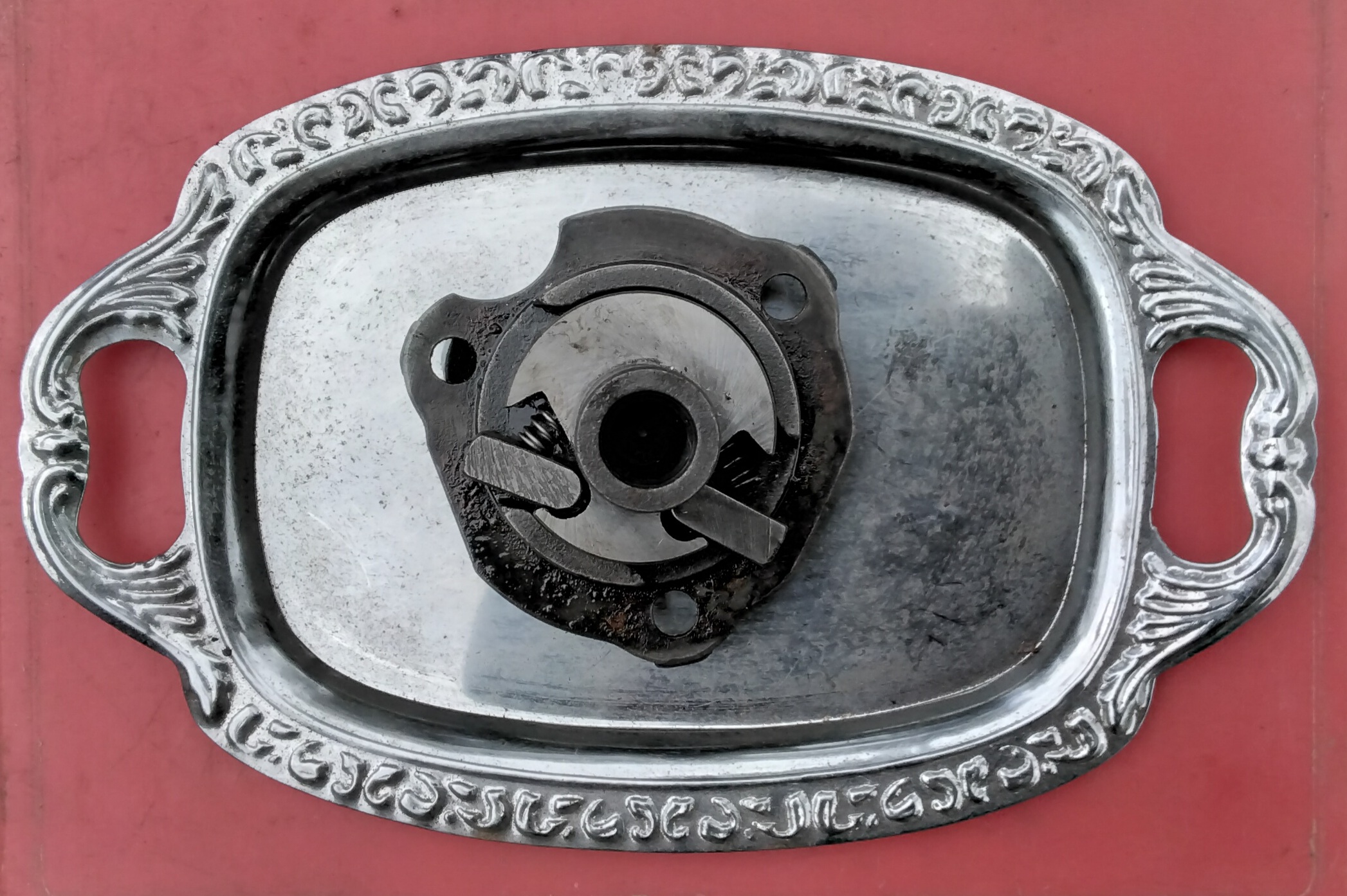

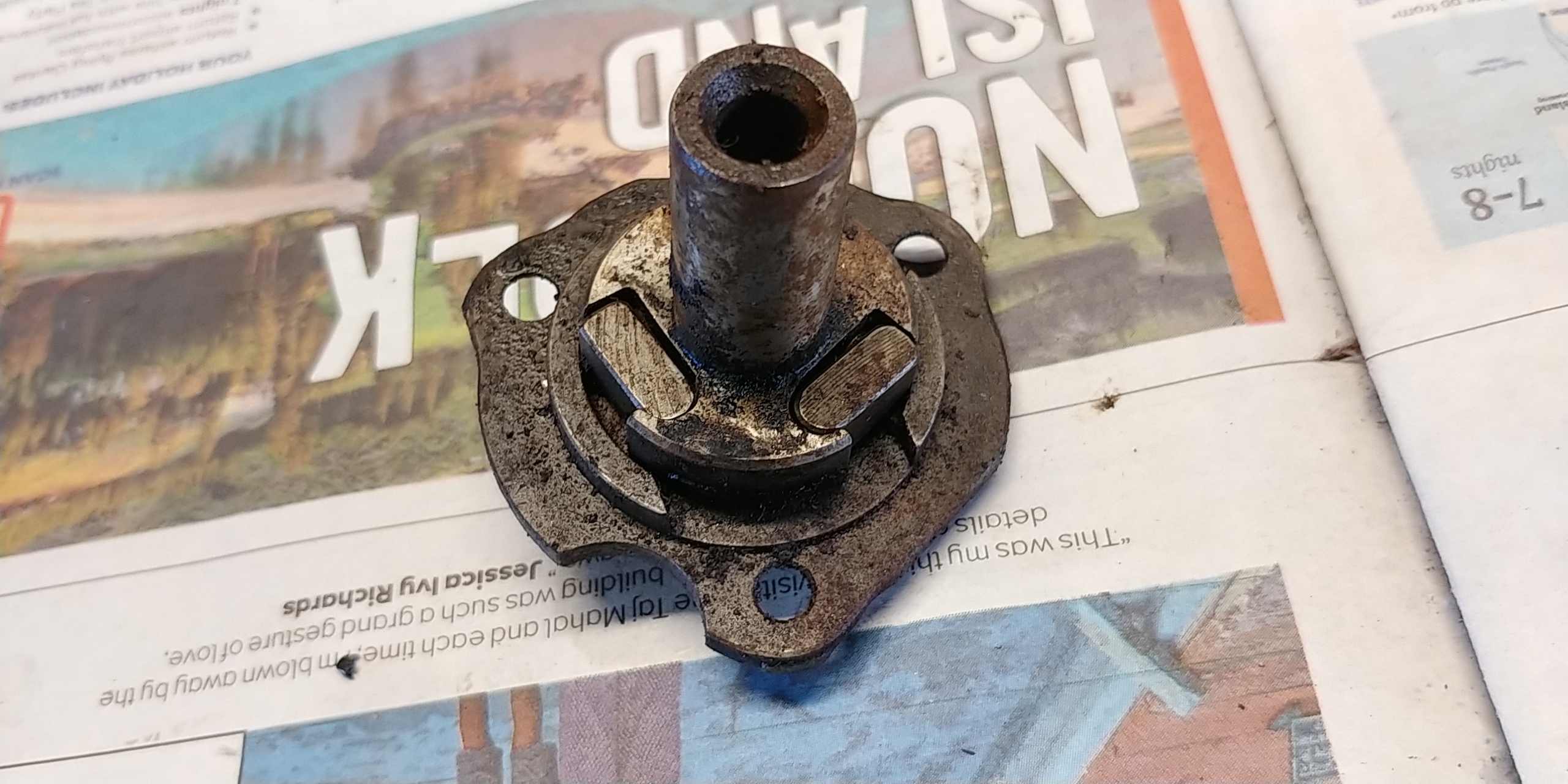

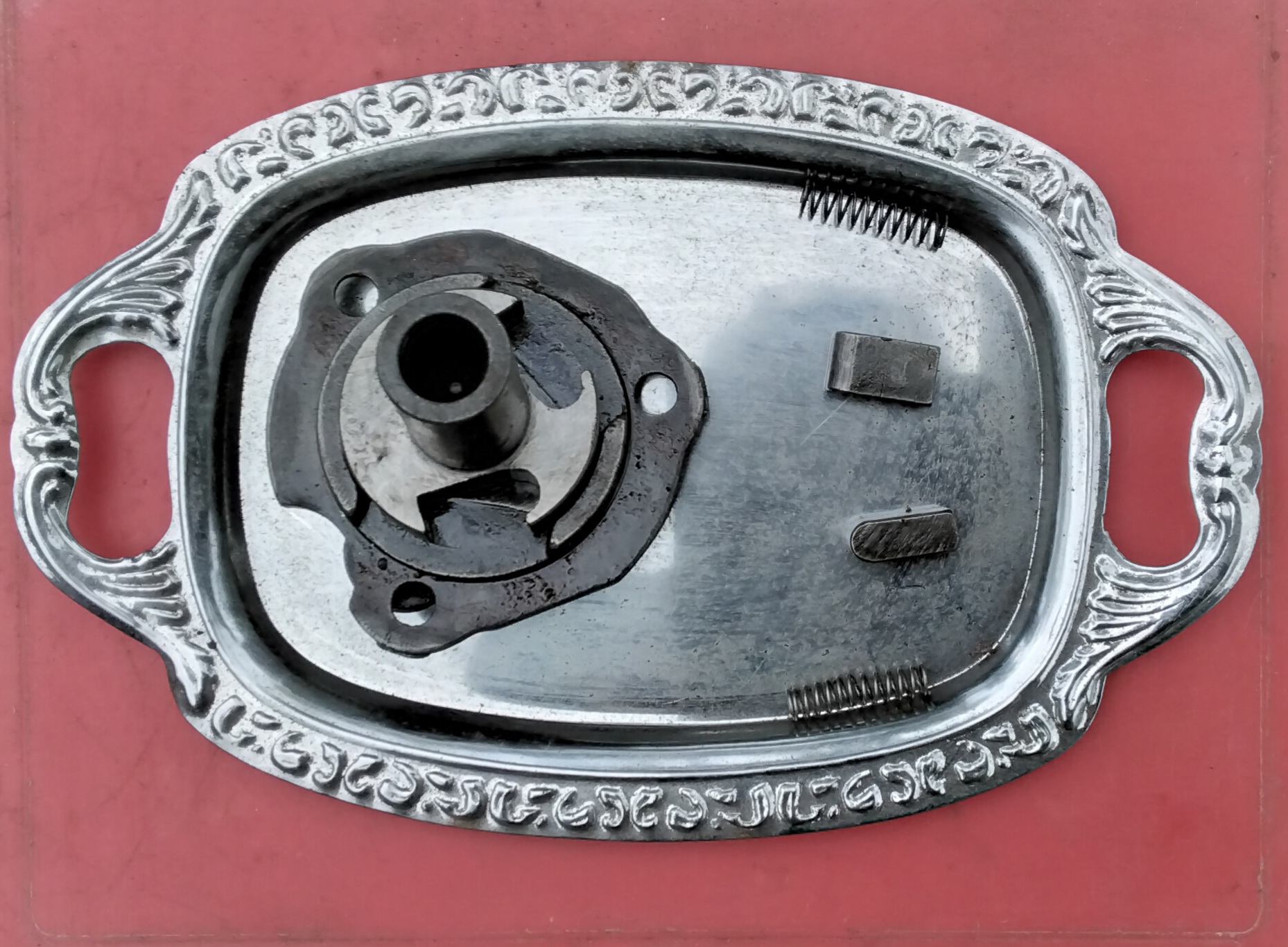

Greg I was looking for :Bultaco: bolts today and found this which shows :Bultaco: 5 speed shift pawls and springs.
One photo shows the pawls retracted which is how you set them during assembly into the shift drum.
The other photo shows one of the pawls and springs separately. There are two springs and two pawls per bike.

You have a keen eye Graham and Thankyou too David for the photos, now I understand better. Today I made time to have a look through the Dolmio jars of small parts and found a spring as described so then I went through my compression spring collection:
No luck there so I started pulling things apart with small compression springs, too big, too small and too long so no Goldilocks moment. Frustrated I packed up my collection and one was hiding inside another and pretty close:
:Bultaco: one at top and found one at bottom:
There isn't a pen here that has not been molested and I think one of them would work fine:
Now for the washer that I could not find. Is it hardened and how thick would it be or are there any other distinguishing features? Something tells me Graham that you know these well? Is it a bit like the time you painted your nuts?

Bultaco kickstart shaft end washer
Hi Greg.
The washers I've found in that spot inside :Bultaco: 5 speed gearboxes are round, flat and made of aluminium about 1.5 to 2.0mm thick
Graham may not have seen your post yet as he's off having fun doing his live music thing in Tasmania.
David
Hi Greg and David. That sounds right David about that washer on top of the kickstart gear. Most of the ones I have seen have been steel though. Have a look on the In Motion site. The part number is 20.07.031. It looks to be steel. Now Greg you leave my painted nuts alone!!!!!

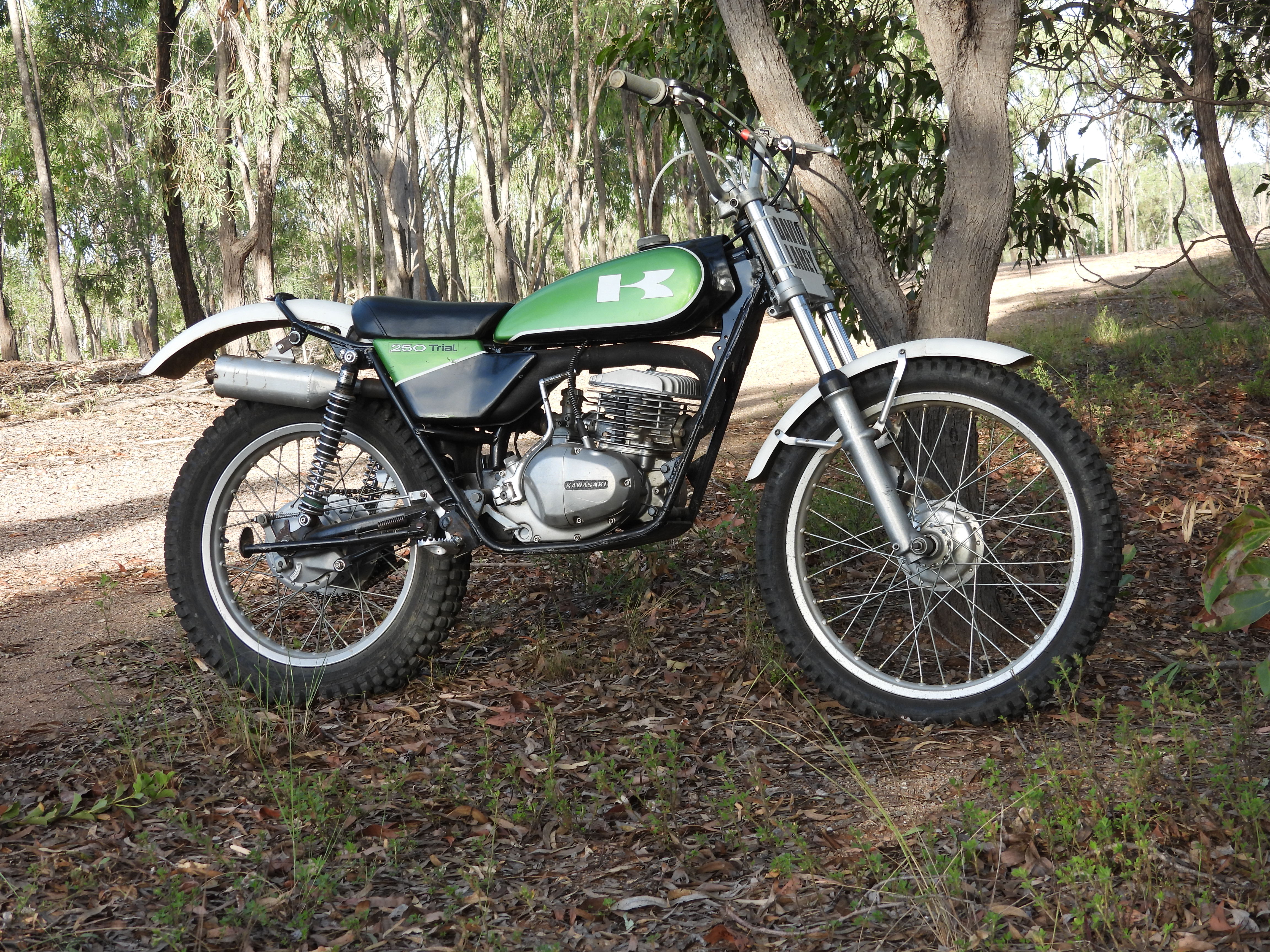

I did some setup experiments last weekend on this KT at a local trials property and tried getting a good photo with a new camera
