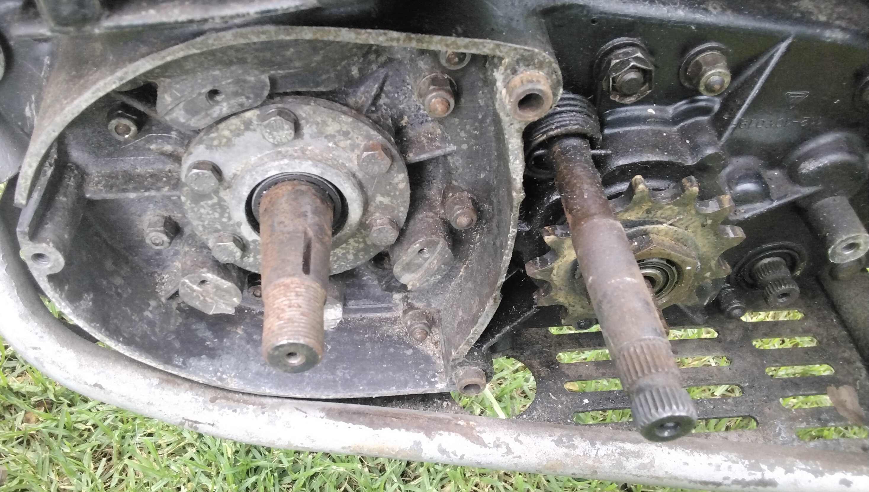

The :kawasaki KT250, :suzuki RL250 and :montesa Cota 348 flywheels would be poor choices.
I fitted a standard :Bultaco: 350 Alpina flywheel to my :Bultaco: 350 Alpina recently, replacing the much lighter flywheel that the bike came with and the standard flywheel made the motor much nicer to ride with.
I think I can see a standard size flywheel in your photo but not sure of it is the aluminium version or the zinc version. The zinc version would be the right one

Let us know what model Alpina that one is. I know the later Alpinas all had Motoplat ignitions on them. Both the M212 and the M213 had Motoplat on them. Either will fit though. Motoplat or Femsa. The 350`s all had a much heavier flywheel on them though.

Bully fanatic wrote:Let us know what model Alpina that one is. I know the later Alpinas all had Motoplat ignitions on them. Both the M212 and the M213 had Motoplat on them. Either will fit though. Motoplat or Femsa. The 350`s all had a much heavier flywheel on them though.
M213 Graham, pretty sure it is original paint late model version of the last model Alpina. It would be good to know how many they made?
