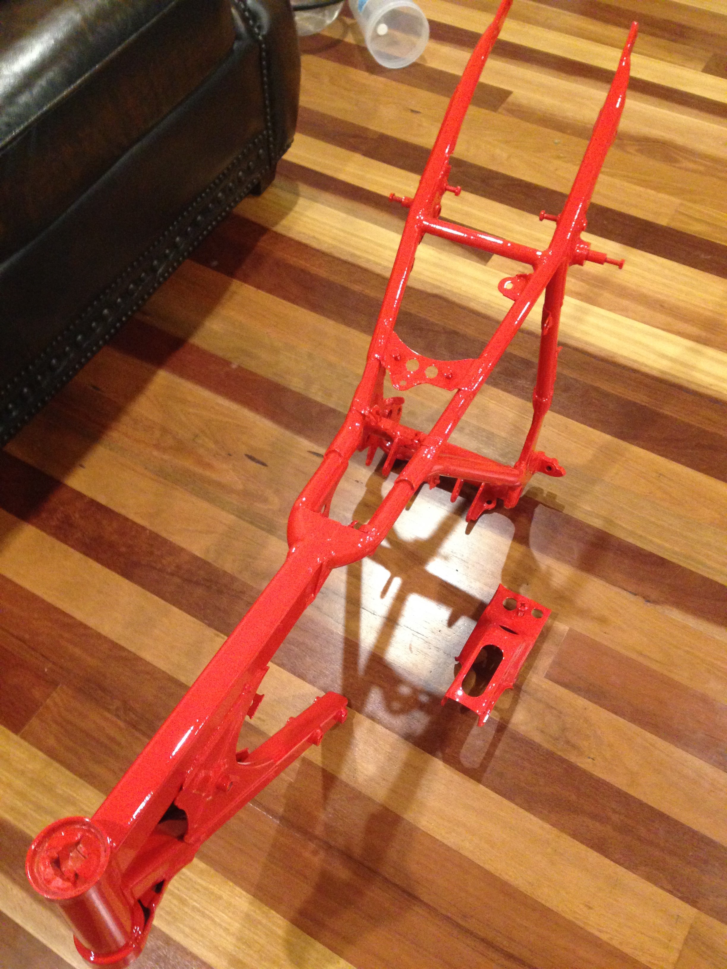

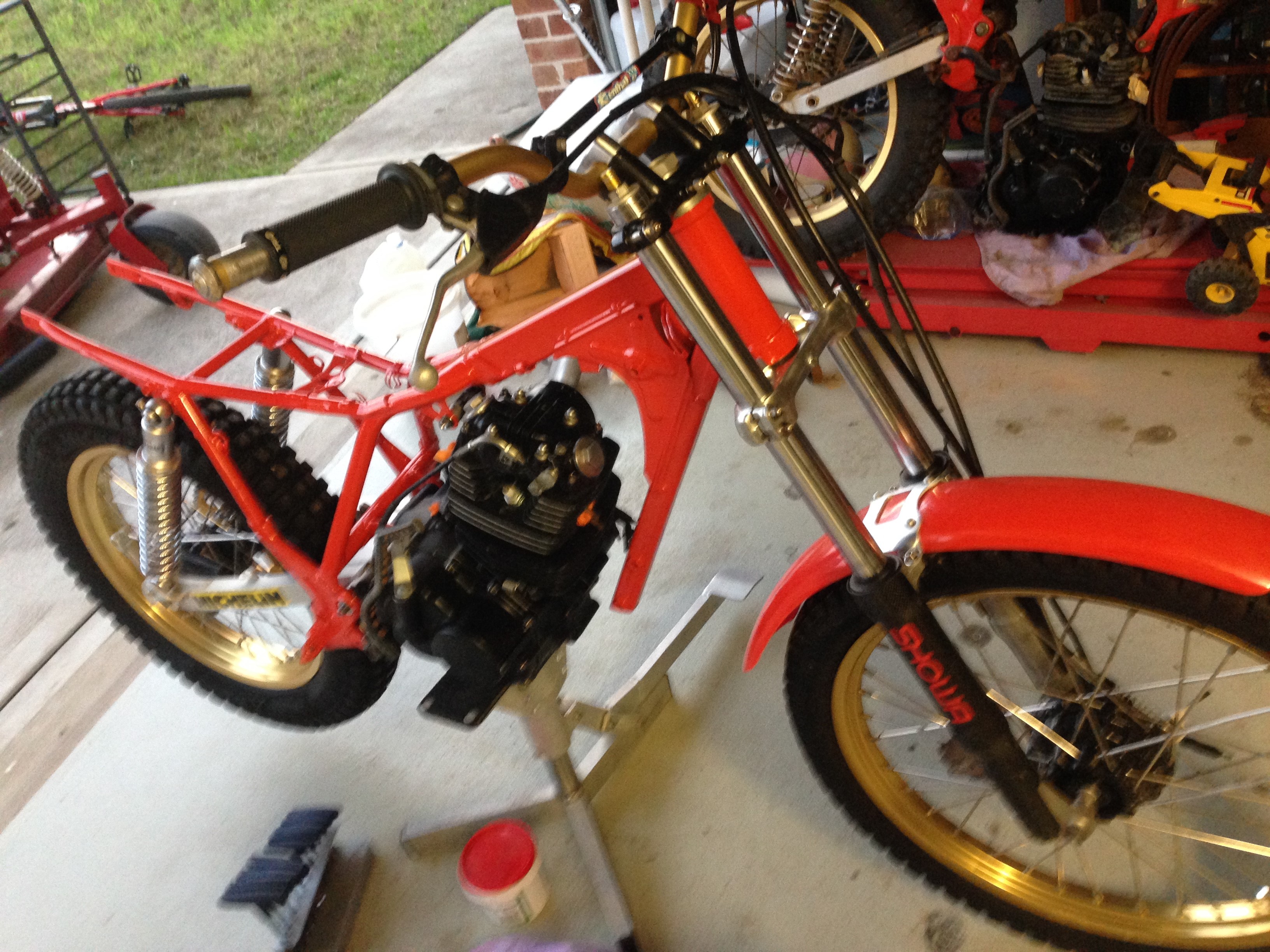

My TLR referb is progressing along.
IMG_1066 (2).JPG (1.63 MiB) Viewed 9764 times
IMG_1183 (2).JPG (1.64 MiB) Viewed 9764 times
Sharvie ~ Maitland NSW

Looking good Steve, are you still on acreage and do you still have a practice area.
sharvie
Posts: 329
Location: Maitland NSW
Post by sharvie »
On 2 acres now
Nothing as far as practice areas go

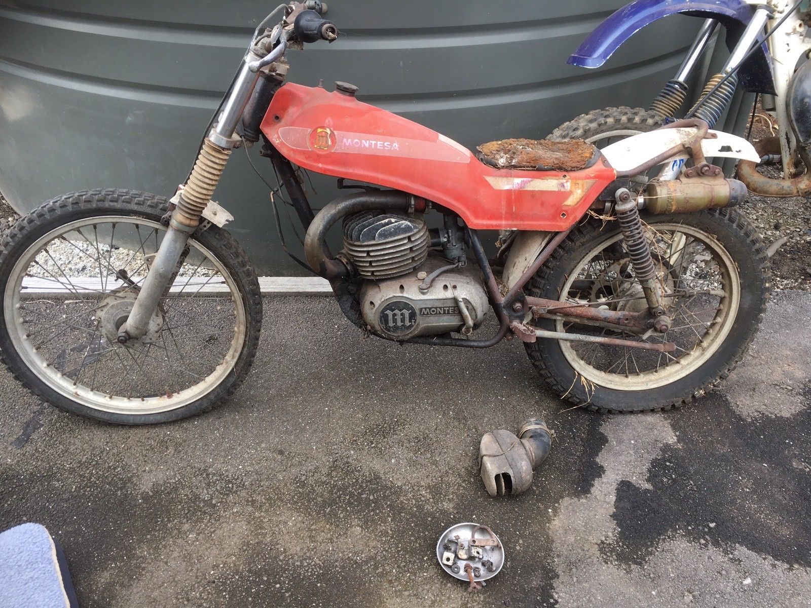

Post by OlDaz »
Picture of mine when I got it recently, been spending a lot of time and $$$ finding bits for it for the rebuild.
Still remembering when.....
