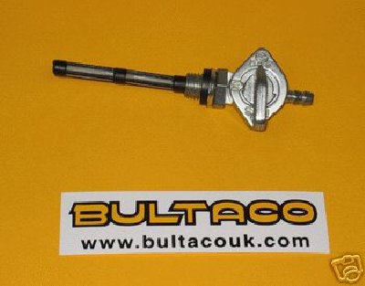

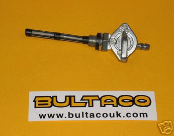

Also my petrol tap leaks and I have added a inline mower tap. With an in line filter it will get a bit crowded. Any hints on repairing the fuel tap . Or can you buy replacements.

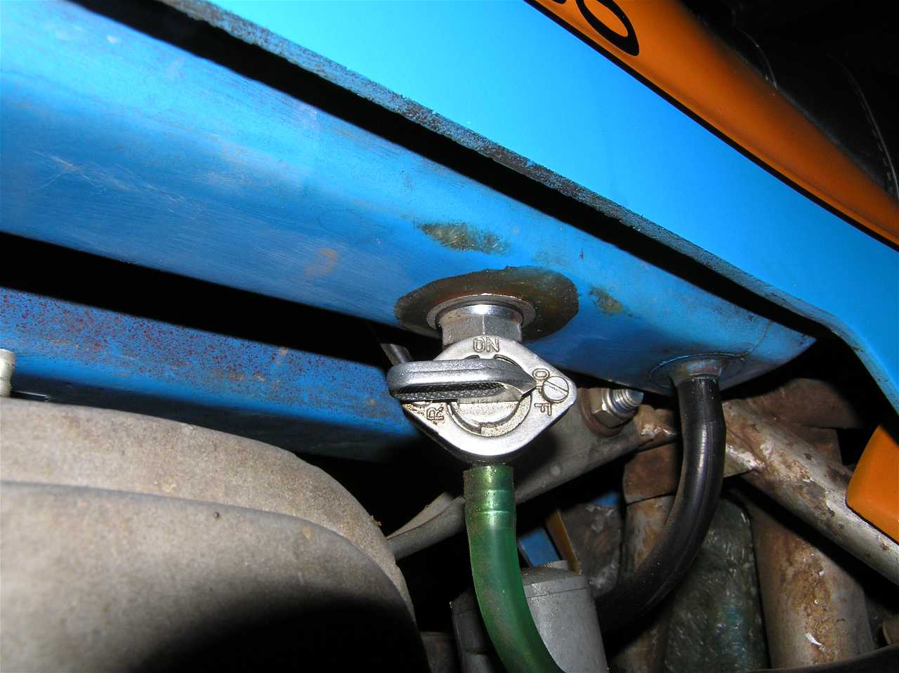

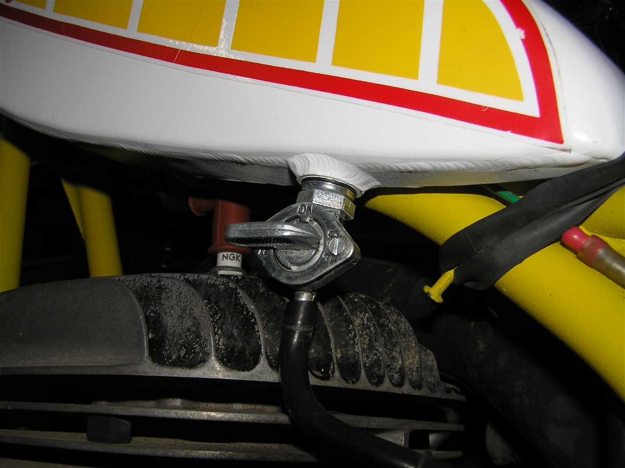

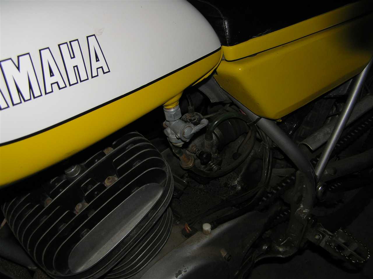

You can buy new Yamaha TY250 twinshock fuel taps from John Cane in the UK. I haven't tried at the local Yamaha shop as I reckon the KT250 fuel taps are better anyway so have fitted them to my TY twinshocks.
Another option is to make a F/F adaptor to fit the fuel tank stub and a standard aftermarket bike fuel tap. They work well and don't cost much. The tap I am thinking of has a male thread and is made to fit all the Spanish 1970s bikes. They are advertised on eBay coming from the UK. I've bought a few of them so far for my Spanish bikes and Majesty and they have all gone well. Still prefer the KT taps for the TY twinshocks though as I don't have to make adaptors that way. If you want a picture of the aftermarket tap I'm talking about let me know.
Another option is to make a loop in the fuel line so it goes down from the tap to near the top of the gearbox and then loops up towards the tank and then back down to the carby connection. My TY250B is like that because the KT tap outlet points down so the loop makes it easier to fit the inline filter.

Thanks for the info on the fuel tap and pictures would be appreciated.

Thanks for the fuel tap photos. I got a fuel filter and aftermarket fuel tap tonight. When i tried to fit the tap it didnt fit as i expected. So i took off the F/F adapter on the TY original and it fit the aftermarket one. Easy. So the tap i got was a MCS - FT3A.( $15) Can supply a photo if required.
