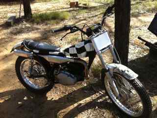

THis is my resto of my 1977 TY250 D still minor things to do to it but geting there

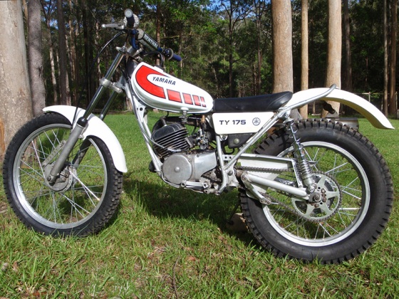

Well here it is…. Finished…. Although I am still waiting on replacement shocks from the UK as the ones they sent me earlier are self destructing after only two rides! I have replaced, selector drum, gears, crank bearings, engine seals, spark plug, condenser, points, bash plate, fork seals, wheel bearings & seals, spokes, tyres, brakes, shockies, throttle body, cables, rebuilt the carby and reconditioned just about every other part on the bike. It’s taken 4 months but worth doing every bit of it. This is the bike I should have had as a kid to learn how to ride and do mechanical work, well I finally got to do it in the end. A big thank you to Greg Harding who provided me with quite a few parts, lots of advice and a set of wheels while I was waiting for my spokes to turn up from Thailand (there’s another story) and to Don in Wauchope who also provided me with parts and great advice.
