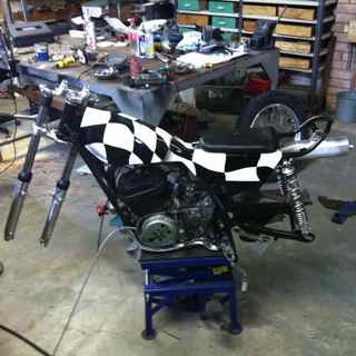

THis is my resto of my 1977 TY250 D still minor things to do to it but geting there
