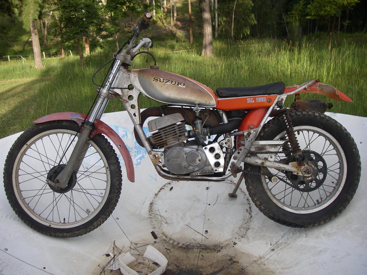

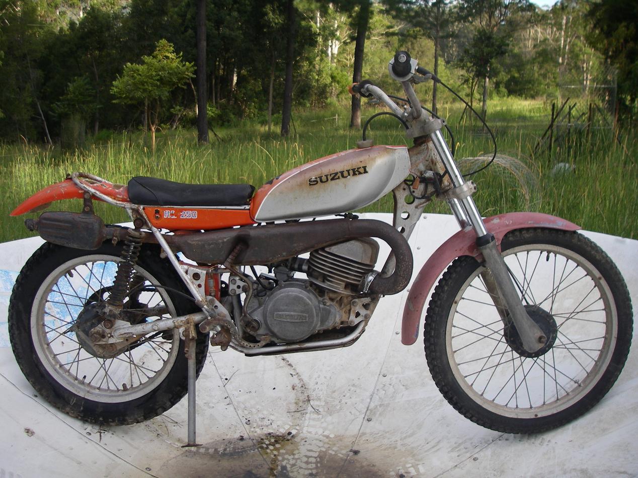

Just thought I would share my latest acquistion, not really a basket case but a non-goer. Story was that it had a dead ignition, have 2 spare bikes with working ignitions, so decided to risk my $200.00. When he delivered the bike, I was very happy! Pulled spark plug out and no spark, disconected old kill switch wire and SPARK! Drain tank and carby, three kicks and RUNNING! HAPPY DAYS! Everything works and rides well! Abeit I wish the handling was as easy to fix! Checked workshop manual and 15/54 428 is standard, this bike has 14/53 and I still think is a bit tall geared. Checking availability of 428 13 tooth sprocket tomorrow! Now I have 2 of 250 and 2 of 175 loan bikes for trials visitors.
- Posts: 906
Nice RL Jack. I am stoked about your find. Talk about an easy fix!

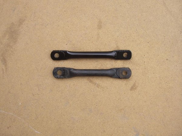

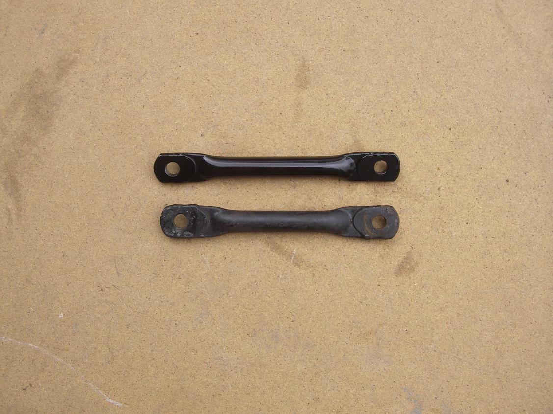

Hi Chippy, I have finished KT250 rear brake brace 10mm longer as requested and have posted a photo here! Working on the fork brace next!

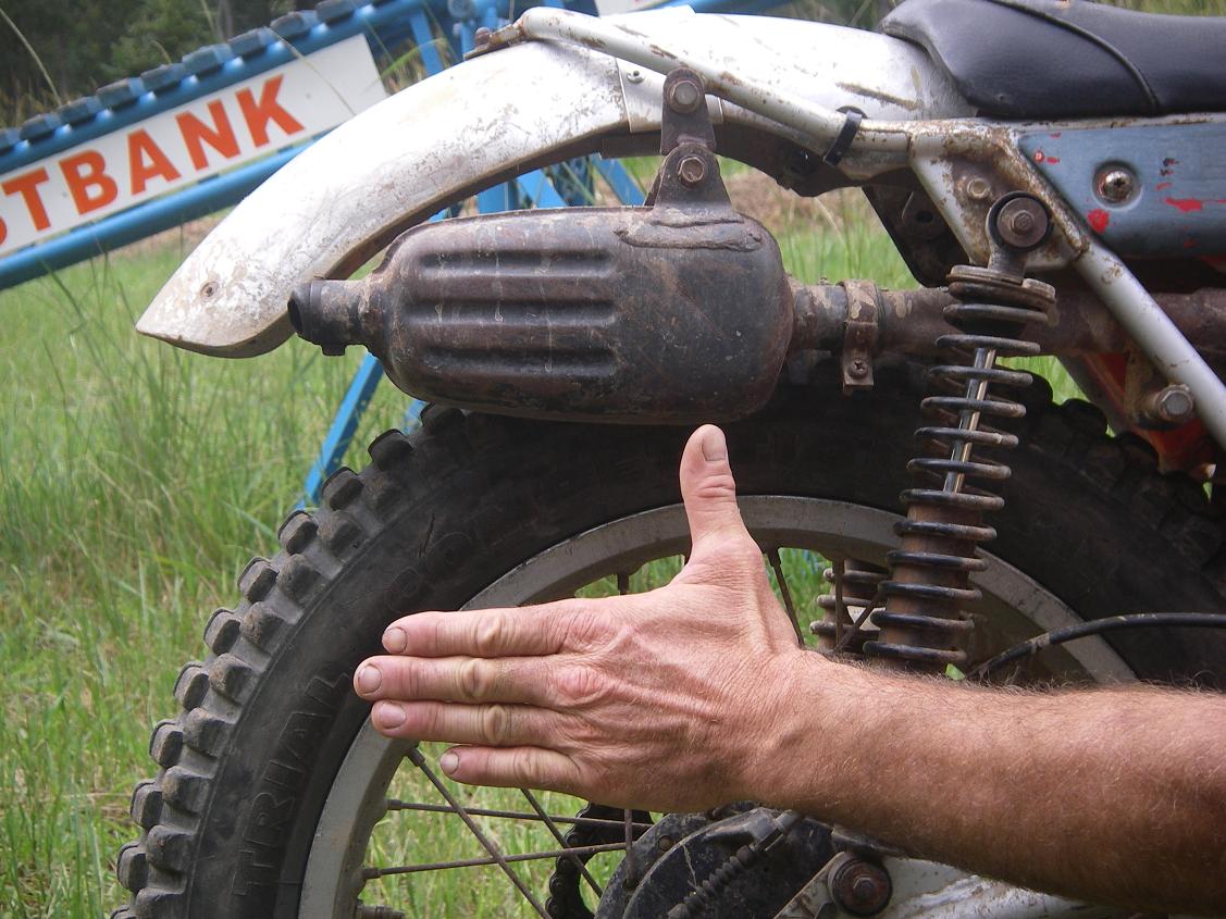

Hi Kim, (no 1 RL250 fan in SA) you seemed to find my description of rear silencer amusing so I have posted a photo to show why! On this subject does anyone know why some have German hand grenade shape and some just hand shape? Three of mine are the latter! One is missing!

Greg that silencer with your hand in the photo looks normal to me for the RLs that had full lighting steel tank, steel rear sprocket, steering damper and a compliance plate.
The one you mention that looks like a german hand grenade??? (cylindrical and longer than the one in your photo) is from the the competition-only model RL with the alloy tank, alloy rear sprocket, no lights and no steering damper.

As for the muffler. I am curious about that one too. My RL has a hand muffler. One RL I looked at around the corner from me has the muffler that looks like the granade rocket thing. Most adverts I have seen for the RL's had the granade type.
I don't think it matters much anyway. They don't work properly becasue they don't seal at the joint for the engine pipe.

The hand shape muffler was probably to make it quieter and looks suspiciously like a Suzuki TM250 muffler - but don't worry the hand grenade type leaked at the joint too.
