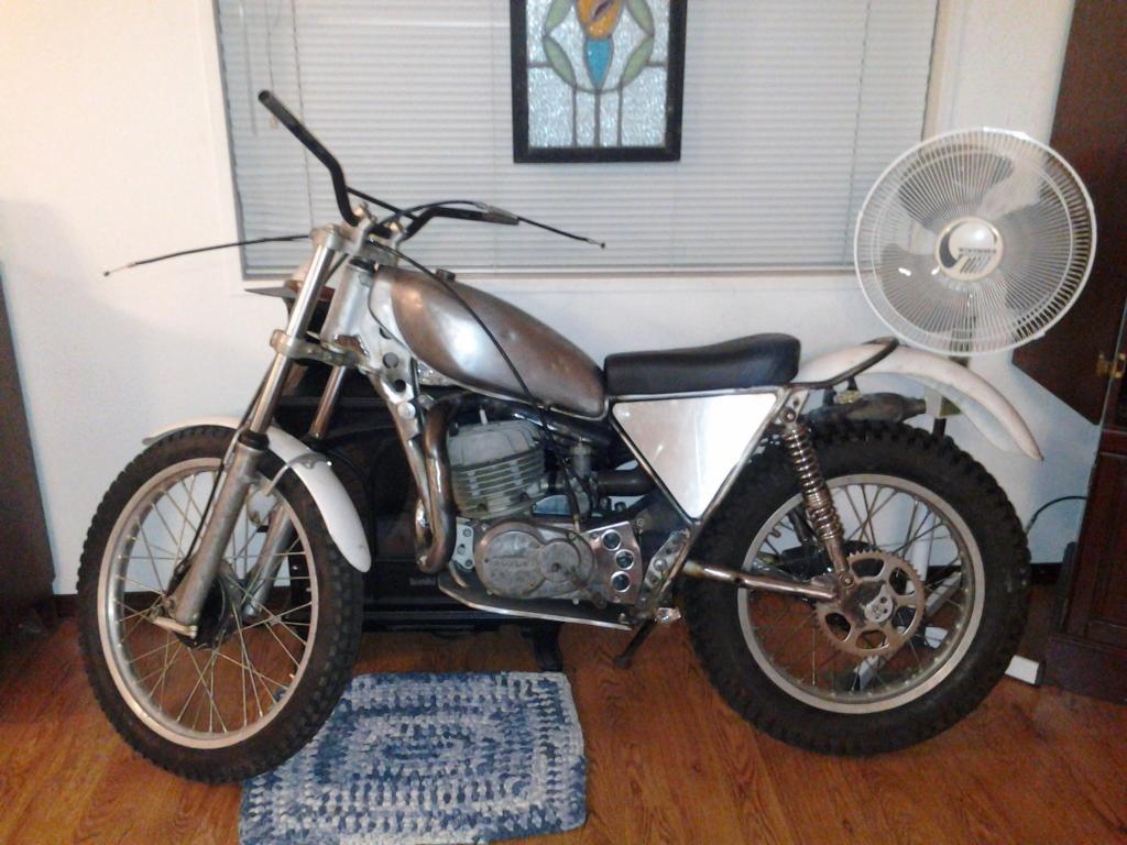

I was going to post this, commenting on the steering geometry of a modified RL, in another thread but it's more appropriate resurrecting this thread.
RL modified, 52in w'base.jpg (106.36 KiB) Viewed 3886 times
I have no desire to cast aspersions on the workmanship of the fabricator (who does excellent work), and there's much to be admired in what he's done on the rest of the bike, but it shows evidence of not understanding steering geometry when modifying the rake on twinshocks.
Standard Suz specs for rake and trail for the RL are 27deg rake and 76mm trail, which for trail is the lowest for twinshock trials bikes of the day. He indicated that he de-raked it 3 or 4 deg depending on where the forktubes are in the triples, and you can see how much he's done so if you look at the bend in the downtube (a couple of inches above the bottom of the gusset). It's very noticeable, whereas production RLs had straight downtube.
If still using the RL triples (as it appears) that reduces trail considerably to a mere 50mm which is extremely short for a twinshock trials bike which would make the steering and handling rather 'nervous' to say the least.
Now look where the steering has settled at with the bike on the side-stand. Note that it's on a polished wooden floor with a well inflated tyre, ie low friction surface/contact, allowing it to settle fairly freely to its equilibrium point. The steering angle at which it settles is the point of zero trail, beyond which the trail becomes negative - a very unstable situation. That is the steering angle where you no longer have any self-centring effect and tucking under starts even on a flat surface as you steer. And that's before you consider the worsening effect of encountering a bump, ledge, rock, log or deep sand. It's a very 'shallow' steering angle on that bike. ie You don't have to steer far before that condition arises.
It's an illuminating example of the potential hazards of adjusting the rake but not the offset on these old twinshocks.
The problem could be overcome by fitting different triples with less offset, for example from the 80s model DR250S, which, with the RL sliders would reduce total offset of axle to 65mm which would bring trail back to a more workable 72mm. Even tho he lengthened the swingarm he said his mods reduced wheelbase to around 52" so a change to the DR triples would reduce it a little further but still be a bit longer than the TY250 wheelbase.
