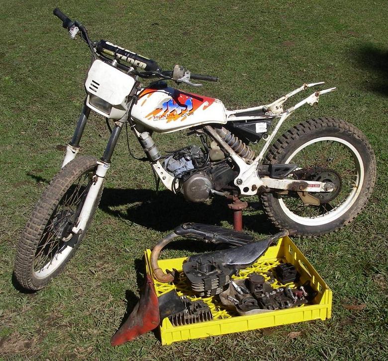

Here is a photo of the latest Basket Case TLM 220/200, not sure if it is a 220 with 200 barrell or a 200 with a 220 bottom end and tank? Quite a few spares to keep Donna's bike going, will be good just to have spare cables and things to take to trials. Thankyou June and Tom.
Jordy, somehow missed that the TL250 swingarm was 6 inches longer, what were they doing to warrant such a long length?
