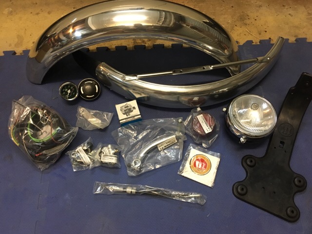

Finally received these from Spain after 11 months :lol:

How do I make the image show up in the post ?
Re: Cota 172 Restoration
Posted: Fri Aug 11, 2017 8:35 pm
When you open a "reply" window or a "new topic" window, below the area where you type words into is a tab that says "Attachments".
Click on that tab and it should invite you to upload a photo (or some other sort of attachment) from somewhere on your computor.
Posted: Fri Aug 11, 2017 9:26 pm
by Phil 850
Like this
Cota 172
Cota 172
