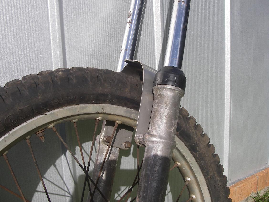

Hi Chippy, finished the fork brace today and have posted a photo. The tricky bit is doming the top to match the concave underside of the mudguard! Also I have refined my handlebar straightening jig and your Renthals came up pretty good! Because these bars have been bent and straightened, I strongly recommened that you use a bolt on crossbar. Another tip is not to drop off of any omni-buses!
Greg,
Thanks very much. The rear brake brace and the front mudguard bracket both look a treat. I can understand trying to get the concave working right would have been difficult. Thanks for your efforts.
Thats great that you were able to straighten the Renthal bars too. (Man of many talents).

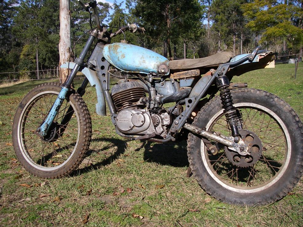

Just thoght I would share this with you (BLUE is the only COLOUR, EVERYTHING else is BACKGROUND!!!). Now you alll understand this, you can see why I like BLUE bikes probably more than the next person! I am posting some photos of an afore mentioned RL 250 I bought a couple of years ago for $300.00. There is no chain in the photos, but the bike is a goer abeit main bearing problems! After all this time, I am still unable to bond with this DUNGAR!

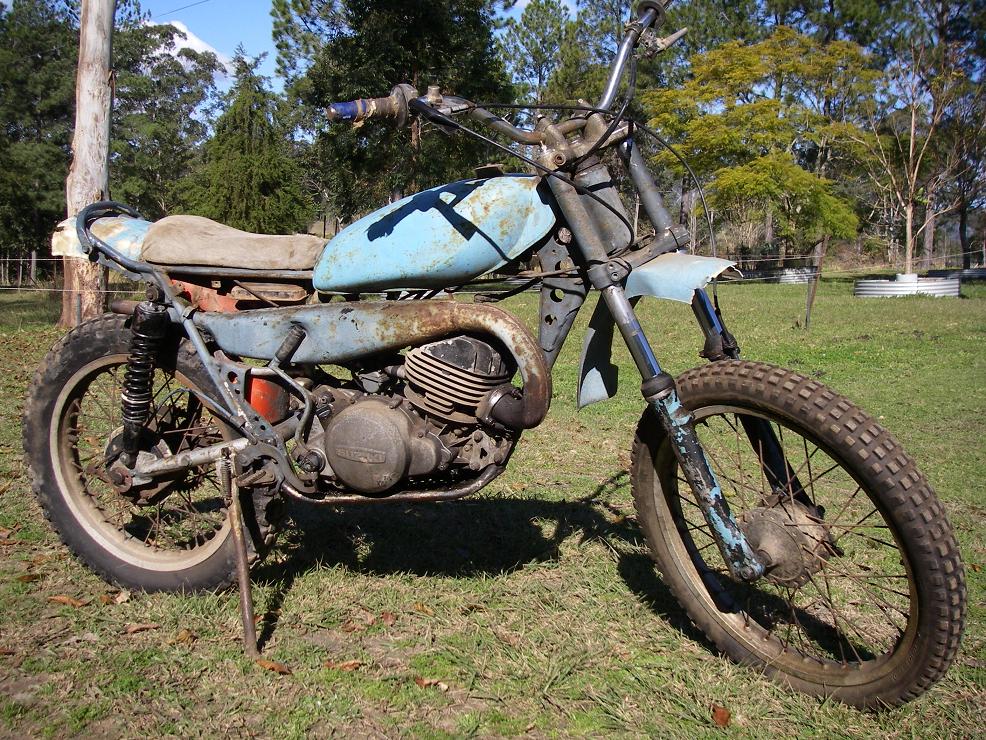

Hi Everyone
I have clocked up a few more rides on the RL,between rides I like to iron out any nigling problems and have the bike ready for the next ride when I put it away. Firstly i cut down and refitted the front guard. Also I have burnt the carbon out of the exhaust and painted it. This job is amusing to me, being someone who makes things, I am fully aware of overlooking things and building traps! I think the exhaust is well made with only one possible leak point so close to the end. Does it really matter? Curious what I find amusing? It seems they bolted up the exhaust and then the kickstart, folded in the kickstart in and went damn!!!!! Murphy says if more than one person is responsible for a miscalculation no-one will be at fault.Oh,um we'll have to make a dint here! Something else I have learnt is that whatever you make stands as a monument to good or bad workmanship!
