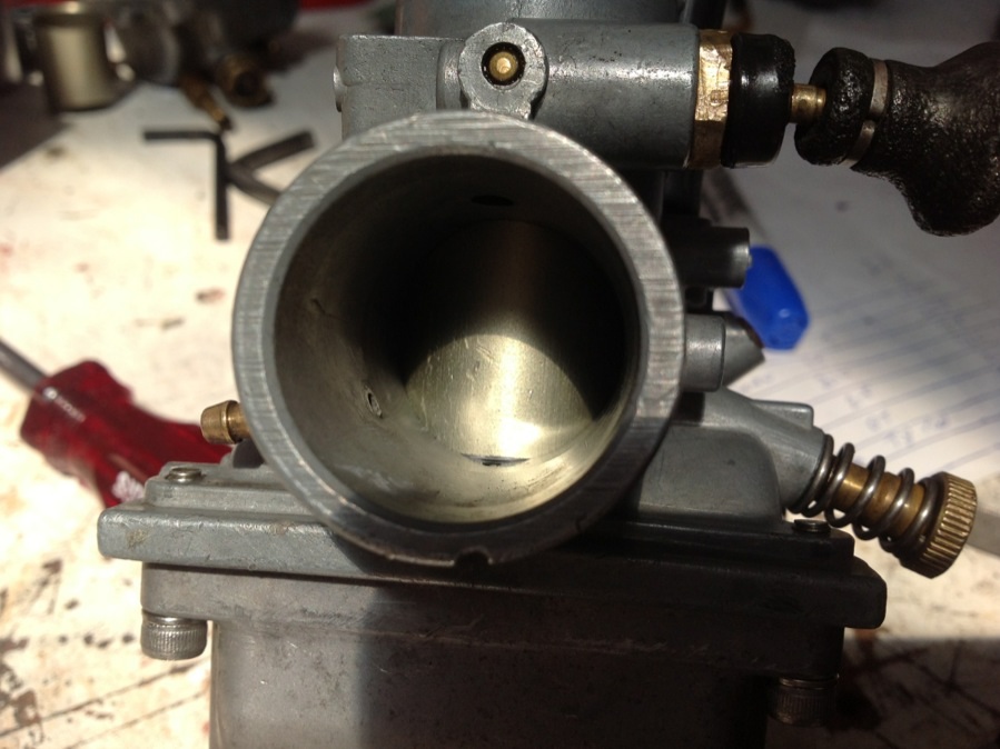

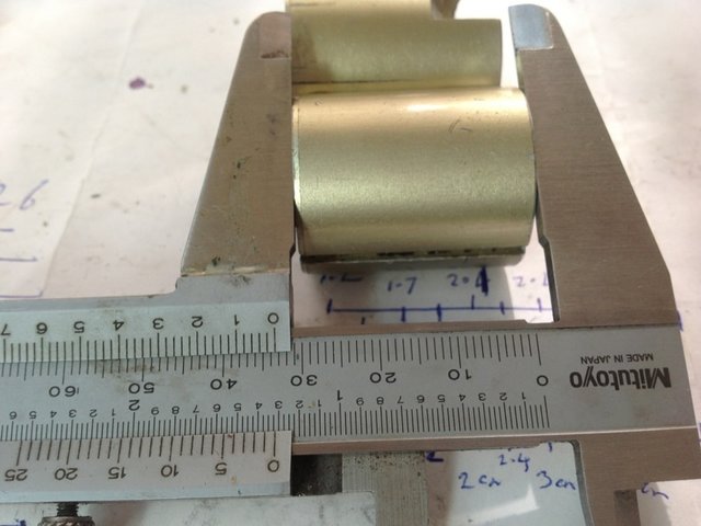

Slide cutaway 2.5, 2, 1.5, mod 1 from a 1.5
1
1
Everything from the 24 has to be transferred over to the 26.
24 and 26.
24 and 26.
The reason for the smaller cutaway is it forces the incoming air to travel faster over the Venturi on the emulsion tube which makes it suck harder and therefore richer. The ratio of air fuel is not changed just more of it which has been frustrating me in my inability to control it. Now that may change

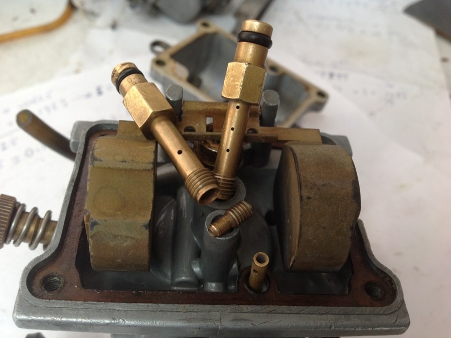

First run on the new 26
Full bell mouth mod
Main air jet - 2mm
DT emulsion tube 5 hole float bowl jet type
Main jet 360
Pilot jet 225
Cutaway #1
TY175 comp needle clip 3
Pilot air jet turns?
New 26 settings first run

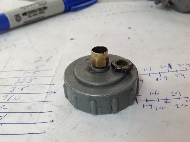

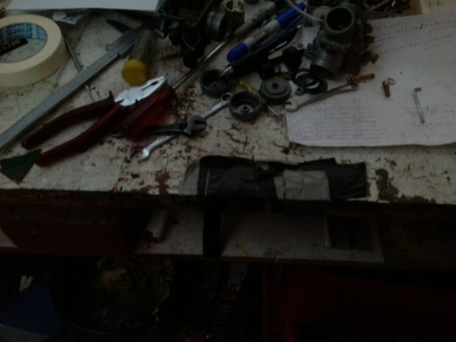

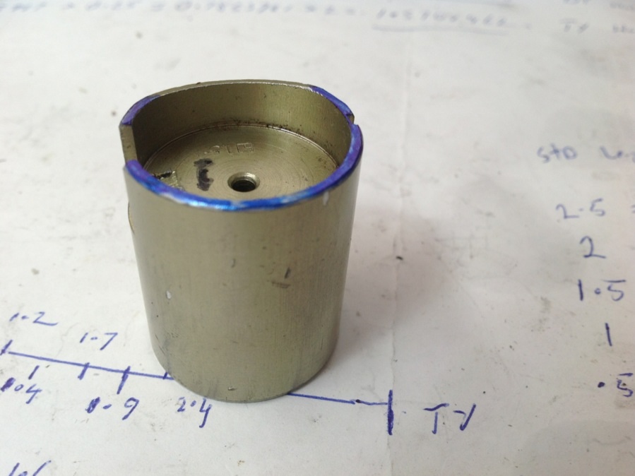

Didn't even get it out for a run. It idles to high. There is slack in the cable but can't bring it down. Took the carb out and painted the base with whiteboard marker and closed it and wiggled to see where it rubs. Seems I could put more chamfer on it the rest looks ok.
Trim
Trim
Trimmed and cleaned up
Sand smooth
Sand smooth
Now closes as good as a standard one. Not that there was much difference. If this doesn't work I will have to counter trim it as it must be sucking air in small amounts from all over sides, pilot, top, choke and idle adjuster which end I replaced with one that has a new oring to seal better
Closes as much as a standard one
Turns out the problem was the cable because of the 1mm I took off the slide the cable is holding it just up a fraction even after I wind all the adjusters in. I fixed it by removing the lock off nut so that the cable could get some slack.
Removed nut
Removed nut
#1 First run its not as good as the 24. The 5 hole emulsion tube never workers as good on the 26 as the TY 2 hole. Seems to work better on the 24 but this could be to drawing harder so it gets its aeration.
Pull it out and change to a 2 hole.
The pilot air adjustment felt like I could go a tad richer from the 22.5 to a 25
Change 1 - 2 hole emulsion tube and 25 pilot jet.
Change 1
Change 1
The 2 hole is better but the 25 pilot is not
Swaped the #1 cutaway for a 1.5 And you could hear it slurping as soon as it started just muddier. I think the 26mm could do wit a .5 cut away.
This set up is easier to work on than standard
Easier to work on
Easier to work on

That was good and makes me think of cutting the slide a bit more to make it a .5.
By changing the needle clip position it helps to work out what to do as cutaway and needle clip position overlap a bit.

I have now taken 1.5 mm of the slide length which in turn reduces the cutaway
Took another .5mm off
I think thats about all I could remove or else it will be none.
I will leave the clip 1 position in for the first run to see if it comes back inline.
I'm surprised how much changing the clip position changes the idle setting in theory the two are not in the same range but they are.
.5 cutaway

Same high idle problem I'm going to solve it temperely by not running a rubber washer and later trim the cap thread protrusion back 1mm.

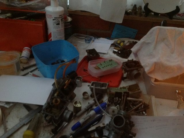

Just did another bunch of tests and I largely have my final veridic.
1) If you want instant response from idle then you need the 24mm with the 2 hole emulsion tube 2.5mm TY comp air jet size and .5 - 1 cutterway.
2) if you want a little more midrange but still good off low then go for the JC type emulsion tube. You still need the low cutter ways as its a bigger carb than standard so needs to draw harder. The TY comp air jet feeds the emulsion tube more air that a JC so it's a hybrid between the two.
3) if you want reasonable instant response from idle with really long legs all the way through then go for the 26mm with the 2 hole emulsion tube and a really big jet 400 ish and .5 cutter way.
I did some reading last night and confirmed a suspicion that these carbs have 4 stroke emulsion tubes in them! The design is to have air in the emulsion tube passage and aerate early and well like old 4 strokes like to have. They suck half as often and low down. If you want bottom end out of a 2stroke then you have to do the same. The problem is when you start asking for top end. At some point this system will be sucking to much air mixed in with the fuel and go lean up top. This explains why I have been having this constant problem with getting it rich enough down low then needing large jets up top.
At one point I was going to admit defeat and use the 24mm with the modified standard air box. changing the slide cutterway has changed the fuelling enough for me to stay with the 26. Not quite as good from really low but better everywhere else. I don't think the 26 is suited to a standard air box.
PS. My testing was with a 16T front sprocket second gear on about a 30 degrees incline. If you scale that back to a 13T trials gearing you aren't going to notice any variation apart from the long legs and increased go.

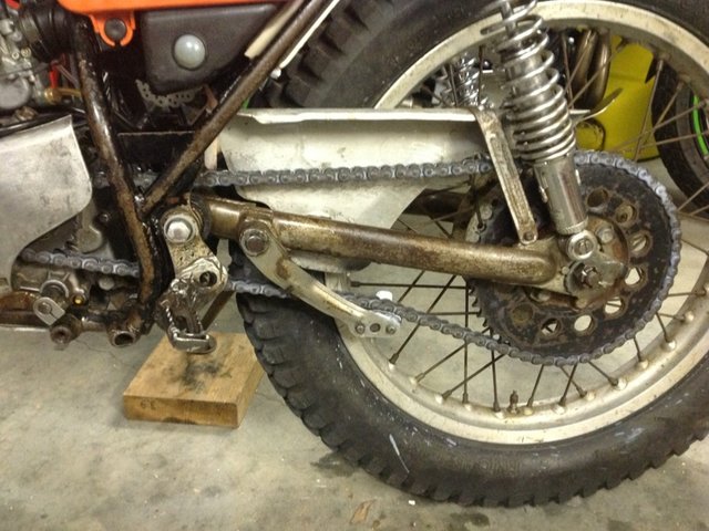

As its to tight on the chain. I have the adjusters turned to beyond the last smallest position to the smooth section and its still to tight
Old chain lengthened to a smaller front sporect

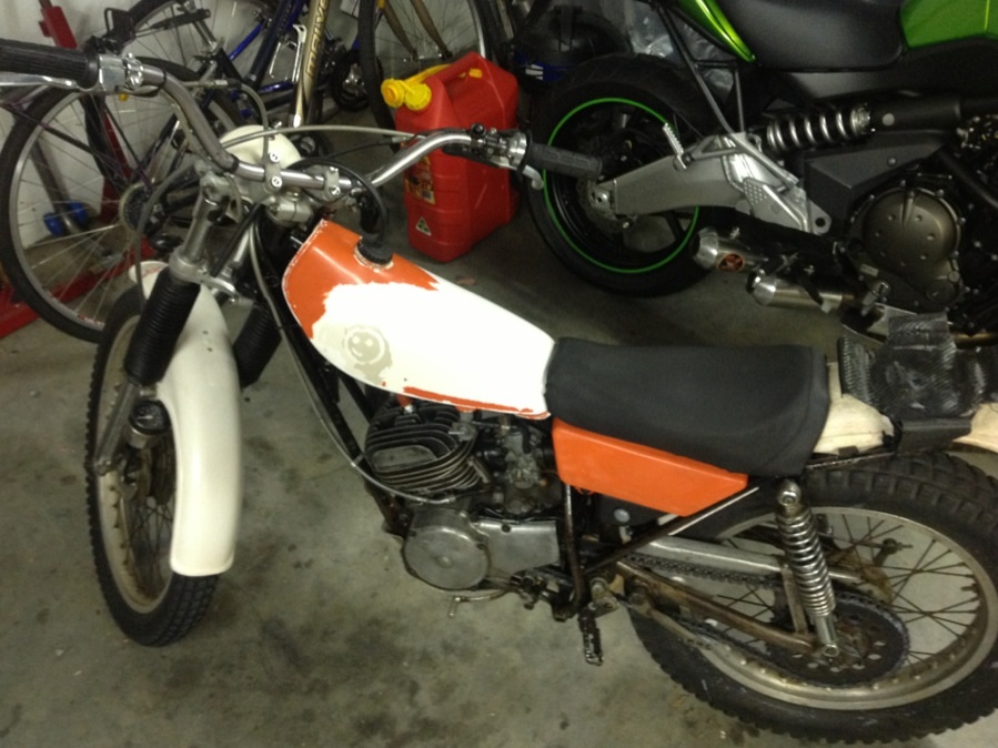

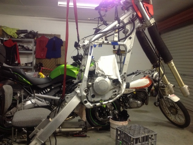

This is my other trials bike. We have been over some rough terrain that I struggled to keep it upright.
My other Trials bike
Going for a long weekend ride, camp. Which is good on this bike as its registered like i can the TY175JC
I will have to give it a look over and set it up. I could be putting it through its paces.
Set it up for a event
There is no lacking of horse power or torque when this one goes bush.
I have to admit to using a knobby on the front in the stile of racing wet. I gust can't afford the lack of grip my inadequate skills provide. I'm thinking the bash plate is not going to take the weight of the bike.
No slouch in the bush
9000 RPM on the dirt is quite an event and best done in small doses.
