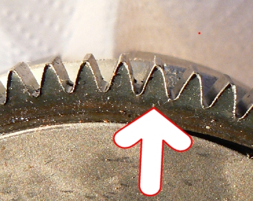

Can you post a photo of the tooth from the end looking inline with the shaft? The teeth on those gears are case hardened, which will not ware down in a hurry so just riding it will not work. The slip stone if you could find one small enough would work if you had a month of Sundays and it was only a small high spot. I had to do a hole 2nd gear for a Maico engine once as the only one available was a repo from USA and it didn't mesh at all with the original gear. Got to it with the dremil and took every tooth down a bit and it's been in there for about 5 years and still working.

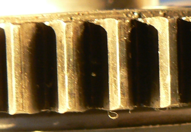

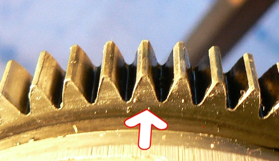

Post by keychange »
Here is the gear - back and front

Looks like on the second photo that the right hand corner of the tooth is bruised a bit. Is that the case?
Looking some more and using a ruler it looks like the distance between the tops of the marked tooth and the ones either side is different. Grab a ruler and have a measure.

TriCub wrote:Looks like on the second photo that the right hand corner of the tooth is bruised a bit. Is that the case?
TriCub - I am not sure what you mean by bruised but as I have said even under magnification I cannot see any obvious flaw. There is every possibility that the distances are different although even under magnification it is hard to measure accurately but yes I think that is the issue ie: the pitch on that tooth is slightly too large and causes the opposing gear to catch.
