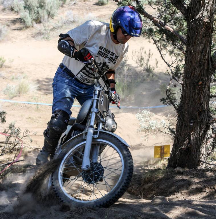

This pic of the the same bike in a section says it all, looks like negative trail has kicked in and he is struggling in that sand. I first saw this pic a few weeks ago on TC and thought it looked awkward and now after reading through this informative post I can see why.

Yes, well spotted Rod. I thought much the same of the pic.

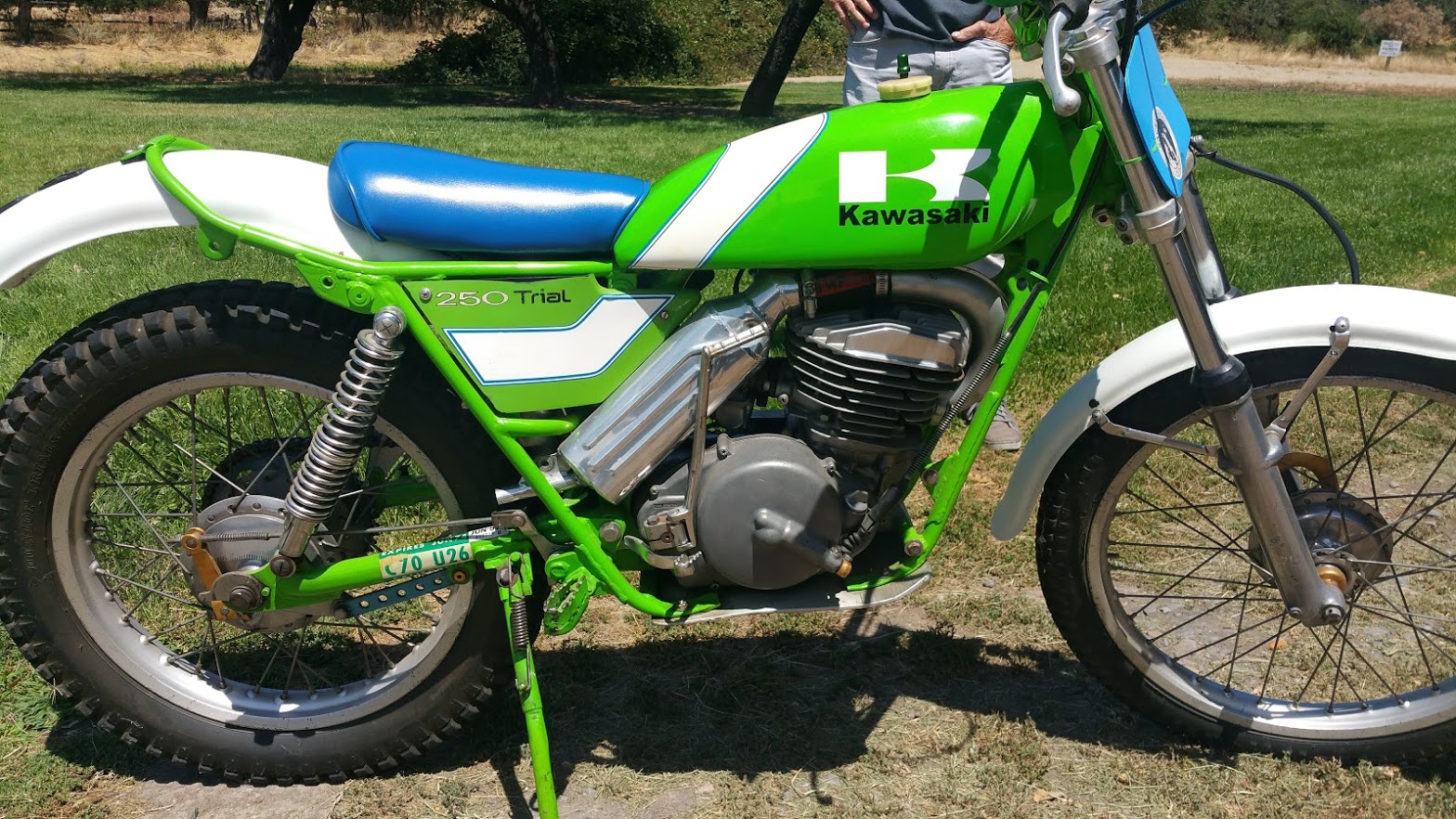

Before I start on what I've done, I need to say why I did it.
In my opinion the stock standard KT has a centre of gravity that is bordering on being too high. It also has a forward weight bias and a shallow steering rake angle. It also has footpegs a long way off the ground. These things combine to give a wobbly ride and heavy steering. If the rake angle is made steeper by lifting the rear end via longer shocks, the centre of gravity becomes seriously high. If the rake angle is made steeper by sliding the fork tubes up in the clamps, a slight benefit is available but only a very small amount of adjustment is available before the mudguard hits the lower triple clamp on compression. If the steering rake is made steeper by running a lot of sag (like what you get with standard springs and standard preload), then the suspension action is poor due to too much sag. It is not possible to increase the trail easily either because even standard the wheel and front guard are very close to hitting the exhaust and frame when the forks are compressed, so doing something like fitting in-line axle forks or different triple clamps to increase the trail is problematic. I have tried this as an experiment and the steering feels great but it is very distracting when the guard keeps pummeling the exhaust header.
Yes the forks on my KT are much firmer in action than standard. The springs are Magical brand and of the type sold for the TY250. They are significantly stiffer than standard TY250 springs. I've changed the damping too using Yamaha Majesty TY250 damping rods, which gives a very nice damping action.
There are some other things too that make this particular KT250 pleasant to ride.
There has been a change made to the main frame loop near the rear of the fuel tank that has reduced the fork rake without moving the front wheel closer to the exhaust or frame.
The footpegs have been moved as low as possible without sticking down lower than the frame rails and they are very low profile pegs. This greatly helps with balance and control.
The frame change was done in a way that suits the use of 340mm shocks which keeps the centre of gravity in a nice spot.
There are other ways to make them nice to ride. One I saw had the steering tube moved forwards in the frame (by quite a lot) which allows for the rake angle to be made steeper and also for increased trail, without the wheel hitting the exhaust.

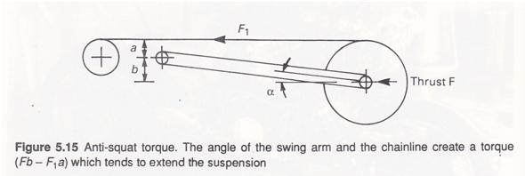

JC1 wrote:.
It’s worth looking into this ‘loop factor’ in a little more depth. It’s a bit of a sidetrack but it does affect steering to some degree (under power).
The natural tendency of a vehicle under acceleration is to ‘squat down’ on the rear suspension due partly to the change in weight distribution since the vehicle’s C of G is considerably above the horizontal driving force. Thus it creates that ‘squat’.
We might assume that the drive force acts where the rubber hits the road, but it actually acts on a bike horizontally through the rear axle. And since the pull of the chain also has an effect, depending on the geometry of the swingarm & chain-sprocket set-up, the drive force can (& often does) produce a torque that extends the rear suspension. Since this is counter to the squat effect, it is understandably called anti-squat (or more correctly, anti-squat torque).
Apart from engine HP & grip on the road (eg sticky tyre, grippy surface, or otherwise) there are numerous variables that affect it: ie front & rear sprocket diameter, swingarm pivot position, swingarm angle & front sprocket position. The diag below ‘reveals all’.
When it all boils down in the geometry, it all depends on the dimensions 'a' and 'b'. They are the most critical. (In a sense the length and angle of the swingarm are irrelevant. What counts is the distance 'b'.)
You can see that the chain pull force ‘F1’ acting at a distance ‘a’ from the pivot produces an anti-clockwise torque (F1 a) compressing the suspension (ie squat torque) & will be greatest on full compression when ‘a’ is maximum. But the thrust force ‘F’ (ie drive force) acting at a distance ‘b’ from the pivot produces a clockwise torque (F b) extending the rear suspension (ie anti-squat torque) & will be greatest at full extension when ‘b’ is maximum.
Now it’s the overall resultant that is important. When F b > F1 a, the overall nett effect is anti-squat torque (Fb – F1a), but when F1 a > F b the overall nett effect is squat.
It is effectively an over-centre mechanism. At some point of suspension compression on most bikes the anti-squat torque (Fb) is going to be zero. That happens when b=0, ie when the swingarm is horizontal. But what happens to it on further compression? It becomes an additional squat torque added to that of the chain-pull squat torque.
Apart from ‘a’ & ‘b’ changing as the suspension is compressed, they are also dependant on the sprocket diameters & the height of the swingarm pivot relative to the front sprocket & rear axle. That’s why the pivot location is critical to squat/anti-squat (& why some factory GP bikes have adjustable pivot locations for diff gearing combinations, track/tyre/stickiness, suspension settings etc).
If you get the pivot too high you get too much anti-squat, thereby worsening the ‘loop factor’ by raising the C of G as the suspension extends under power, & also stiffening the rear suspension under power. But if you get it too low you get excessive squat & soften the rear suspension under power. (In fact on high powered bikes you tend to pull the tyre off the track & cause excessive wheelspin.)
Now as long as ‘b’ > 0 (ie the rear axle is below the swingarm pivot) there is going to be some anti-squat torque produced under power even though it reduces towards zero as the swingarm approaches horizontal.
Going back to the RL, it seems that its swingarm is not horizontal until the rear suspension is almost bottomed!
Add to that the RL’s ‘frisky’ engine & you can see why the high swingarm pivot potentially has such importance/effect. (You can also see that running longer shocks is likely to make the loop factor doubly worse, by both raising the C of G directly & increasing the anti-squat effect.).
While having some anti-squat torque still produced at/near full compression is not necessarily a problem in itself (since it’s the nett effect that matters), it probably does indicate that the RL has excessive anti-squat at laden ride height, raising the C of G & tendency to loop under power.
Apart from lowering the swingarm pivot, one could overcome it somewhat with shorter/softer shocks (which unfortunately also lowers ground clearance & slows the steering) or with a roller under the top chain-run to raise it a little further above the swingarm pivot, thus increasing ‘a’ (in Fig 5.15 above) & hence also the pro-squat torque, to overcome more of that anti-squat.
I recently noticed, on looking at some pics of Beamish RLs, that the swingarm pivot is noticeably lower on the Mk2s with the production RL engine compared to the standard RL. Obviously they came to see a problem there too. (The Mk 1 Beamish is on par with the std RL, and the MK3 with the completely different black engine appears to have gone back to a higher pivot)
